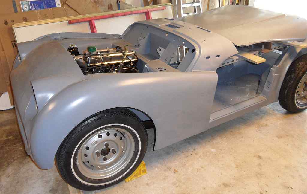

I can't believe it's only been 2 months since I started welding. Today I ran out things to weld -and I only took 479 pictures along the way. Yesterday I repaired the transmission tunnel, today I finished the last couple things that needed done with the tub off. Then I used a razor and scraped off the majority of the improperly applied POR15 on the under side of the spare tire compartment.
It's been so long since I stripped the body paint that I had some surface rust forming and used OSPHO to clean it off the inner front fenders before resting the tub back on the frame (OSPHO drips will eat away any paint). As soon as I can get the inner side of the hood stripped, I can get it blasted and primed. So I'm probably half way to seeing it painted.

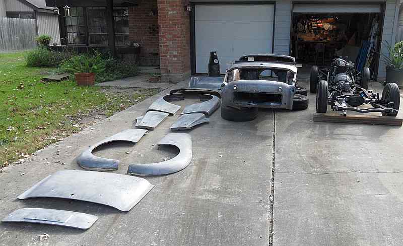

Tomorrow it will be 6 years since I picked up the TR3, and I have a special event planned. But today, just for fun, I pushed it into the drive and took a few pictures. All the removable panels are now stripped bare, inside and out and have been repaired. Less than 6 bolts were holding the panels in place for the first picture, and it took me about 1/2 hour to get the tub off (or on) and take a few pictures.
My front apron had 3 layers of paint before a "skim coat" of filler. Then another 3 layers of paint under that -excluding primers. Under all that paint was a layer of rust about as thick as the filler that caused the surface to crackle, with a few holes rusted through. I really do think I'm done welding now. I started body work 20 months ago. I think I'm half way done now.

Looking great Tex. Your Body Gaps look much better than mine...I am envious.

Thanks, but you really can't tell from those pictures. The doors are resting there, held in place with a bungee. The apron and hoods are held in place by gravity. Two bolts per fender, started, but not even tightened.

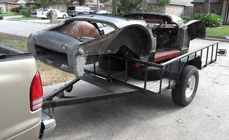

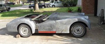

This morning I used my TRuck and my brothers TRailer to take the TR3 to breakfast and then 70 miles to La Marque to be blasted and epoxy primed. I've never had any children, and never dropped them off to school on the first day, but I know how I felt leaving the TR for the first time since I brought it home.
Did you know that both doors, the spare tire cover, the trunk lid, the hood and the apron will all fit inside a Dodge dakota back seat, leaving plenty of room in the bed for 4 fenders?
I should have it back in a week or so and can start 'getting ready' to paint.

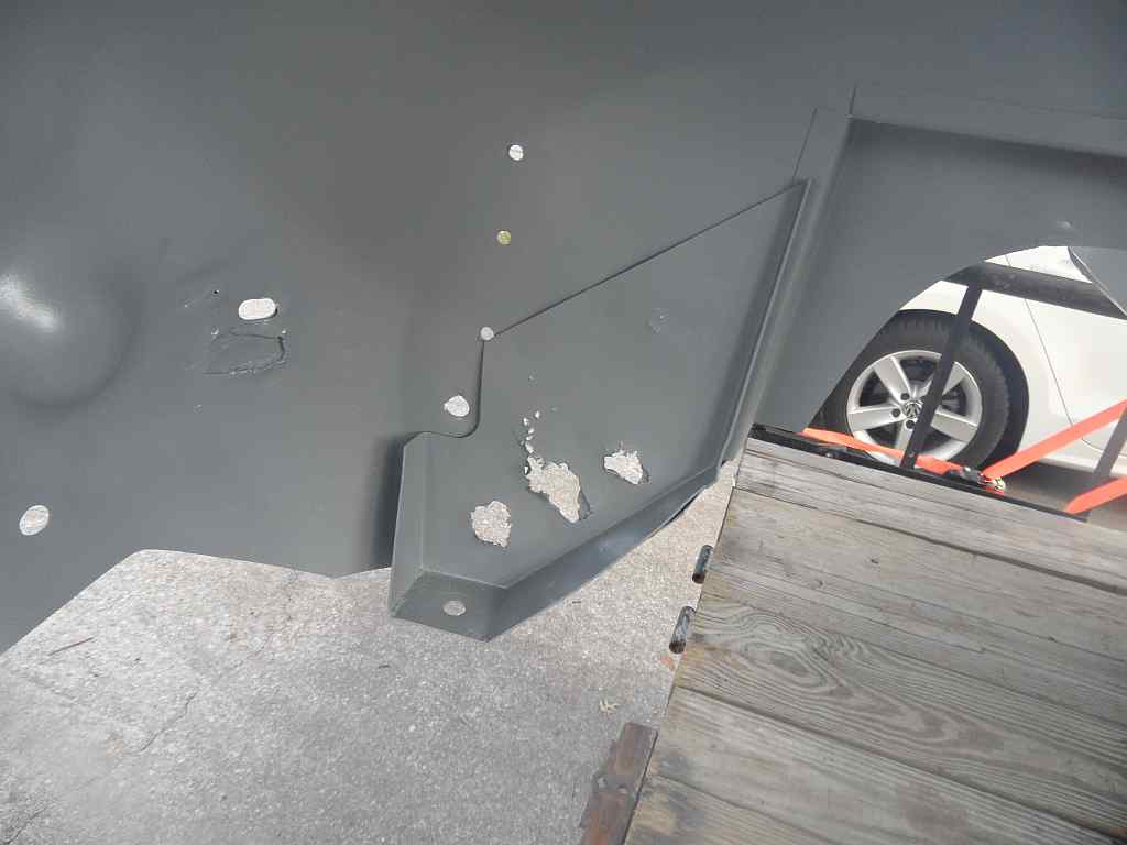

Picked up the TR3 tub and panels yesterday. It was stripped to bare metal and epoxy primed. Both the 2 front and the 2 rear body mounts (where a second section of steel is added by spot welding) rusted from the inside, and holes blew through with the blaster. So I am not done welding, but the car is all grey and back home. -The really fun part will start soon.

So I finally cut into my primed steel and repaired the sections I should have addressed before priming. The last weld repair was made to two small filled sections at the rear right fender attachment (allowing repair of the last cage nut with a bolt broken inside it) near original lead. Welding near lead will reflow the lead. Then I spot sand blasted the body mounts and repairs and my neighbor mixed up some epoxy primer and sprayed it on all the bare spots. Once again, the car is completly primed -this time without holes.

To check alignment, I bolted on the front apron -which I've learned should be done prior to tightening the 6 body to frame bolts at the front (so the front of the fenders can be aligned, especially at the front/bottom). This picture shows my left and front fender, each held on by a single bolt to the top of the apron. I thought they fit, but am very happy with how well. The right side, not so much, but I was so happy I nearly danced after seeing the left fit.
The bag on the dash is the rest of the new bolts/washers to hold on the left fender properly, but it's already so solid, you'd think it wouldn't need all that. I remember taking it apart and it being so tight with nothing holding it together but habbit. I kept thinking 'there must be another bolt somewhere'. After a litle shake, a few choice words and Wham, it fell apart.

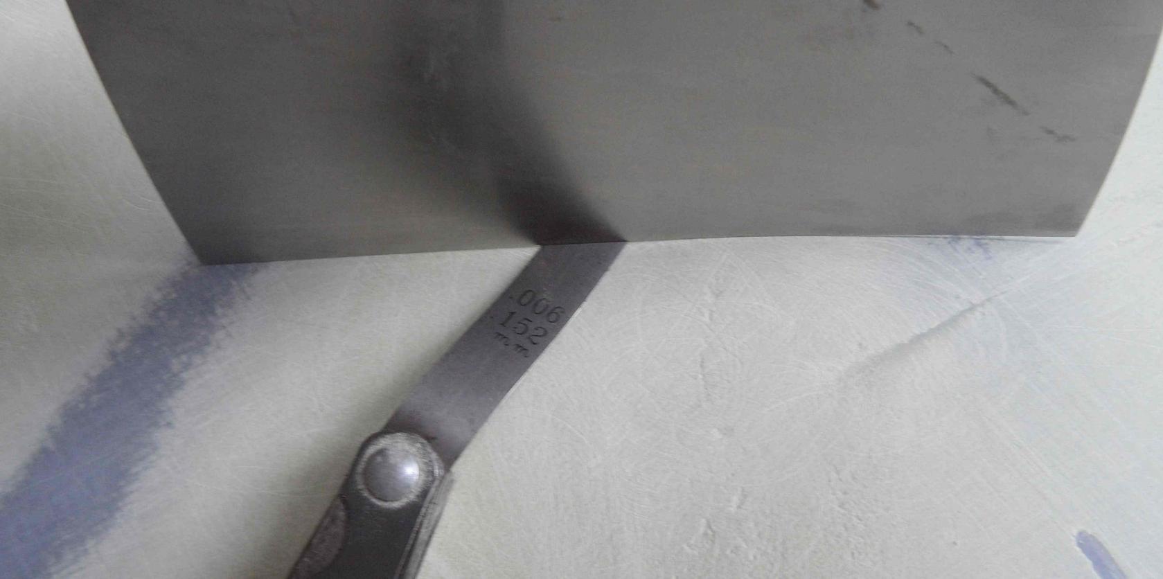

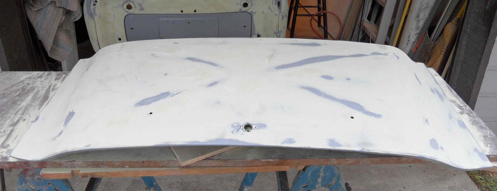

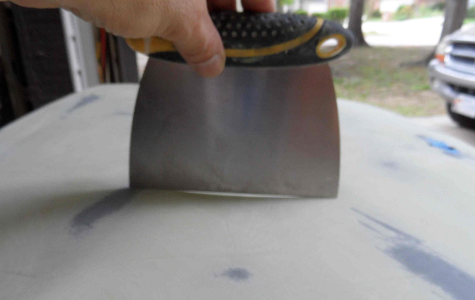

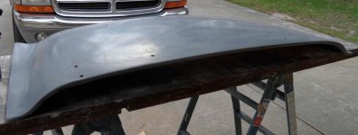

After I had everything bead blasted and epoxy primed, I noticed my trunk lid looked a little stretched, in the right light, you could see the "X" cross support on the top side. After skimming with filler, and block sanding, the "X" was easily seen. I wondered how much it was bent, and laid a flat tool across the high spots to measure the low spot with a "filler" gauge. A couple more passes with filler and block sanding and it looks (and feels) flat now.
I'm tired of block sanding, but the end is near.

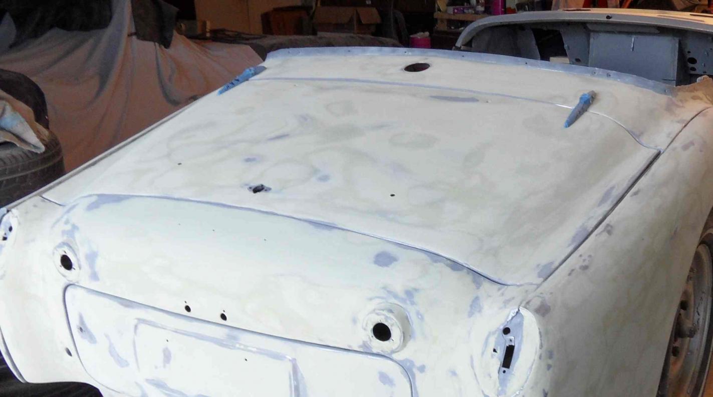

Think you MUST be farther along than half by now
"Half way" is very subjective. Now, I think I'm "half way" to primer. The entire car has been filled and blocked and sanded with 80 grit, so now I have to block again with 180 grit. After it's primed, I'll be "half way" to paint, since I'll only have to block it twice again with finer grit before paint. Then I can start puting it back together. Since the chasis is done, I'm already "half way" there. The dash, cappings and seats are done, so the interior is "half way" there... just like it was 6 years ago when I started, all I lack is finishing. :)
