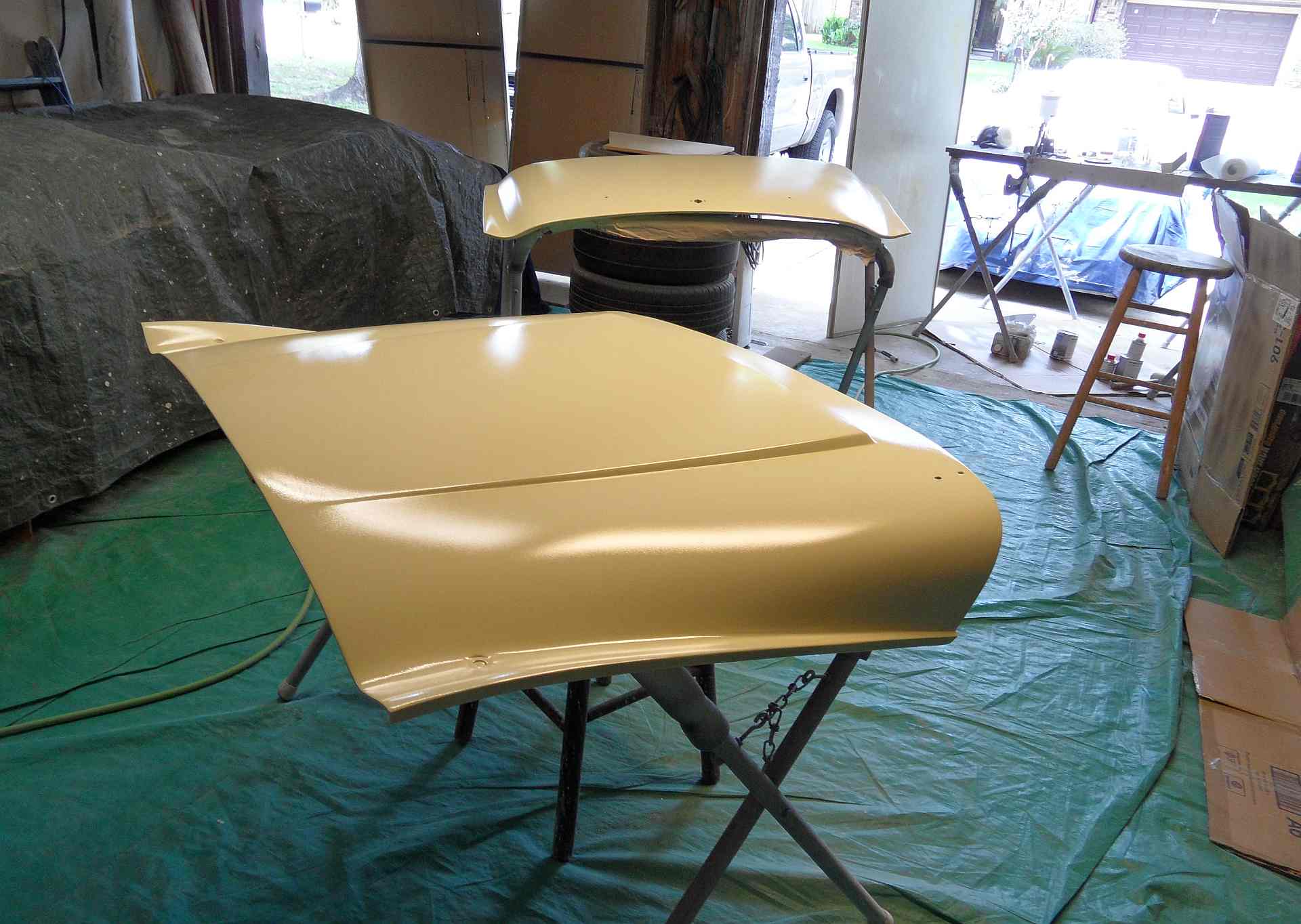

Saturday, on the trunk and hood, I put 3 coats of color followed by 4 coats of clear -more than recommend by PPG, but I need enough clear to sand off the orange-peel. Sunday I spent wet sanding those two panels. Monday I buffed and polished them. Today I polished the tub with the fenders installed with all the bolts finger tight.

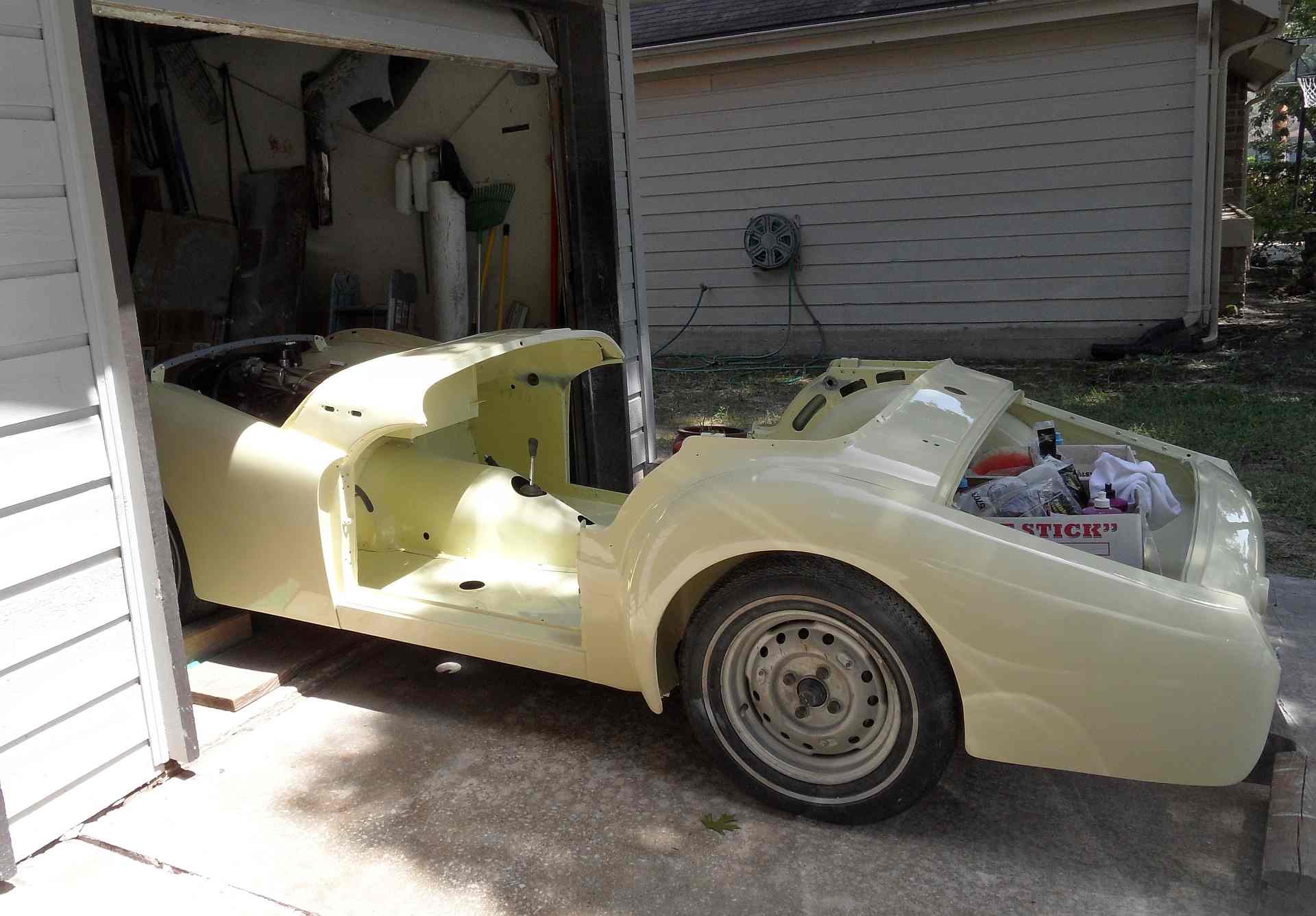

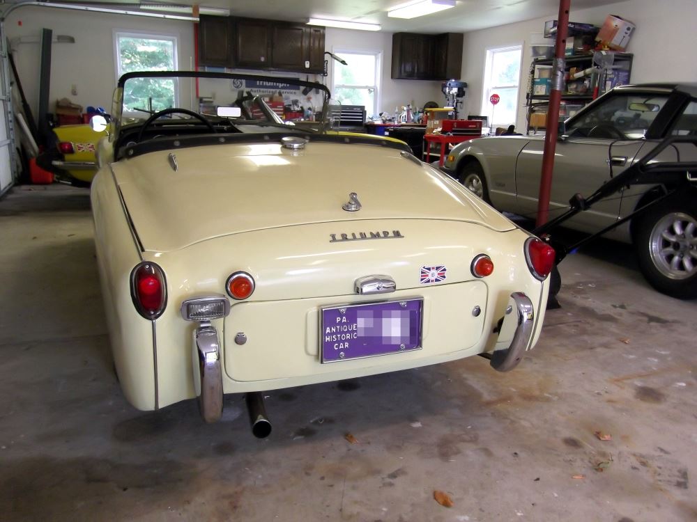

I wanted to see the 'finished' result actually in the sun so I pushed it out into the driveway. I think I'm more than half way out of the garage...
Looks beautiful Jer. You must be very excited to be nearly done with the very difficult Body and Paint step. You've about caught up with me!

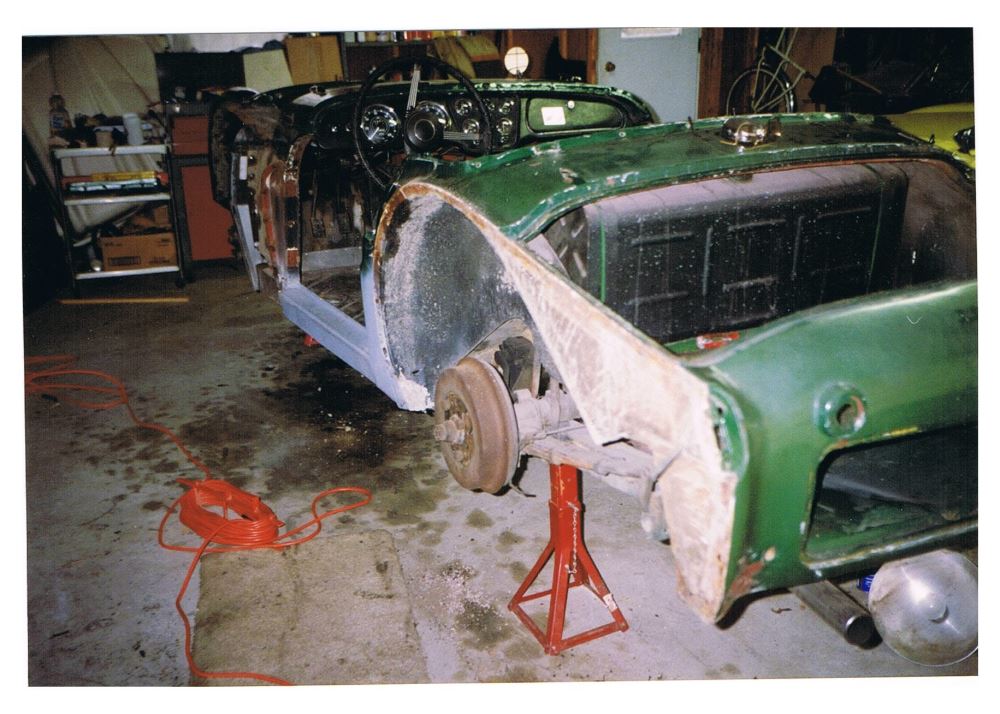

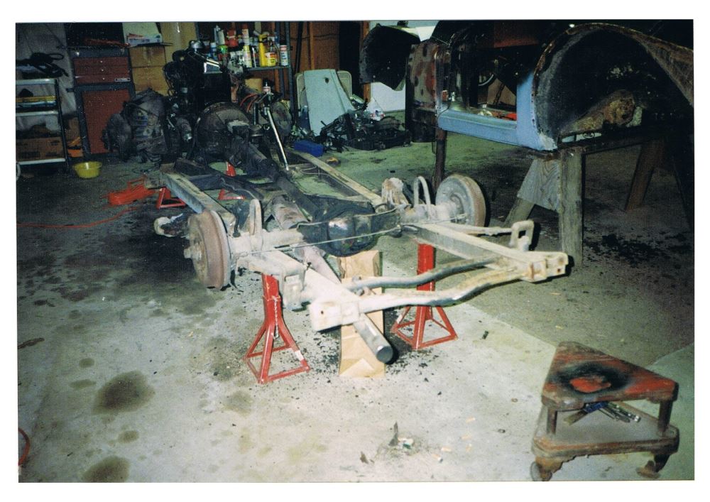

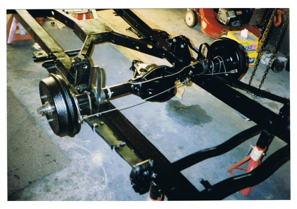

Congratulations, you turned the corner. There is no end to the satisfaction you get when you go from picture 1 to picture 4.
Joe

I painted it in my garage with the doors open and a large exhaust fan pushing air out from the back side of the garage through a soffit vent. I would generally stand some old closet doors across the front to try to stop leaves and stuff from blowing in while I was painting. I painted small sections at a time when possible. In this picture you can see the hood and trunk in my "paint booth" -the last of the body parts to be painted.
Dust? Well, a few cat hairs fell into the 2nd coat of clear. I saw them before the 3rd coat, but they were too stuck to be blown off with an air tool and I didn't want to dig them out. When I was 'color sanding' I found the hairs useful to show me that I still had more clear before I hit paint. I know of at least 5 cat hairs, but I don't know how to tell where the dust is. Anyone would be hard pressed to find the hairs. I'm not worried about dust, hairs, a few fish eyes, or anything.

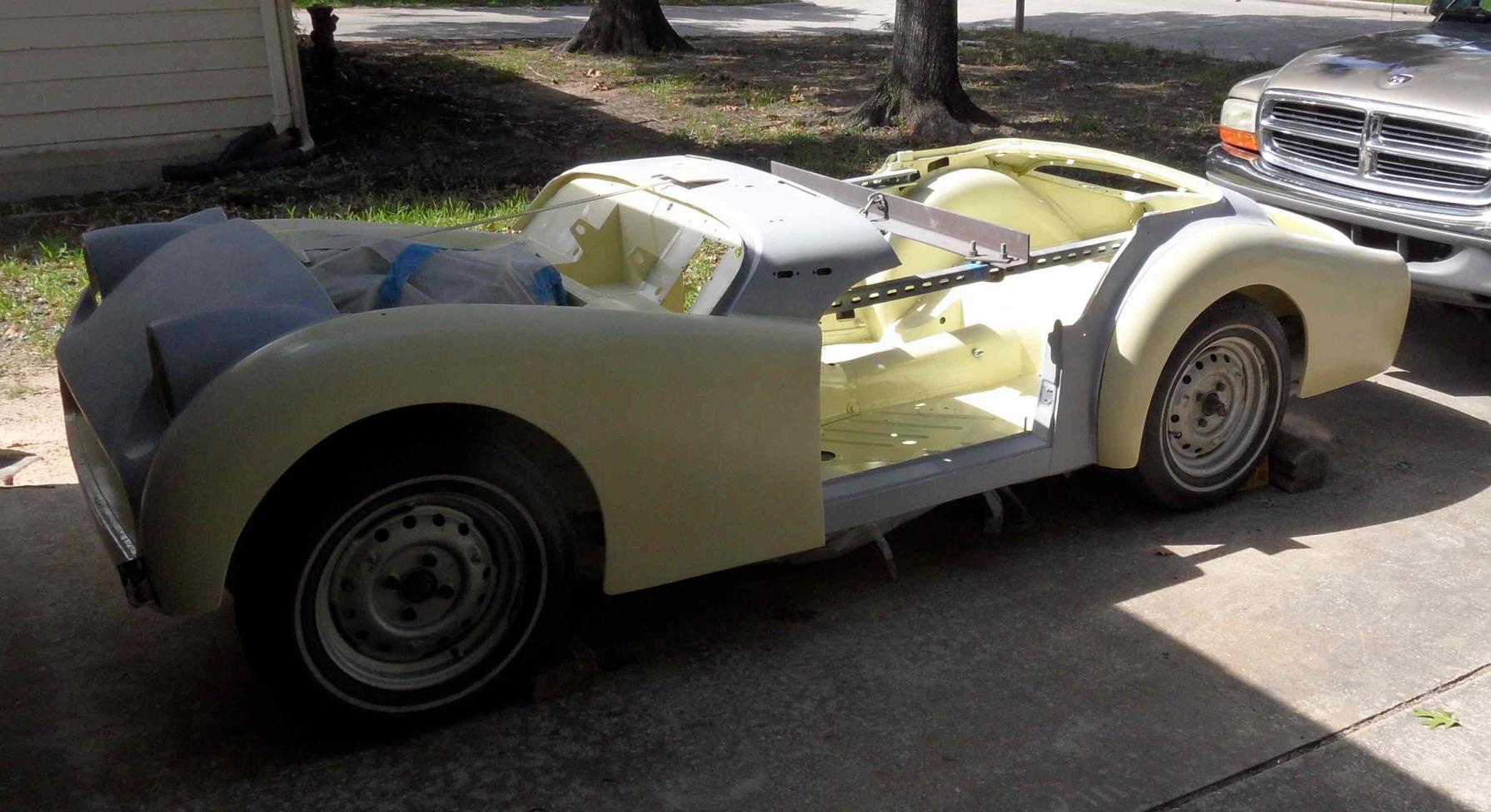

Thanks, considering where I started, it looks very good. Considering what I got for what I spent, I think I did well. It looks fine -probably better than new.
Even though the rear end is more than half way put back together, I still have to put the beads on the front, install the steering column, and dash and wire... so I'm hoping I'm close to half way done with the final assembly. Whoever came up with the idea for beading on the rear fenders must have 6 hands and a lot of patience.
