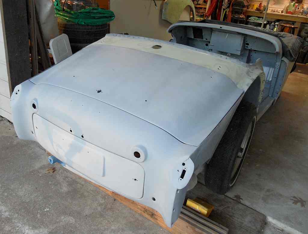

The curves keep coming. Yesterday I realized I'd never test fitted the trunk handle, and it didn't have one when I got it. The two threaded holes for the handle somehow became not centered with the top holes in the trunk sheet metal. One side had a broken stud in it. Luckily I had another trunk lid in the attic, because I was sure the attachment plate under the sheet metal should move -but it doesn't. I'm not sure how it's attached, but it wasn't rusted/primed in position. I 'stretched' the top holes and drilled/re tapped the mount. The spare had a broken stud in the right side too...

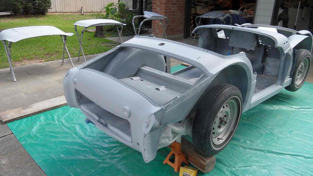

After only a month of procrastinating, I installed the 1.7mm tip and mixed up some high build primer. I never used a HVLP gun before and I managed to use up the paint on some parts, but it wasn't working as expected. After cleaning the gun I figured out to get the settings to function by filling the cup with water and spraying cardboard. I'm still having trouble getting a nice consistent pattern, but it's much more usable.
After a couple attempts separated by more block sanding, I have a few parts looking pretty good. I still have a ways to go before I try a guide coat, but I am making progress again. I'd say I'm half way to knowing how to apply high build primer.

Pictures. It's funny that ever since I started body work, the pictures looked so much better than the car did in real life. My welds looked clean and solid. The filler looked smooth. But, now that it really is much flatter and smoother, it looks better in real life than in the pictures. When I run my hand across it, I can't believe it's the same old, bent up, twisted, rusted out, and re-welded panel. I'll put some pictures up when I can set a few finished parts on the finished tub -and by finished, I mean primed and ready for final sanding. Halfway finished.

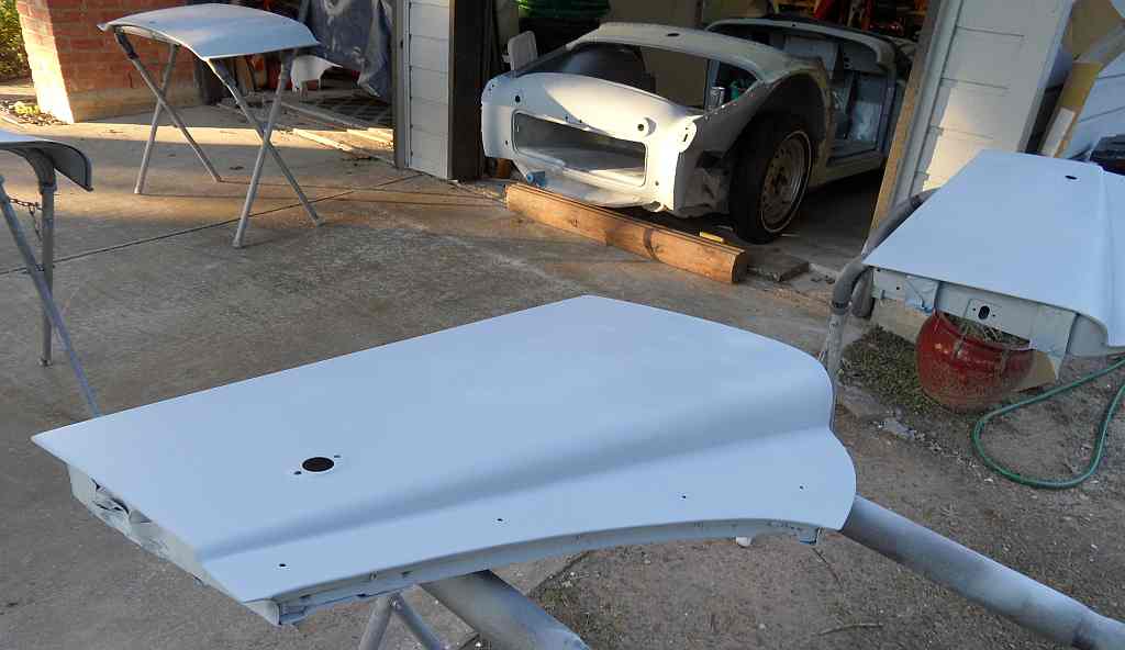

So it was (relatively) cooler this morning and I sprayed some more primer. I turned up the pressure into the line, and down to about 30psi at the gun inlet. Changing the air control knob at the bottom of the gun causes the pressure at the inlet to change while using the gun. So when I'm trying to shoot my test pattern, I must change both the air regulator into the gun as well as the air control knob. The fluid control knob seems to function as I'd expect: causing the test pattern to be barely covered or running at either extreme. But the top knob (pattern control) does not seem to do anything. I always get a round pattern.
The adjustments today provided much more 'wet' coverage than previously, and much of it looks good, but the result is a sort of striping, since I'm painting strips with little overlap. After I sand, it will probably look fine but I don't understand how to get an oval pattern. I used up 1/2 gallon of primer now, and everything except the 4 fenders has more than 1 coat of primer.View attachment 27618tub_prime.jpg
Duh. I simply had to open the valve a little more. Now I have the pressure set to about 15psi at the gun (as the paint spec suggests), and my pattern is much better. I had to get some more primer anyway, so I also got some high temp hardner. My latest spray looks like someone did it who has a clue what to do.

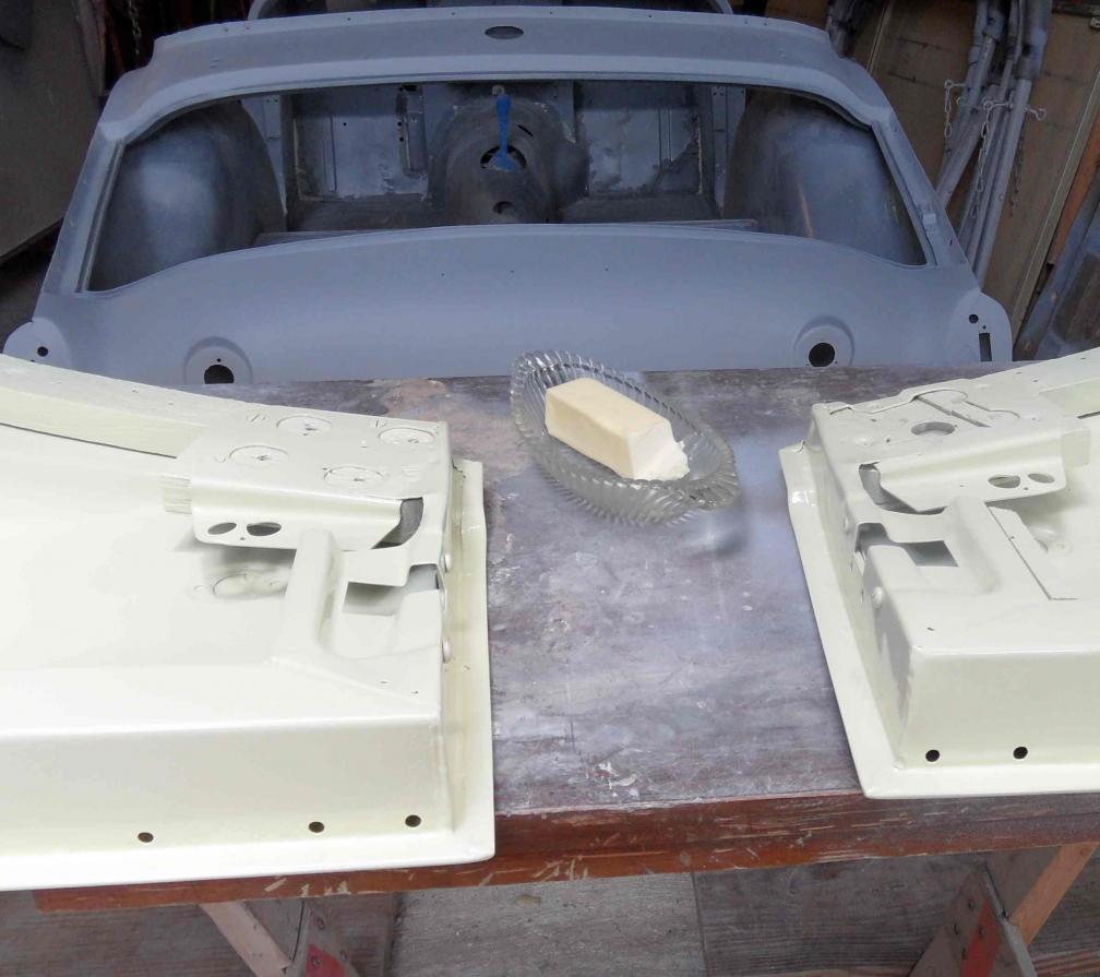

I was teenager when we got our first colored TV set. I had seen The Wizard of Oz many times on our black and white set, but waiting for the half-way point when the color would turn on was exciting. I was reminded of that today when I picked up some color at the paint store. Primrose yellow, or as the mixer called it "butter".

On day two thousand five hundred and three, PPG said 'let there be butter'.
