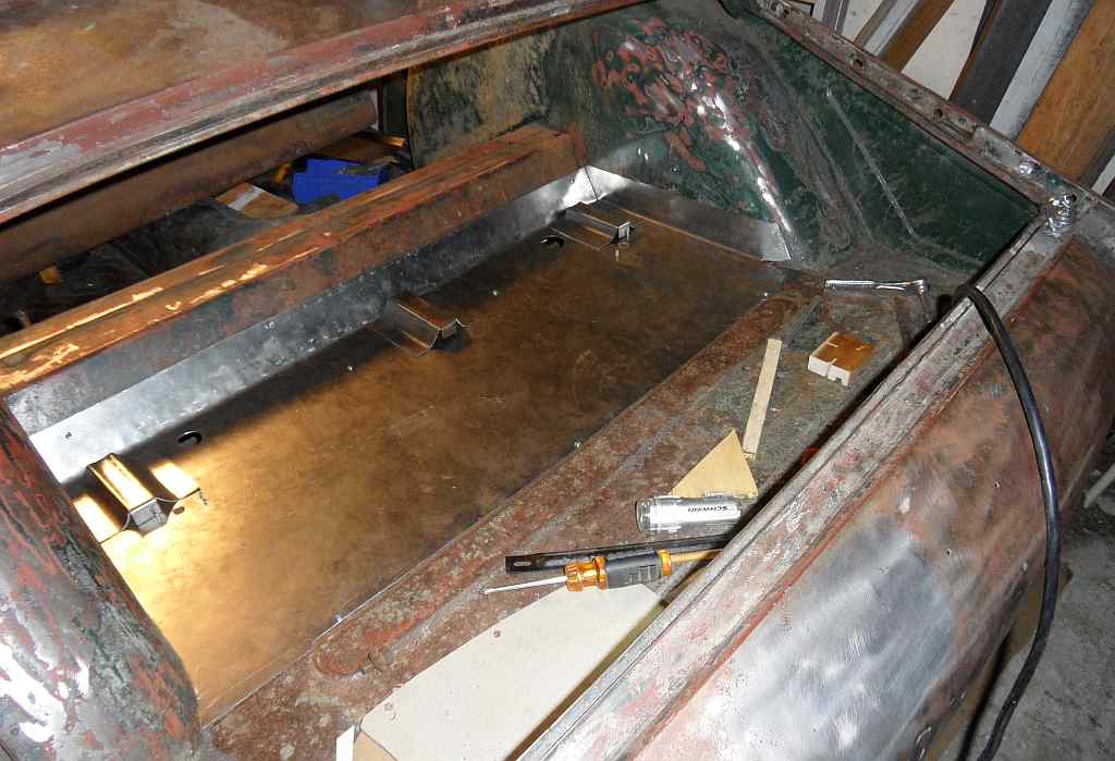

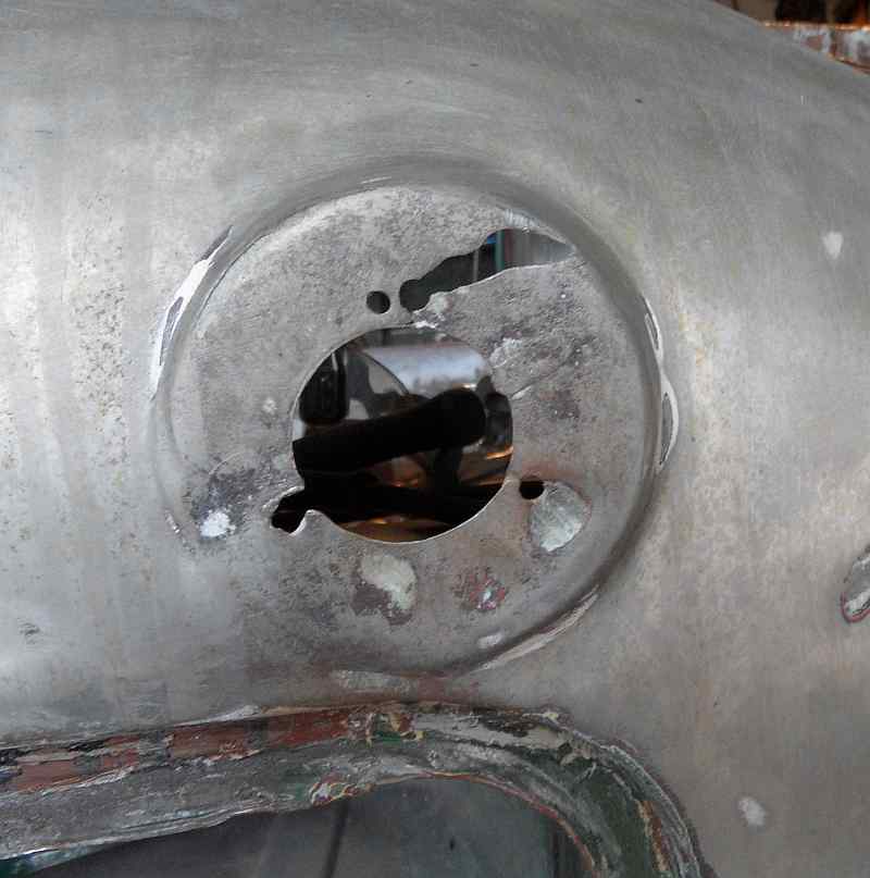

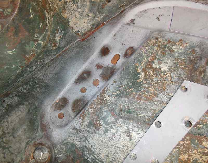

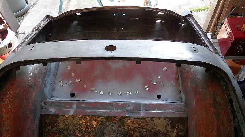

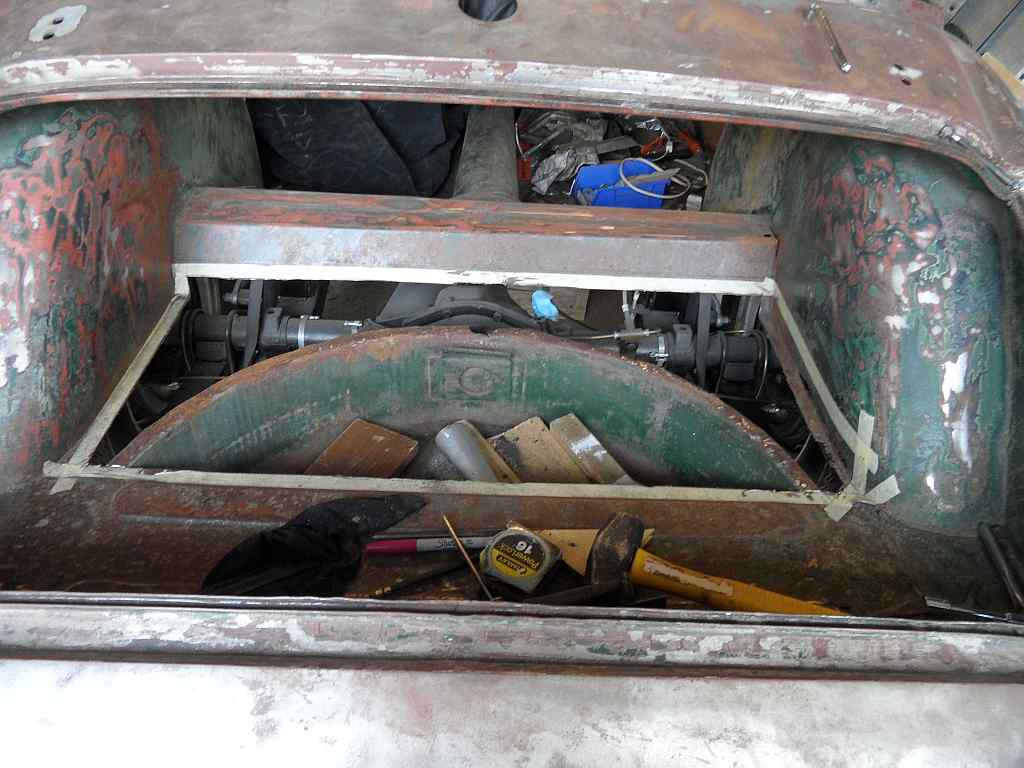

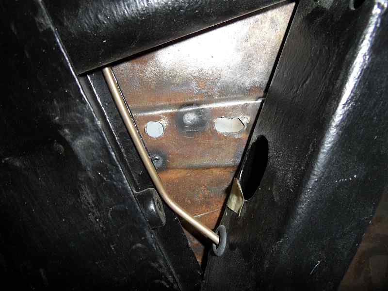

Well, it's been another busy month, unfortunately, no time was spent on the TR3 until this week. I finally tackled the rust holes in the trunk floor and gas tank issue. I decided to use the newer style tank requiring the holes to be in different places. And the shape is different, requiring some brackets to hold the back of the tank above the trunk floor (the front rests on the shelf). I routed new 5/16" steel line to the tank from the union and the rubber coupler fits (barely) as well as the cap and rear seat. I removed 40 spot welds between this section of the trunk floor and the spare tire compartment. I took the brackets with nuts welded (for the tank straps) off the old floor and made another patch. It would have been much easier if I was using the original tank -but a club member gave me a tank that needs a little work, and you know I can't pass up something free from a club member.
One more area to tackle, and I can start welding.

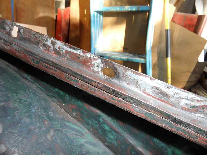

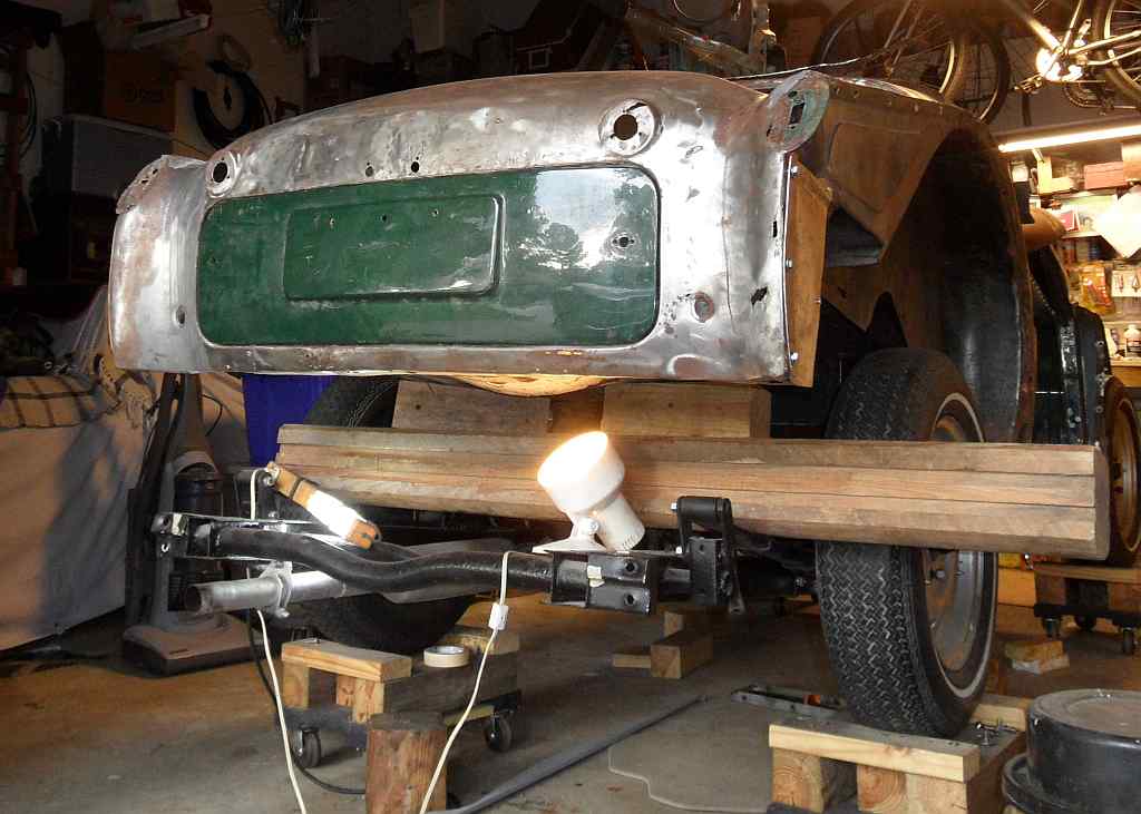

More progress. Last week I lifted the tub off the frame so I could address (to steal a line from Macy's web site) "that little bump from a Buick back in 1964". Actually, I have no idea who, what or when it was bumped. But somwhere in the life line between two shades of BRG, there was a bump. And somewhere a little rust creeped in, so I removed the back side, pounded it out and made a new panel to close it back up solid. My welding lessons will start as soon as my neighbor has time to bring over his MIG and get me started. The tub is back down, bolted solid, and I'll start with the floor patches.
BTW I made some very long (8"-10") alignment rods by threading a little of a 5/16" rod. Once the tub is close, the rods can be inserted into the tub and threaded into the outriggers. It makes line-up a snap.

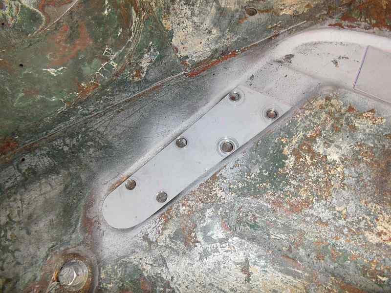

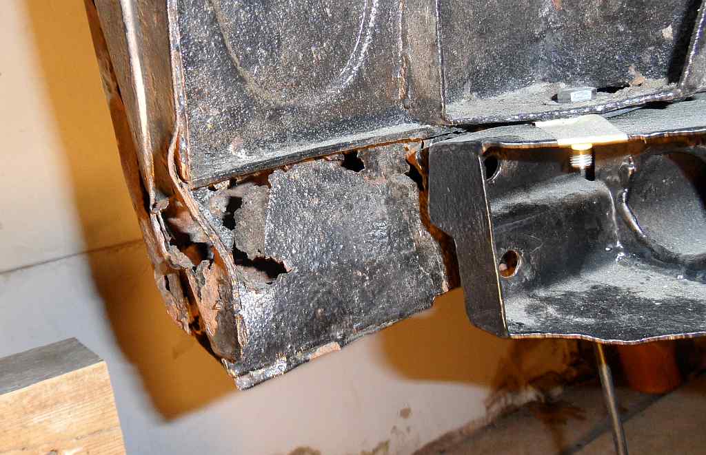

I practiced on a rusted out battery box that I removed and some old steel from a rusted fender. New cleaned steel is easier to weld than rusted steel with paint and filler on it. My neighbor has been patient and kept saying, if you don't like the weld, grind it off, and do it again. At this point, I'm just trying to patch up the floor and make it solid. I have a small sheet of copper under the floor (above the frame) where I'm welding. This is the 3rd patch I welded, so it's good enough to share. The underside shows the welds should be solid.
I have a lot more welding to do... nowhere near 1/2 done.

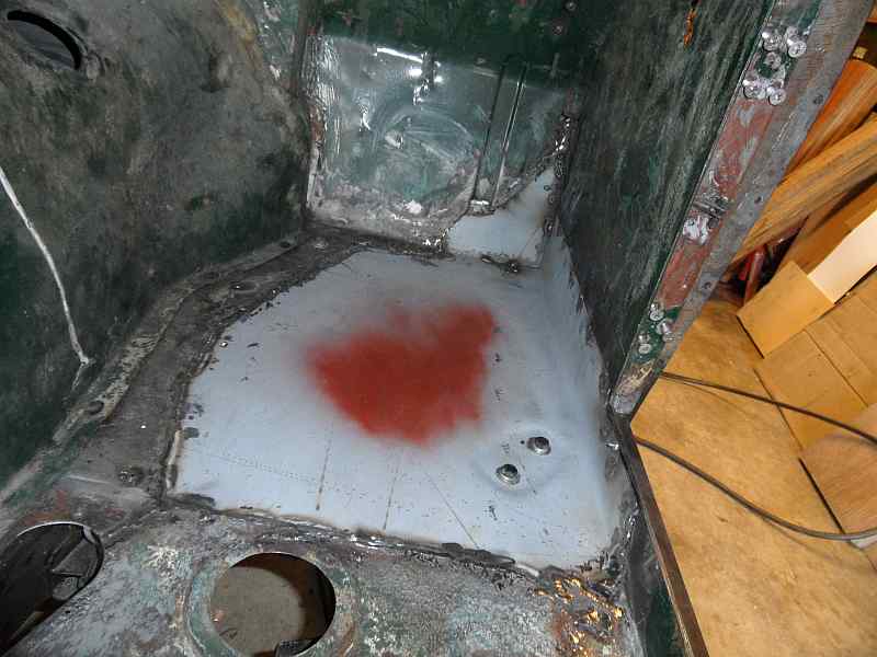

I did some more welding this weekend, and half way to a decent weld with half as much grinding. I'm getting the feel for it and at the same time completing some ugly welds that after a little seam sealer, a little heat/sound deadner, some padded carpet and a thick floor mat, and you'll never know it was patched.

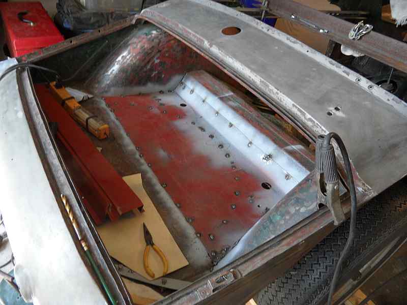

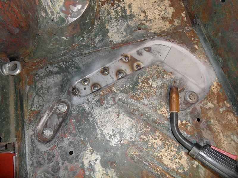

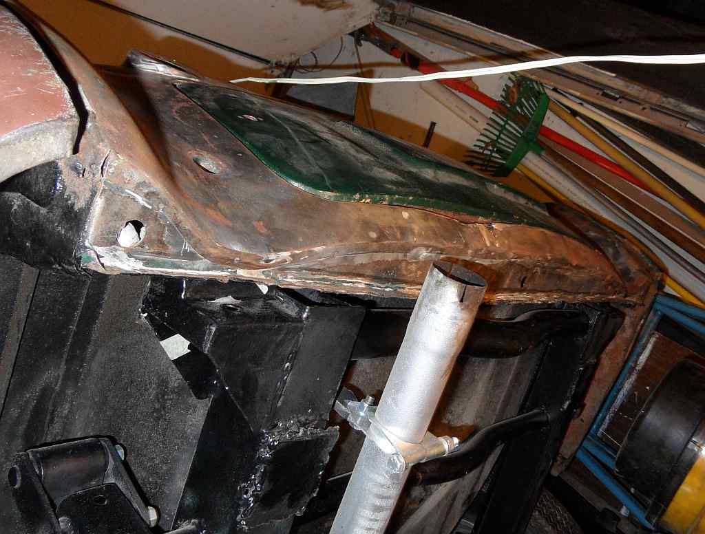

I've used about 40 cut-off wheels, but there's almost no sign of wear on the grind disc. My harbor freight 4" angle grinder has held up well -but occasionally it gets so warm I have to shut it off to cool down. Yesterday I shattered a weld-cutter drill bit after I failed to keep the panels tight, and welded them to stay apart. It was difficult to straighten that out. If drilling a hole to allow welding a panel to the panel under it is called plug welding, then I'd like to put in a plug for that, over seam/butt welding.
Is it just me, or is my trunk smiling at me...

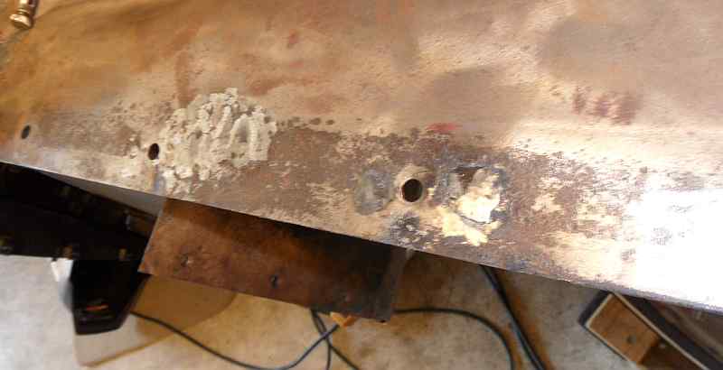

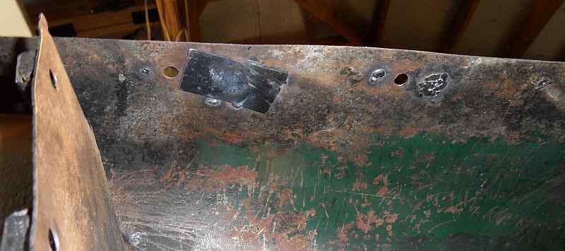

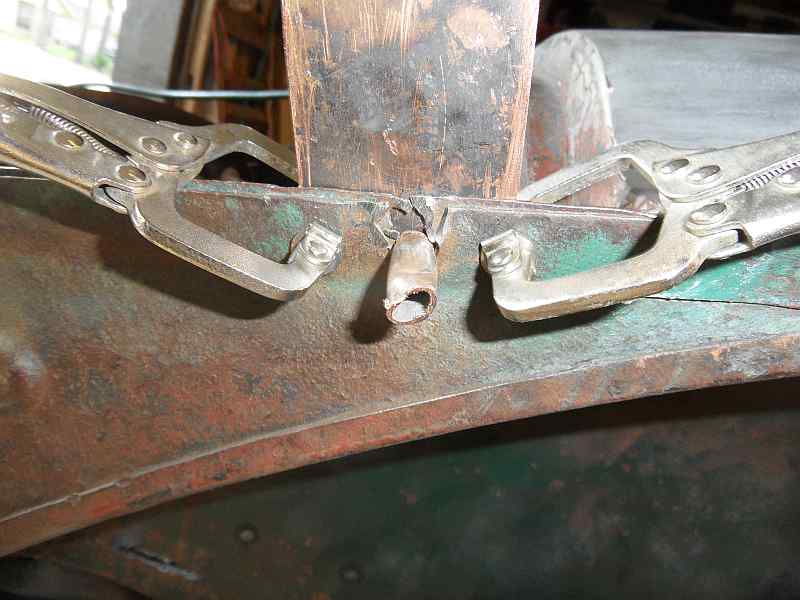

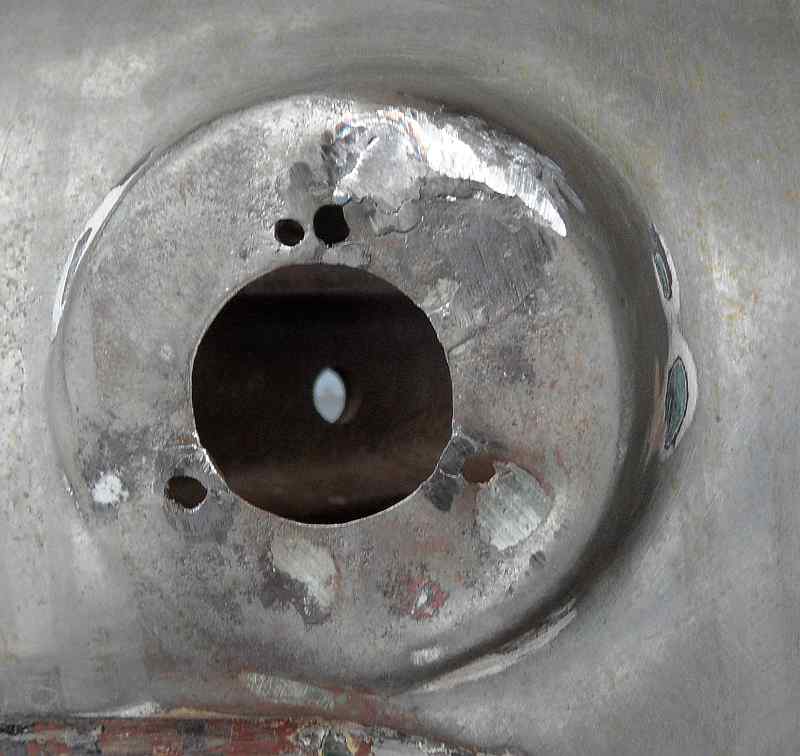

Lawyers and doctors practice. I may still be practicing, but my welds are good to go. I tried a few trickier welds today that involved rusted and/or thin metal. Tush had a great suggestion, and I used a length of copper pipe bent so it sat against the inside of the holes I was trying to weld shut. Aside from shedding some heat, the weld will not stick to it, but the weld-wire will still arc when it hits it (instead of just disappearing into the hole).
I'm not sure if I am practicing welding, or grinding. Thin metal can be a challange.

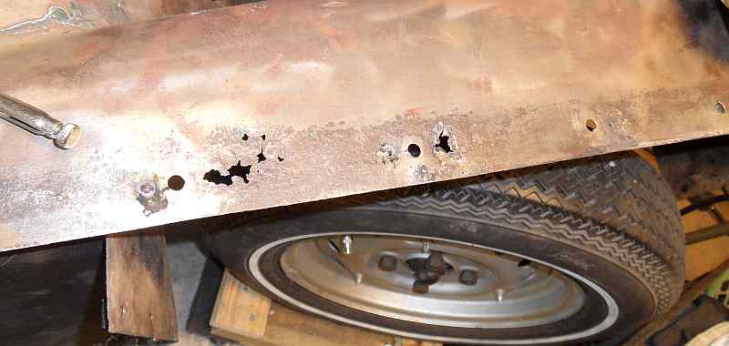

I failed a welding quiz this morning. I couldn't get a weld to work no matter how I tried. Cold, spitting, no flow, etc... Luckily I had a lunch appointment, and when I shut down everything, I found I hadn't turned the gas on.

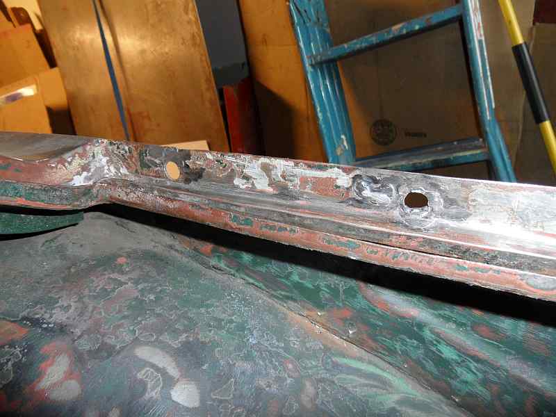

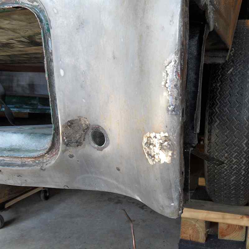

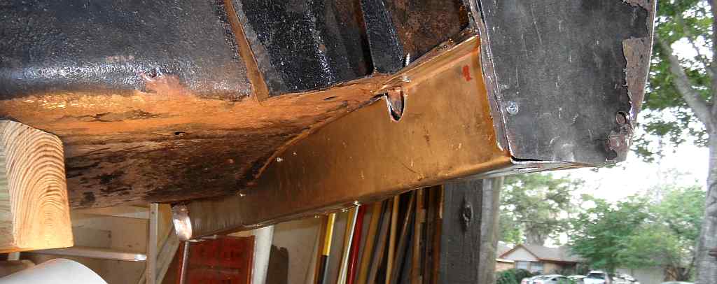

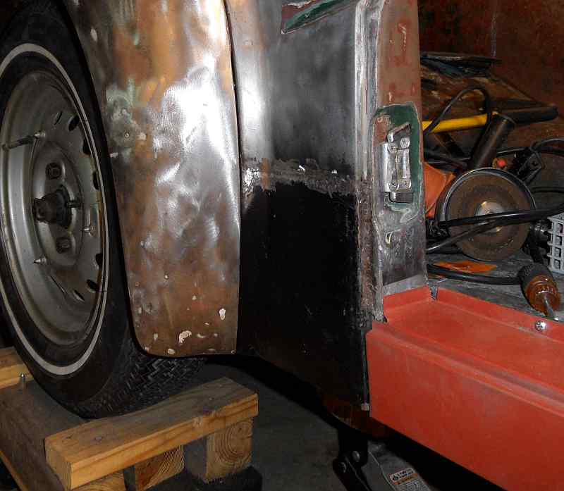

But this afternoon I passed my first real test. I wleded in my dog-leg patch. It's seam welded solid to the section above it, and inside the door jam (and tacked to the fender patch as well as to the inner sill on the under side). I purchased a new dremel today to help with the grinding in tight places. I wish I'd have done that sooner.
Yesterday I used the copper pipe trick to fix the holes inside the trunk that take screws to hold on the rear fender. My holes were so messed up, the screws couldn't be positioned properly to align the fender correctly. Now that fender fits like it was made to.
