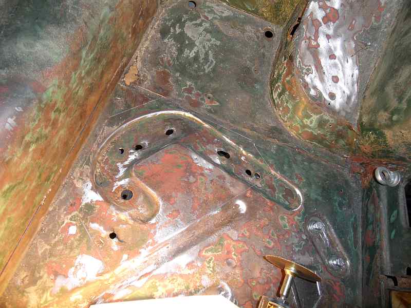

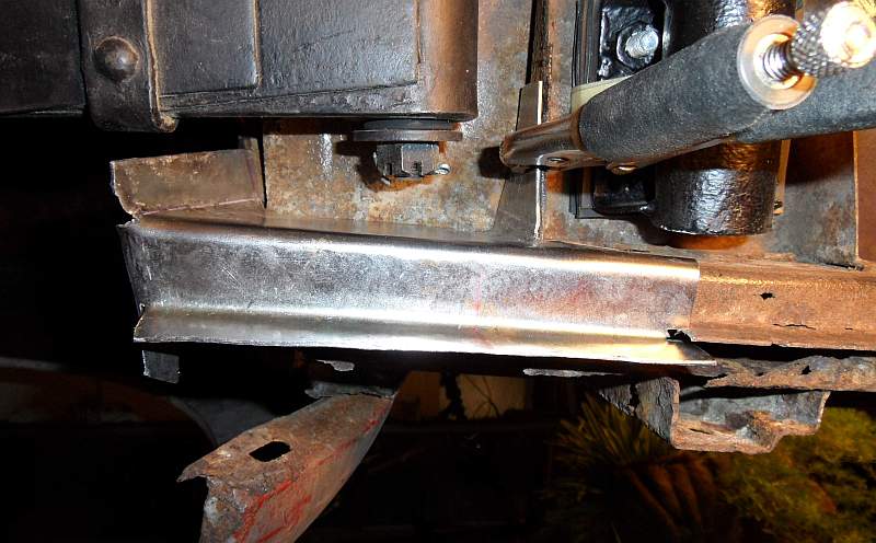

I’m working backwards in that I started by fitting the outer rocker panels and dog leg patches, (after fitting the doors and fenders) then fitted a patch for the outside of the inner sill. Today I made the inside of the inner sill patch and finally an inside fender well patch including the rear fender lower captive nut. They will have to be welded in place by a different order. My welding lessons haven’t started yet, but I want to have as much ready as possible before welding begins.

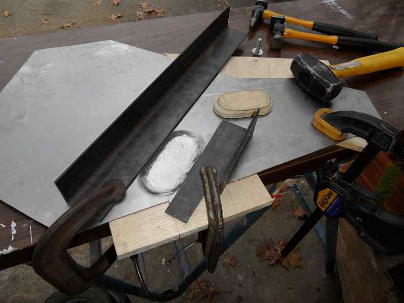

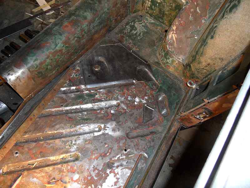

And though the holes were small, I saw no need to count them all. The ‘double dimples’ in the front of the floor pan were pressed into it when it was stamped out. They allow the pan to be bolted to the inner sills just above the frame rail. As my 2nd picture shows, I didn’t have much metal left in this area. I also don’t have a 10 ton press in my garage, but I do have a 10lb hammer and can cut plywood into a die set that might work to make some patches. My neighbor loaned me his hand brake that bends a little welding lip onto the edge and also helps keep the metal straight. I drilled 3 small holes for #6 screws and nuts, just to be sure it stays in position when I pull off the tub and weld it from the bottom side. Even without welding, the 18 gauge patch makes for a much more solid floor than I had.

How did you form the "dimple" in the floor patch? Was it just by hammring on the wood form until you got the shape?
In this pic:
https://www.britishcarforum.com/bcforum/u...utCagePatch.jpg
it looks like you might need to cut back the metal a bit further above the patch, otherwise when you are welding you will just be burning through the metal/rust. When you are welding you want to weld to solid metal.
Pretty much. I thought I'd be able to hammer on the wooden insert with the metal atop the wooden cut-out, but it turned out to be simplier to just use body hammers with the cut-out under it. I also flipped it over and hammered from the bottom side with the insert laying under the forming dimple. It took a few strikes, but it came out OK. It's functional, and not normal for anyone to look at the pans. The wooden cut-out was larger than than the insert by about half an inch with all edges beveled.
Thanks for the note on the rust. I think I'm back far into good metal, but I'll check it again when I clean it up prior to welding. -That was one of the simplier patches.

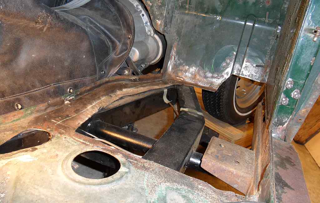

Without trying to explain "how or why", this access hole for the shock on earlier cars is obviously in the wrong place. I know I can make a mountain out of a mole hill, but sometimes Mohammid must go to the mountain. In this case, I just wanted to move the hole. -It may not seem like much progress, but if I ever need to remove that shock, this was required or the body would have to come off in order to remove that bolt...
