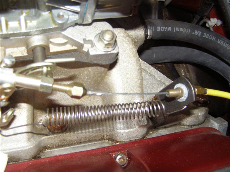

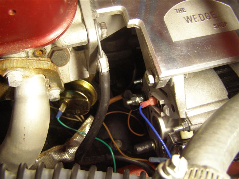

Pics below. The ground cable that I show pointing up was not there as it is in the picture. It was tucked down below the alternator, so I could not see the end of the unattached cable, or this would not have happened.
You can see how the throttle linkage is pulled back because the cable is melted internally to it's housing at the firewall.
