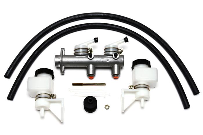

My dual brake system works terrific, very happy with its performance still. Here's Wilwood Master Cylinder I installed.

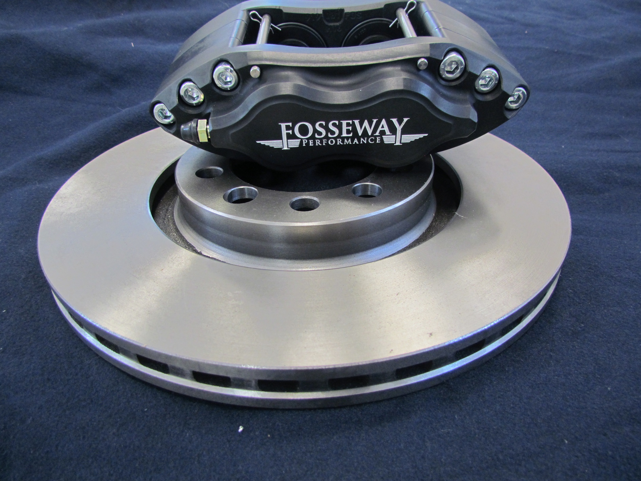

I'm using the Fosseway Performance 4 piston calipers.... which have 30% more piston area than my original BJ7's. So, I'm needing to factor that into the whole process. The rears are, at this point, still drums, albeit they have been radius match to maximize performance. Of course, I'll need to use a balance valve to get the correct front/rear pressures regardless of what is pushing them.

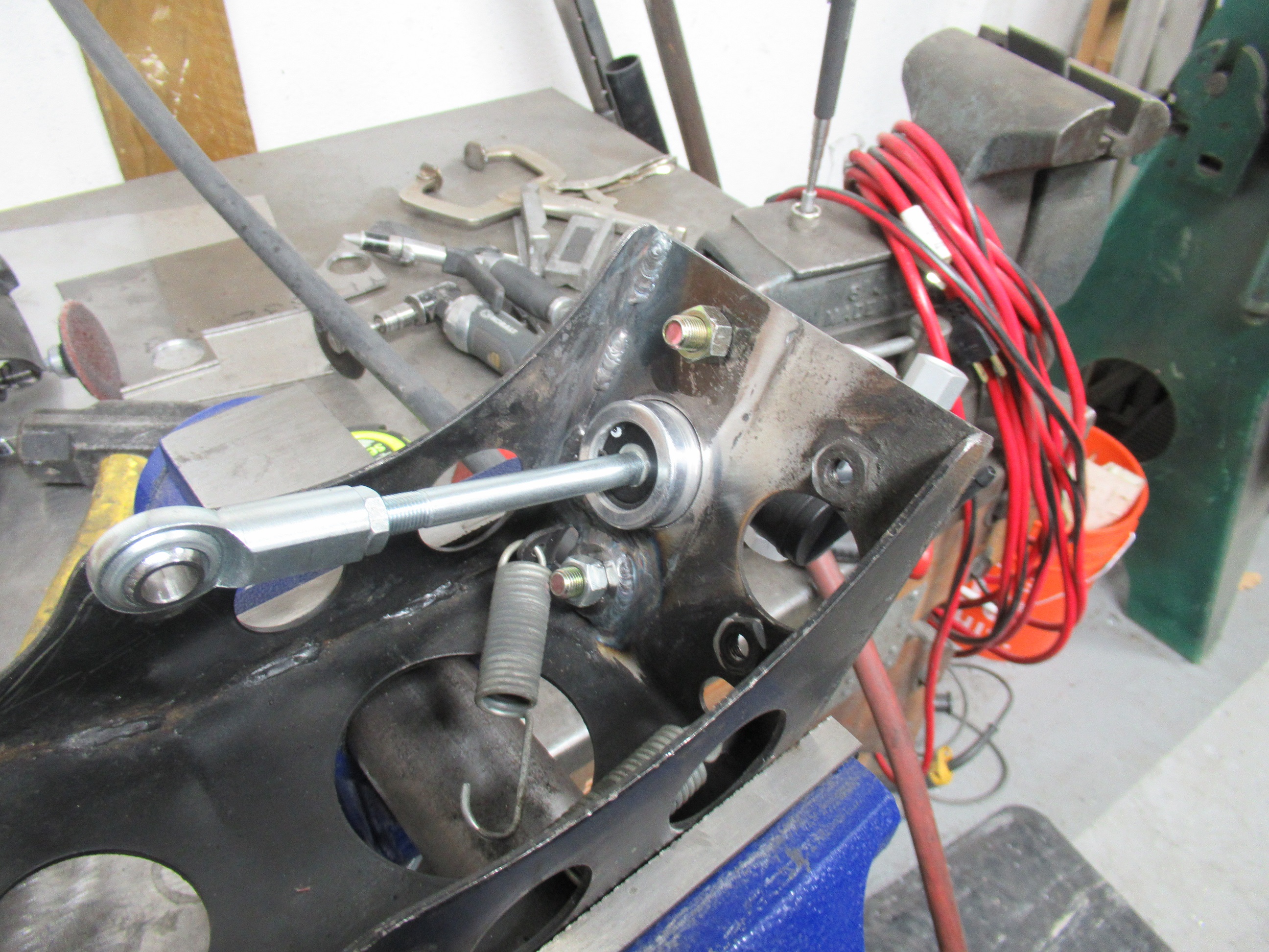

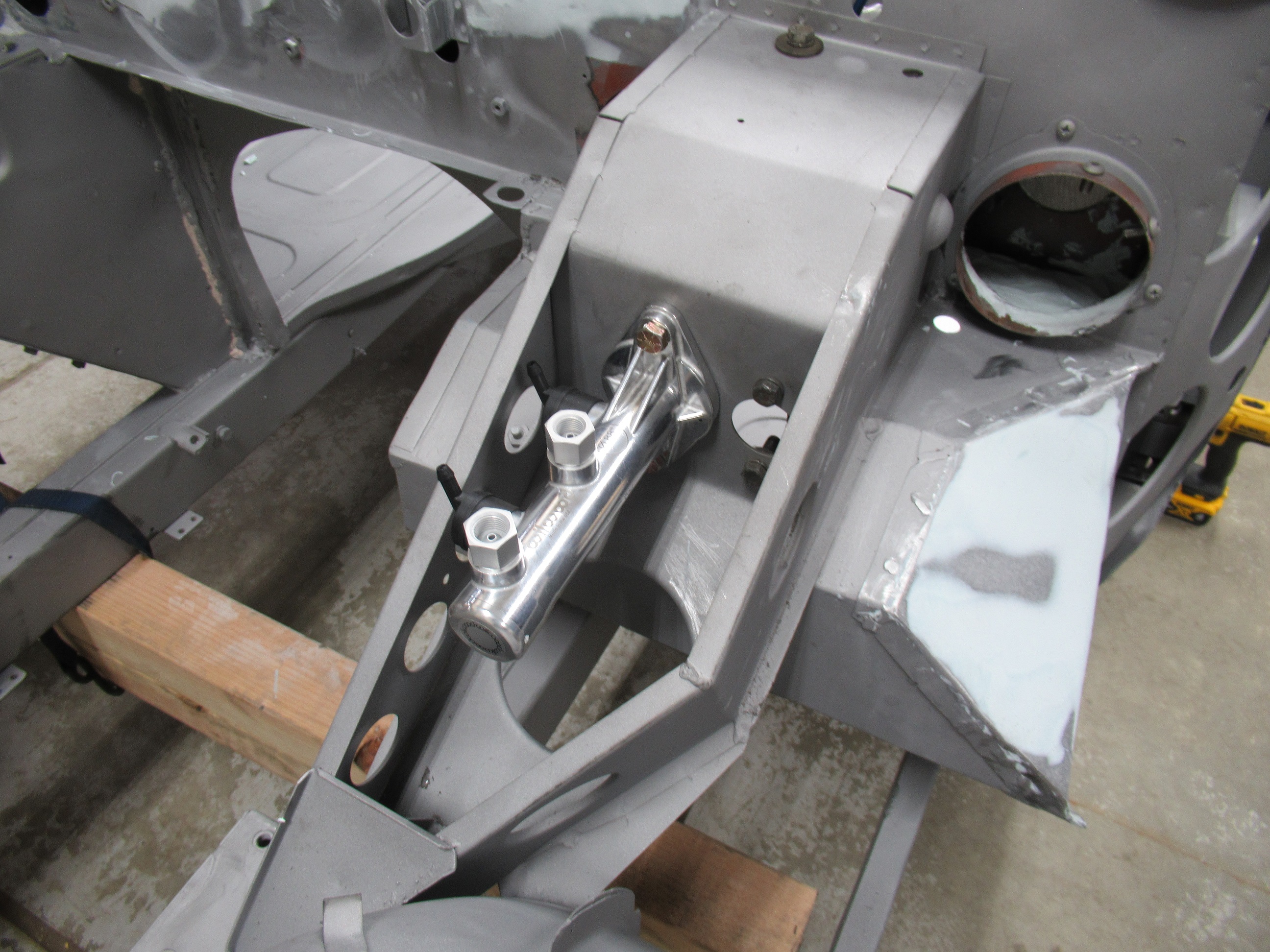

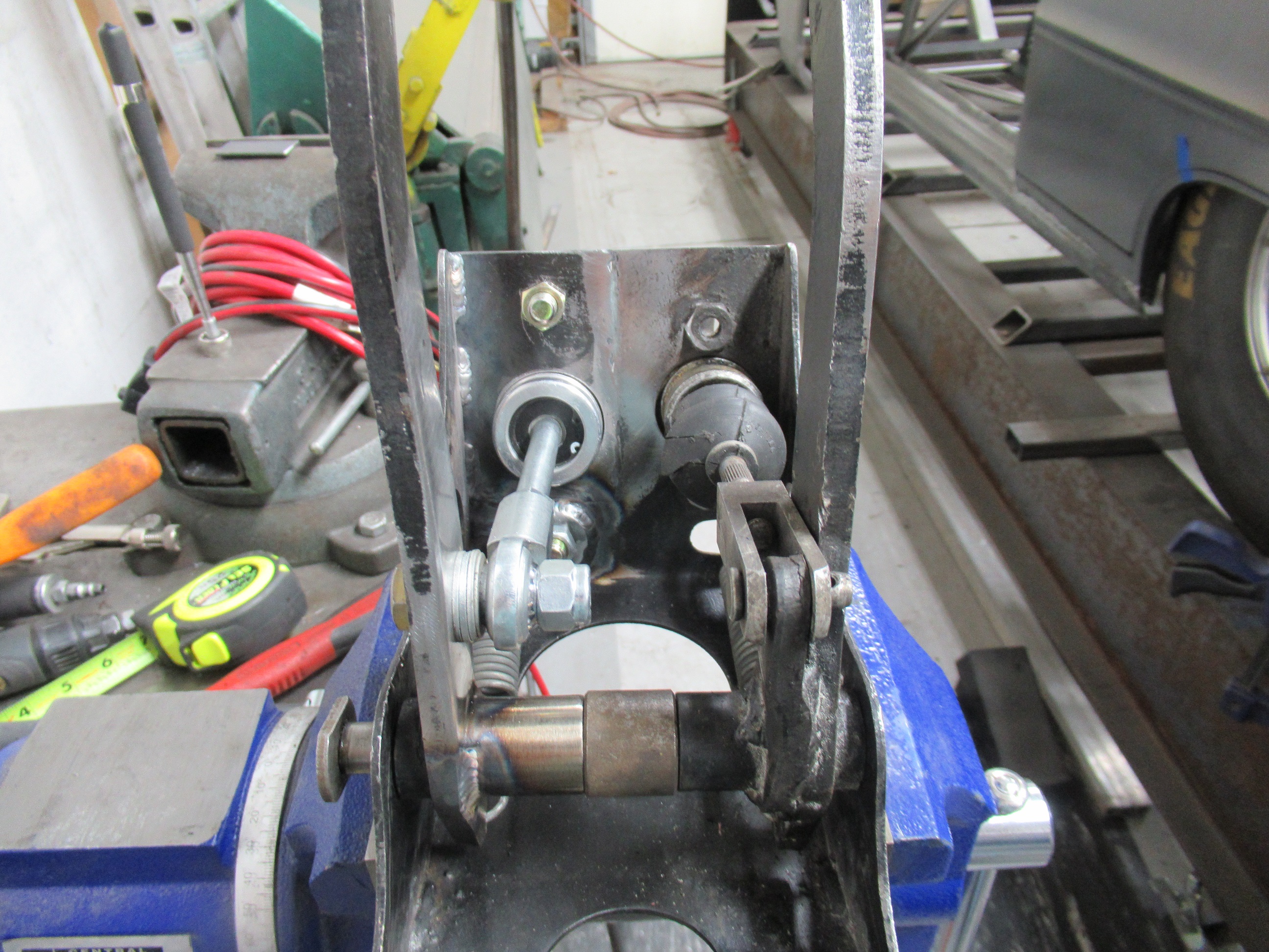

Initial installation of my Wilwood dual master cylinder (they call it a "tandem") was completed last Friday. As you may have guessed it wasn't a simple bolt on. After conversations with Wilwood guys I learned that my Healey pedal ratio (3.83) was not a good match for the Wilwood dual master cylinder. Based on the Fosseway 4-piston caliper size that I'll be using, their recommendation was Wilwood's 260-14241 (7/8") unit. They told me that a more acceptable pedal ratio was in the 6 to 7:1 range. So, that's what I've done.... changed the pedal ratio... which also required repositioning of the master cylinder. There's more to do, but where it's mounted now gives me a pedal ratio of 6.64 and allows full travel of the pushrod in the MC (important for safety).
