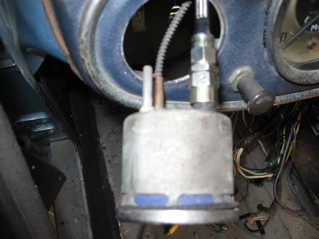

If you want a nicer and more permanent solution (for a little more money) consider ordering a braided oil line kit like that shown above in HealyRick's post. These typically sell for around $30 if you order online from a supplier like Summit or Jegs. These kits are heavier duty and should not be subject to fatigue. I'm posting a link to one such kit, other lengths are available. Summit also sells similar kits by Longacre. To select the right length, run a heavy string from the gauge along the path to the pressure port on the engine. Measure that string to determine the closest length kit available.
https://www.summitracing.com/parts/aaf-all46110-60
I like the braided oil line kits if you don't mind spending a little more. Look carefully at the contents of the kit. As shown in the link I posted above, make sure the kit includes a male fitting with male threads you can screw into the engine block and a male fitting with female pipe threads for the back of the gauge. You want the hose itself to have female fittings on each end so during engine or dash service you can easily unscrew both/either end of the hose. Some hose kits will instead of a hose end with male pipe threads. Those are much harder to deal with.

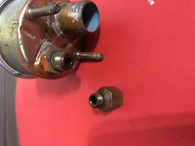

I just pulled out the SW gauge, it had a fitting on it already. Doesn’t this look like what I need?? Of course I don’t have the dual gauge now, it’s at the shop that’s modifying my aluminum radiator.
Yes, but.... What you do not have (at least not shown in the picture) is the tubing itself, the compression ferule, and the ferule nut.
I already have the line set up that is connected to the engine. This is a running car and I’m just replacing the SW gauge a previous owner installed. steveg this gauge is going to be connected to a Chevy 350, I wasn’t sure if this would be a simple replacement or if it will need adapters to be able for it to work.
I had some free time to install the gauge today, the adapter from the SW gauge worked with no issues. Thanks for all the info.
