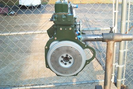

Drew's new baby

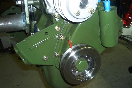

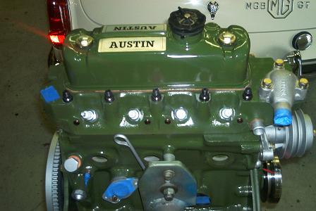

Here ya go
Hap Waldrop
I'm sure a few of you will notice the lack of freeze plugs, the side mount stand kinda gets in the way of that, I normally put those in after it comes off the stand. Oh nad stating that gave a chance to snaeak another pic in :smile:

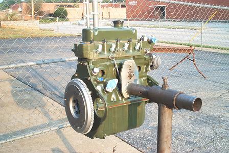

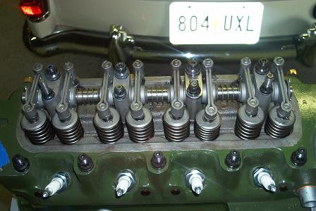

Here's a run down of what Drews engine is. The whole idea is to give Drew a torque monster, well compared to the 948 he was accustom to, something that will get him up thoise mountains he like to go riding in.
Ported, polished head w. new hardened exhaust seats, and reworked bronze guide for the ported heads, new springs, Drew'd valve were in nice shape so we reusued them.
9.78 to 1 compression, dreww was alittle concerned about pushing it to 10.0 to 1, so we used the AE 21253 piston which have a higher compression height, then all we had to do to the head, deck wise, was skim cut. I used the APT VP266 cam, and APT chiolled iron lifters, the VP266 is a nice lift increase, but still a good torquey cam that will idle nice for Drew. ARP hardware was used through out, head studs, rods bolts and flywheel bolts. Everything is balanced and blueprinted. Tri metal bearing, Rollmaster vernier timing gear set, Romac harmonic balancer, Payen gaskets, all new grade 8 hardware used where ARP is not used. Overall this motor theme is to be real torquey, and pull the mountains good, this motor should pull like a little tractor form 3 to 5K rpm, and still be capable of running up to 6K without wimper. It cosmeticly is intended to look like a sleeper, not that we will fool anyone with a 1275 and HS2 carbs in Buyeye, but the plan is to make it look like it belongs under the bonnet of a Bugeye.

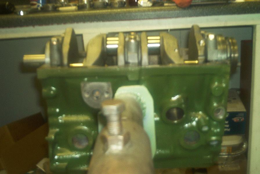

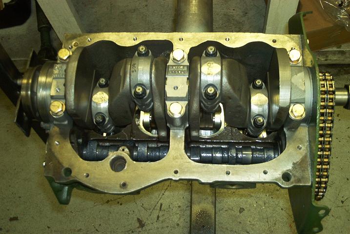

Hap Waldrop
anoother one once the rods and cam are installed

jlaird
Lovely, I do note however that it has a stock weight flywheel?

Hap Waldrop
Yep, we didn't go the aluminum flywheel route, or even the lighten flywheel route they rev up fine they way they are, like I stated before it's all about torque. Drew can add a aluminum flywheel to it if like, Britsh Parts Northwest has really good pricing on them,but all it does it make the engine a little more revvy, the goal here is to get Drew to top of those mountains, where his tired 948 struggled with. This engine will seem like a tractor compared to what Drew was used to.
Drew, I thinking you said you were doing this, but a 3.9 diff will be the way to go now that you have way more torque.
