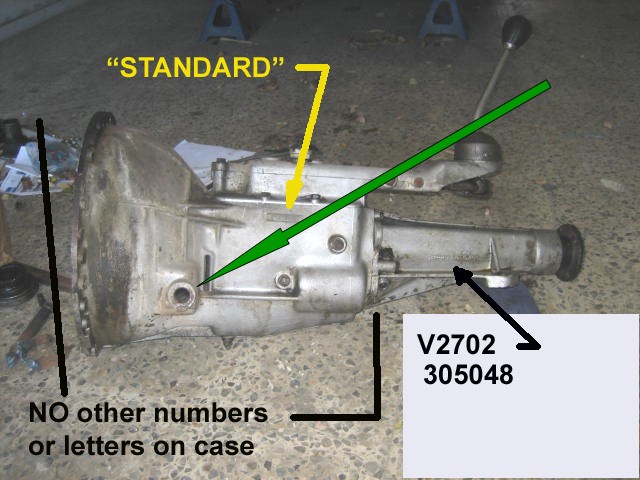

Peter,
I have the tranny turned this way and that
and even upside down. I have posted and photoed
ALL the ID numbers I could locate.
Here is another photo of the tranny
with location of IDs I found.
thanks, Dale

Dale,
The commission number is stamped on the clutch shaft boss as indicated by the green arrow.
Ray

PeterK
Dale, the "stamped" number is usually very light and hard to see, especially if dirty. The casting numbers (red arrows) are very visible. Look for a machined flat and the number is stamped on it, same as the number plate in the engine compartment.

Peter,
Thanks for the advice, I'll try to look closer.
Sadly, there is no number plate in the engine
compartment. Just an empty hole in the wheel
well where a plate once was.
No number on the differential that anyone
could see either. We looked close with the diff
out of the car and cleaned up nice.
Plainly stamped on the engine block tab is
CC4195E which I am pretty certain is a TR250 engine No.
I was hoping the tranny might be original so I could
identify a "real" manufacture number. Looks like
I am out of luck there as well.
dale

Alan et al:
I went over to the Crypt this morning and cleaned
off the tranny area where the ID number should be.
Whoa!! I found a number etched.
CD5909
Also, on top of the tranny is some type of
switch with two cut wires coming out of it.
What were (are) they?
My engine No is CC4195E

Thanks Ray,
Heading out to a custom fastener store
to pick up some SAE #8s to replace the
DPO's K-mart junk.
I have one Moss bushing with a slot,
part No. 330-230.
Can anyone identify my tranny yet?
and is this bushing correct and I need to
order one more?
BTW. There is only one existing shaft bushing
in the tranny housing. No wonder things got screwed up.
I.m looking for what model and year my tranny is.
thanks,
D

Harry,
No mistake, I cleaned and looked very close.
I Googled the CD5909 and came up with 1968 TR250
The engine CC4195E is clearly TR250 block.
I am going to bite the big bullet and take the TR6
clutch shaft to the machine shop and have it machined
into a TR250 shaft as close as possible.
I will also have the taper pin thru drilled and a
second thru drill and fasten the fork as recommended
by most.

Here is a side by side photo with
Alan's TR4 gearbox cut and pasted for
reference. I stood the tranny on the
wide end to see if the grooved shaft
protruded.
It DID NOT....
but I made a huge oil mess on the floor.
So, since the engine block is without doubt CC4195E
a TR250; is the tranny also a 250 and thus properly
matched?
Everything seemed to fit together well when
I took it apart. My only real issue is the new clutch
fork bar has no groove in the end, but the one I removed
did have the groove to hold it in place with a thru-bolt.
Thanks as always--Dale 83* sunny Bayamon, PR
