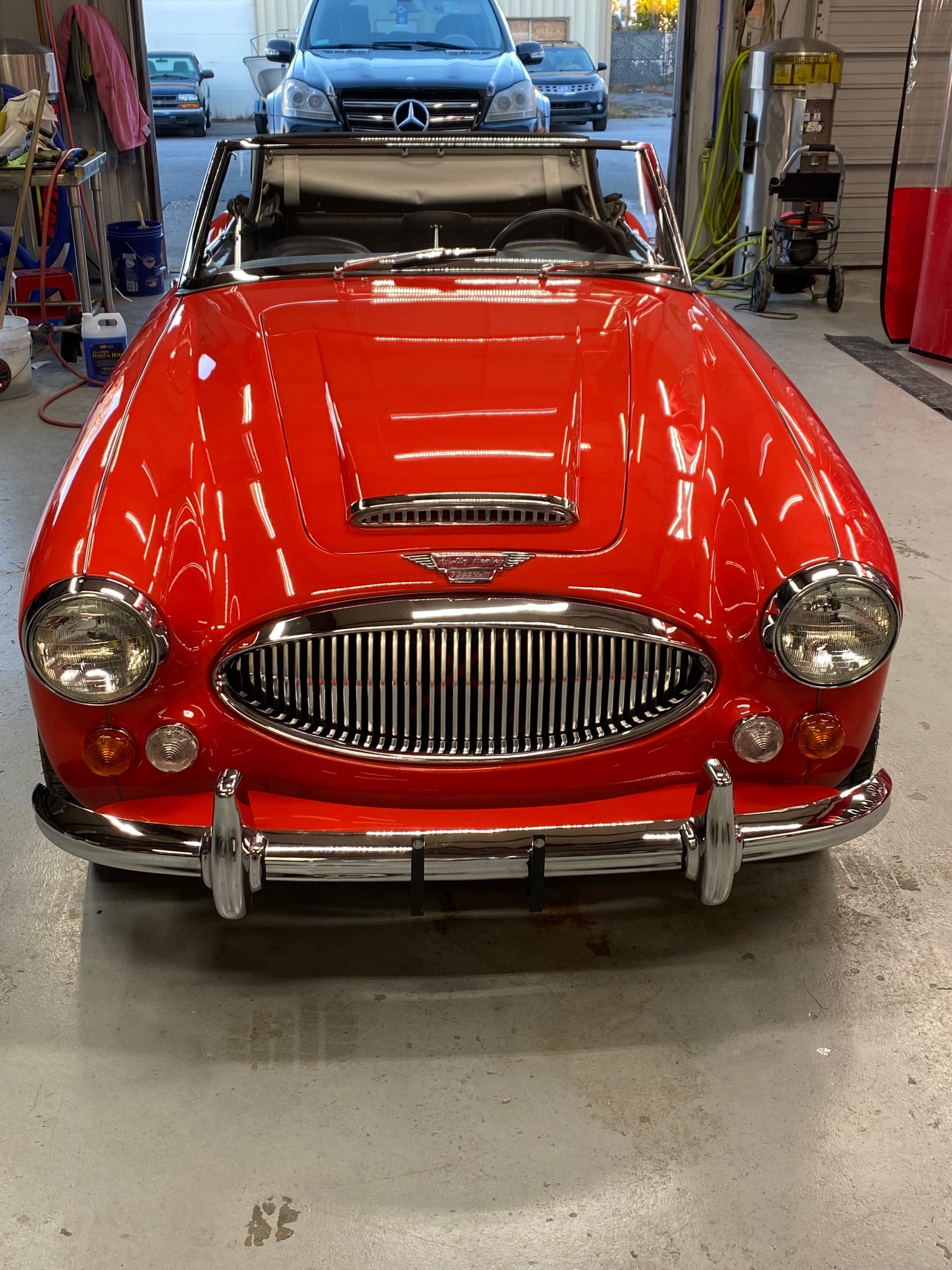

Hello there. I have been fortunate enough to be invited to exhibit my '66 AH 3000 BJ8 at the Hilton Head Concours d'Elegance in November and wondering if you have suggestions on what to bring with me, besides chairs and other "comfort" items. Tools? Cleaners/ etc, etc. Thanks

I met the chief judge for Hilton Head last weekend, Gerald Greenfield. He was here in Portland and was assigned as my assistant in judging class Q-1 in the Forest Grove Concours. Very nice guy. I asked him if he needed any more judges for Hilton Head and he said he'd work me in (could be as a clipboard holder...).
Anyway, I'd bring your preferred brand of Speed Shine/Quick Detailer and couple of appropriate micro-fiber cloths. A battery-operated vacuum can come in handy for the carpets, or maybe just a good lint brush for that final carpet grooming. Wide masking tape, wrapped around your palm, sticky side out, also makes a good, quick carpet cleaner. Beyond that there shouldn't be any cleaning/detailing needs that you didn't take care of before you left home.
For documentation, a BMIHT certificate is a nice touch, although most concours judges won't know what it is, but introduce it as the car's "birth certificate" from the British Motor Museum and it lends a certain air that you have a deep appreciation for your car; i.e., you cared enough to obtain the certificate (and if you don't have it, there's still plenty of time to get one, and you can order them online).
A binder with restoration photos and receipts is nice to show with the car. The judges won't have time to peruse it, and some of them may not care at all, but generally it also serves as a testament to your seriousness and your appreciation of the car you're showing. It says, "I didn't buy it this way, and I've been through the mill and sweat blood getting it to this point."
Remember that little things are tie-breakers in elite concours judging, so step back and look for flaws that can be addressed (or hidden!), and of course cleanliness is paramount. Not only does it reflect on the car, but it also reflects on the owner and says that you really care and you consider the judges' work and the event important. When they introduce themselves, thank them for their work and tell them you are honored that your car was accepted for this wonderful event.
