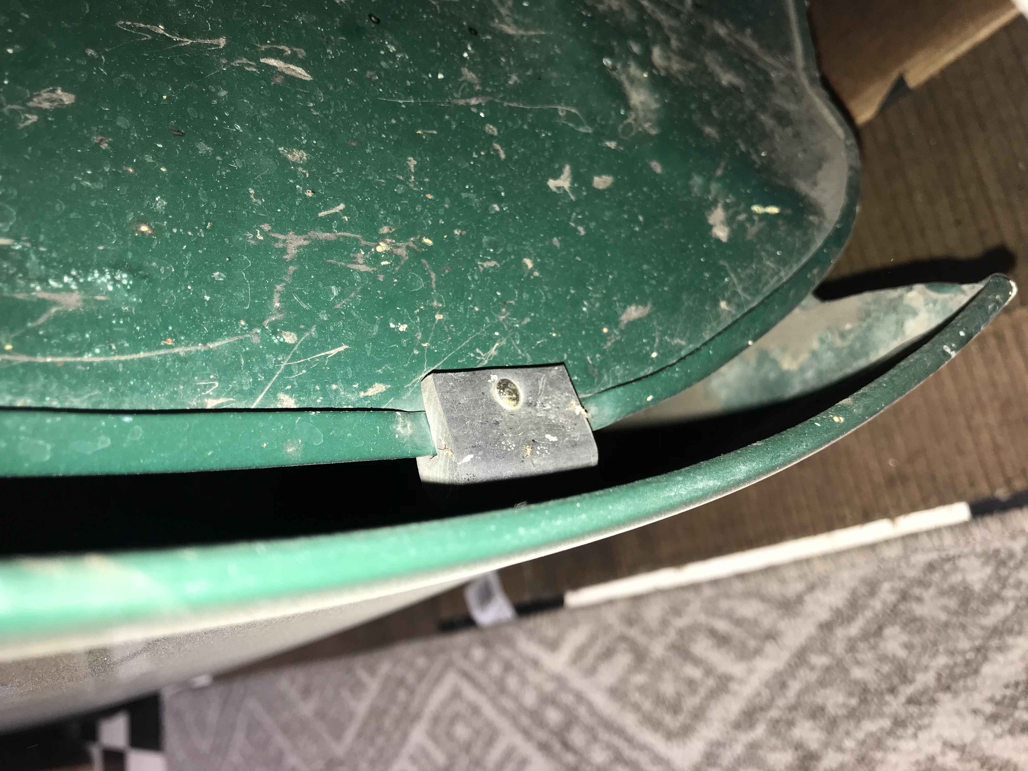

8. The Guidelines refer to two rubber buffers fastened with split rivets and washers, attached to the outer rear edge of each of the front inner wheel arches. I looked there and cant fathom what and where. Any help?
These buffers are the same as the ones for the hood (bonnet). You’ll see a couple of holes on the inner wheelarch panel. One is about 3” from the boom [I suspect he meant "bottom"] and the other about 9” above that. They’re meant to keep the fender from hitting the inner wheelarch. They were installed before the car was painted, so they get painted.
