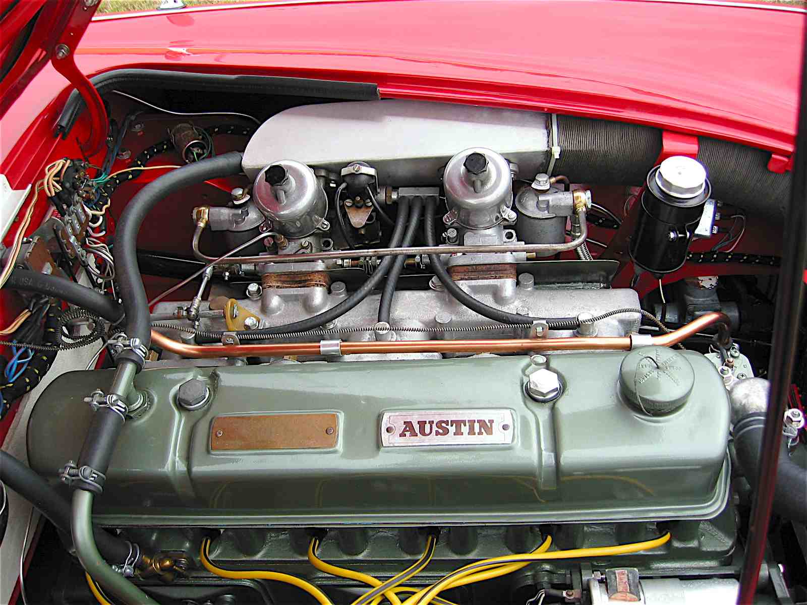

Willy,
I don't know who this car belongs to, but I took this photo at the Conclave in Winston-Salem. I was impressed with design and workmanship
Lin Rose

For a Healey, if you can’t have both, I’d prefer the cold air going to the driver instead of the carbs. Looks like the photo in Lin’s post sacrifices comfort for a couple of ponies. Then again, I live in a warmer climate.

Hello Lin, that was a nice setup for the SU's although we don't know if it had a filter in there. Regards, BUNDYRUM.
