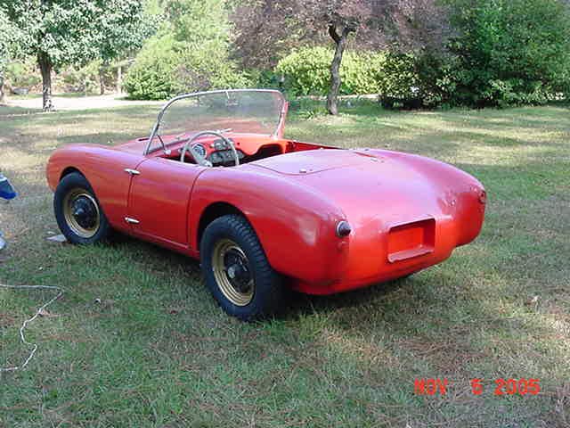

I have a Berkeley that the PO put a Honda 360 motorcycle engine in. He did keep the original 2 stroke twin engine and gave it to me when I bought the car. Can you post a photo of yours? I have heard that a guy put a Honda 400 4 cylinder in his Berkeley but had overheating problems as well as other issues. I think I am going to fix a few small problems on mine and sell it if you know anyone looking for one. I have too many projects! Good luck, Eric

Is that engine a 2 or four cylinder?? What model? From your picture it appears to fit under the bonnet OK.
Kurt.
EricG
It is a twin cylinder 4 stroke engine from a Honda 360 motorcycle made in the late 70's. It fits well but the hood had to have a small "power bulge" molded into the leading edge to clear the top of the head.
