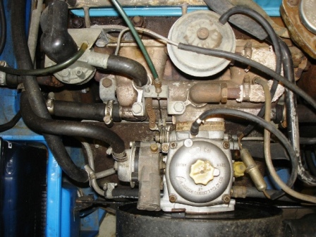

Here's a photo of what a CA smogged Spitfire ought to look like... gives you some idea of what you need. The airpump, charcoal canisters and anti-run on valve are out of view.
