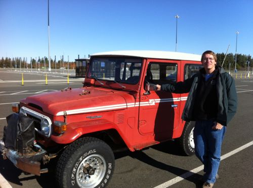

Okay, this isn't on a LBC (LJT actually -- '76 Land Cruiser) but I need to try and see what I can do to resurrect some badly oxidized paint. It's pretty chalky and faded over most of the exterior. I'm pretty sure it's the original paint. I've never dealt with paint work before, but I'd like to try what I can to bring some shine back -- and make it look a bit less pink.
Ideas?

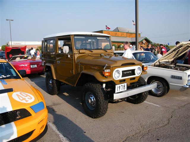

Here's a beauty that showed up at the Sept. Coffee and Cars in OKC. Hope yours comes out as nice.

I'm sure it's been neglected for some time. I'll give it a go anyways and see if I can make at least a bit of improvement. It's a truck after all, so it doesn't need to look that pretty.
That's a nice looking truck. Don' think mine will ever look that clean, though I do have a set of those original style wheels being powder coated right now. Love the stock look with the hubcaps
