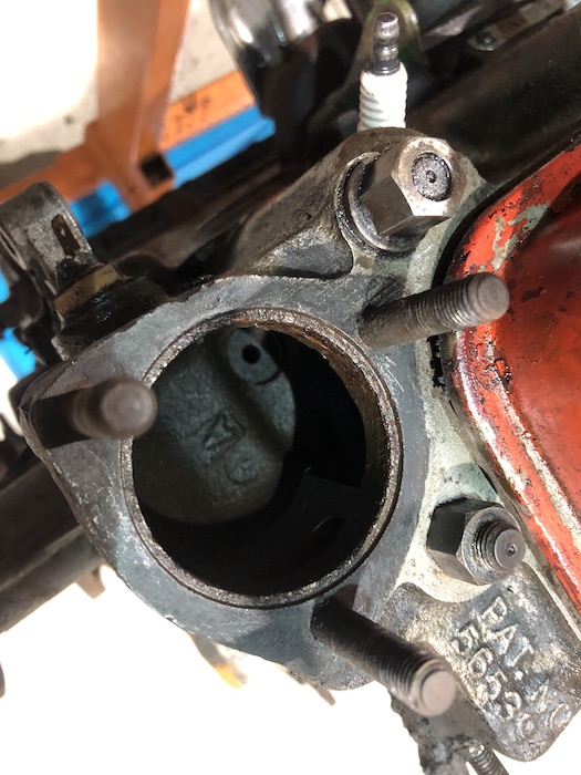

Made some good progress last night. Unboxed my parts order (missing one radiator hose, have to call supplier on Monday) but otherwise in good shape. Got down to business and worked on cleaning up the engine a little bit, pulling off external parts like distributor, oil filter housing (I'm converting to the inverted type so the filter won't hit the steering column), etc. Did a bit of degreasing but didn't go overboard with it. Scraped off the worse of the grease.
With things sorta clean I wanted to at least get one new item started so I decided to tackle the thermostat and housing. Happily it came off easily and I was pleased to see that the head inside the thermostat opening looks really clean. I've got a new thermostat and housing to install today.

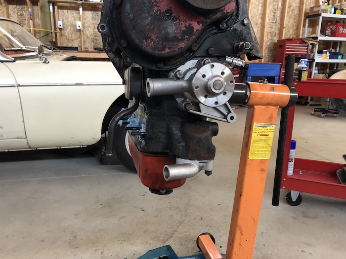

Here's the water pump I ordered. Given Doc's description I think this will be okay (impeller looks cast to me) but I'd love another set of eyes on it .
You're good to go, Drew! That's a proper pump from what I can see.
Thanks, Doc. Onward!

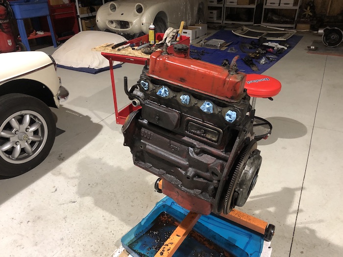

Made some more progress today, got the water pump, thermostat and housing, clutch, and side cover gaskets installed today. Also turned the engine over and took off the oil pan to clean it out and replace the gasket. There is hole in the backplate that had some sort of rubber plug that disintegrated in my hands while I was cleaning things. I looked at the engine that I pulled out of the B and it didn't have anything covering that hole. Moss lists part 297-495 (maybe?). Two questions - is this important and can I install it without pulling the flywheel?
Moving forward. Next step is to clean and prep the trans mount and install a fresh throwout bearing. With that done I'm pretty much ready to put this into the B and start sorting out the details.
