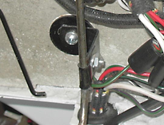

As some one more eliquently put it I am 15 years into a two year project and I am stumped. On the BJ7 there is a small bracket that holds the looped hydrolic line in place and it mounts on the fire wall. I can not find one anywhere. Does any one have one that I could purchase or use as a template to make another one?? Many thanks
Keoke
OH Healeyguy, that bracket is nothing but an "L" shaped piece; ~ 3/4" wide and 1 3/4" long with a small wire harness clamp bolted to its end that holds the oil pipe in place. --Keoke

Hi HG,
Best I can do at the moment is a picture of what it looks like.
