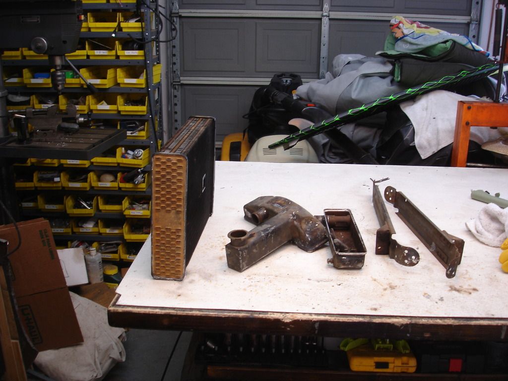

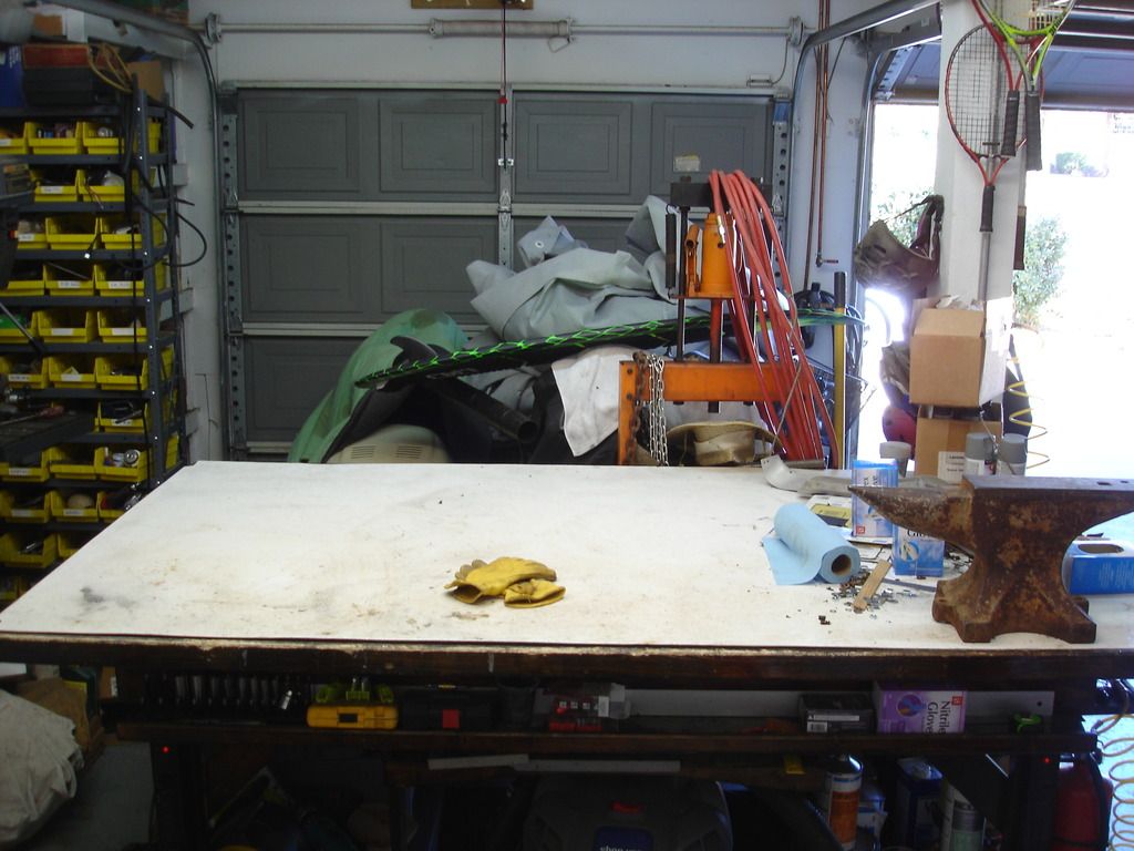

Thought I'd show everyone what an empty work bench looks like. It hasn't been empty since I bought this jalopy 3 years ago!
Must be a great feeling!
Cheers
Tush
Just big enough for you and your son to heft the tub up on! Excellent workmanship with unimaginable diligence - you sure you have a day job?

Almost, Jeff! Tush, the feeling was short lived, as the party went outdoors!

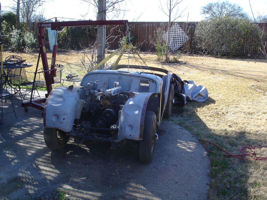

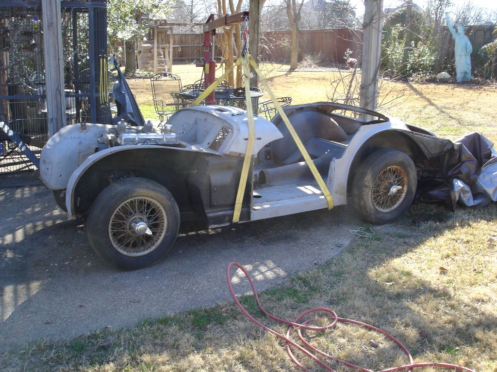

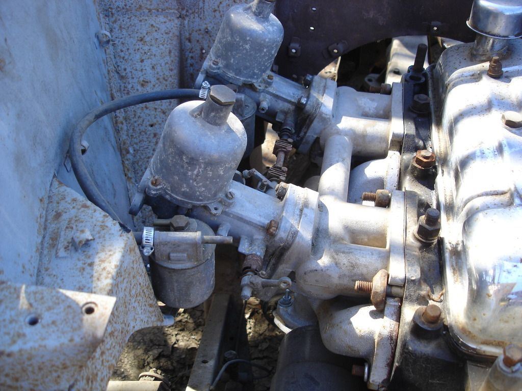

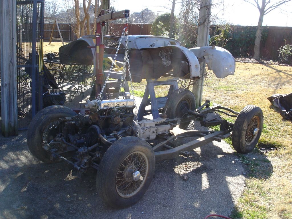

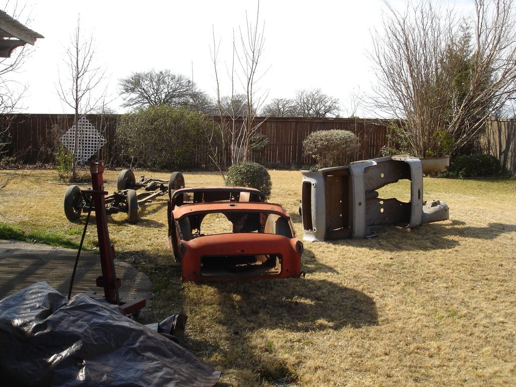

Working alone, here is the cherry picker about to do its work...pulling the tub off the donor car

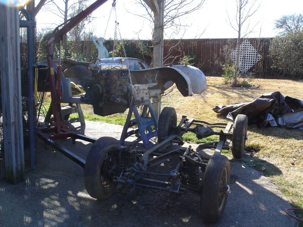

This pic shows that the tub will NOT come off without first removing the carbs. I had to try!?!

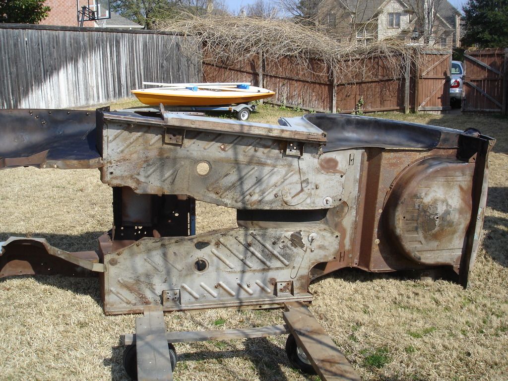

Phase one complete. The tub is off, so I could then remove the motor/tranny/ and odd parts that are left on the frame. I will use this frame as the jig as I cut and patch the tub, so everything that is removable will come off.
It occurred to me at this point that I have now taken apart 3 TR's...but only reassembled 1. That's a 33% average...I'm not doing very well on that front!

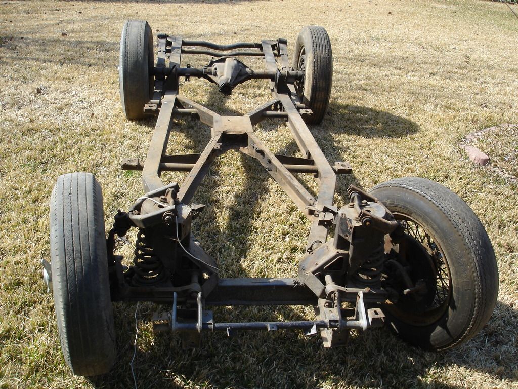

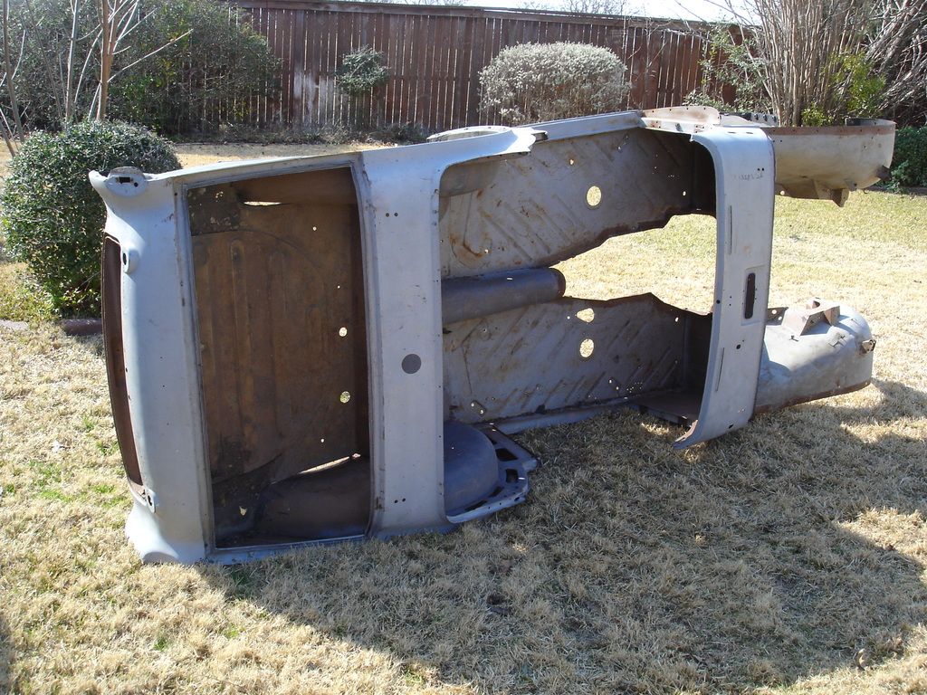

Here is the bare frame. I left the wheels and suspension on for now, so I could roll it around.

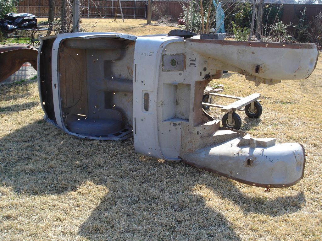

Here is my very high-tech tub transport device. It costs $100...mainly for the 4 castors from Northern. I had to build a second dolly, since I will be playing with 2 tubs...The original, to be used for a pattern for the final tub. And, the donor tub, which will provide the majority of the metal for the finished masterpiece.

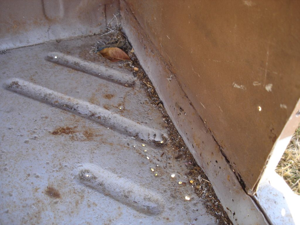

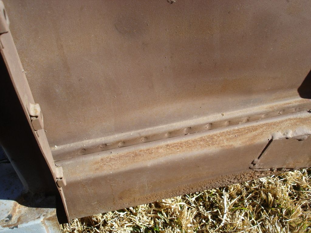

The bottom of the donor tub is relatively decent. One inner sill looks bad at the rear. The floor has a few bad areas. Some poor replacement patch work has to be dealt with...but it could be worse!

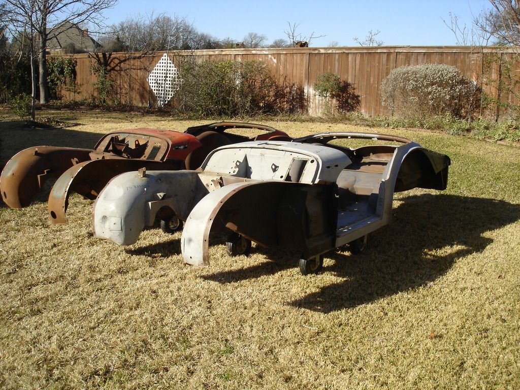

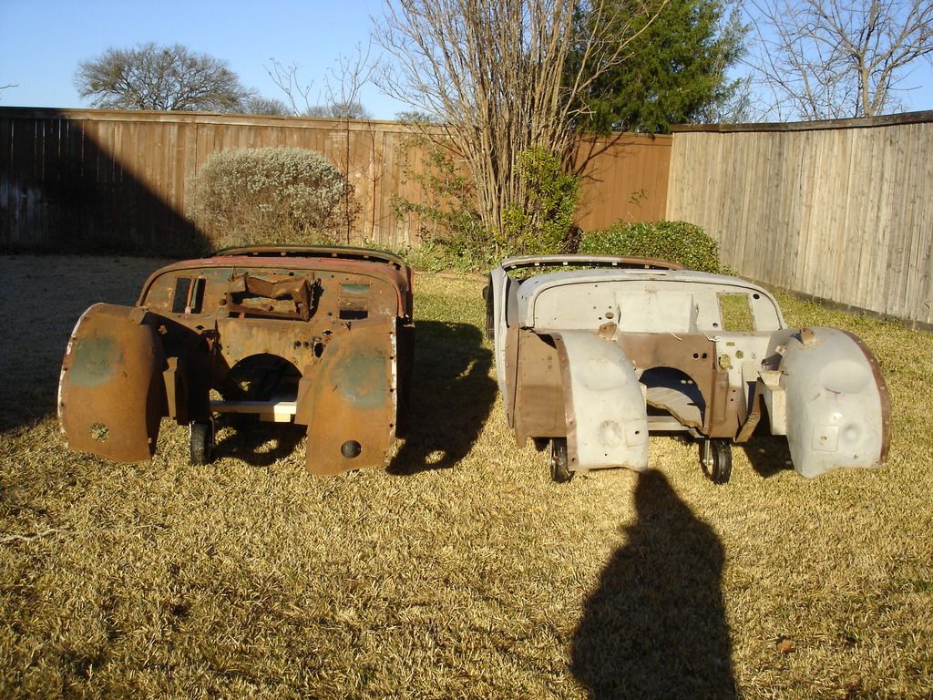

So that's where we leave off. The frame can roll. The 2 tubs can roll.

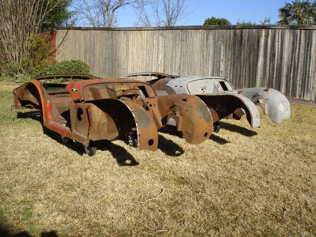

Rather than beat around the bush, I'll post pics showing the situation. There are 2 main issues going on at once. First, I bought the TR3 tub to replace the TR2 rusted out tub. They look the same at first glance, but there are many more differences than appears at a quick glance.
Second, some parts of BOTH tubs are rusted out. The donor tub has been patched with fiberglass. That sucks. The floors are holed worse than I initially thought. Bottom line, the donor tub sucks.

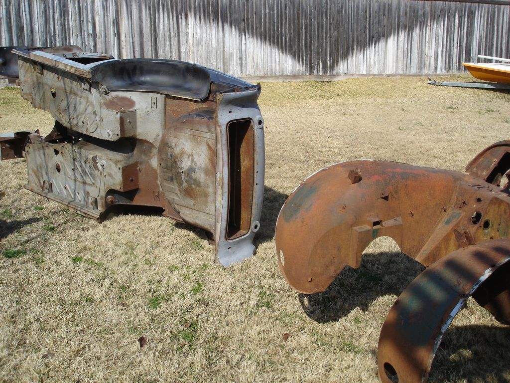

TR2 Vs TR3 Differences

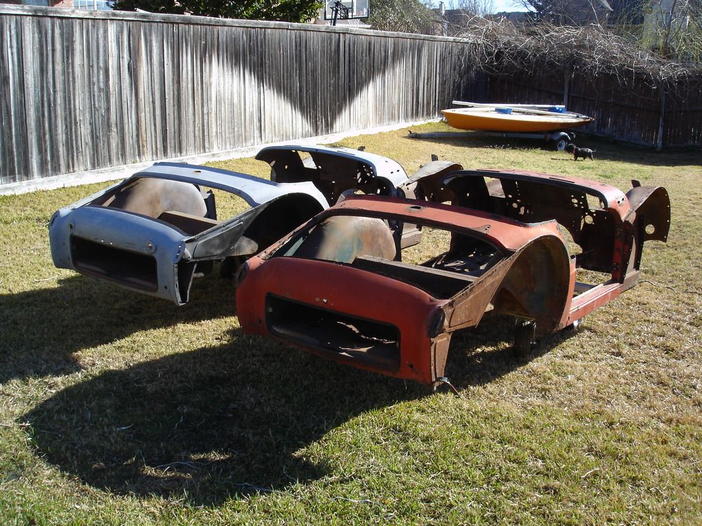

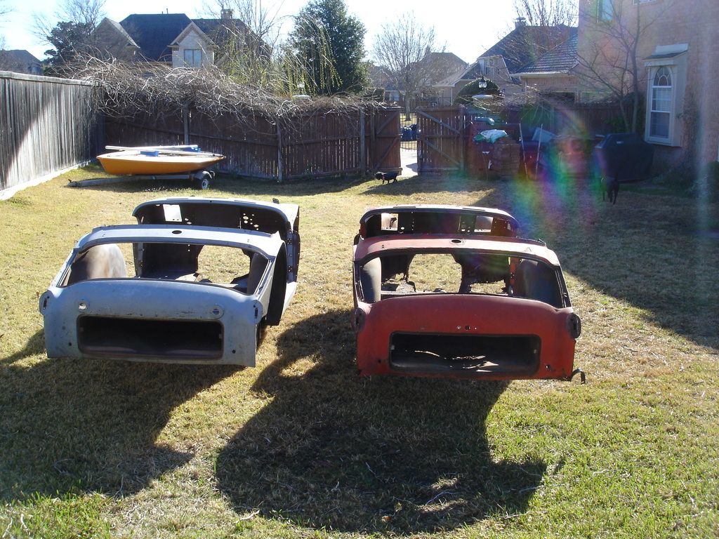

These are the 2 tubs. For the first time in 3 years I am to the point they are completely dissassembled and can be set next to each other for comparison. First glance not to bad?!? It gets bad...

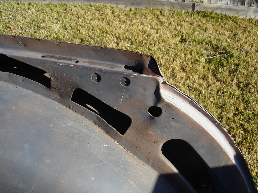

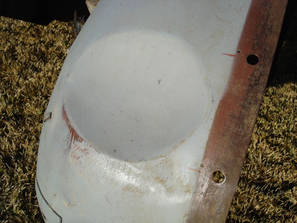

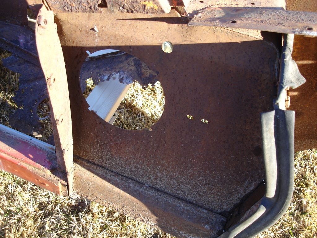

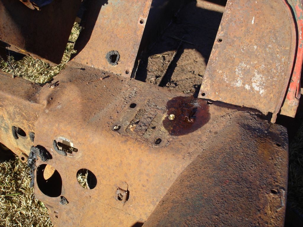

Starting at the front, this is the headlight relief for a TR2. Just a hole.
TR3...has a hole for the bumper mount, no hole for the headlight, a reinforcement patch, and a relief for the headlight. Uhg. If you guys have learned anything about me, it's that I am annul when it comes to restorations. I can not just leave this in TR3 style and in good conscience pass the car off as a TR2.
Continuing...

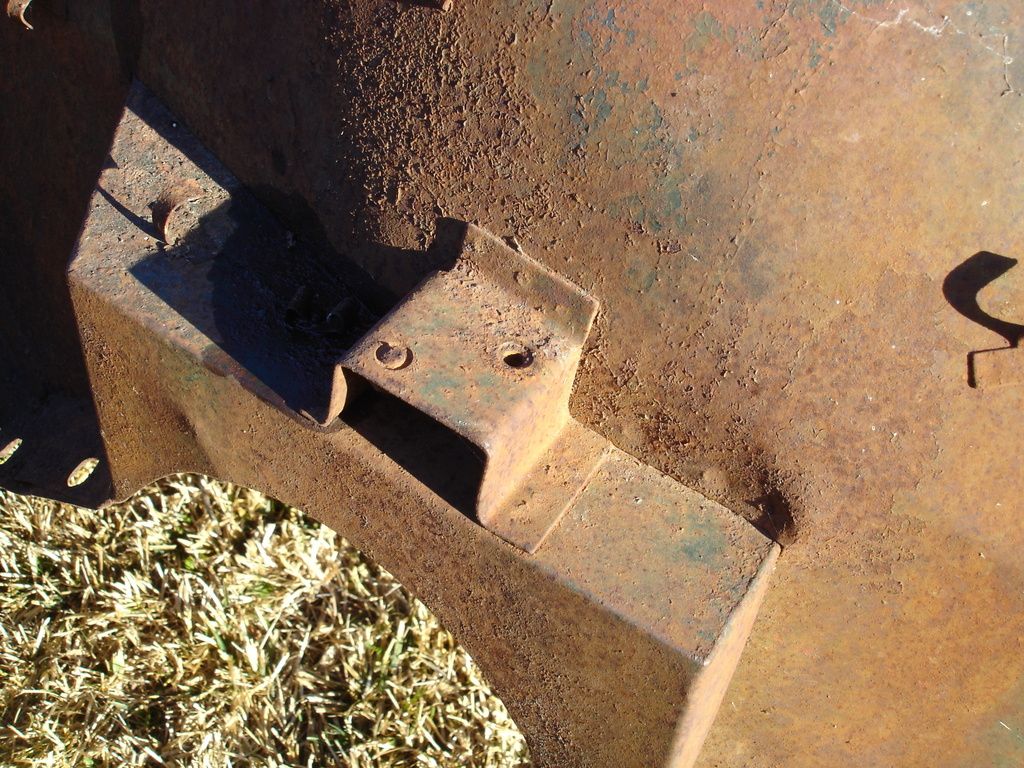

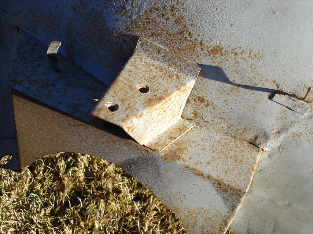

It's been so long...I think this is the TR2 horn mounting pad?
TR3 horn pad. Different shape and hole spacing.
TR2 has the hole for a RHD steering column.
TR3...nope.

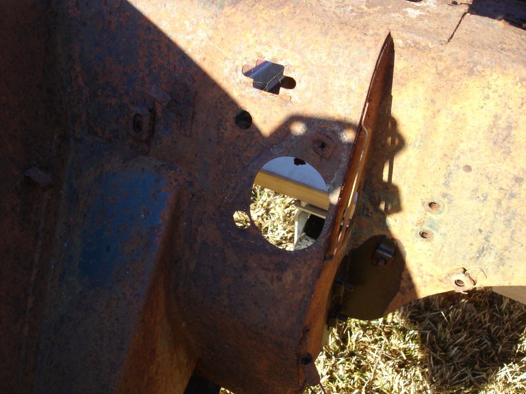

TR2 radiator brace. It uses just a hole for the brace rod to bolt to.
TR3...a slot.
TR2 has the brake/clutch opening for RHD.
And, of course, the TR3 not.

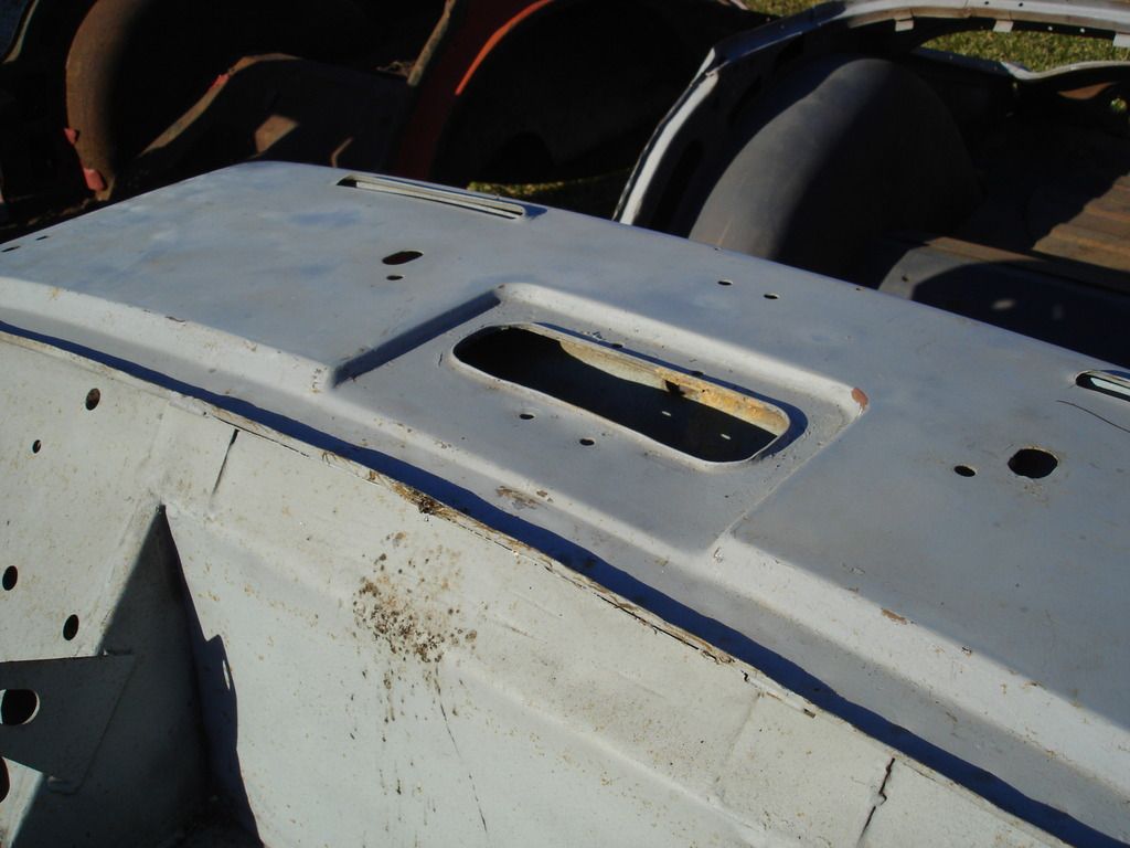

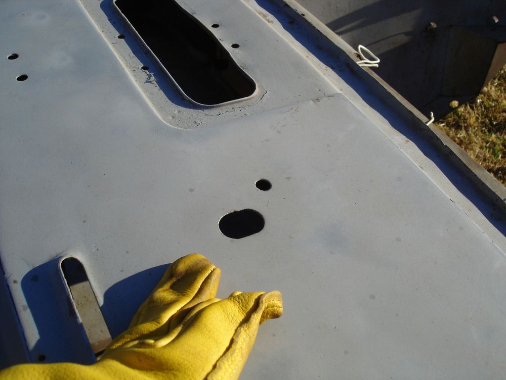

TR2 has no front scuttle vent.
You guessed it...TR3 does.

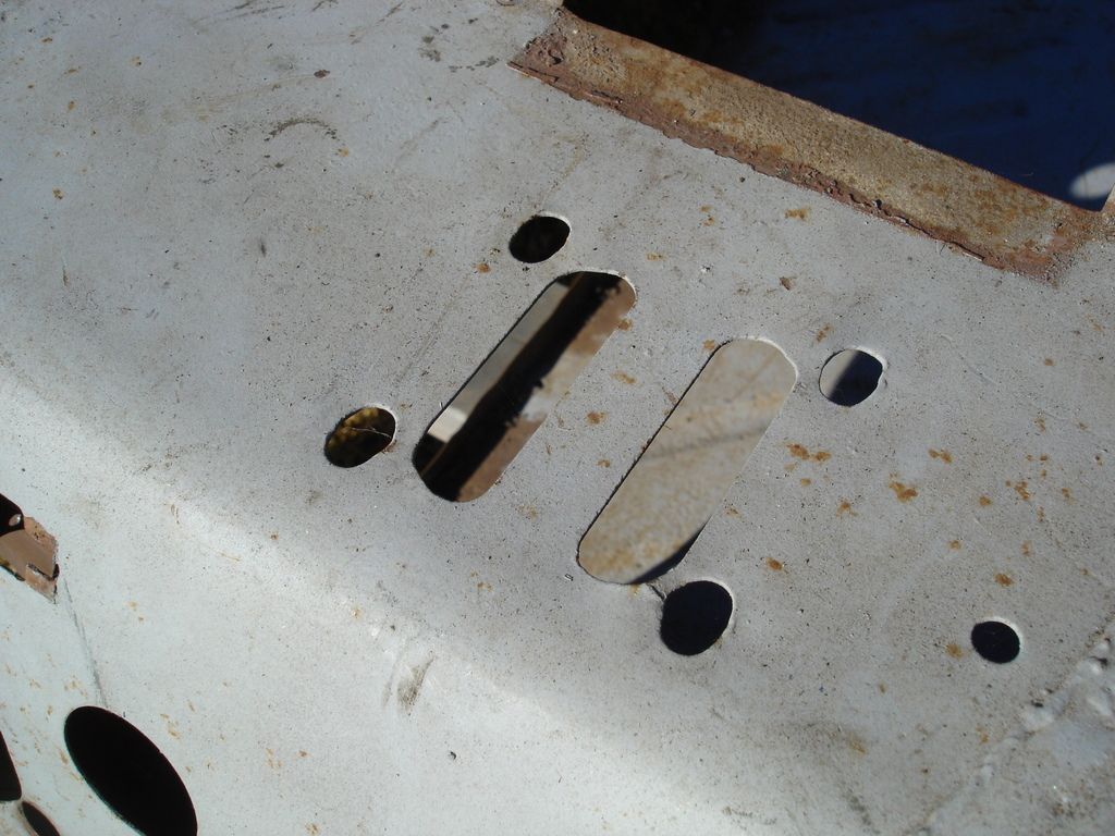

Funny illusion on this pic. I am trying to show the thin slots for the brake and clutch pedals...but the rust from the floor seems to fill in the holes. Rust, rust, rust...I am so tired of looking at rust.
TR3 has larger slots for the disc brake set up.

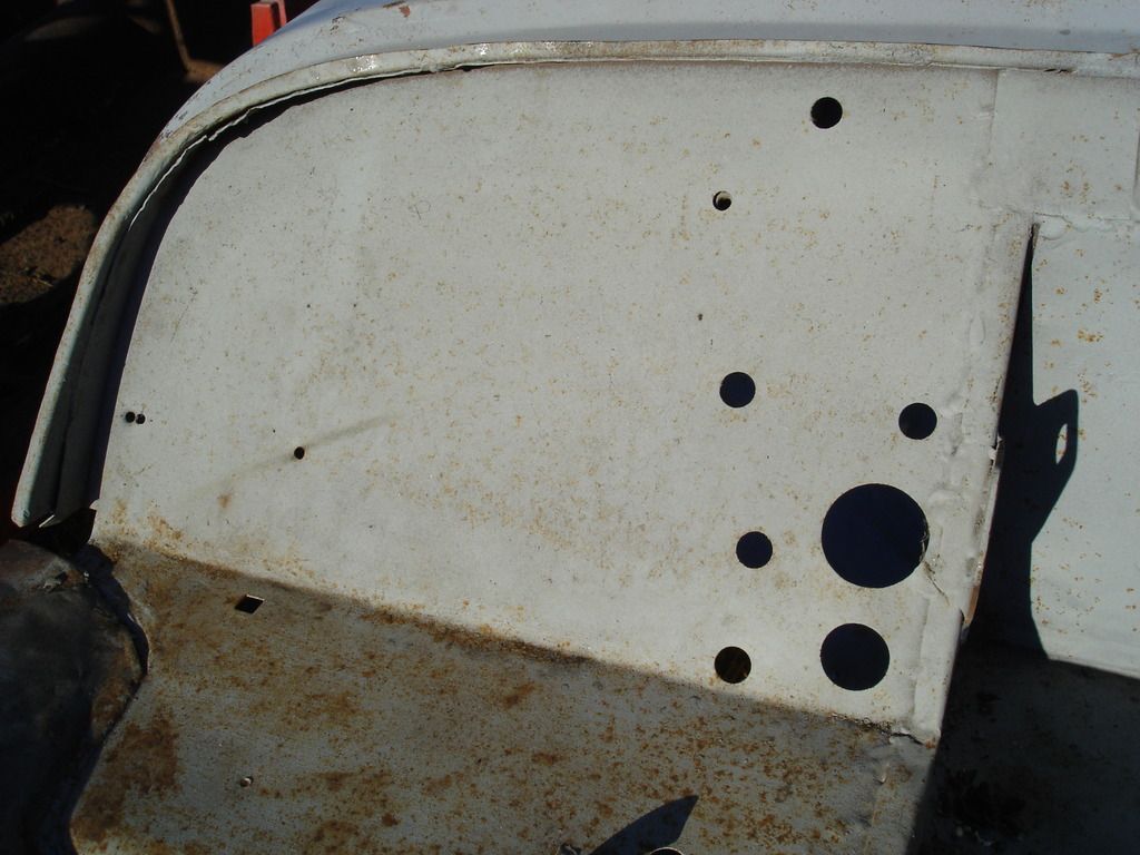

Speaker hole TR2.
None TR3

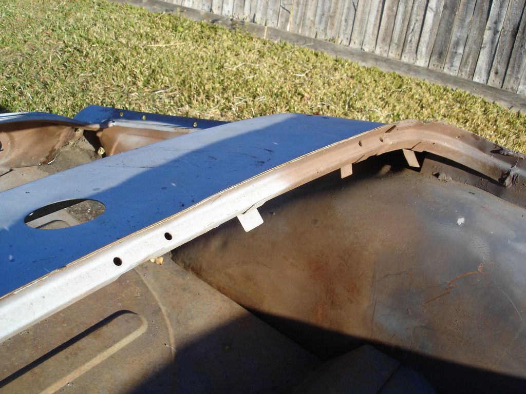

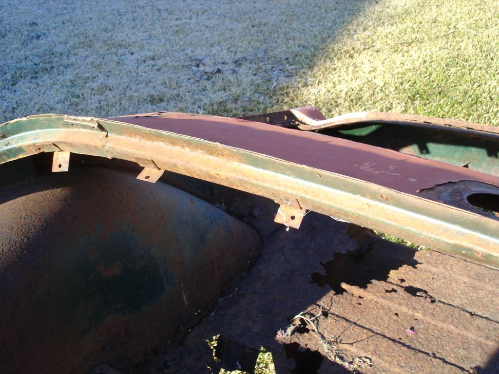

Just like the door frames, the TR2 uses a wood insert for the dash edge.
TR3 went with an all-metal dash edge

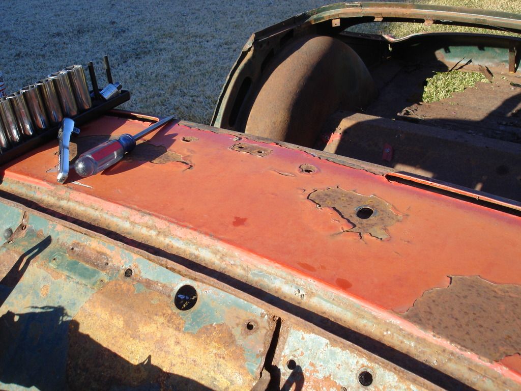

TR2 rear cockpit edging has few holes.
TR3 added a bunch of extra holes.

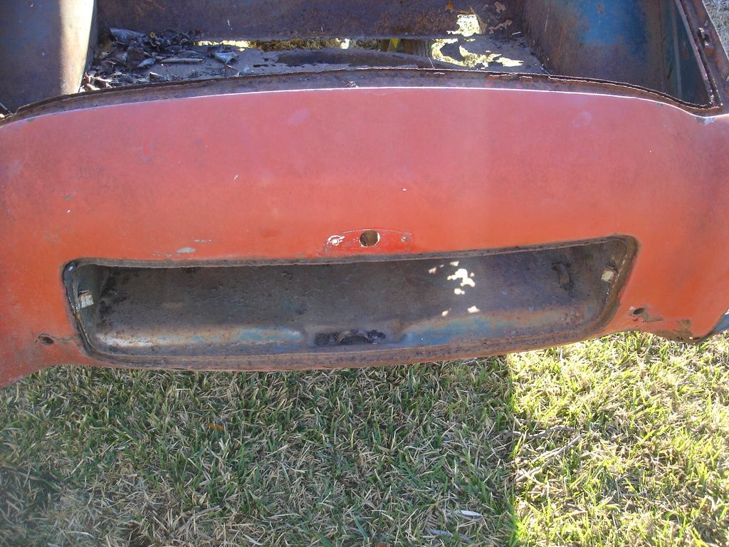

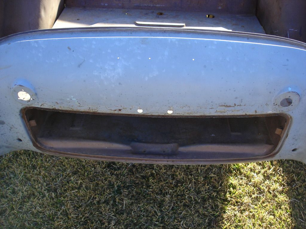

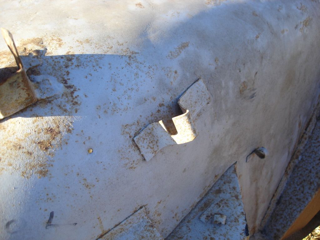

TR2 rear valence has no extra brake light pintles. The brake light is in the license plate light assembly.

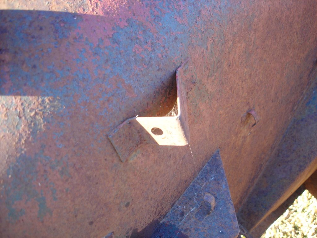

Gotta get rid of the TR3 pintles.

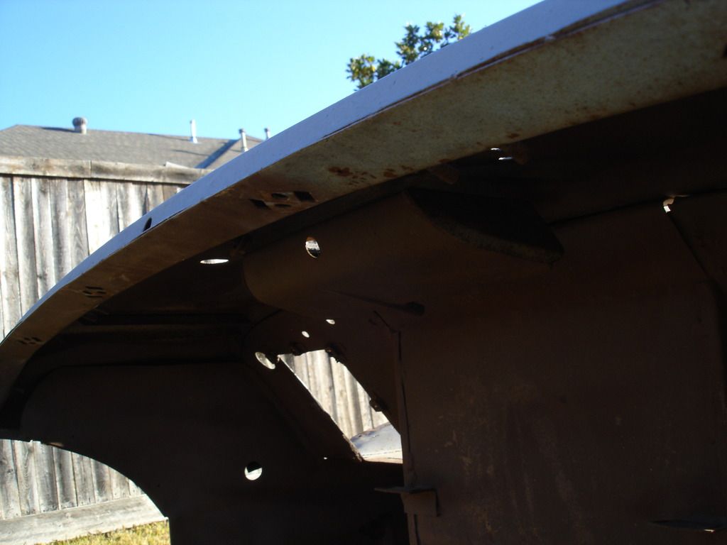

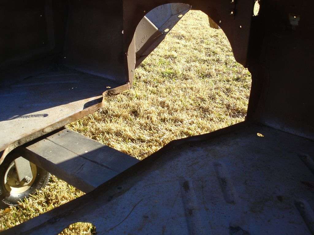

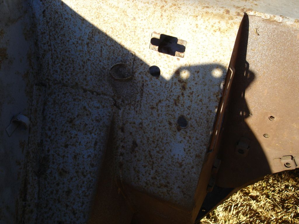

AND just when I thought I had caught all the differences...I found a subtle one with the way the kick panels attach. The tr2 kick panels are full length, extending all the way down to the floor boards.
OK, I know what you're thinking..."what floorboards?" I hear 'ya!

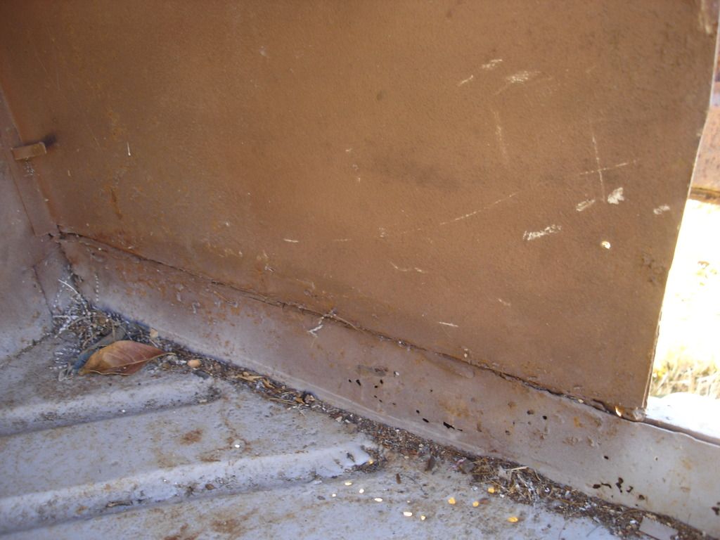

This is a view of the outside of the kick panel where it disappears inside of the inner sill.
The TR3 stops at the top of the sill and is spot welded to it there.

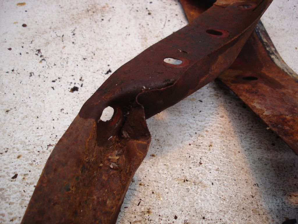

So, now for the rust and accident damage.

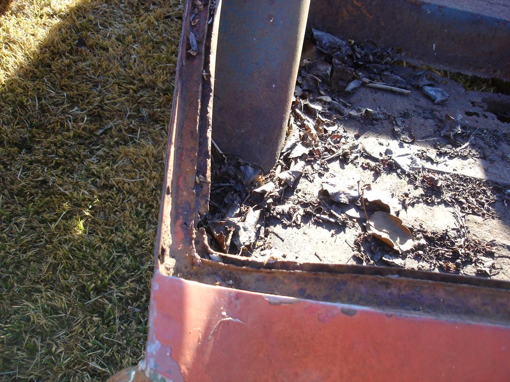

This is the TR2 tub, the back side of the forward body mount. Water got between the body mount plate and the wing, so both are compromised. Except for this area on both sides, the inner front wings look usable.
This is the right TR3 kick panel. Not sure what's going on with it, but it is not straight. TBD.

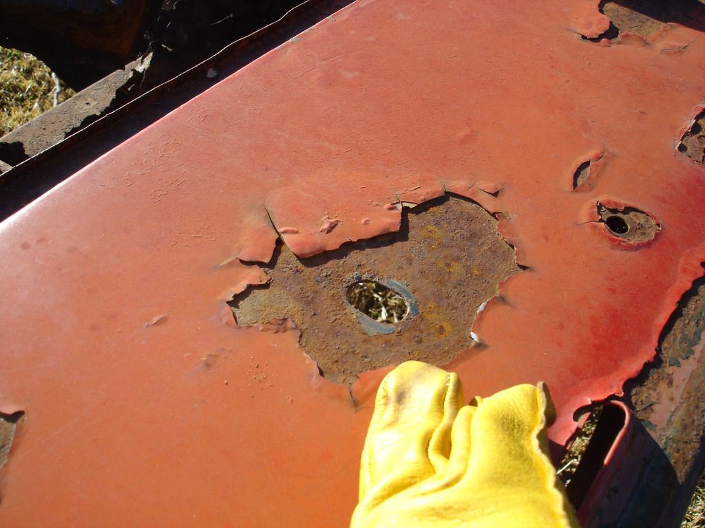

TR3 front body mounts. That's a lot of bondo oooozzzing through rust holes. I don't know if I even want to make the effort to strip these inner wings. If it looks this bad bondo'd, it sure won't look any better bare.

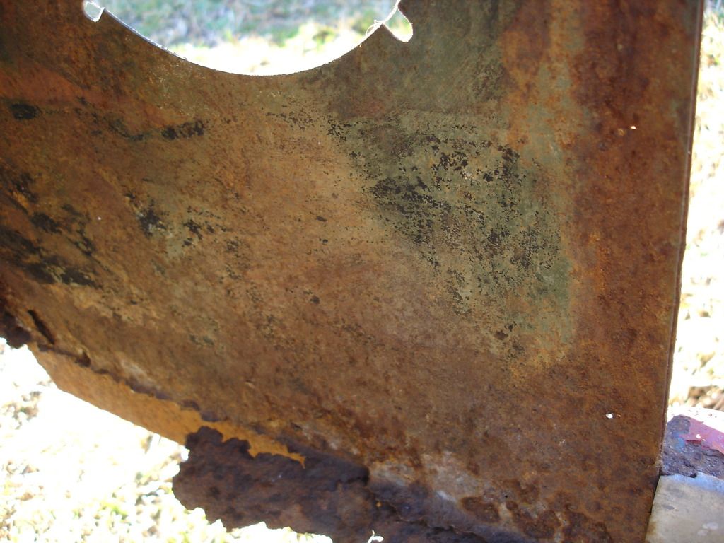

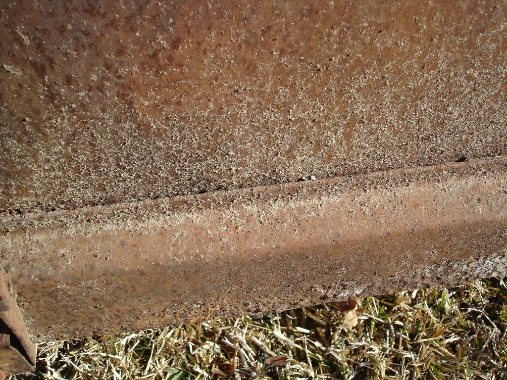

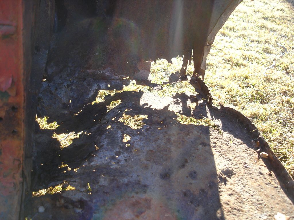

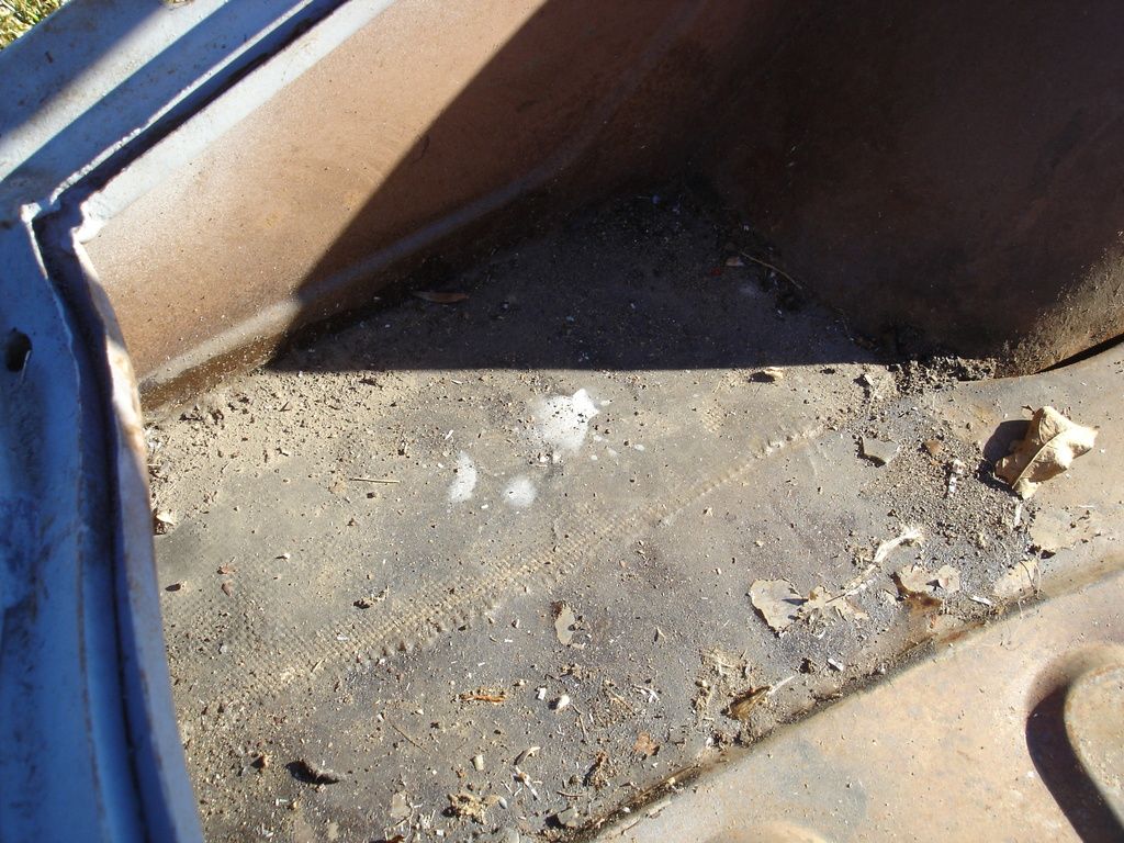

TR2 floors are really non-existent. There is only enough of them left to cause Tetanus.
TR3 floors. Better, BUT. I have not stripped them yet. I see bondo across them. And...

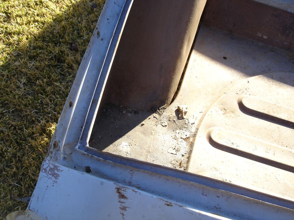

In my experience, if there are this many rust holes showing BEFORE I strip the bondo, it is not going to look any better afterward.

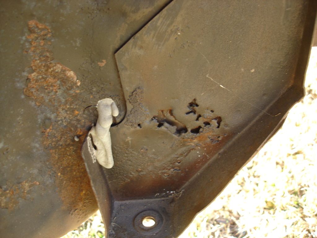

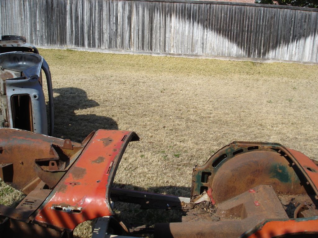

TR3...someone took a BFH to the top of the quarter panel. TBD
TR2 boot floor...missing.
TR2 boot seal channel...missing.

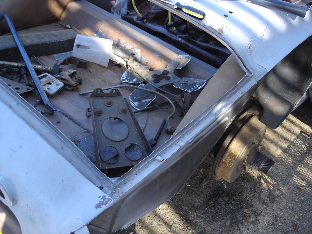

TR3. The boot floor is new. Look at the gap between the new floor and the rear wheel well. Something is going on there. I would much prefer a screwed up original car than having to figure out how some PO tried to repair.

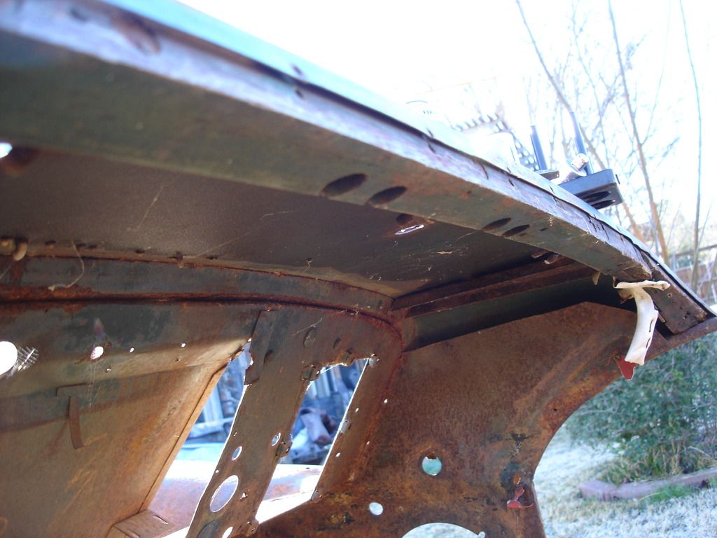

TR3 outer boot floors. Yes, that is fiberglass cloth. Yes, When I shine light under the boot, I can see the light through the fiberglass. NO...that is not normal. It escapes me why some bozo would replace the floor and then fiberglass holes right next to the new metal. If a job is worth doing, it is worth doing right.

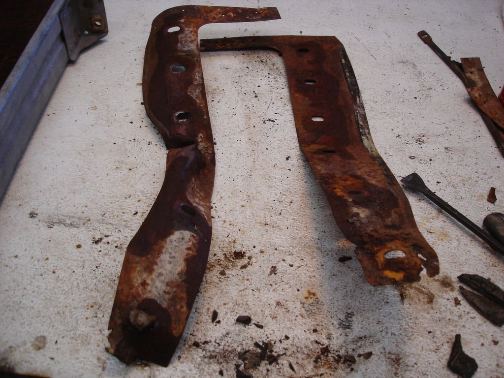

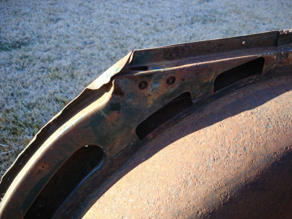

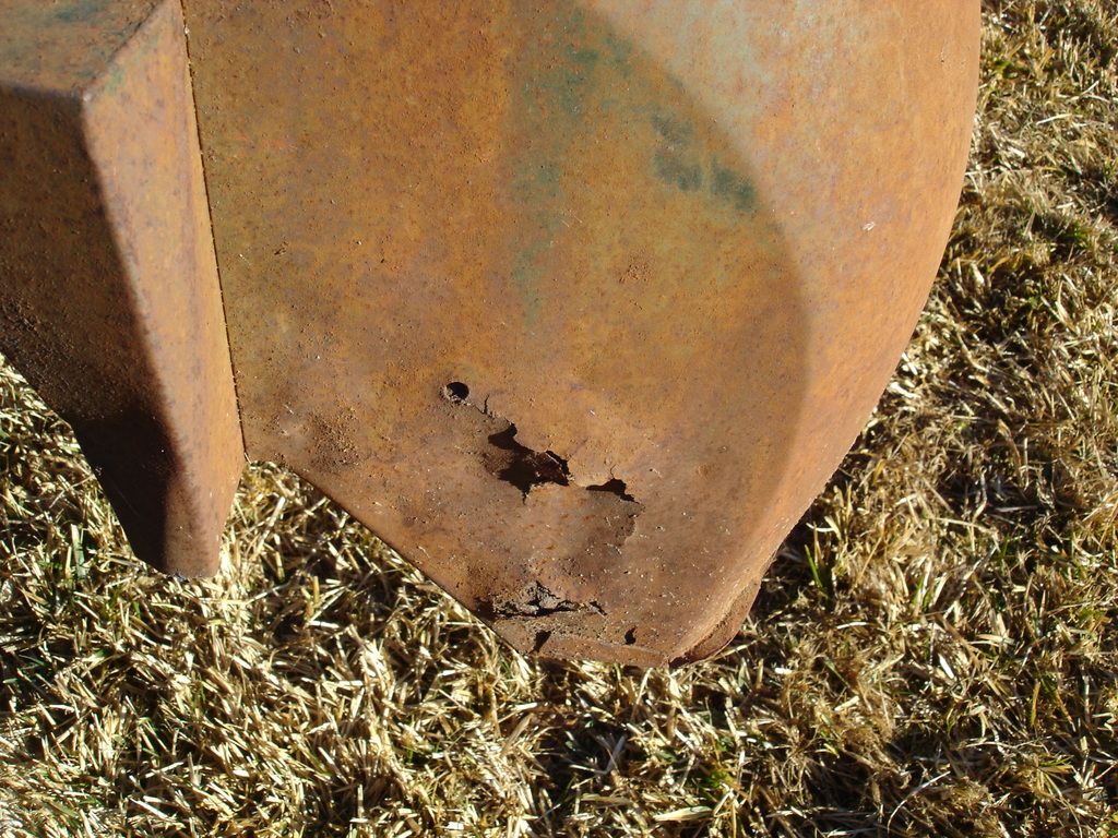

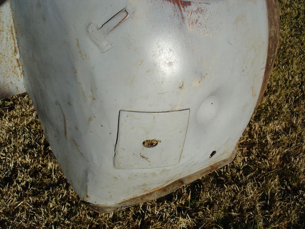

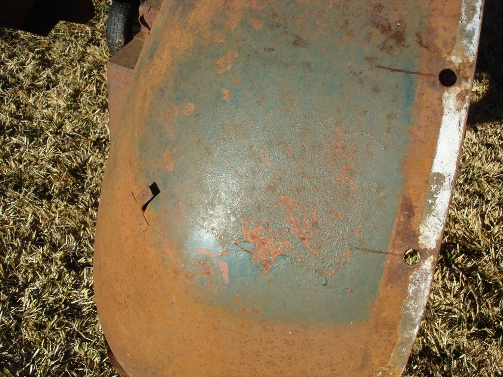

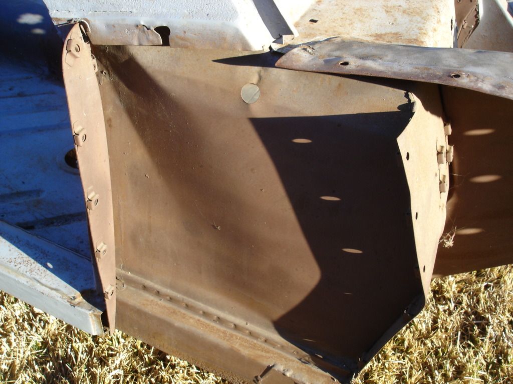

These are the seal panels that go inside the front wings to seal the tub to the wing. The one was in a pretty good accident, that even bent the "A" post. I would absolutely rather have to deal with this damage than to deal with crappy repair work. As bad as these look, with one having rust holes and the other crumpled like tin foil, I will re-use both of these! They will look as good as new when they go back in.
Just a few shots of the general tubs.
I have a lot of decisions to make. Neither tub is usable as-is. I don't know if I can even find enough good metal to splice a decent tub out of the 2. I will need new floors. I will need MANY patches. I will need beer!

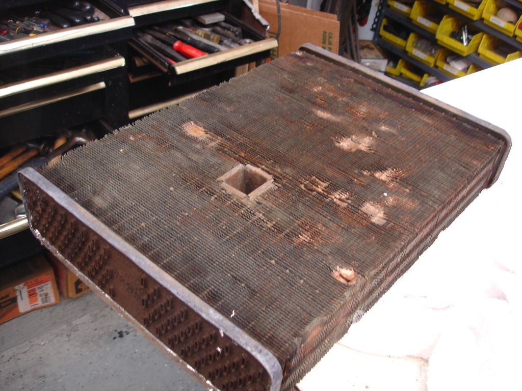

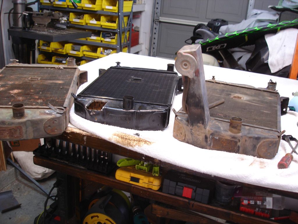

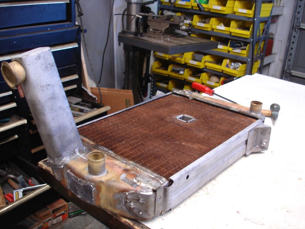

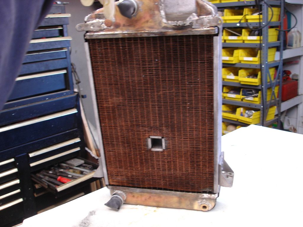

I hoped for a decent radiator from the donor car...but no luck there. The cans were decent, but the core had been run over with something large.
I could not bring myselft to spend $500+ on a new radiator, and after 3 full years of Ebay shopping, one that LOOKED decent turned up for $150. I bought it a few months ago. The good news, it had a good core. The bad news is the cans were all beat up. I have no idea if the dents just didn't show up in the Ebay pics, or if it took hits in shipping. No matter...it was ugly.

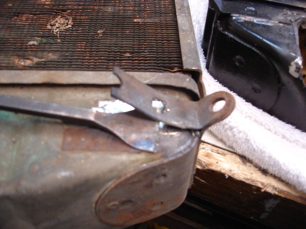

So, 3 radiators, none decent, but each with it's own decent parts. Time to mix and match! Here is the photo sequence of taking apart radiators and putting them back together. It may be obvious to some of you, but I bet a few have never seen the inside of one.

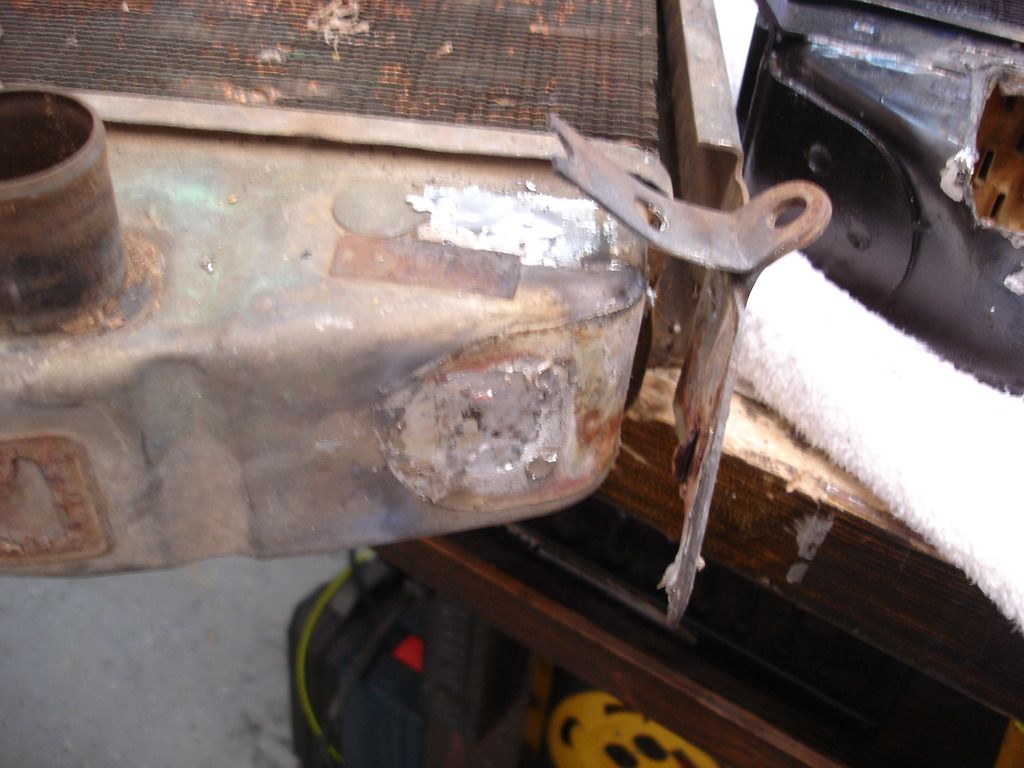

The starting point...3 clunkers. The reason the neck is missing from the center one is that it is the Ebay radiator. I removed the neck to try to beat the dents out of it. What I did not know is the neck is not open, but merely has 3/8" holes in the tank end. That idea failed.
Heat and prying is all it takes to break the solder bonds all around.
This is the donor car core with the tank off. The tanks from that radiator were the best, so they will go on the Ebay core.
Yes...that is a rat's nest IN the radiator!

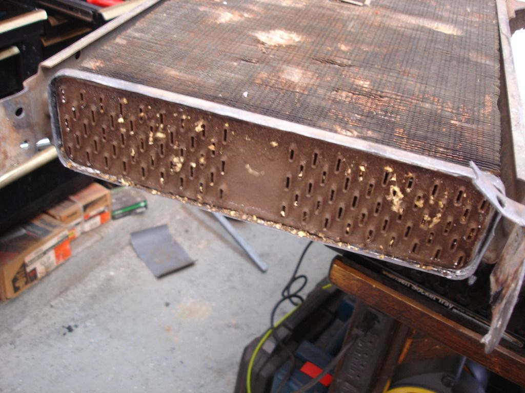

I am not using this core, but you can see the dark brown deposits at the end of the coolant tubes. That is from years of Stop Leak. Once in, it never comes out, and it provides an insulating layer on every surface. If you have cooling problems, this may be one of the reasons.

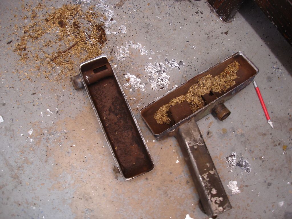

Here is a close-up of the Ebay tube ends. Notice all the little rust, rocks and junk that slowly clog the tubes. Each piece reduces your cooling power a little bit, until it finally is unable to cool your car anymore. Notice this core has NOT had any stop leak added...bonus!
All of that junk gets picked out, blown out, or shoved out with a welding rod.

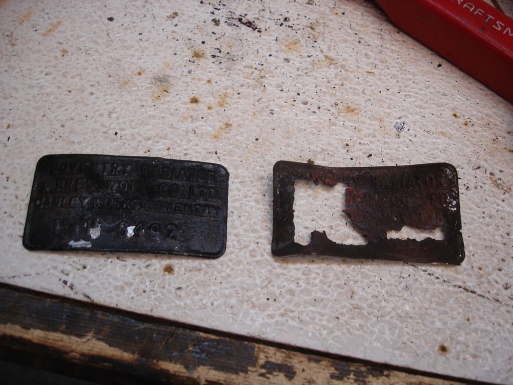

I chose the best of the build plates to go on the finished Frankenstein.
These are the best of the 3 parts. They will eventually be put back together for a nice radiator.
Here they are after blasting. The core is copper. The side rails are steel, and the tanks are mostly brass...except for the filler neck that is tin. That is why solder is used for these...it's the only way to hold together so many dissimilar metals.

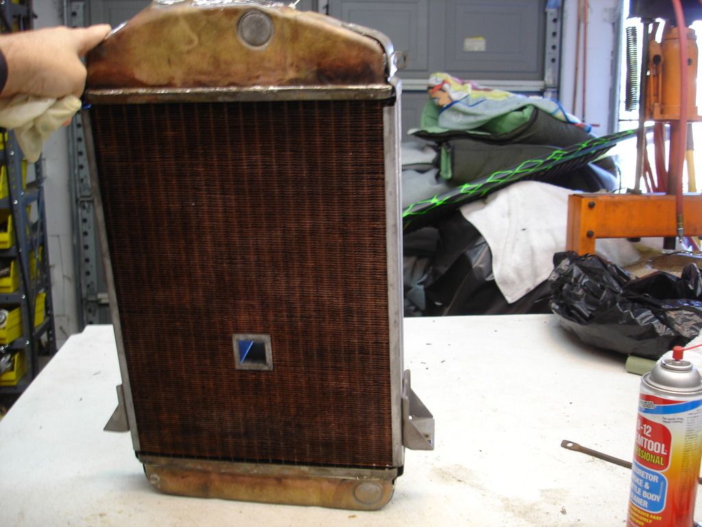

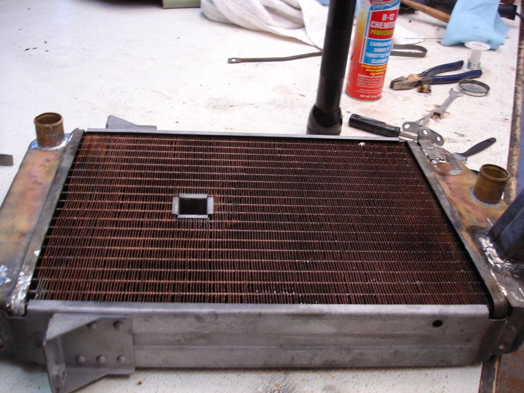

Only one issue...if you look closely at this blurry pic, you can see that one tube is blocked. I am not sure with what, but I was unable to unblock it. This single tube will be blocked off, so it will not be operable. I did this just in case it was plugged by a shop because it was leaking.
Here is the same tube soldered shut. No more issue! Yes, in theory it will reduce the cooling by 3%.
I thought about taking pics of the soldering, but I did not have enough hands to operate the radiator parts, torch, flux, and solder...and still snap pics.
It was boring anyway.

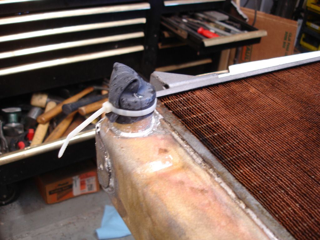

The core did not look that good when it arrived. I spent over an hour with a thin comb and tiny needle nosed pliers, straightening each and every cooling fin. The fins are perfect! But as with every radiator...they won't stay perfect for long. Oh well.
The final thing I did before painting is to seal off the openings and pressurize to 5 psi with air. I then painted soapy water all over to check my soldering for leaks. The only area I had to re-touch was around the neck. Funny thing is my TR3 radiator went to a real radiator shop. When I got it back I installed it and it leaked...around the filler neck! It has a warranty, but the value of the warranty is nothing compared to R&R'ing a TR3 radiator. I had to solder that leak with the radiator installed in the car. I was too lazy to take it back out!
Here is the finished Frankenstein. That's the good news. The bad is I have to go back to those blasted tubs now. Oh, wait...no I don't! I bought a bike!
