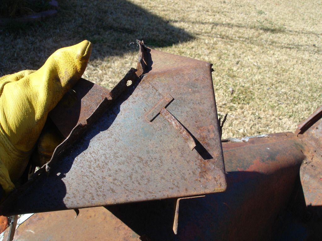

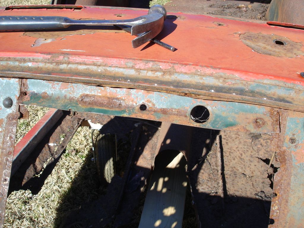

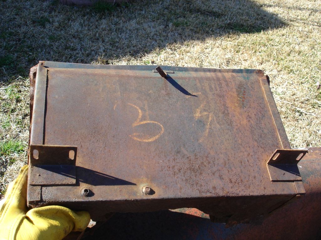

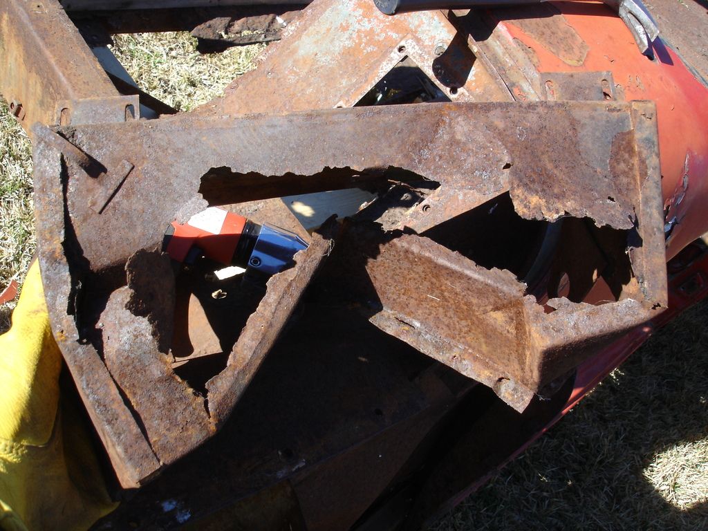

This is a view of the battery box on the TR2 tub. I started removing it 3 years ago, and was so totally disgusted with the situation that I quit. 3 years later I am finishing the removal. The battery box in the donor car is intact, but it looks like some home made affair, and it was welded in to well to make removal easy. I will spring for the $58 for a new box.

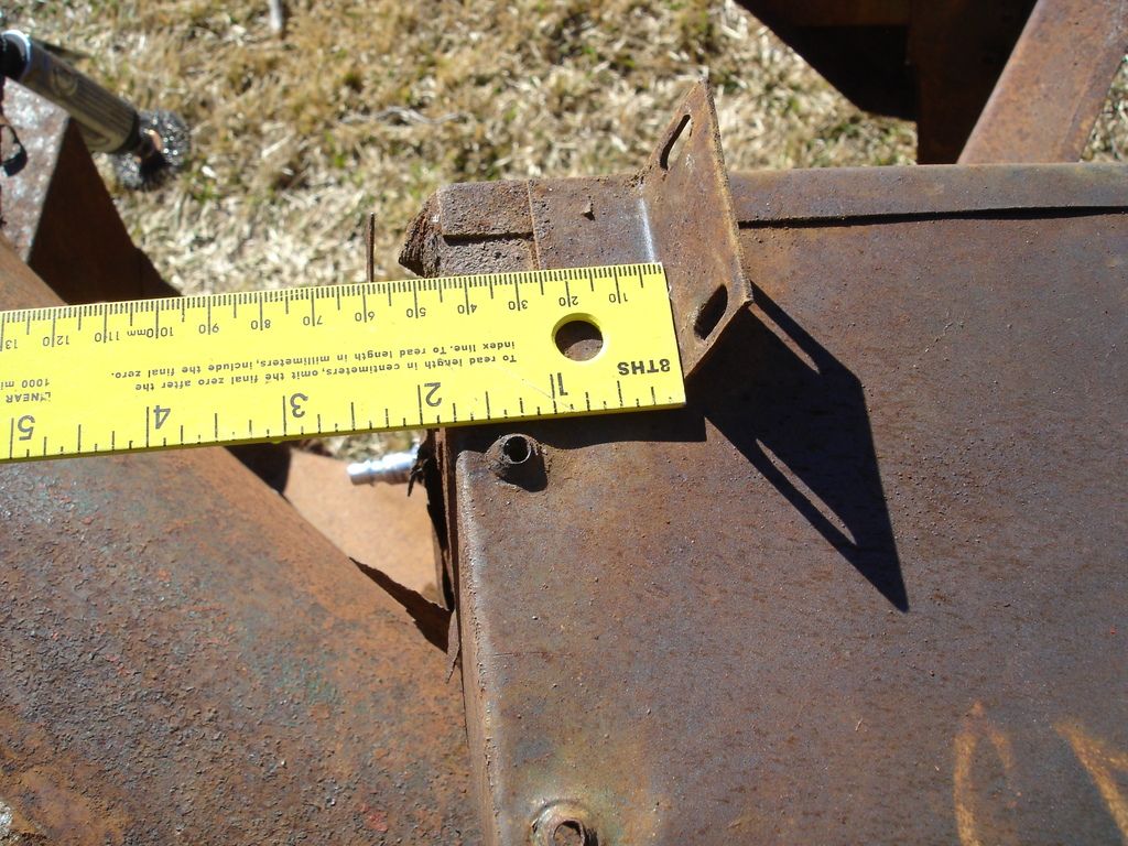

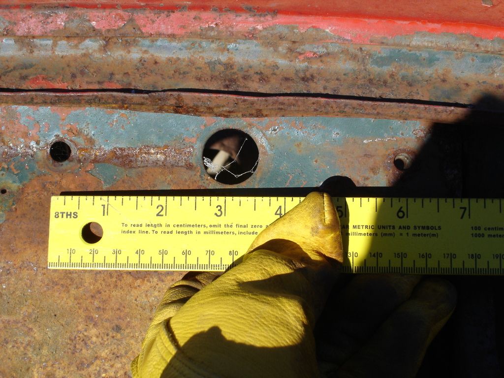

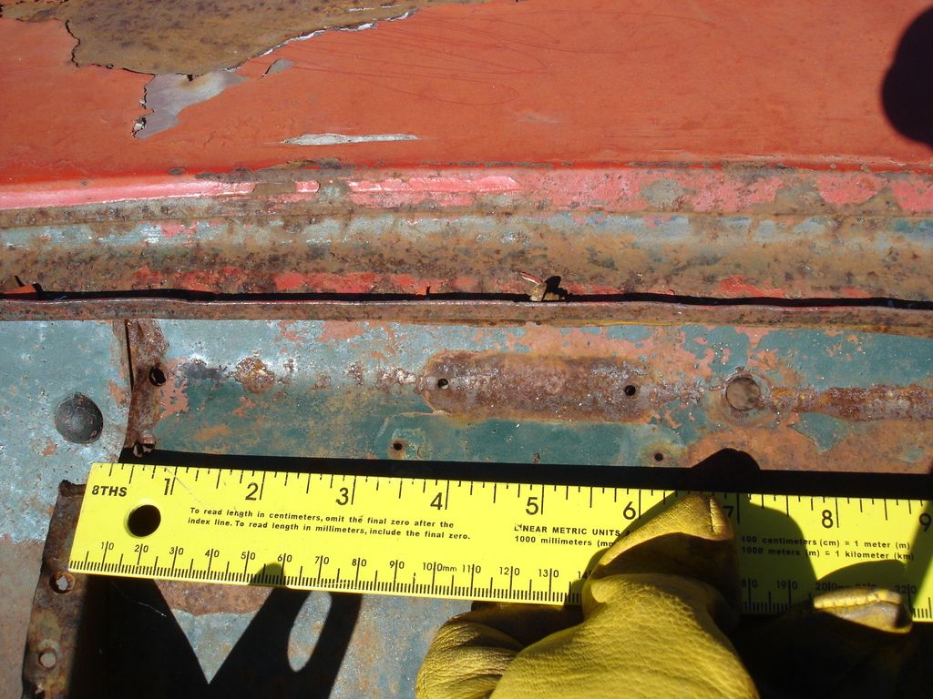

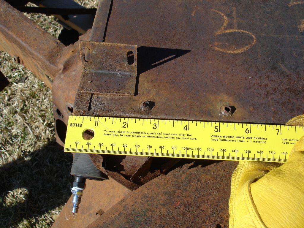

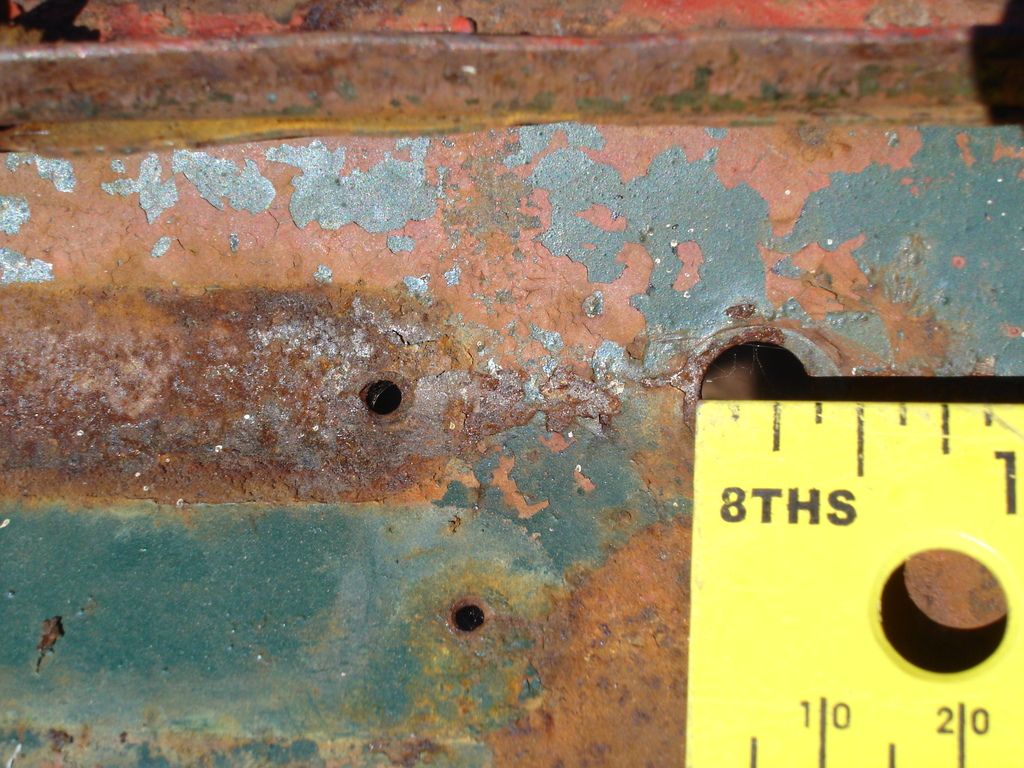

Here, and the next few pics I am taking measurements so I can duplicate the series of holes that are in the original box. Also, the little "T" wire loom holders do not come on new battery boxes, so I am documenting their locations.

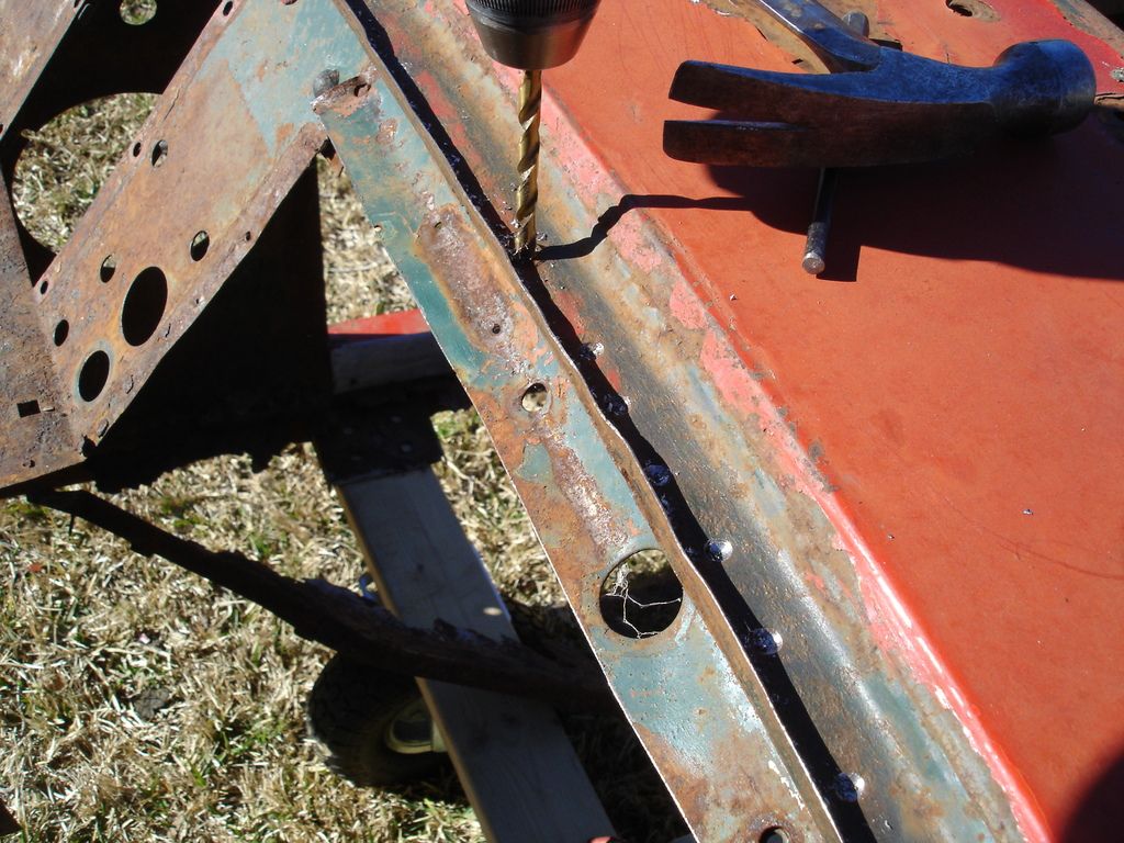

Here I went ahead and cut out the box, leaving just the spot welded top metal to be drilled out.

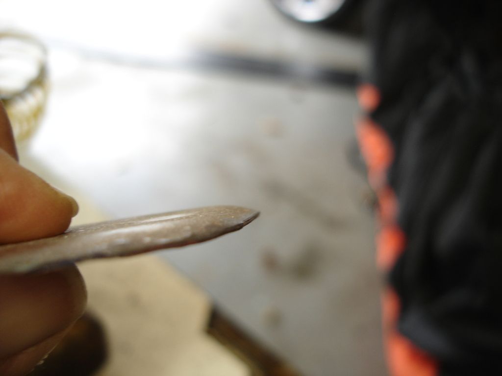

Standard 3/16" drill bit on each spot weld, and then I rapped the plates apart using a 3/16" drift punch. Any problem areas get chiseled. This process wears out drills and chisels fast, so I stop frequently to sharpen them.
The box removed. The tub already looks better, without the mangled box dangling there!
And, Just in case I get confused, I will save the top section with the holes, until I have duplicated them on the new box.

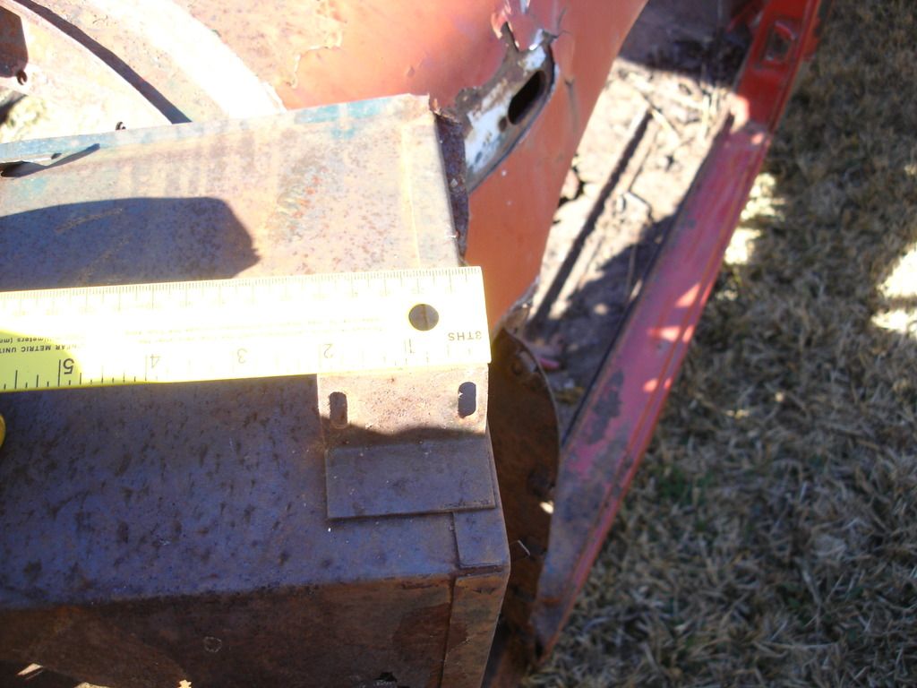

Here is the wire loom "T" on the right side of the box. Also note the angle bracket that attaches the dash brace. These parts do NOT come on new boxes...so they will have to be duplicated later. I will even go as far duplicating the yellow factory markings on the box...when the time comes.
Since this is an overdrive car, the OD solenoid attaches to the left, rear corner. Here I note the spacing and location to duplicate.

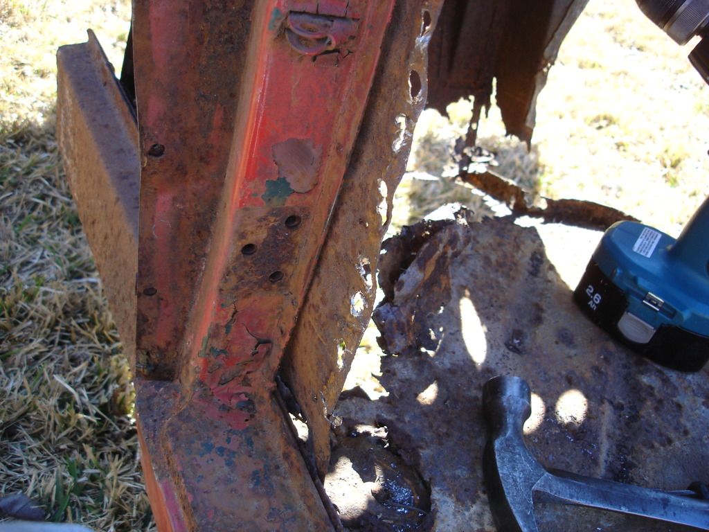

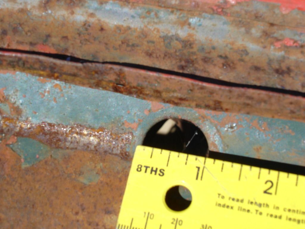

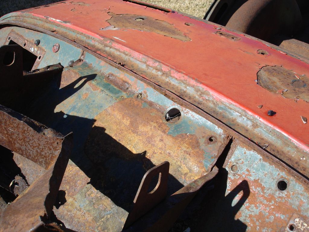

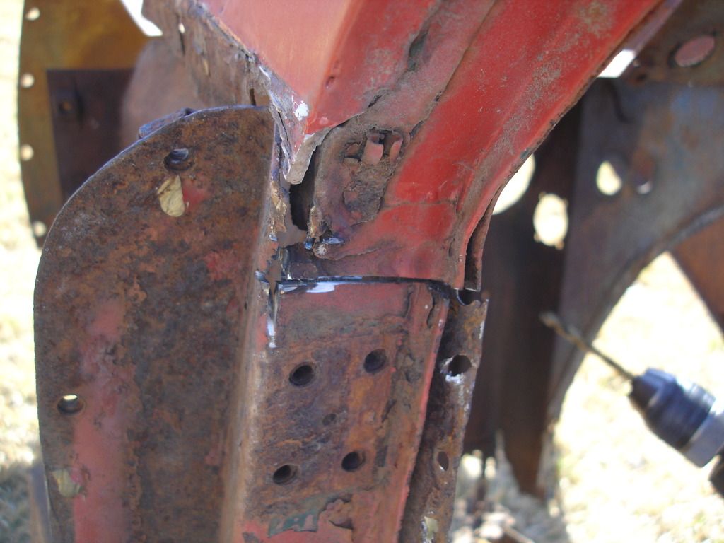

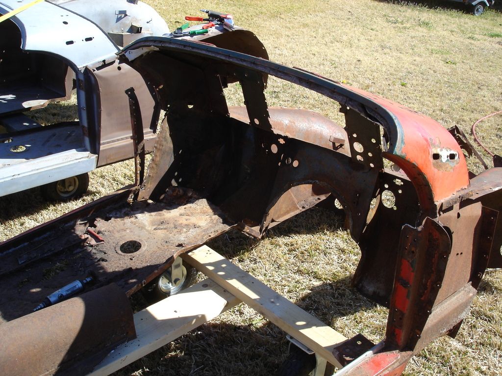

This is the left "A" post, to which the door hinges. The post in my TR2 was hit in an accident, and you can see the curve in the post. It should be perfectly vertical and straight. This is the point I will break the front clip from the rest of the tub.
Now, breaking off the front clip sounds envolved, but you will see it is merely a matter of drilling the line of spot welds which are holding the side kick panels to the "A" posts. This is a matter of about a dozen spots per side.
Normally the floor would have to be removed too...but in my particular case..."what floor??"
Here I am working my way up the A post drilling out the spots. You can start to see light between the kick panel and A post.
The very top of the post has one long weld, so here I used a cut-off disc to slice through it. I favored the kick panel side of the weld, since I will be re-using the kick panel and NOT the A post.
Once the last spot is drilled, the kick panel no longer supports the front clip, so here you can see it is rotating inward. One side down, one to go...

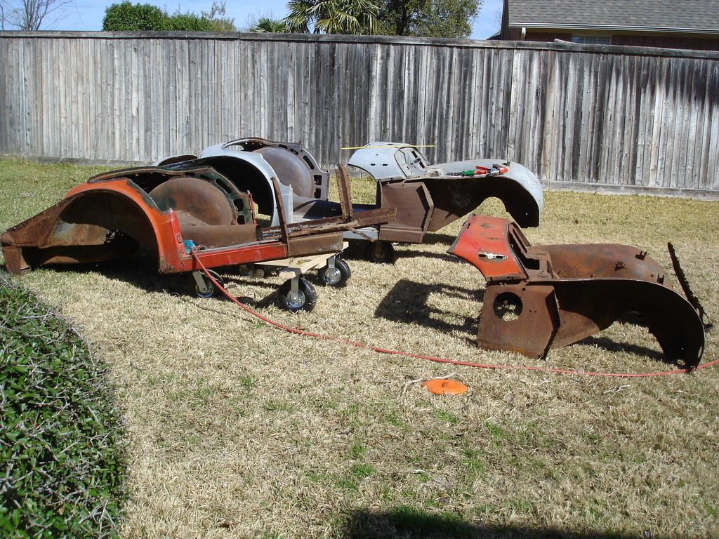

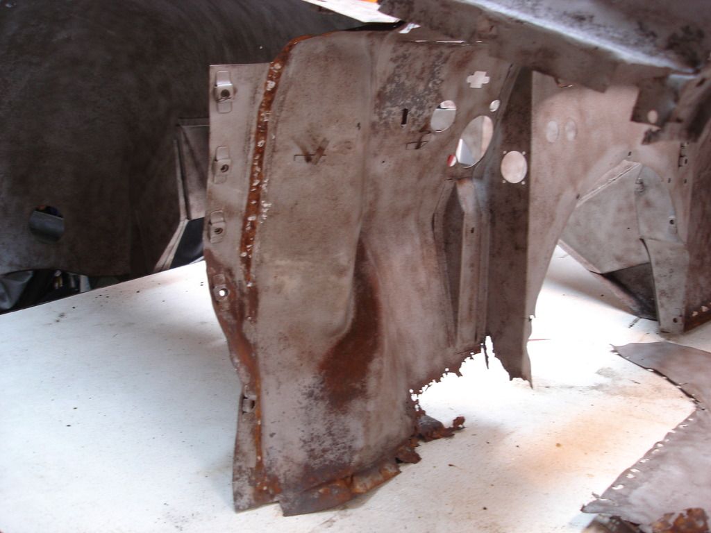

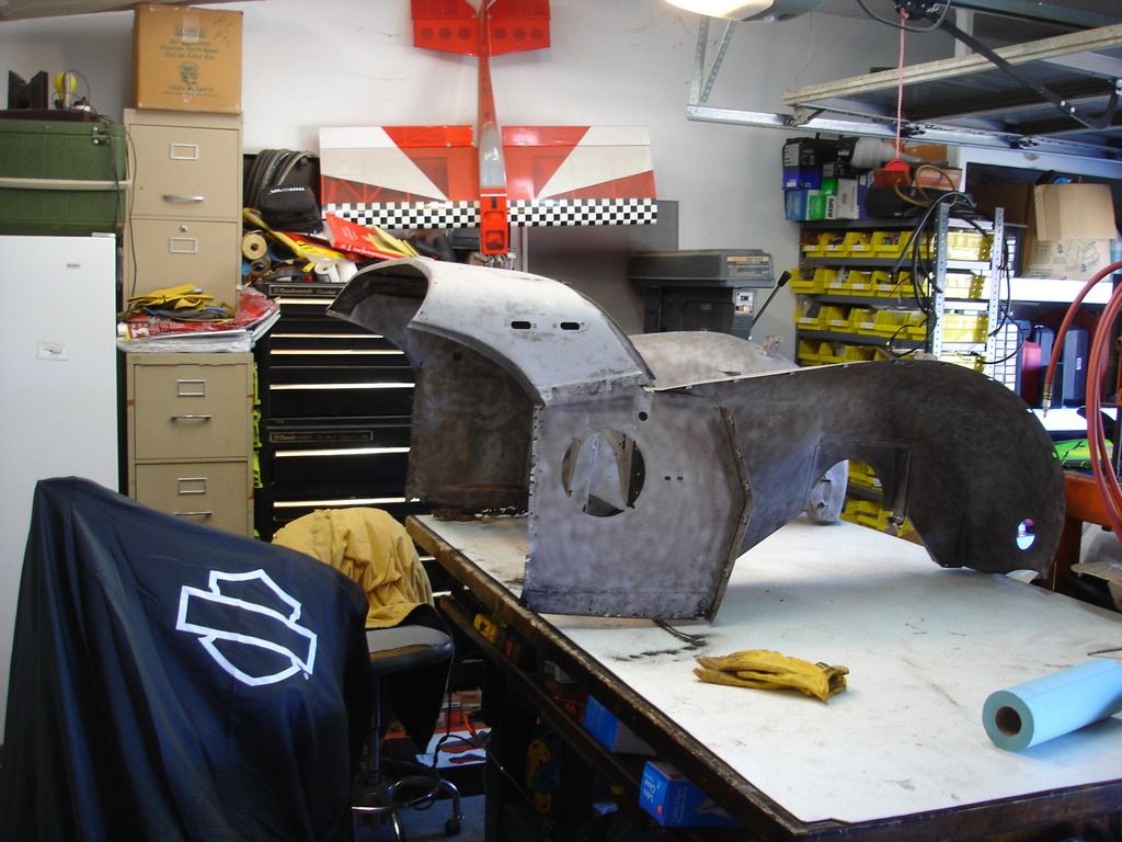

The right side was identical...and here is the front clip removed. I will be able to fit this entire part on my work bench as I patch and straighten it.

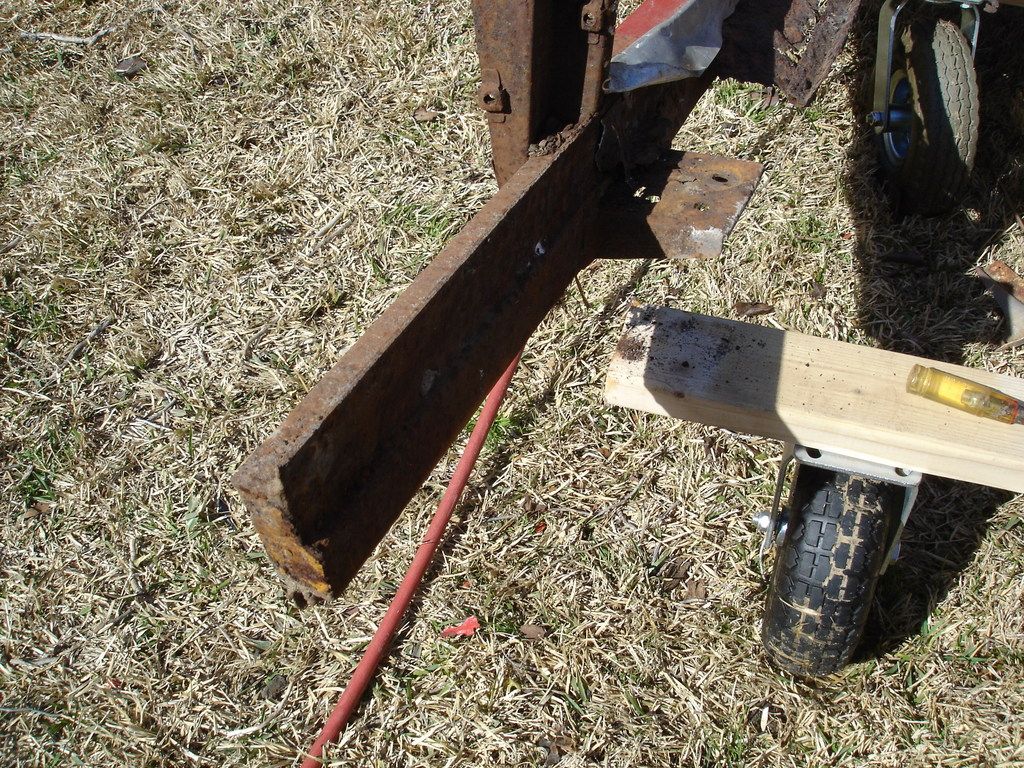

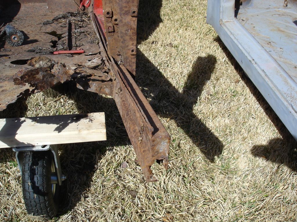

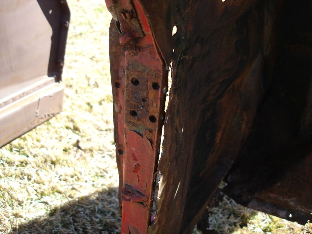

These are a couple shots of the right inner sill, where it extends forward from the A post. Other than the mounting pads to the frame, it really is better than I expected.
And the left inner sill.

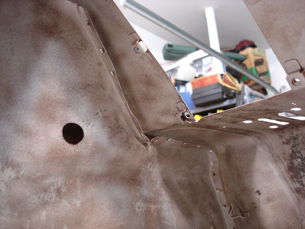

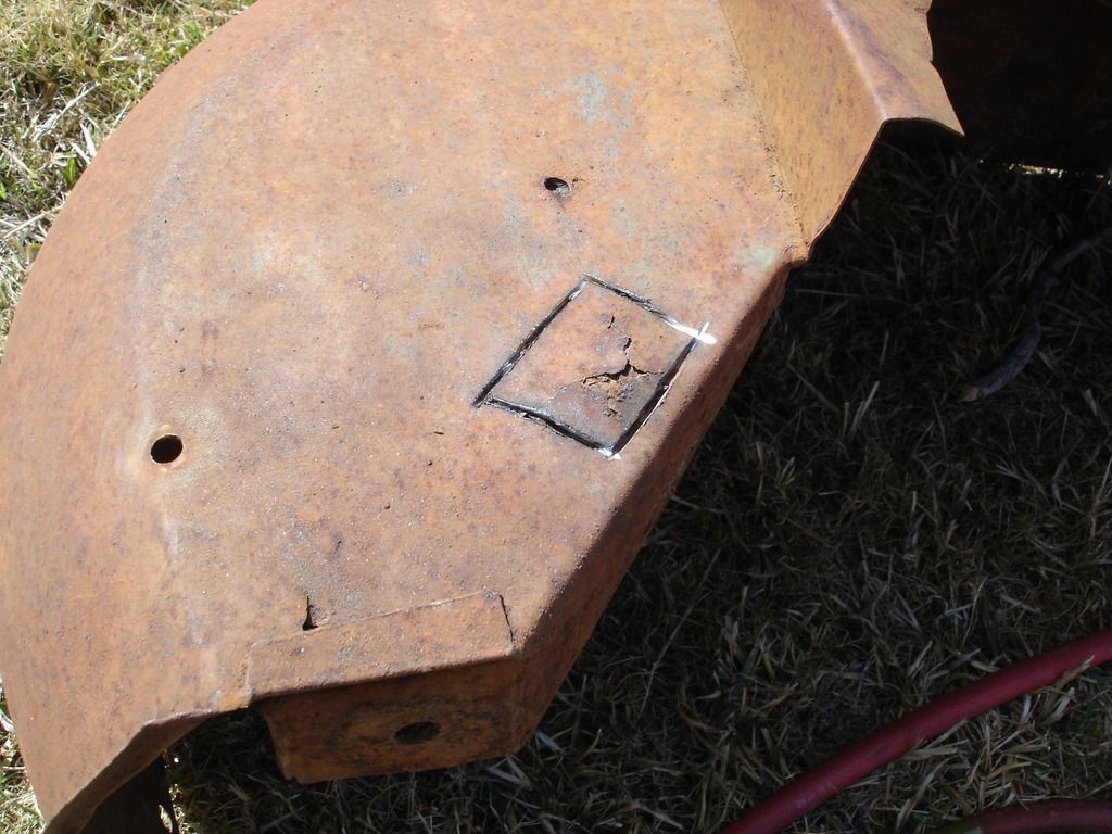

I am now prepping for sand blasting. If you remember the pics earlier, the inner wings are rusting out where the forward body mount attaches. Here I have opened up some of that area so I can get the abrasive into it and clean the rusticles out.
Commercial break....

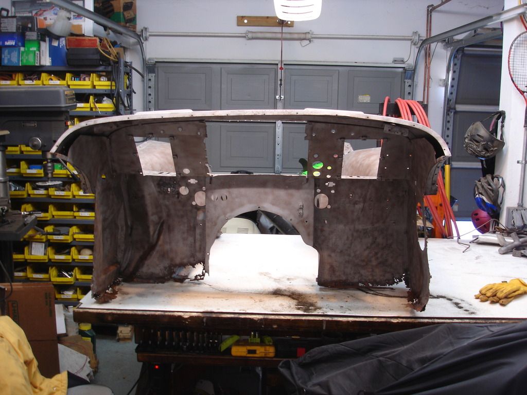

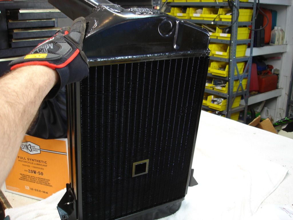

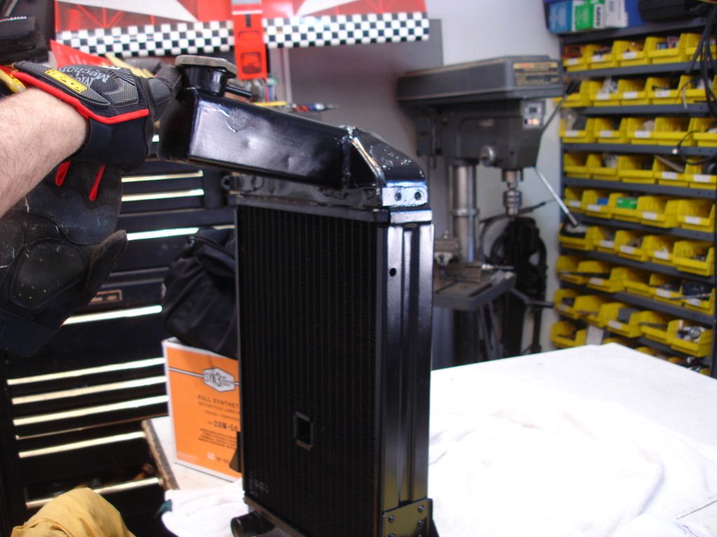

To clear my table for the front clip, I painted the frankenstien radiator. Looks pretty good with a coat of paint, huh!
So, this is the front clip all blasted and set on the table. I spared you the gruelling pain of blasting, which took about 8 hours. I even destroyed my new compressor. No prob...it's still got 2 years of warranty. This will be the last car I plan to sand blast in my life, so I will try to stretch the ruined compressor until I'm done with the tub blasting...then I'll call Ingersoll Rand to give me a fresh one. Blasting is by far the hardest load you can put on compressors.

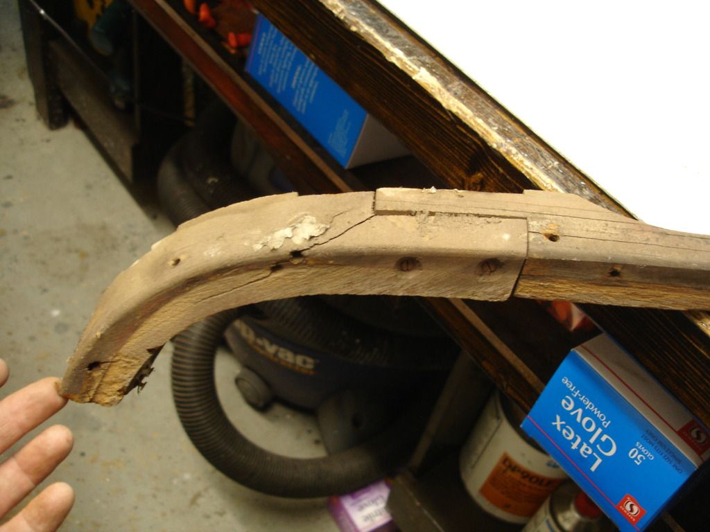

I thought I was done with my wood working for this project...
....nope.

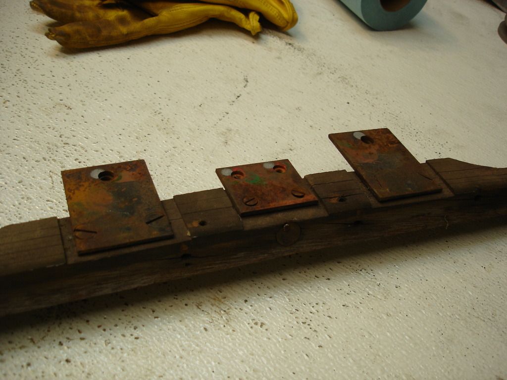

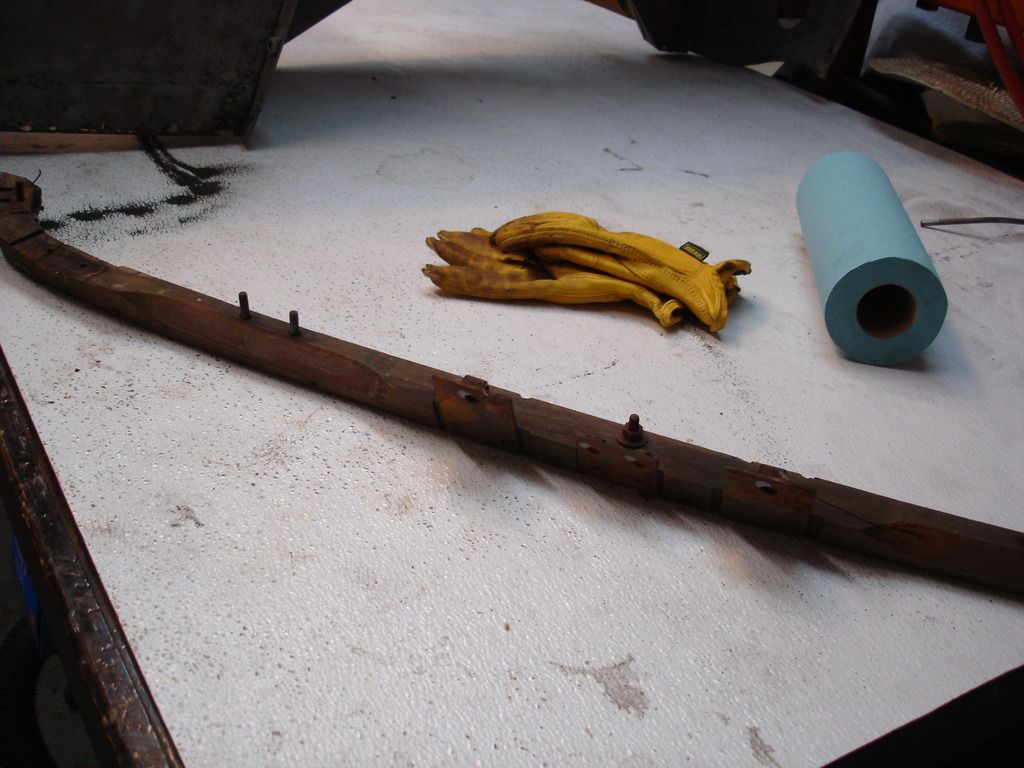

This is the dash insert. The door woods were only a warm up for this mother of all wood working jobs!

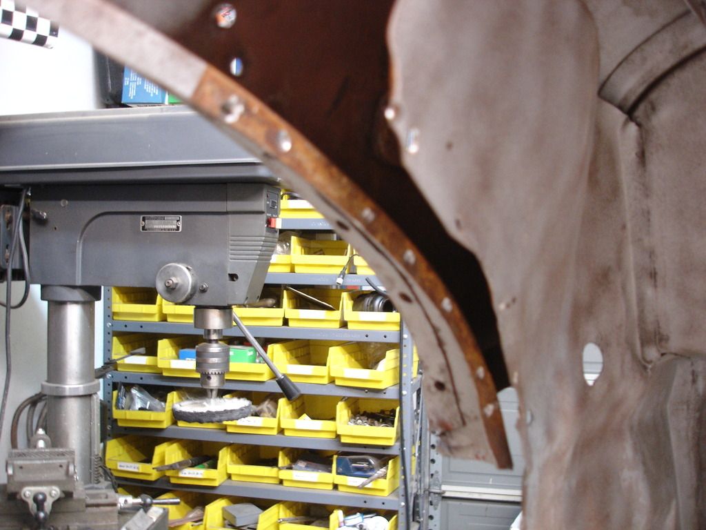

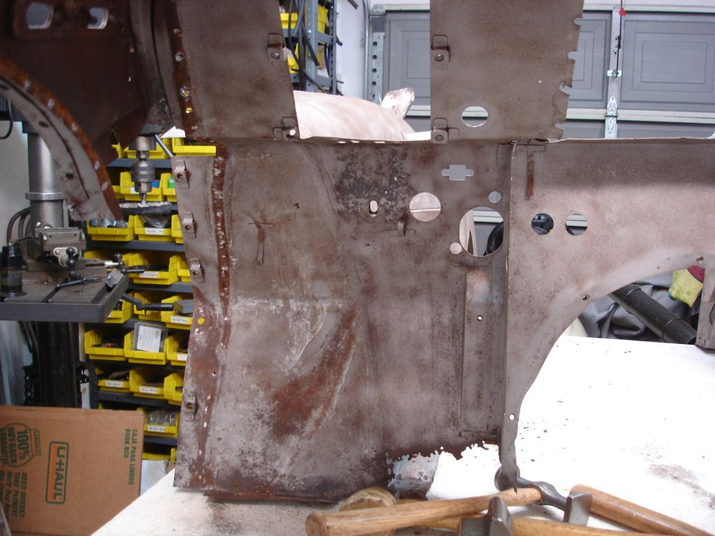

This week I start to tackle the repairs on the front clip. It is a toss up as to whether it would be easier to convert the TR3 front clip or repair the original TR2 clip. One thing I have learned is to not second guess yourself. Pick a path and stay on it ...until something knocks you off the path!

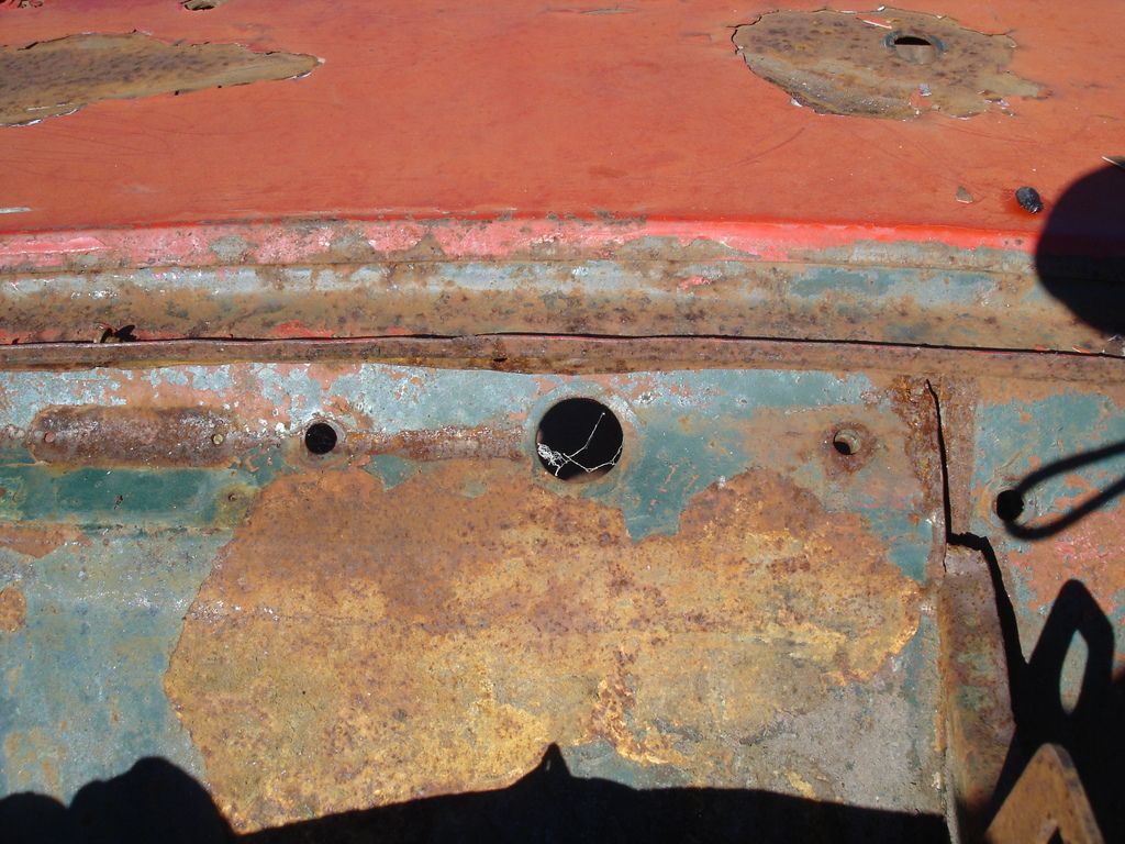

This is the corner of the scuttle, with a bit of rust through I will have to contend with. I decided to move to the opposite corner and take care of the accident damage first.
So, this is the starting point. Both the kick panel and firewall are bent like an accordion. I will first remove the kick panel to make it easier to access the damage and beat it out.
Here I am pointing to the line of spot welds that are holding the kick panel to the firewall. Just a matter of methodically drilling and splitting the welds.

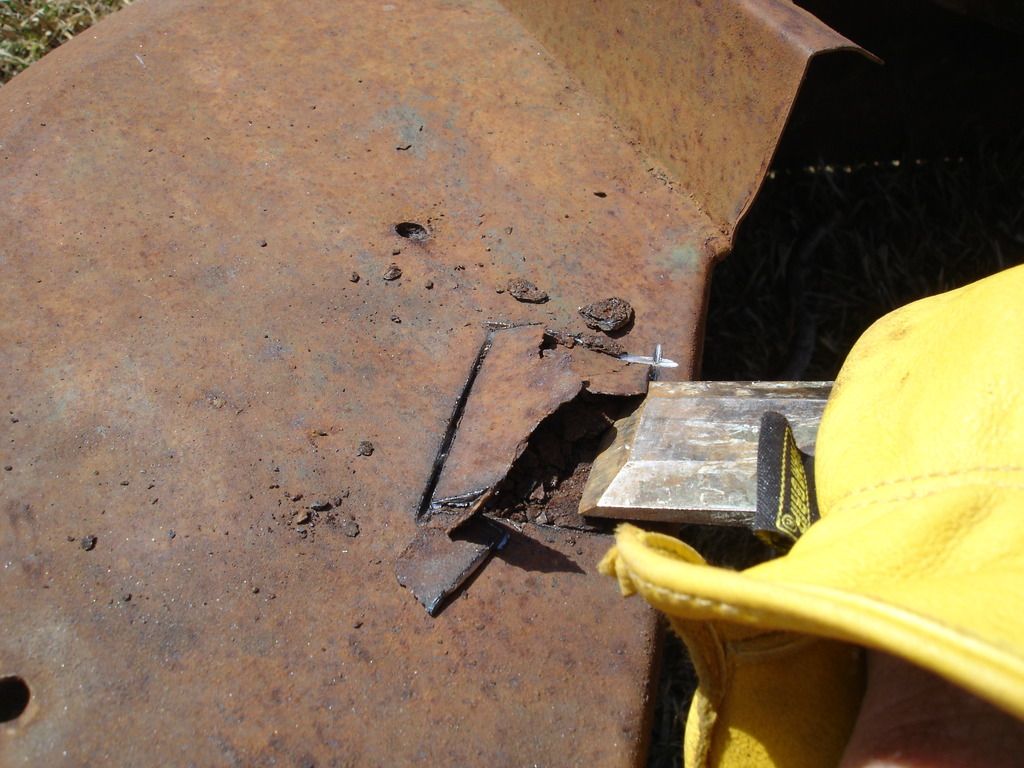

Here I have broken the welds along the scuttle. I'll keep working my was forward and downward. Nothing special...
I drill the spot about 1/2 way through using a 3/16" drill bit, and then use a sharp chisel to break the weld apart. Some pop easily, others not so easily.
Almost done.
And finished. Now you can easily see the accident damage to the driver's side firewall. I'll come back to this. For now I will fix the kick panel that I just removed.

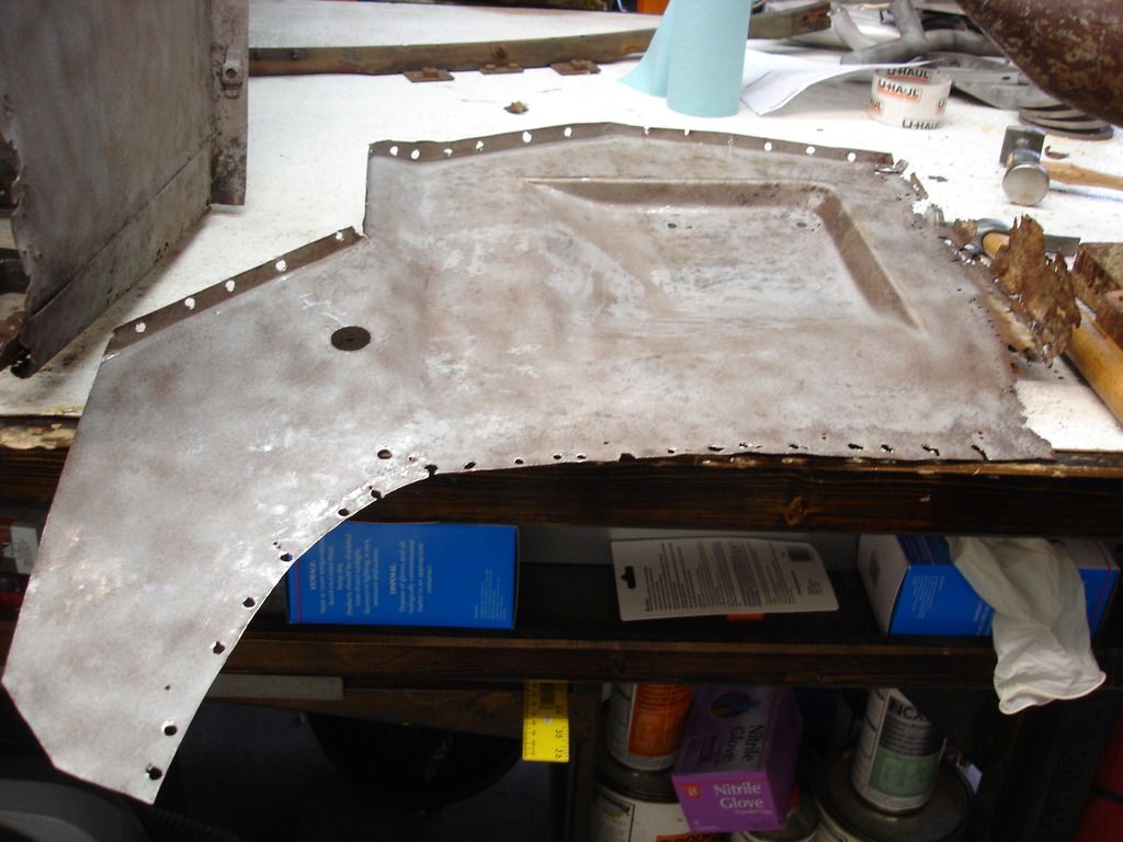

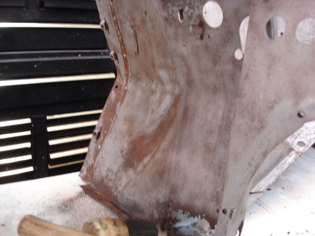

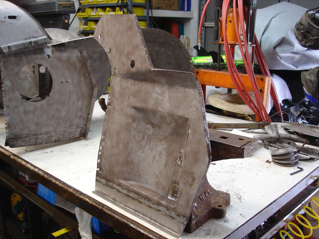

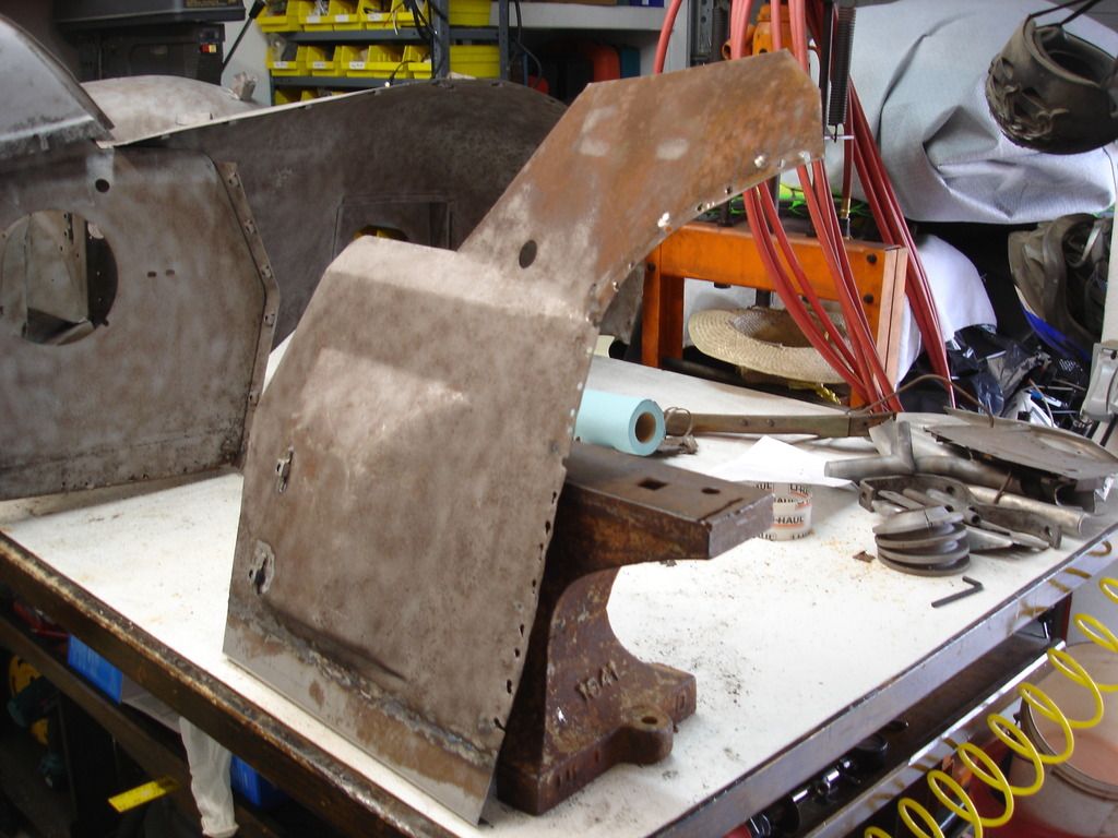

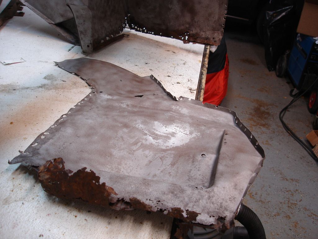

2 issues going on with the kick panel. First, I will have to straighten the accident damage. Once the panel is straight, then I will replace the rusted out section along the floor board.
Poof!! The panel is magically straight! I wish. I used the anvil as a dolly and just gradually worked the metal into shape. The anvil is not required, but using it for a backing frees one of my hands to align the panel for each tap.
Now to replace the lower rusted out section. Here, note that I always straighten the metal first, and only then do I replace any metal. If you replace metal on a bent panel, you will lock in the bends and may not be able to ever remove them.
If you study this pic, you will notice that some of the floor is still attached, looking like double metal. Originally, the kick panel had a 1/2" bent ledge along the bottom, which rested inside the floor pan.. That 1/2" ledge is gone, so I will have to duplicate it.
Also, if you look closely at my index finger, I have ascribed a line precisely 2" up from where the ledge will be. I made it straight, and I made it 2" so I can keep a reference after the bad metal is sheered off.

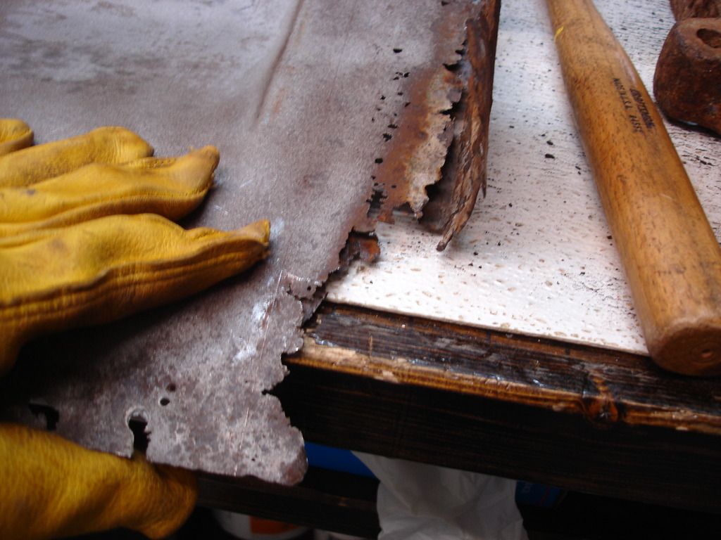

I then formed a bottom section from fresh 20 gage metal to weld on to the cut edge. I've done this a good 2 dozen times, so I am sparing you the details.

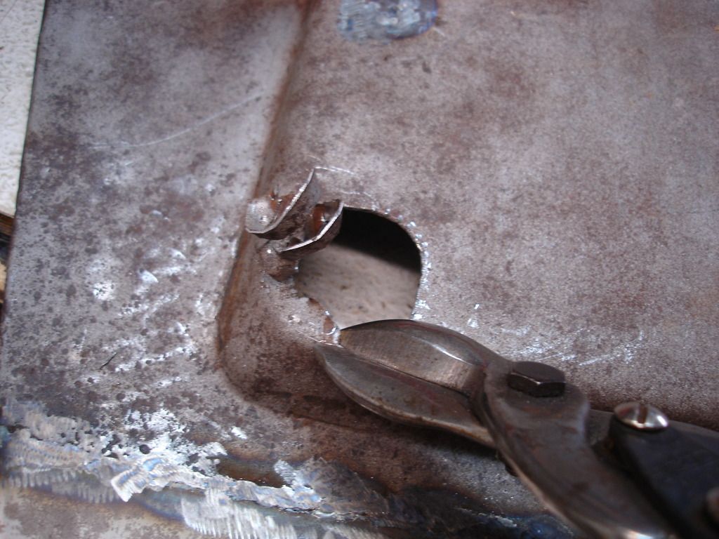

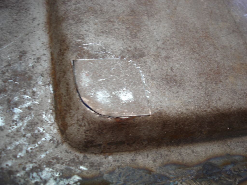

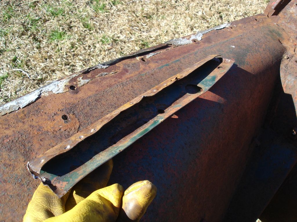

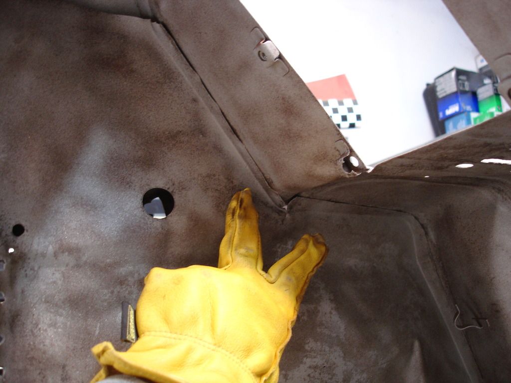

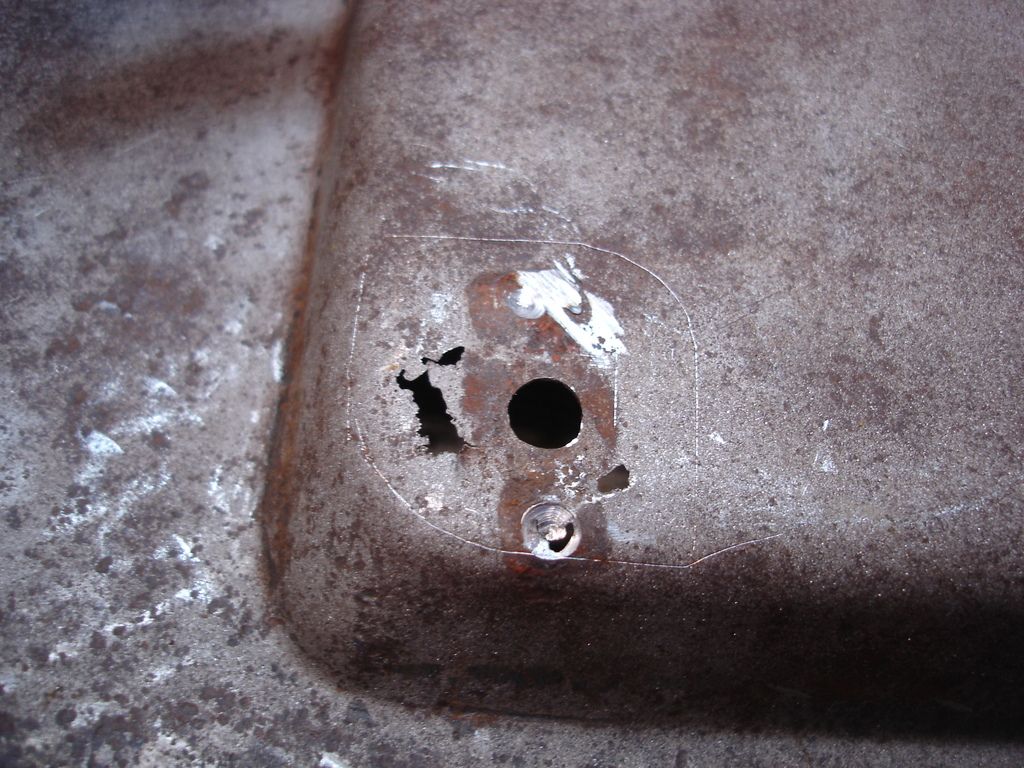

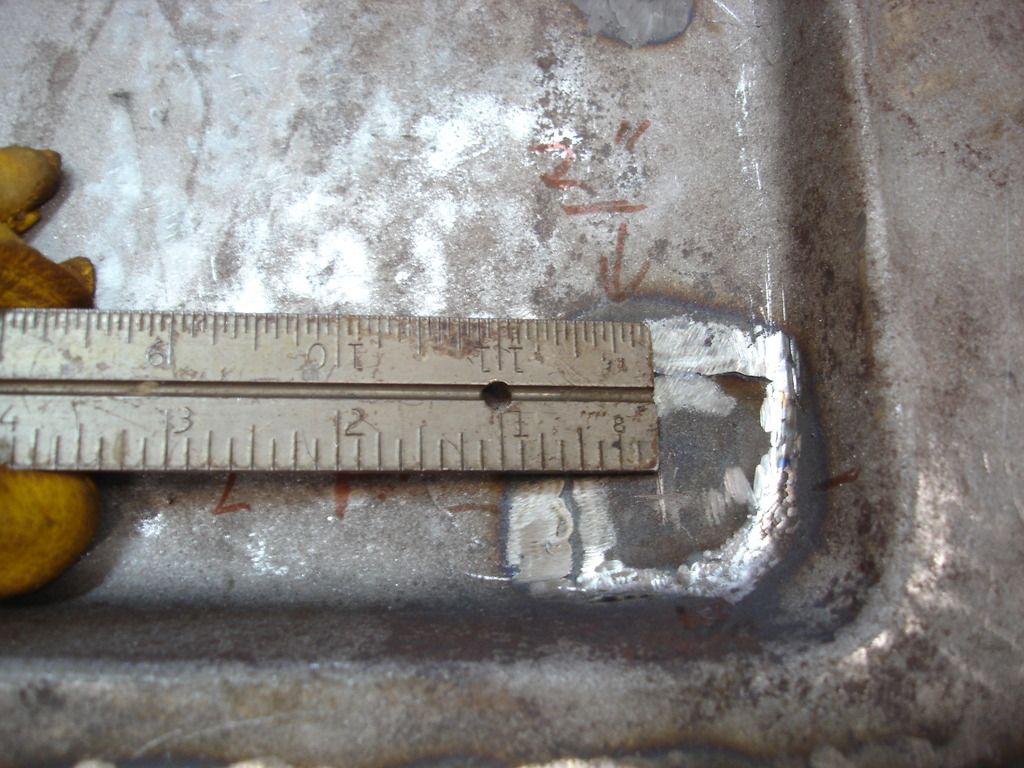

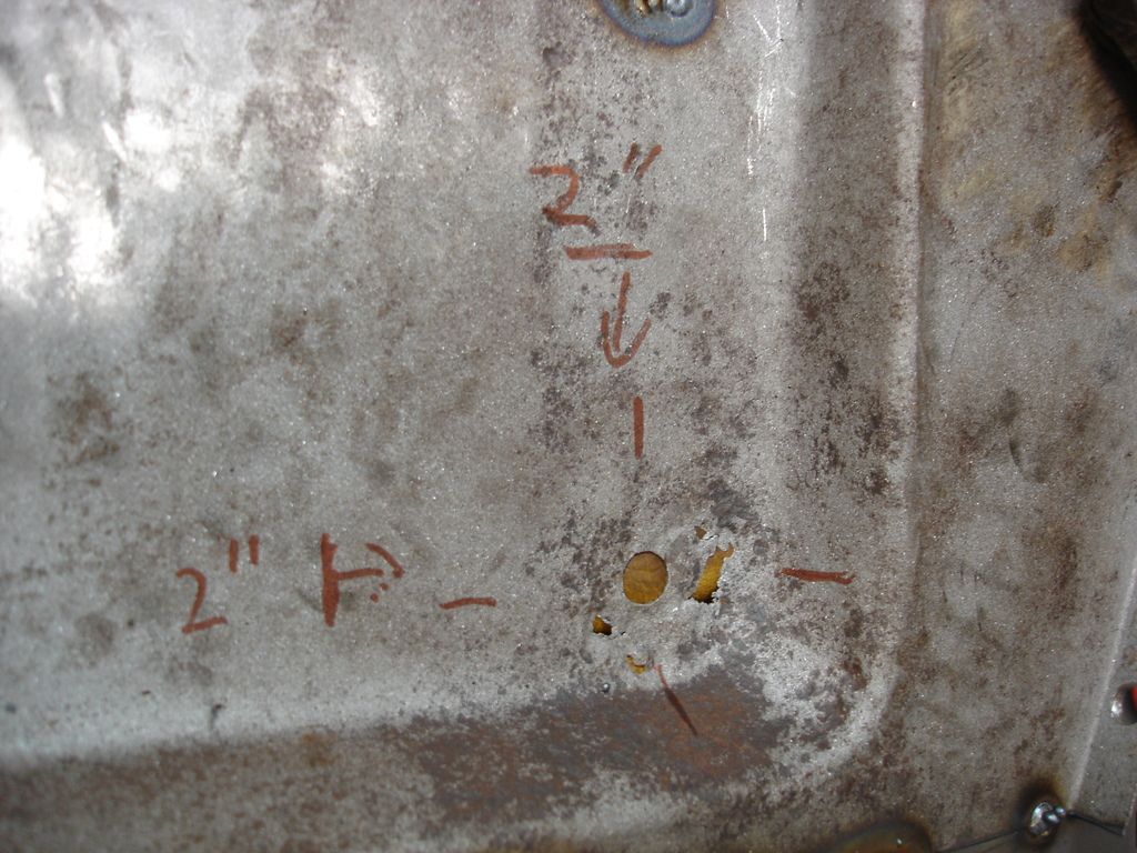

Here is the lower mounting hole for the headlight dimmer switch on the kick panel. It is rusted out around the hole and the entire area has to be replaced. This presents a challenge...once I remove the metal, how do I know where to put the hole after?

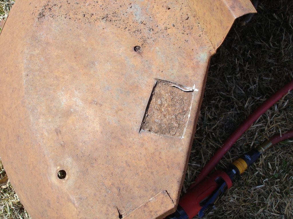

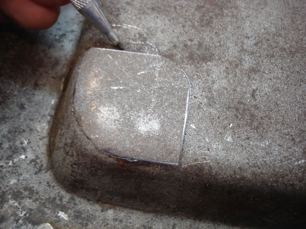

The solution I used here is to mark the panel in a section far enough away from the repair that I can find the references later. In this case, I marked a 2" reference to locate both "x" and "y" directions.
I marked the area to be replaced, but before I cut it out, I shaped the replacement patch. The lower pic shows that the 2 edges have a slight curve I had to beat into the patch. Before I cut I could use the original as a pattern. If you cut first, it would be difficult to get the bends right.

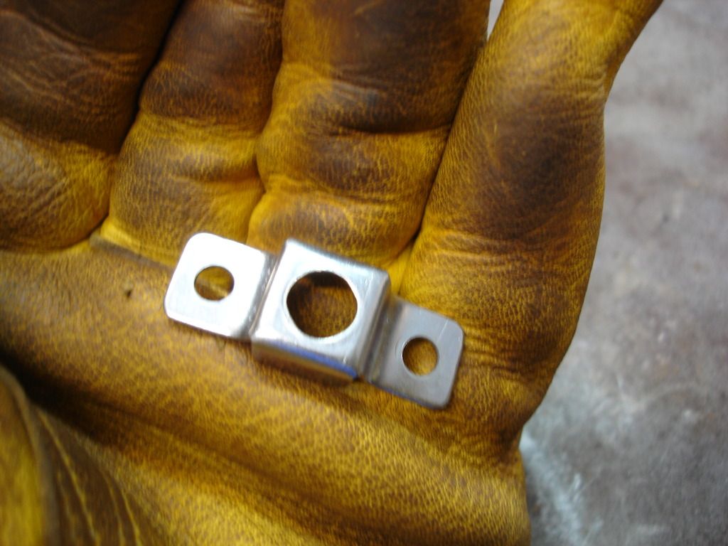

And the patch is in place. I re-cut the hole using my reference points, and now only have to add the caged nut to the back side.

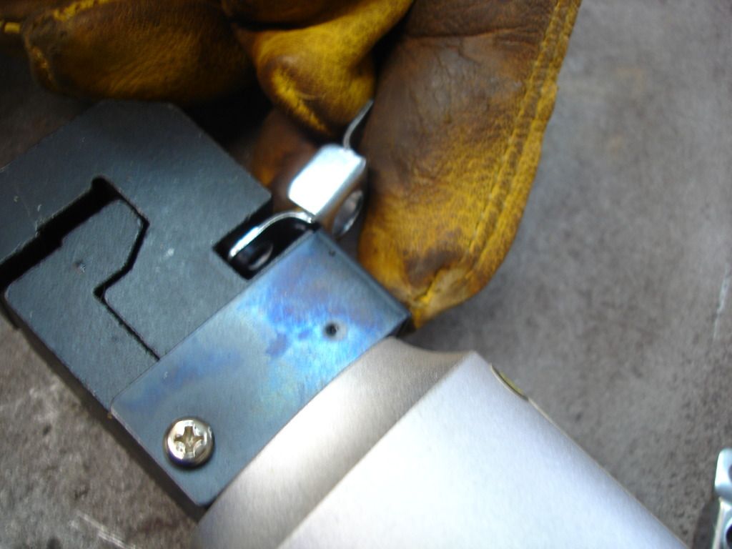

To emulate a spot weld, I punch 2 holes into the new cage. I will then hole-weld through these holes.
And the kick panel is done.

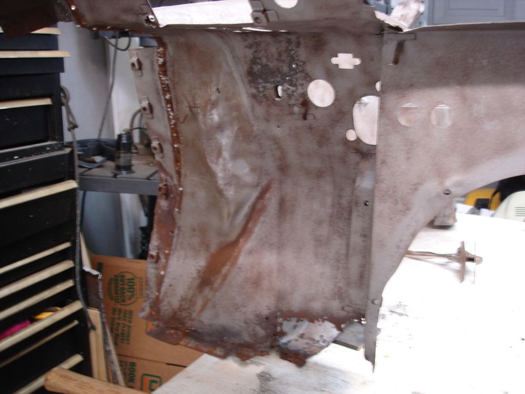

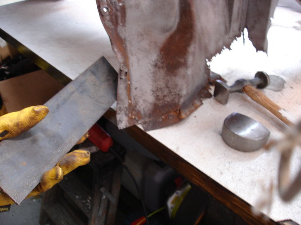

Now for the firewall. The severity of the damage poses (another) problem. If I just start beating the panel, I will end up with hammer dimples that will stretch it badly. Here I am showing a large 1/4" thick steel plate that I will use as a dolly. It has to be large to span the distance between the rumples in the metal.
Note....I really wanted to press this area out, by using 2 plates like I have in the pick. I could then clamp the plates to both sides of the firewall and use "C" clamps to press the whole panel at one time. That would avoid any hammer marks. But...I didn't have another steel plate, and going to get one would take more time than just using the one plate and a hammer. I mention the pressing technique as an alternative to those who follow.
This is about half way through the process. I am holding the plate on one side and hitting the high points on the opposite side. Do not hit so hard as to create hammer dimples. Just keep working gradually to minimize stretching. I am also alternating sides for the hammer and dolly...being ambidextrous would be nice for hammering left handed!
About 3/4 done. Again, this cannot be rushed. Study the dents and work them out by backing the lows and tapping the high spots. Because of the large area envolved, I had to work slowly across the entire panel, so as to only straighten a little at a time, then go back to the beginning and work slowly across the panel again.
Here, I have beat it a good as I can. The areas that are not straight have been stretched. Stretching was inevitable in damage this bad. So, now the process changed back to the shrinking technique. This is:
Find the spots that oil can.
Heat that spot red hot.
Before it cools, hammer and dolly it back to straight.
Repeat with the next oil can spot.
Anyway...this is as far as I got this week. For the coming week I will shrink the firewall to perfect shape and then replace the lower edge that is rusted out.
