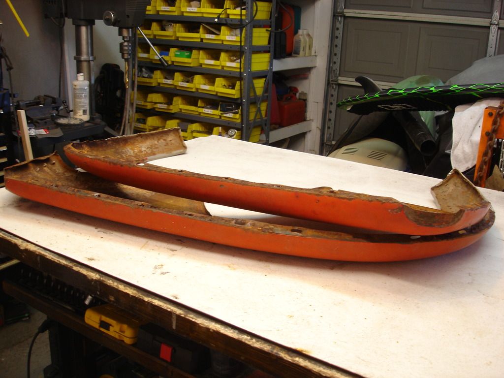

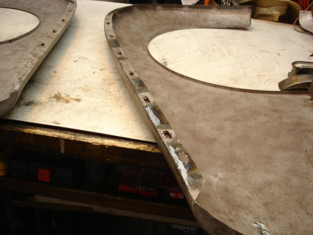

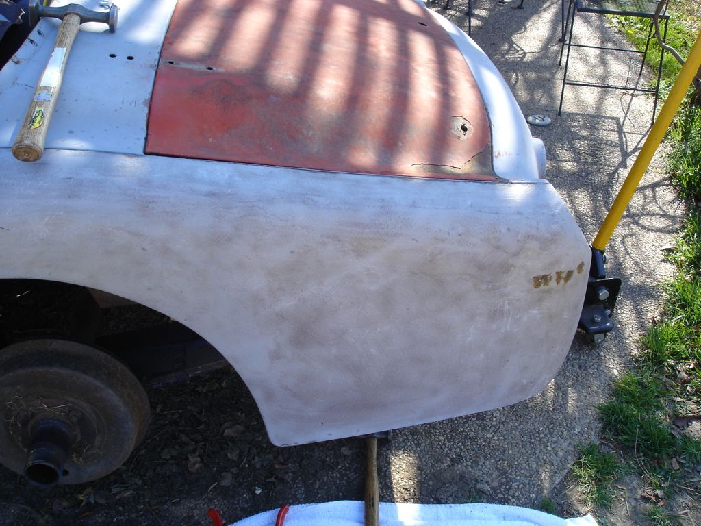

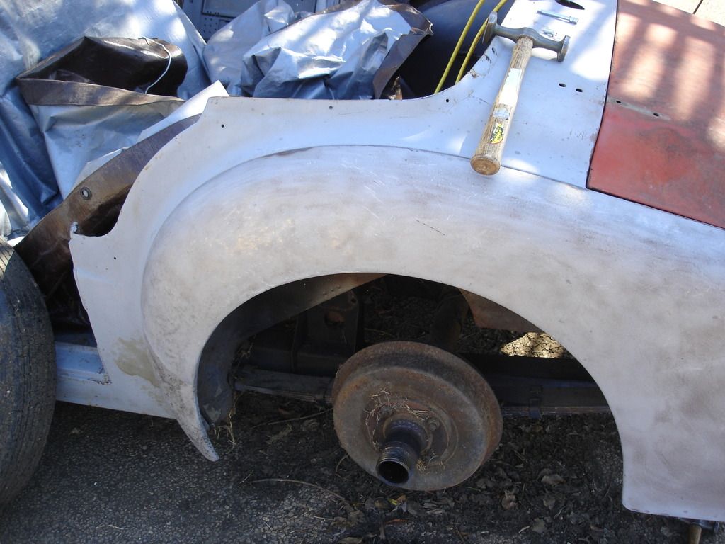

So, here are the 2 original TR2 rear wings. Compared to the front wings, there is little to them. They are merely a single sheet stamping. The only bracket is the small stabilizing bracket that is about 2" by 1". I also pulled the wings off the donor car, and it turns out I will be using the left from the original car, and the right from the donor.
Quick preview shows there is bondo and drilled holes in the right wing at the rear.
This is the lower rear corner where it bolts to the rear valence panel. The tab is torn.
As mentioned, the stabilizer bracket used to be here. No telling where it went. Luckily they are still on the donor car panels, so I can get one from there.

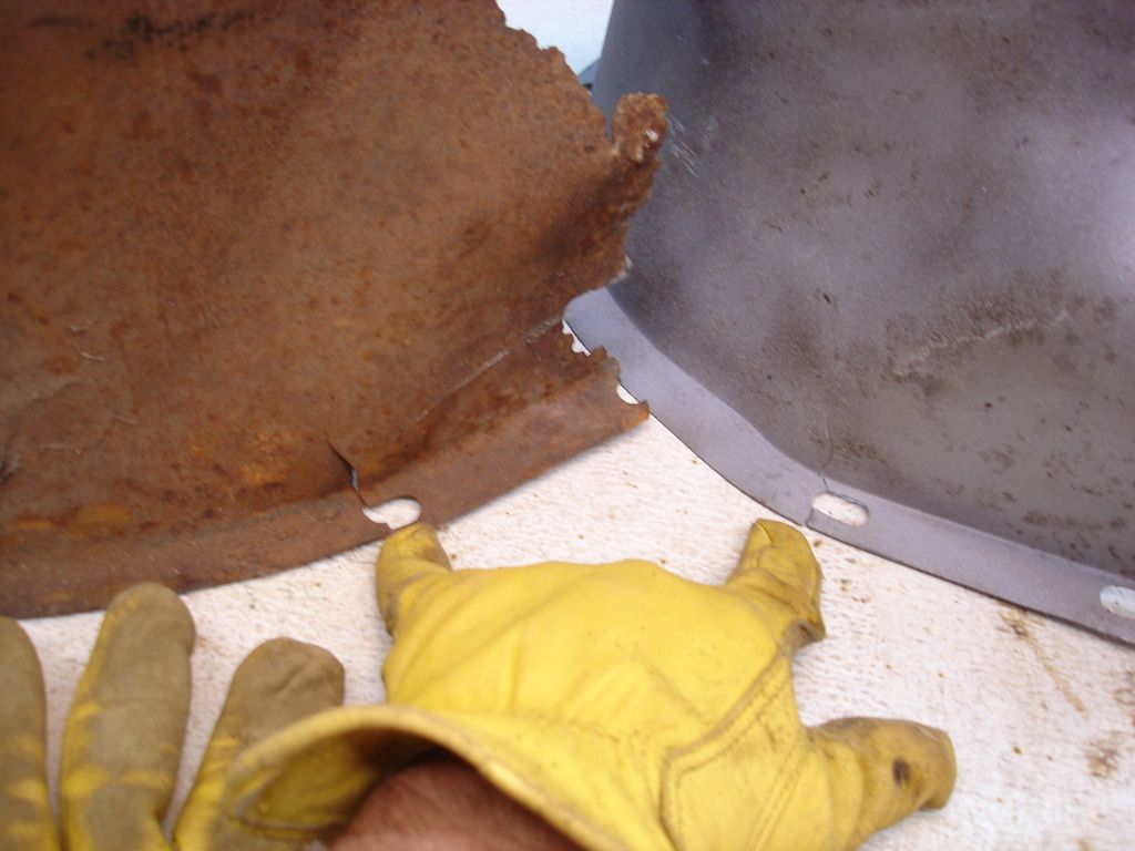

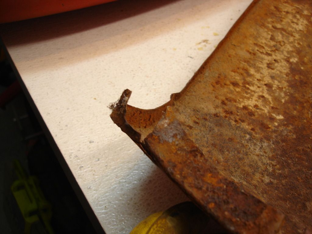

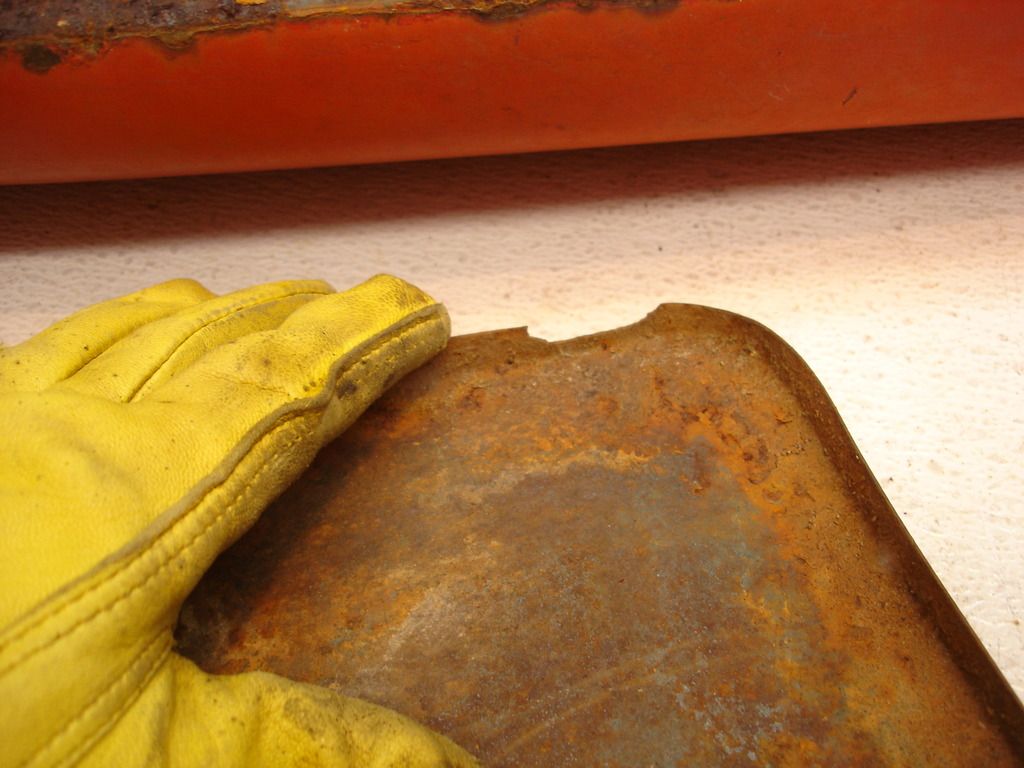

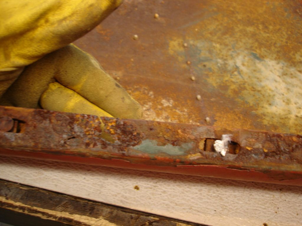

The main damage on ALL of the panels is the mounting tab along the top. Here you can see the tab is rusted away, and all the bolts had to be cut to remove the panel.

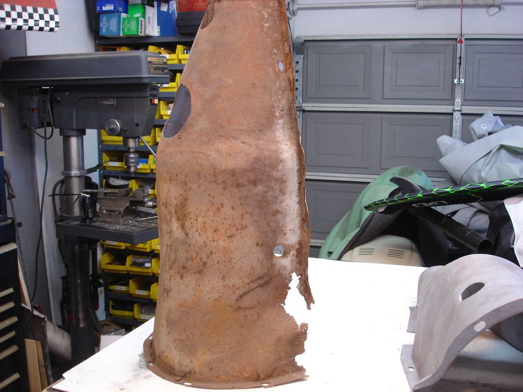

With the preview over, it's time to get to work stripping. Here is the original left panel I will use after heating and scraping with the torch and gasket scraper. It's actually much better than I was expecting. The main body is NOT rusted through for a change! Bonus! The main issue will be replacing the rusted out mounting tab.

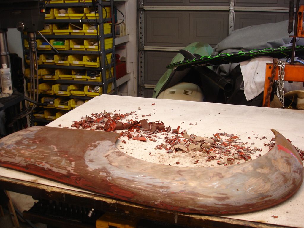

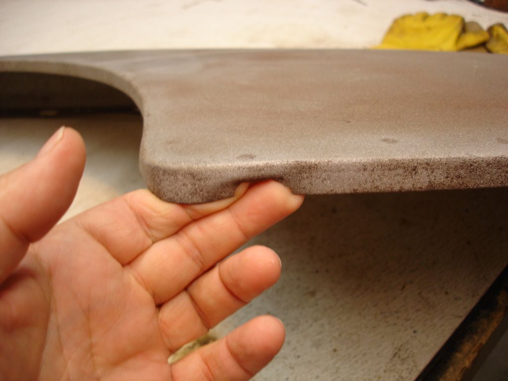

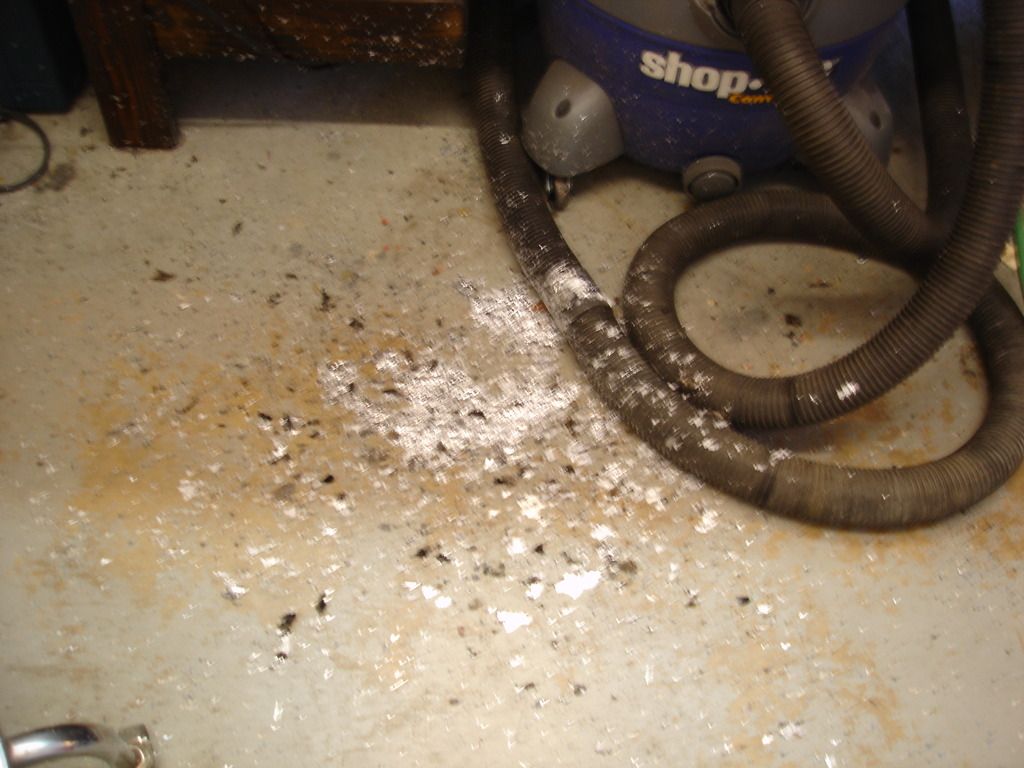

The donor car is another story. When I picked up this wing, it weighed more than double what the other wings weighed. Lead! No problem, though. Once again the torch comes out and the lead drips off. Guess I should have moved the vacuum hose. Bummer. It took longer to clean the lead off the hose than it did to get it off the wing.
In addition to the 10 pounds of lead on the floor, this is the bondo that pealed off. You can see some fiberglass cloth in the pile. This was on the donor wing. I am not certain what the PO's thing was with glass cloth...but he/she seemed to put it everywhere. And, of course, every time I peel it off, there is always a surprise underneath. On the front wings, the surprise was that the wings had been beat with a ball peen hammer. This time the surprise was that the panel is good underneath...for a change!

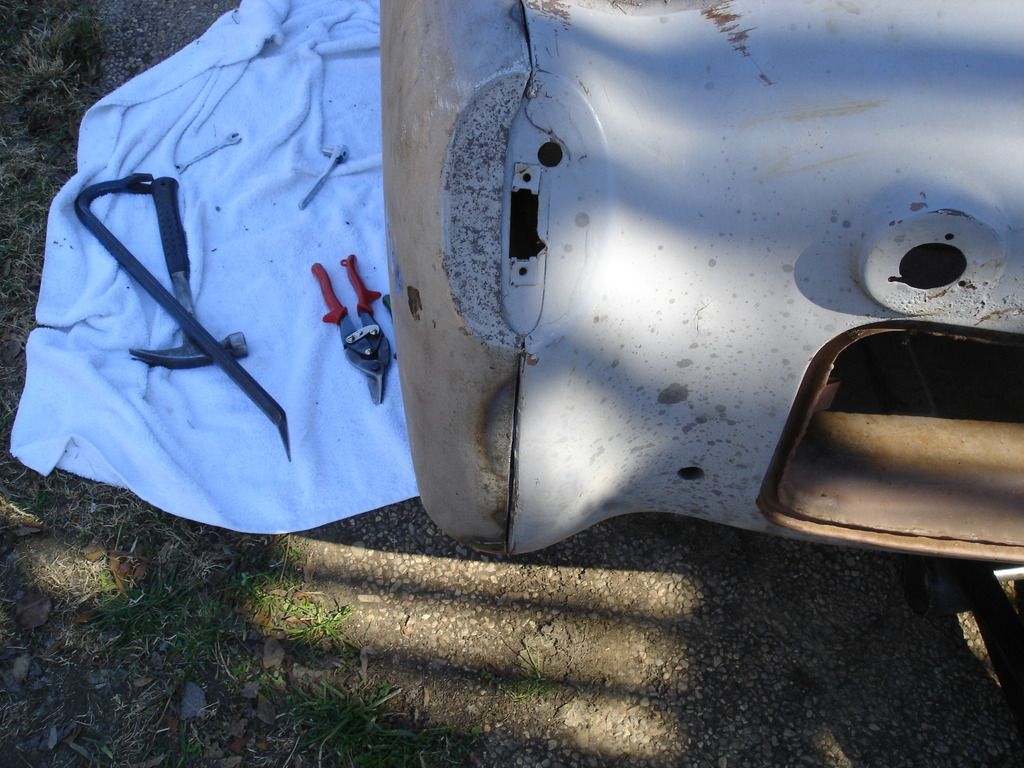

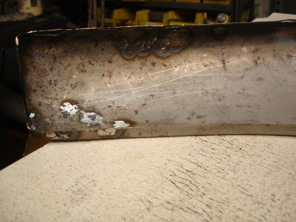

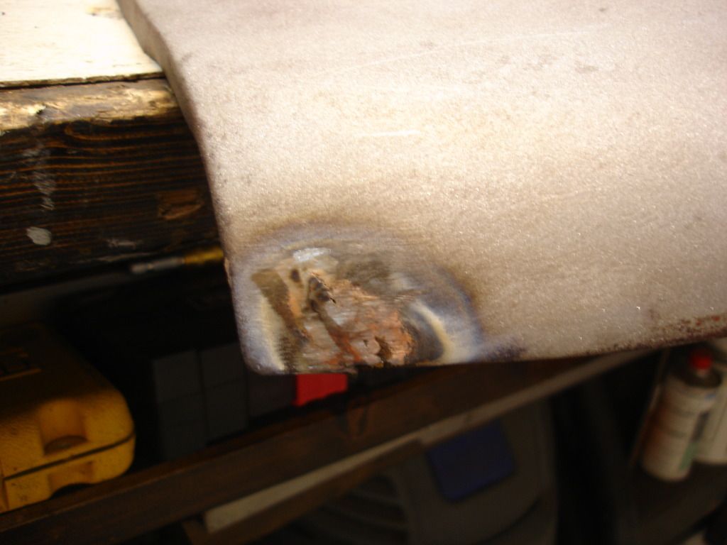

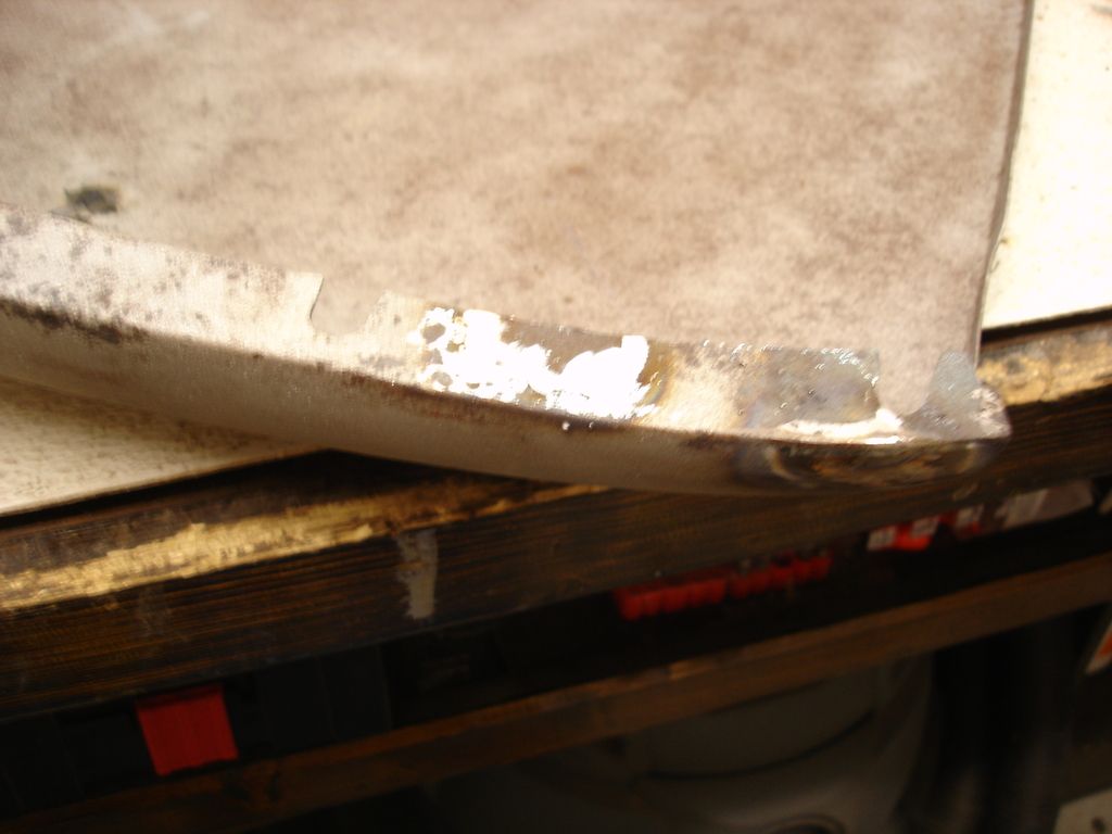

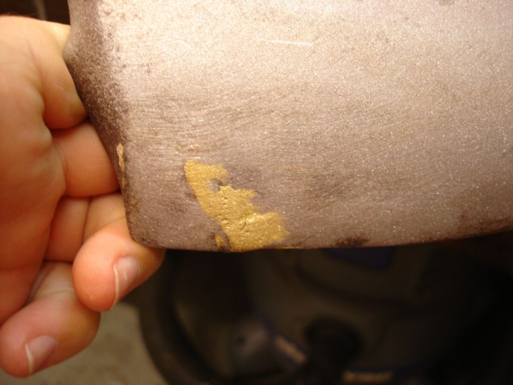

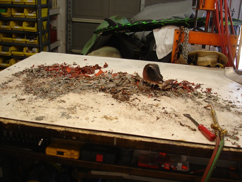

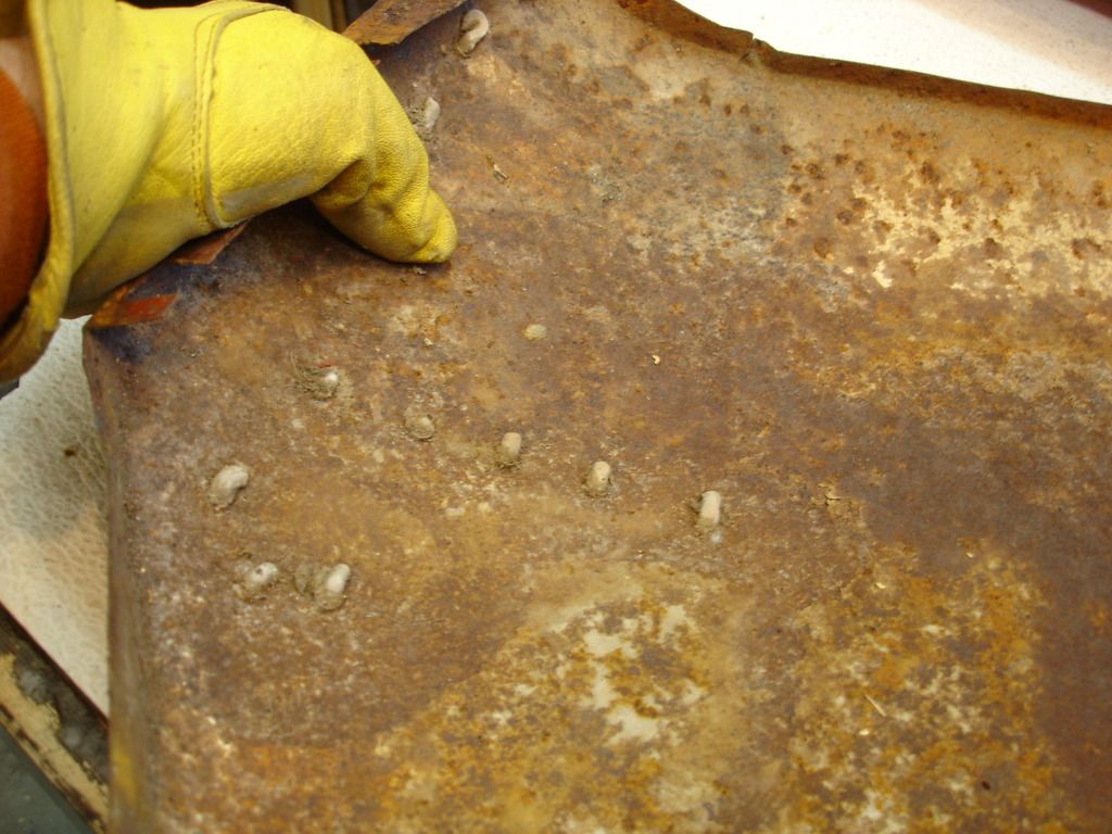

This is the lower rear of the left wing. I really don't get body shop's infatuation with brazing. It takes an oxi acetylene torch, bronze rods and special flux to braze. If you have a torch, why not just weld it?? You already have the torch, flux is not needed, and you can use any scrap steel you have as filler. I have even used old couch springs in a bind. Oh well. Like the lead, this will come off.
The area gets heated until the steel glows, and then I rapped the panel on the table. The bronze falls free.
And I'm back to basics...just a steel slice that needs to be welded closed.
Like so.

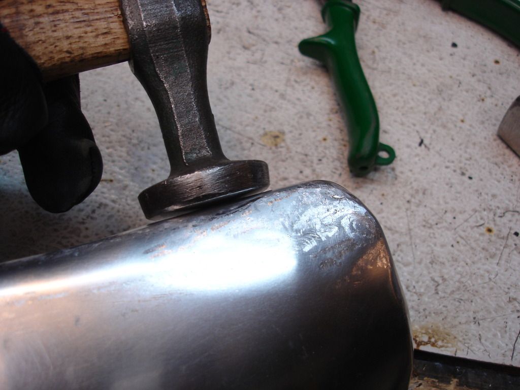

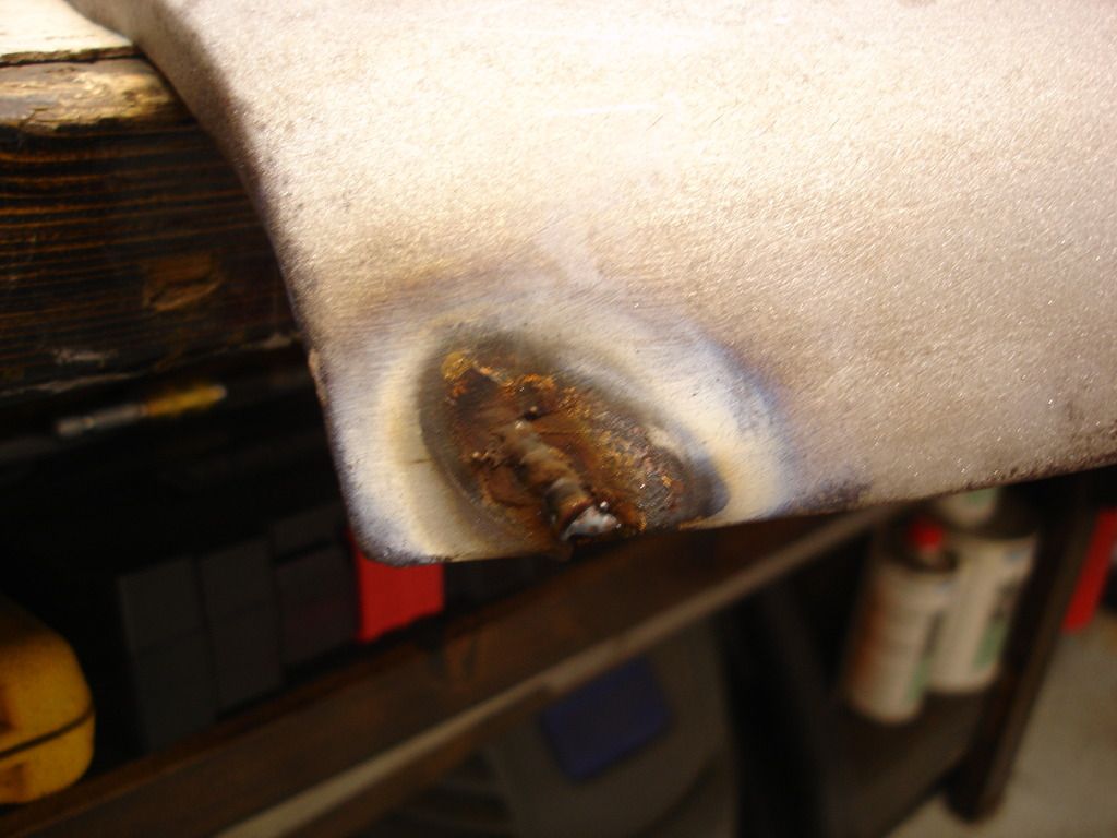

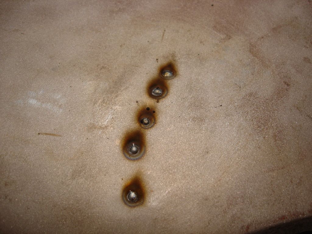

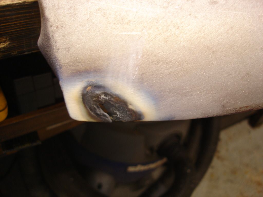

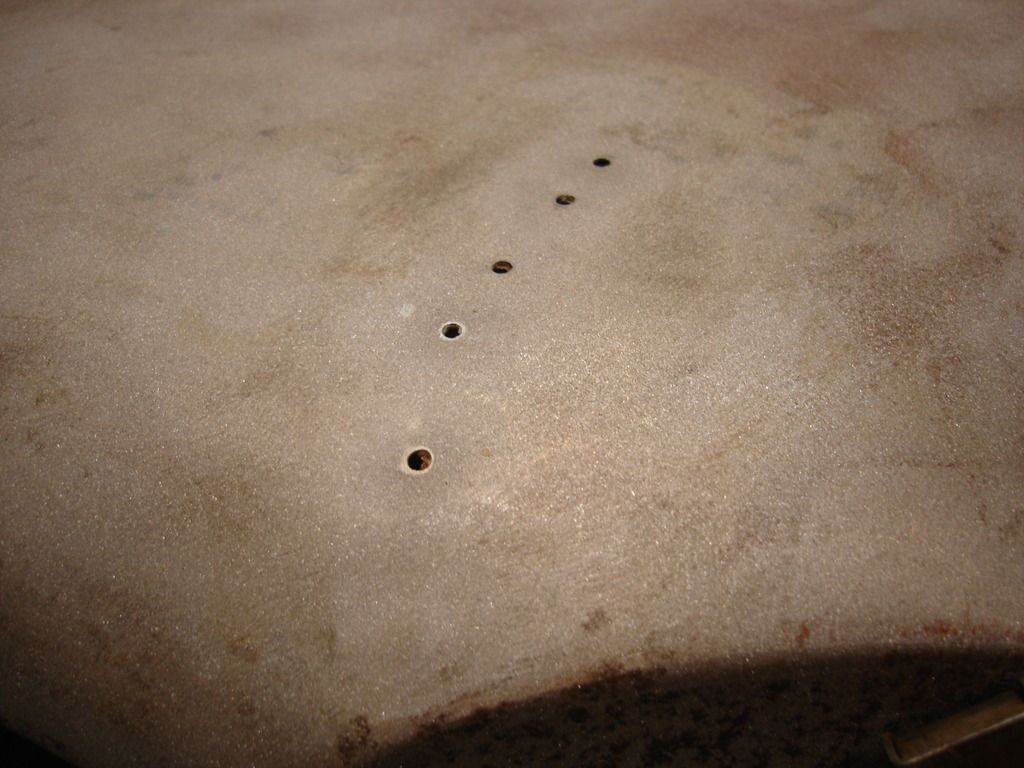

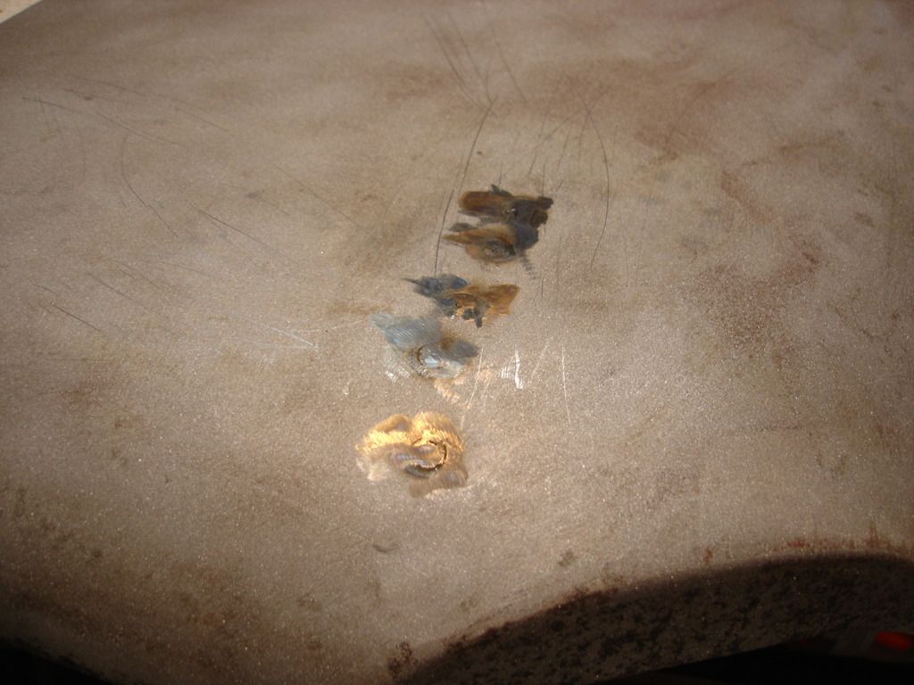

Next are the holes drilled by the last body shop.
Here I have hammer and dollied the area to straighten it out. You do not want to weld the panel if it is deformed. That would lock in the deformation, making it very difficult to straighten later.
I find it interesting that the first thing I have to do to fix THEIR damage is to properly fix the wing the way it should have been done to begin with! I assume most body shops had no idea how easy it is to unbolt these panels to work on, negating the need for these drill and pull techniques needed with welded-on panels.
15 minutes later the holes are filled and smoothed. Moving on....

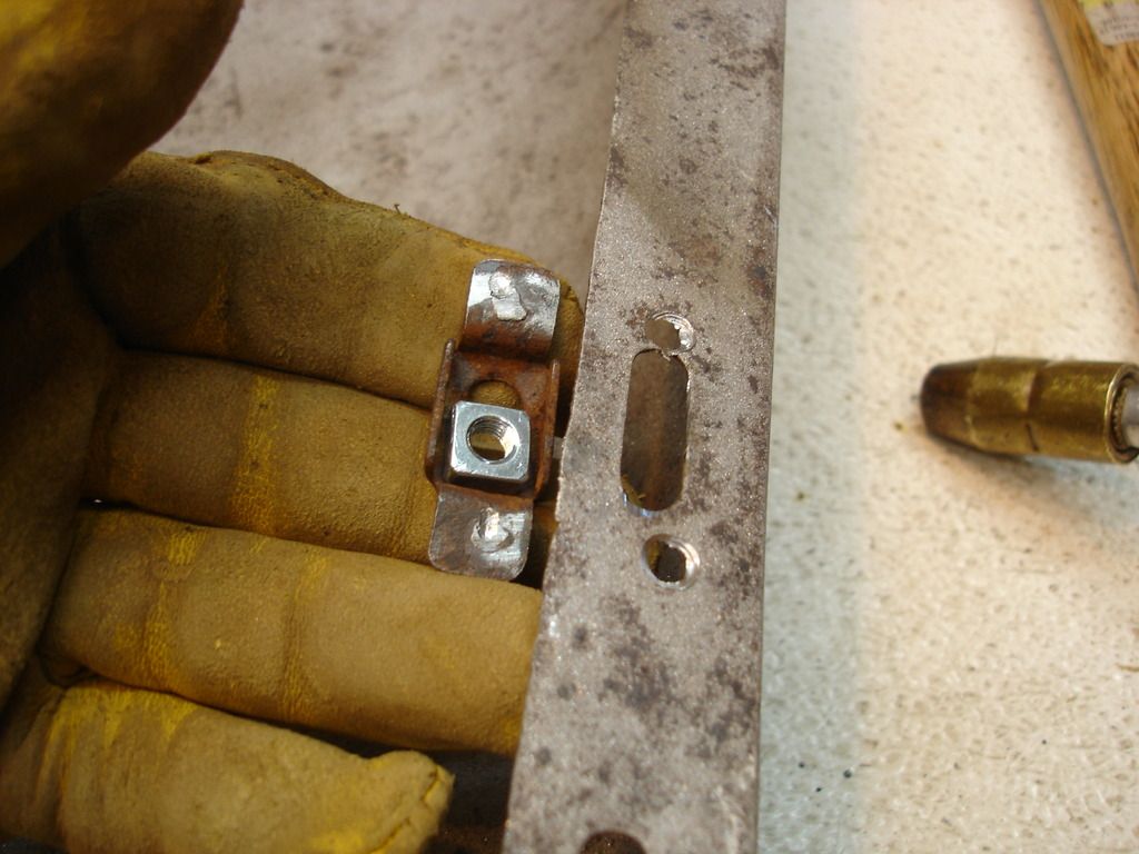

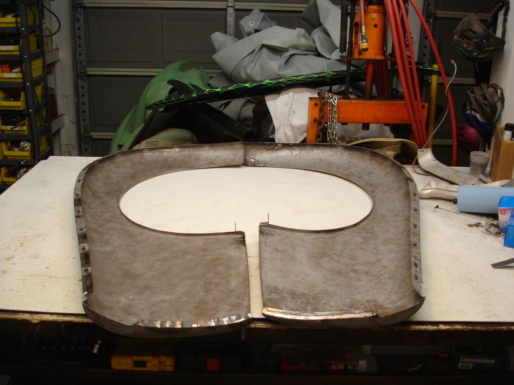

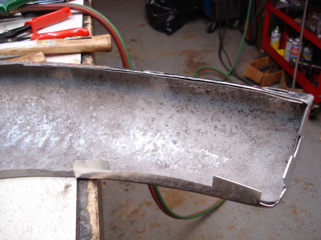

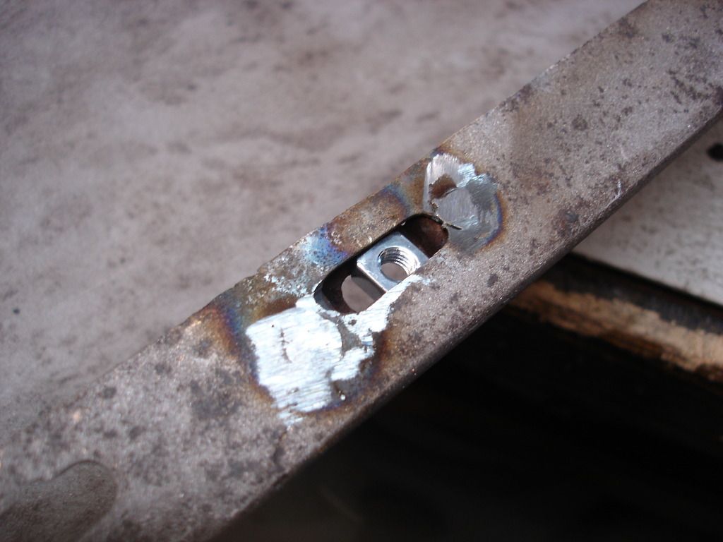

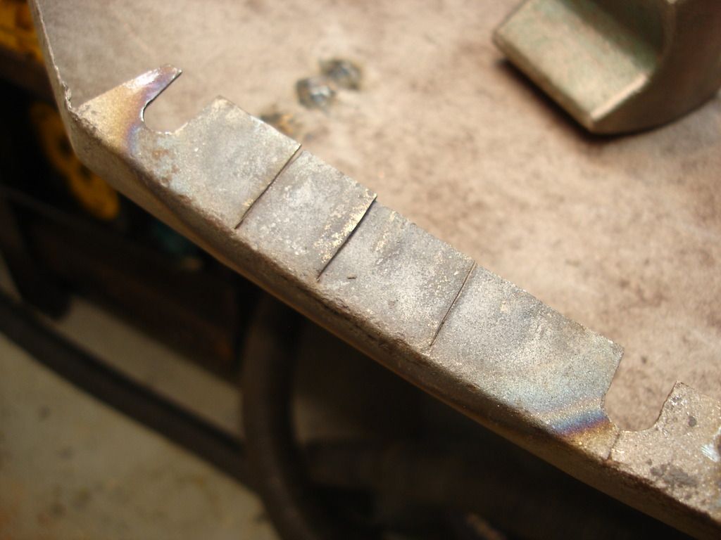

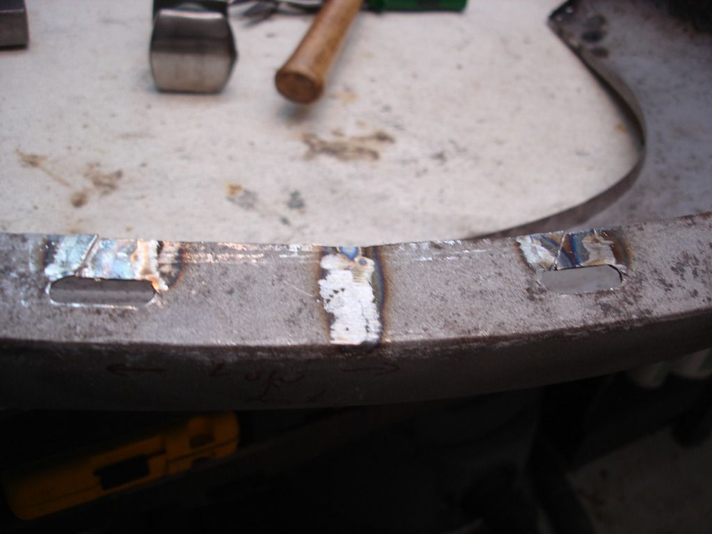

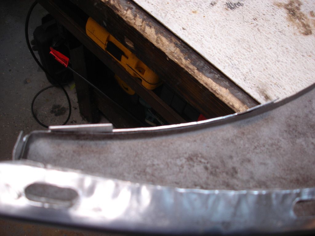

I counted 5 areas on the mounting flange that will need patches. Here I am starting at the rear end of the left wing with the first...
And methodically moving forward. Notice that as I go I am removing the square nuts from the cages. The cages are decent, so I merely pry the side of each cage open and pop out the square nuts. There are too many, so I have ordered a dozen nuts from Moss.
Finishing the week, I have only 1 more flange patch, and will have to transfer the stabilizer tab over to this spot on the left panel.

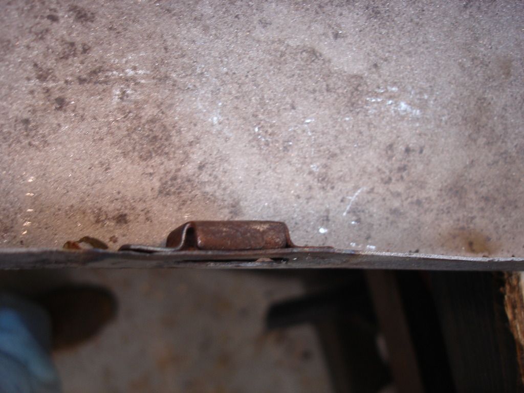

John did you notice how the nut cages are longer on the rear fenders? Did you happen to find source for them? Yours looked pretty good, but on mine the PO cut them off. I guess I could bend something up or just hold a wrench on the backside. Or cut them off a worse looking fender….OH great work, I learn a lot from following along. I tried some butt welding that I saw you do and fixed the hood prop by fabbing up a piece and welding the two together without a lap then grinding the piece to shape. I would not have tried it, but you make it look too easy, so I had too try.
Steve
Since I've been reusing all the cages, I hadn't noticed about the rear cages being longer, but it seems like I do remember something like that when I was doing the TR3. On that car I replaced the cages and nuts on every location that the nuts were bad. The TR3 was in very decent shape. I'll see if I can find the old receipts to see if I bought different style cages and where they were from.

Thanks, Tim. Is it the "tab" cages at the bottom of the page? They would work, but don't look like they give the same freedom of adjustment that the originals did.
The cage/nut situation is worse than I initially thought. I have plenty of the original cages to remove from the other nasty wings...but the new square nuts are so small they spin in the cage AND fall out! I just did a search, both by feet and Google for nuts. There are none. 1/4-28 is not available anywhere.
Right now I am vacillating about whether to weld tabs on the tiny nuts from Moss, or just fab my own square nuts from bar stock. It's funny how many minuscule problems slow you down on a full restoration. This should be a non-issue, but it turns into a show stopper. I waited a week for these nuts/cages to arrive.

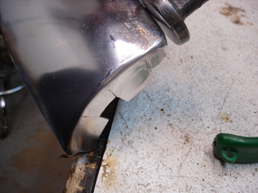

The donor wing was a sieve behind the stone guard. These guards cause more damage than they prevent. Here I have plugged all the tiny pin holes.

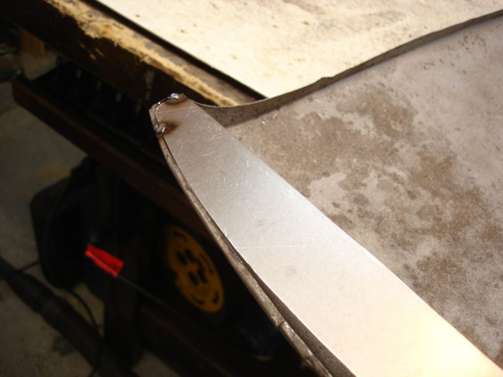

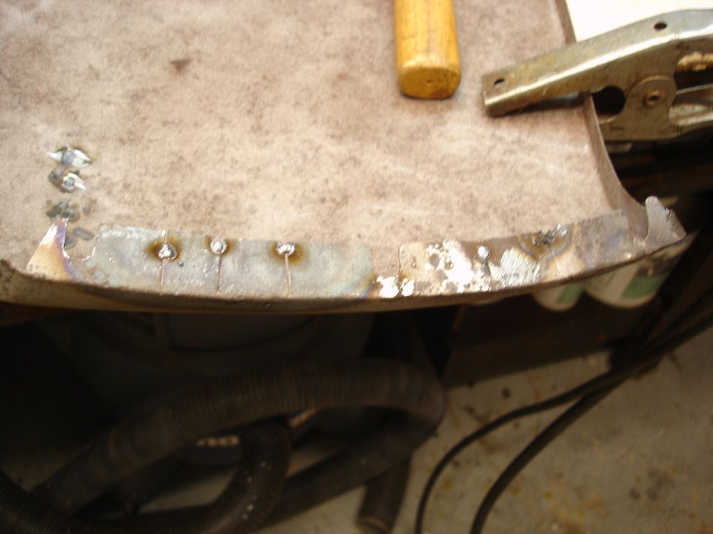

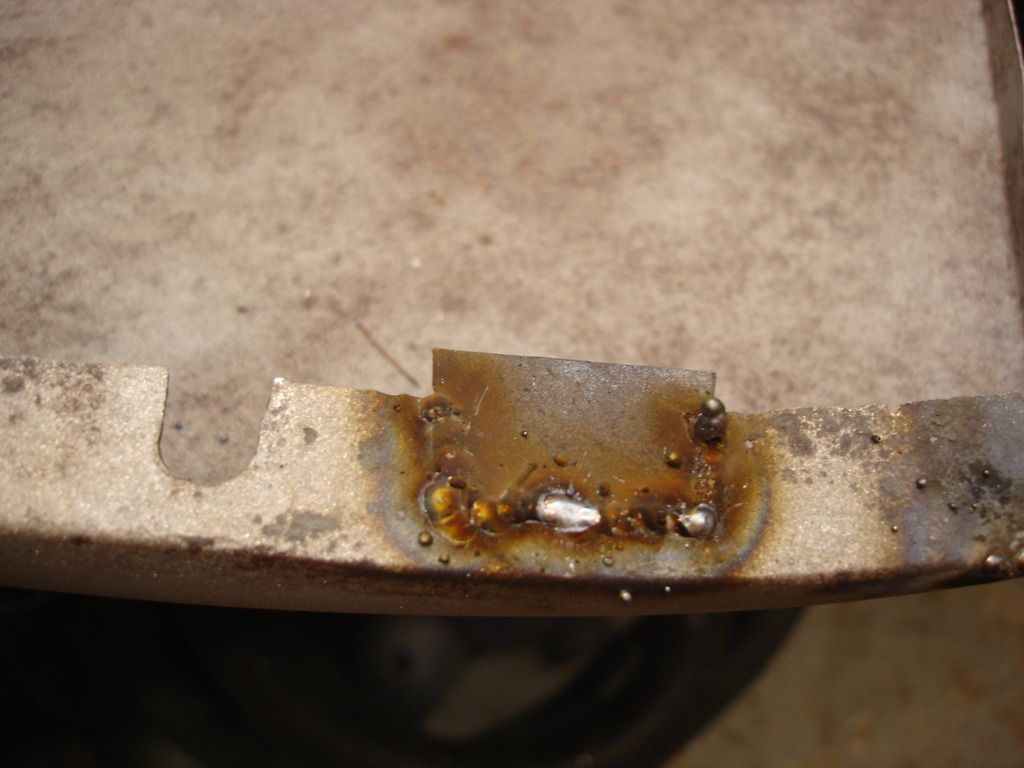

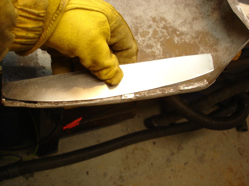

The rear mounting flange on the donor wing was also a mess. The PO had tried to rough in some metal to replace the bad area, but it was not up to my liking. Here I have cut all the bad out. It will be replaced with a decent patch.

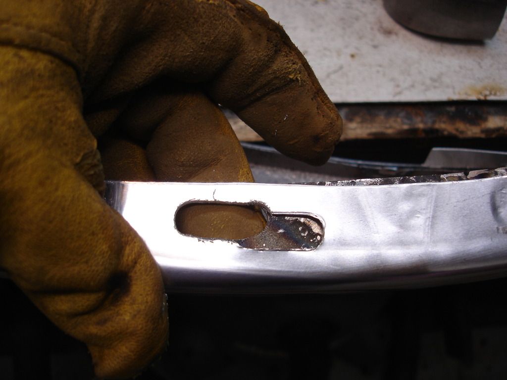

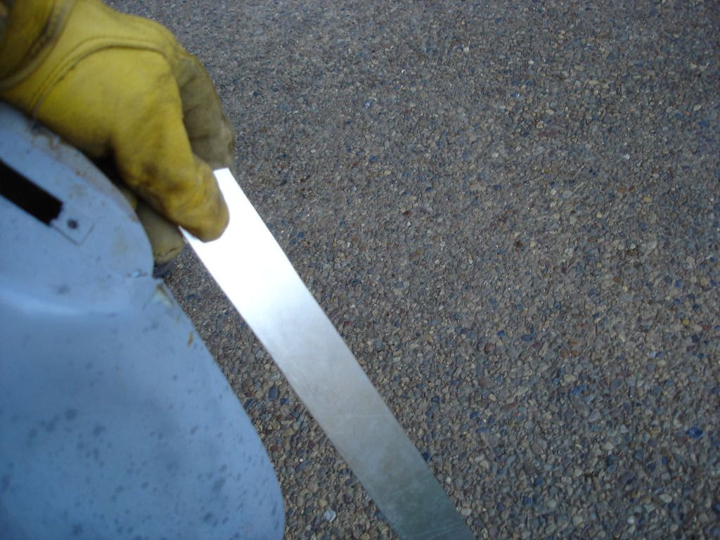

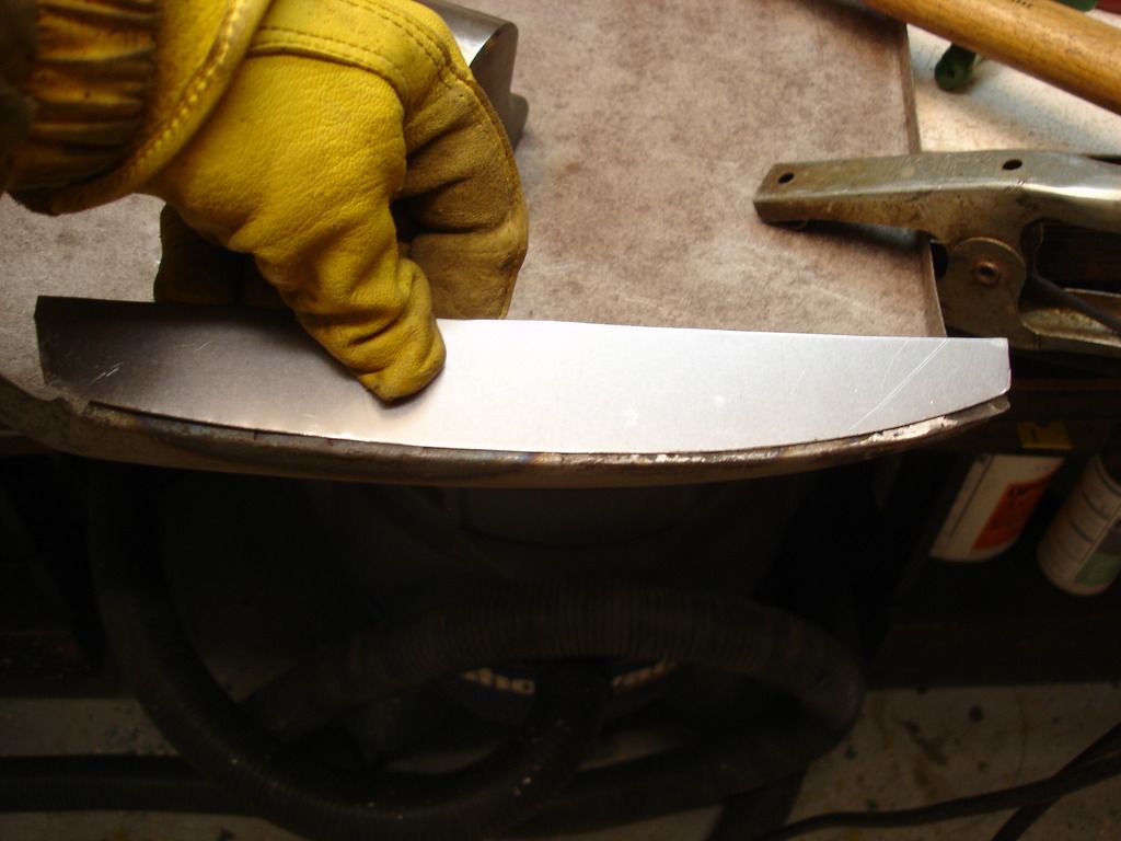

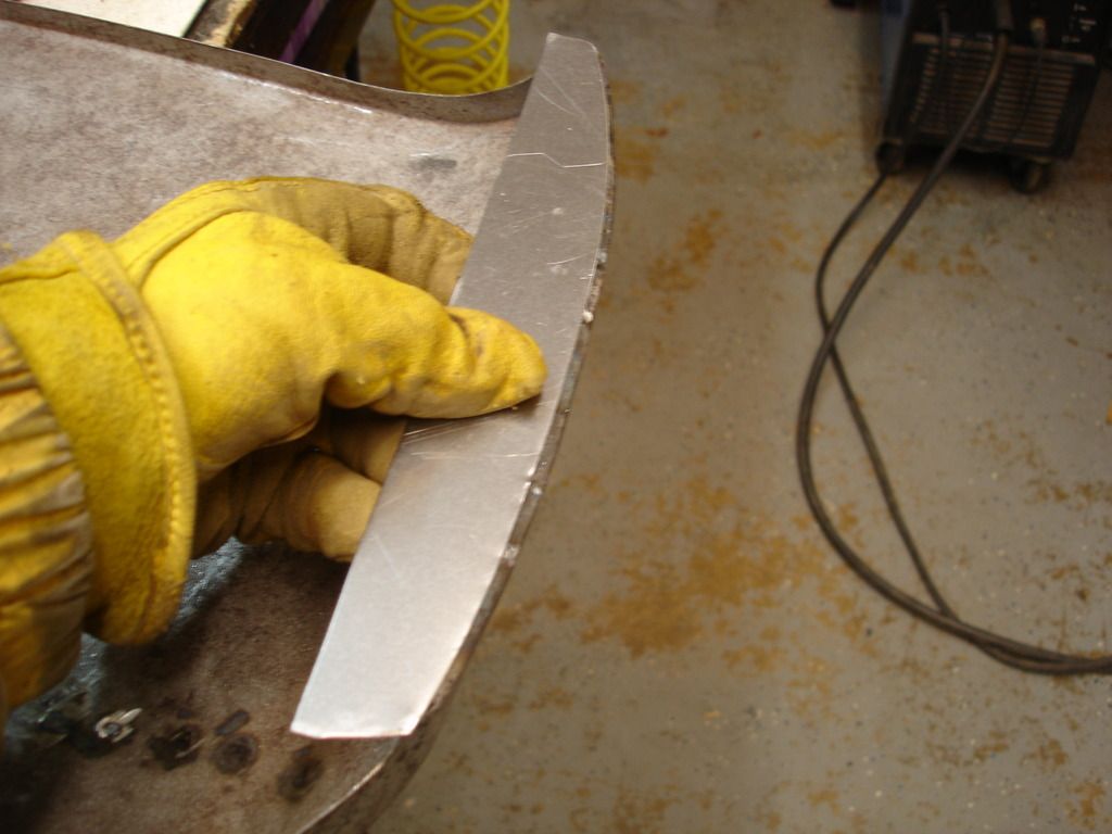

The evolution of the new patch, from a strip of metal, I marked the proper curvature using the tub.
And trimmed it to match.
Now that's a flange I can live with! I will save the cutouts for the mounting bolts for the trial fitting of the wing onto the tub.

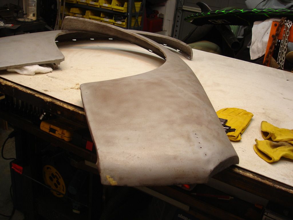

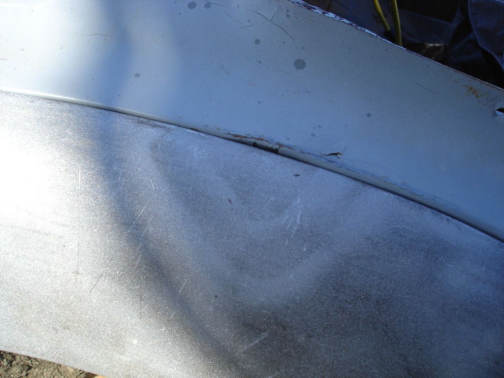

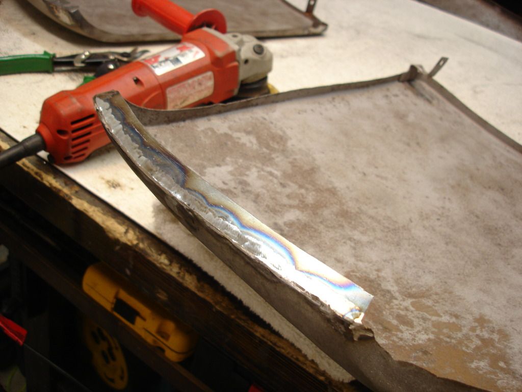

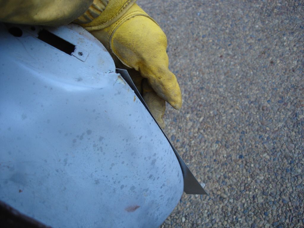

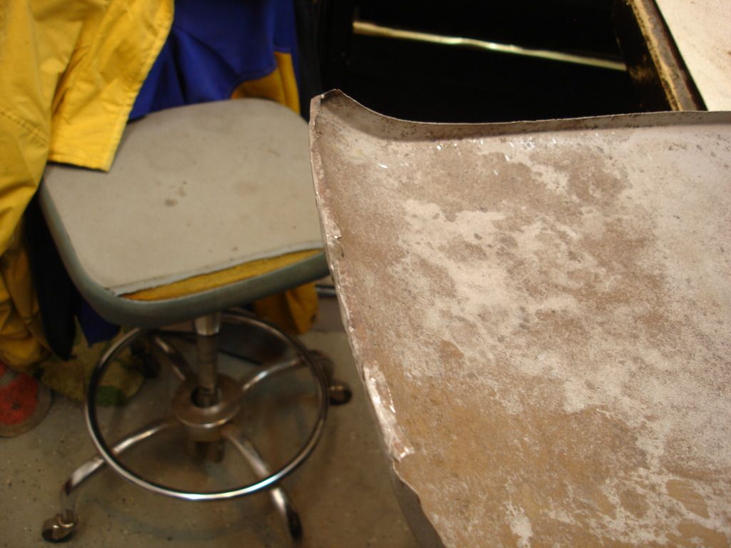

I held the left wing up to the tub and realized that it was not formed properly to match the tub. Obviously another long forgotten fender bender. I neded more curvature, but the flange would have to be shrunk WAY to much for using heat. So, here I have trimmed the flange with slits. These will be bent to overlap, re-trimmed, and the welded closed again. This process is the "other" way to shrink metal...that is, cut it out and reweld it closed.
Tacked to the proper shape.

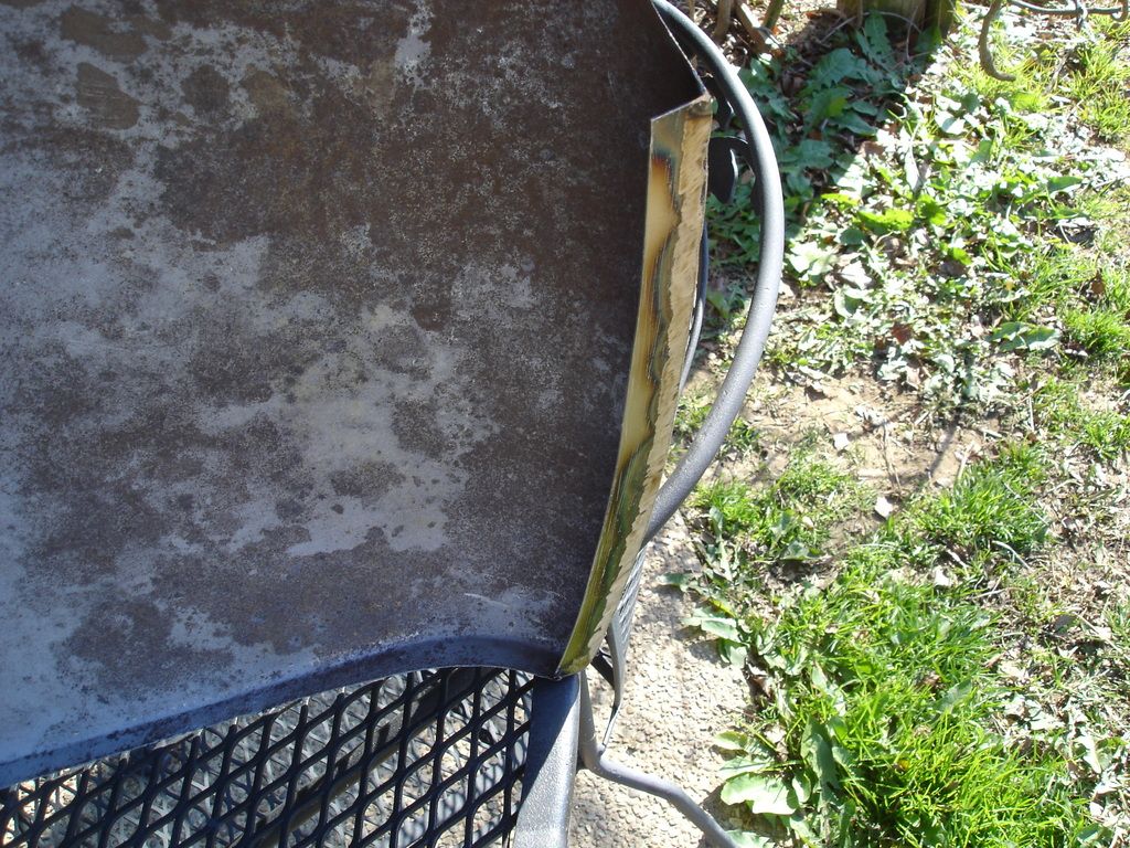

And finish welded.
At this point the 2 rear wings are intact. No more bends, bondo, or lead. I spent 2 more days tapping the shape into them, but they are about done.

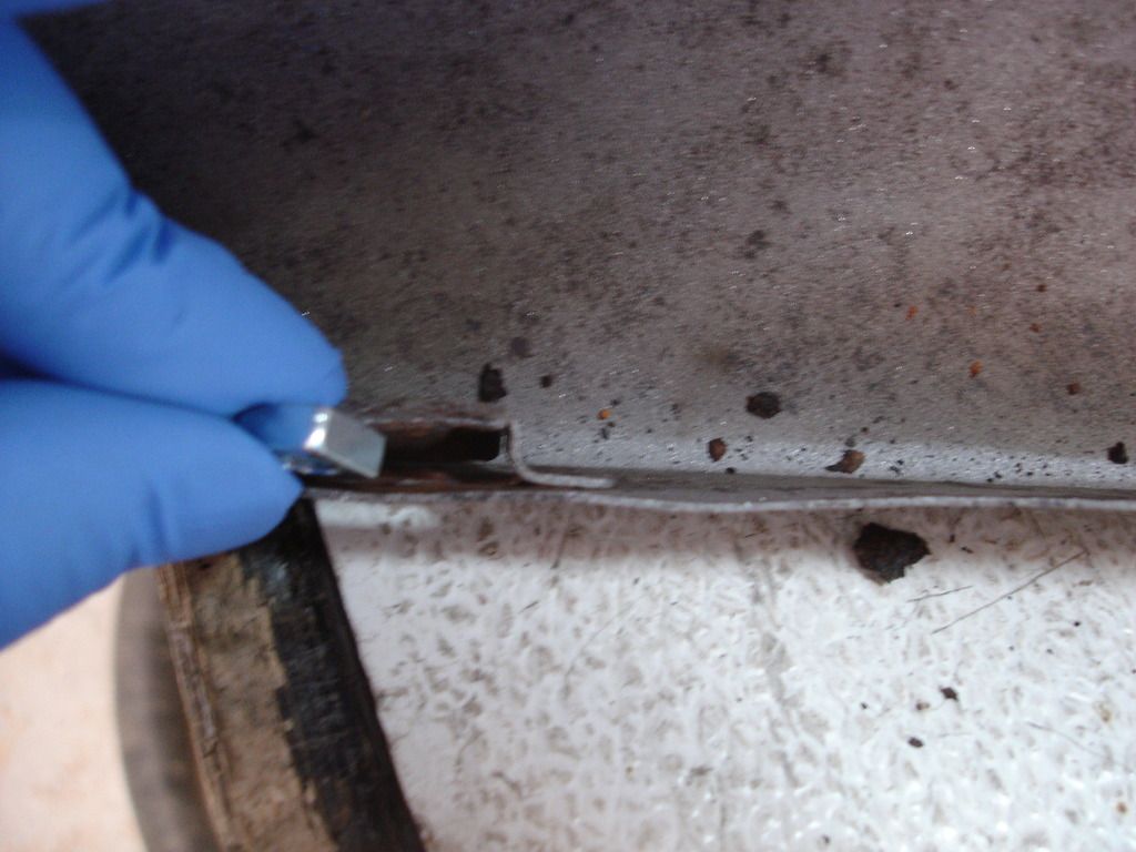

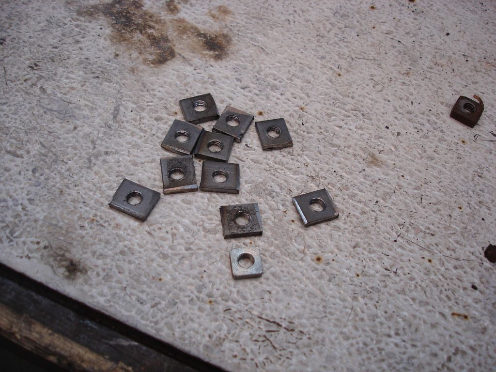

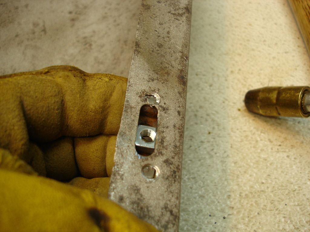

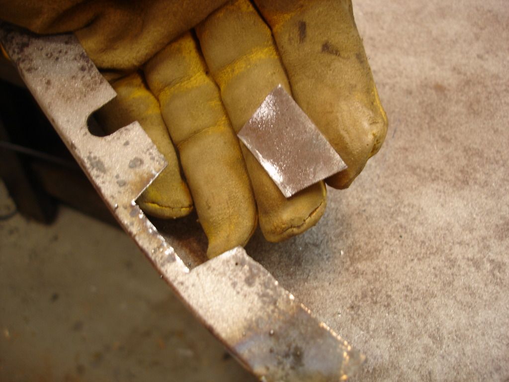

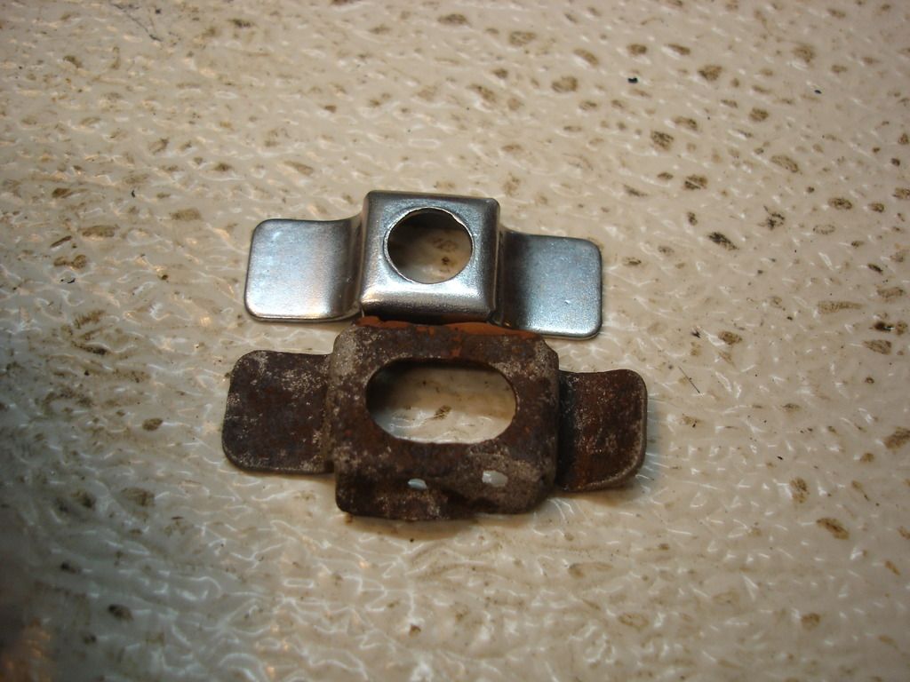

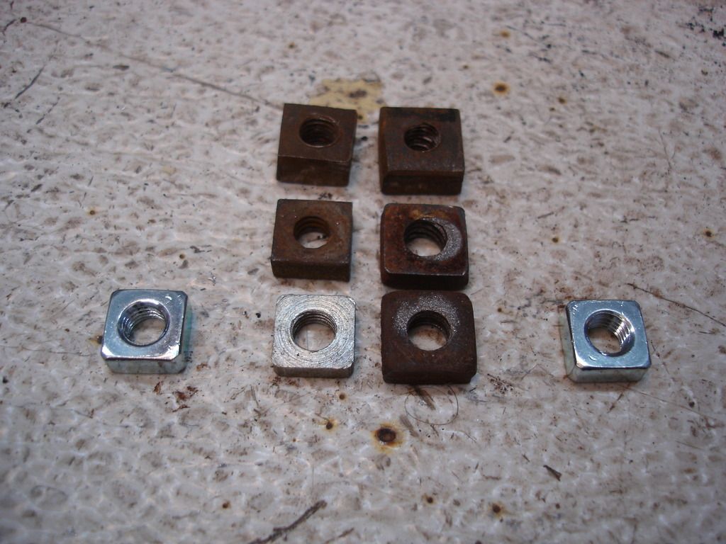

The next "issue" were the cages. The original are longer than the repros currently available. I wound up pulling a couple replacement cages off the spare trash wings. But, then another problem arose....
Namely, the repro nuts do not fit the original cages! Rats! Here is the entire selection of square nuts I accumulated. The 2 on the outsides are what come from the big 3 suppliers. They will work with the cages the suppliers provide, but they are too small for most of the OEM cages. For the rear wings, I needed the largest size nuts...1/2", shown at the lower right of the factory nuts. All of these nuts came off TR2's/TR3's. Gotta love the consistency!
At first I thought they would work. But, after installing them all in one wing, I picked the wing up and they all promptly fell right back out. The nuts are so small they fit through the openings in the wing and cage! I searched for fine thread 1/4" square nuts across the entire internet enabled world. There are none. They have to be 1/2" square to keep from falling out. The repros are 3/8". All of the originals were frozen to the bolts and un-restorable.
I had to move to plan "C".
I bought some 1/2" by 3/16" thick steel bar stock and cut my own nuts. Sounds like a real pain, but it actually took much less time than searching the internet and hardwares in vain.
So, in they go and the cages got tapped back closed. Job done...finally! The dumbest little issues cause the most grief.

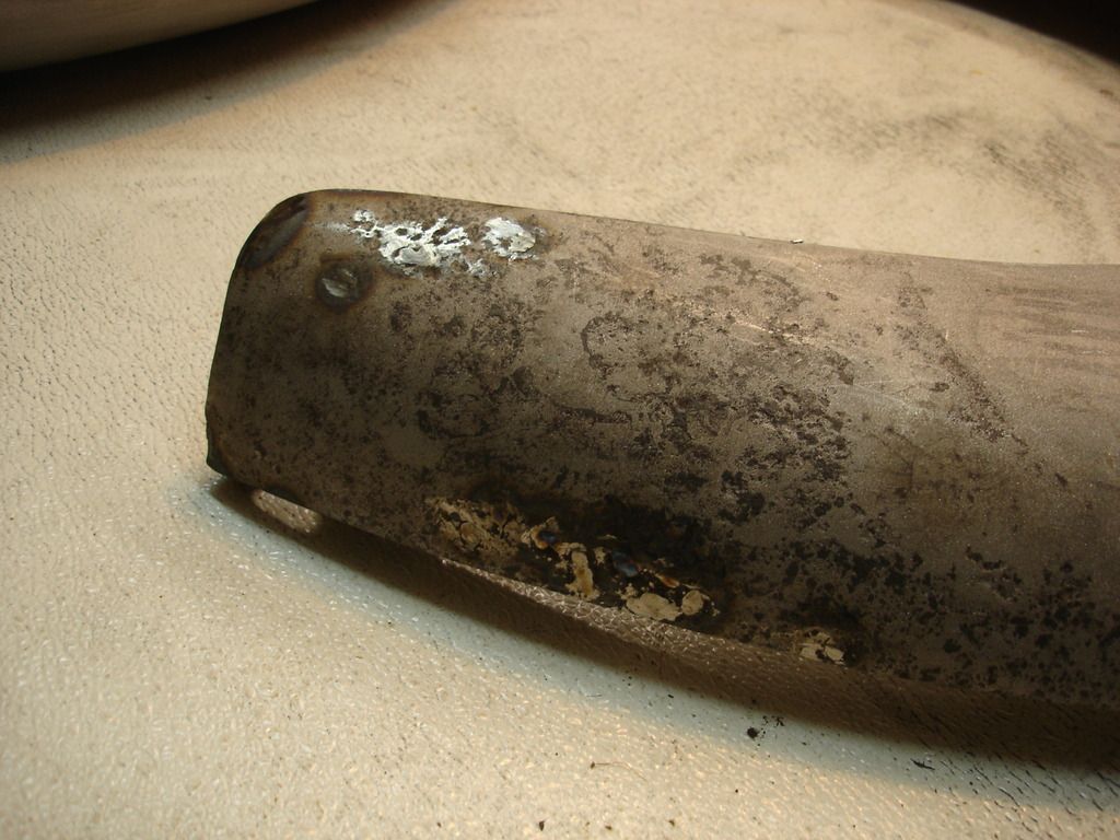

The stone guards are identical mirror copies of each other. But the wings are not! Bummer. The problems with hand-made car parts. So, the following sequence is what I had to go through to fit the repro guards to both sides.
Important safety tip...you cannot fit these to a finish painted car without a lot of tears. If at all possible, fit them to bare metal.
This shows the biggest problem side.

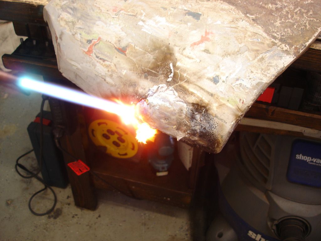

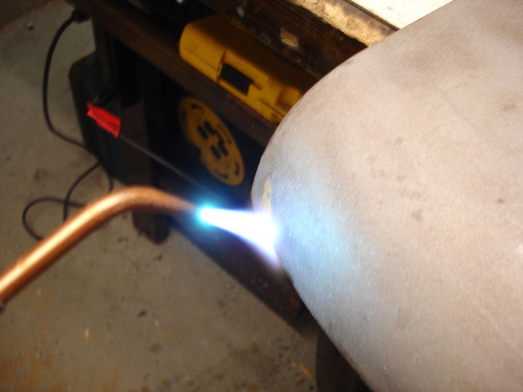

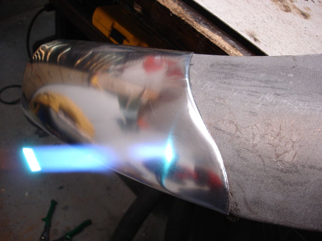

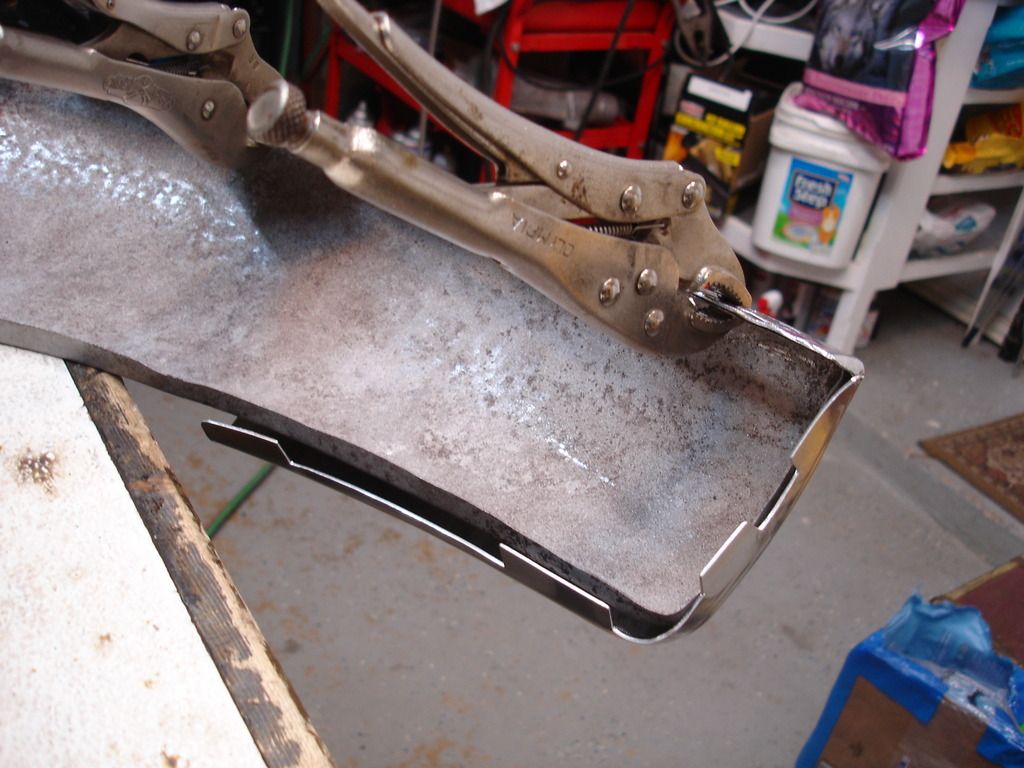

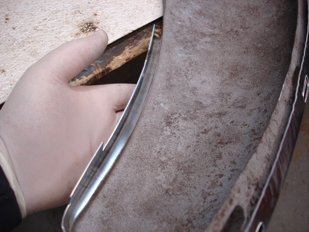

Aluminum is very docile with even a minimum of heat. Here I am torching it to soften the edges. I will then roll those edges over for a good fit.
Of interest...the side that fit well right off the bat had misaligned mounting holes. I had to open them up to match the holes on the wing. The side that fit like crap had the mounting holes perfect. Go figure!?!

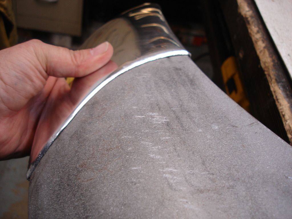

Here, I am heating the aluminum to soften it, and tapping the edges around to match the wing. Essentially, I am using the wing as a mold. Notice it beggars up the finish on the guard. That's not to be helped at this point. It'll be fixed later.
As you fold over the edges, the extra metal on the sides gets longer. Also, the curvature makes it necessary to slit the selvage at the bottom. This area will not be visible unless you put the car on a lift. On the sides, I trimmed the extra, and stretched that with a lot of beating.

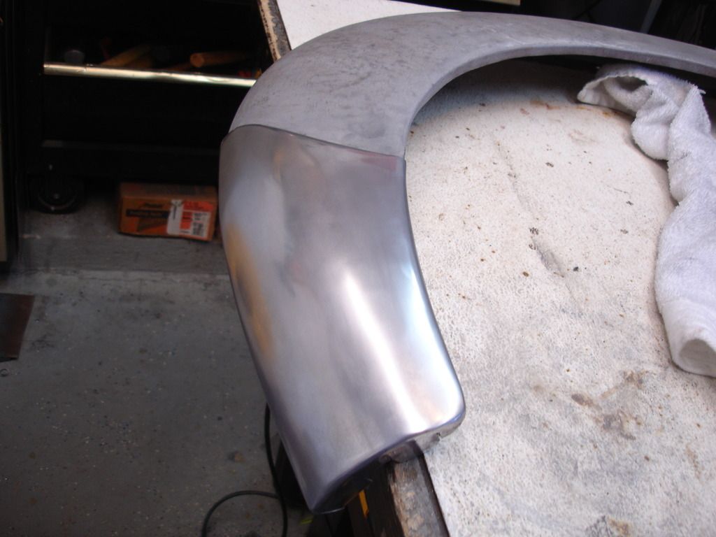

At this stage I am getting somewhere. It is finally looking like the 2 parts were meant to go together.

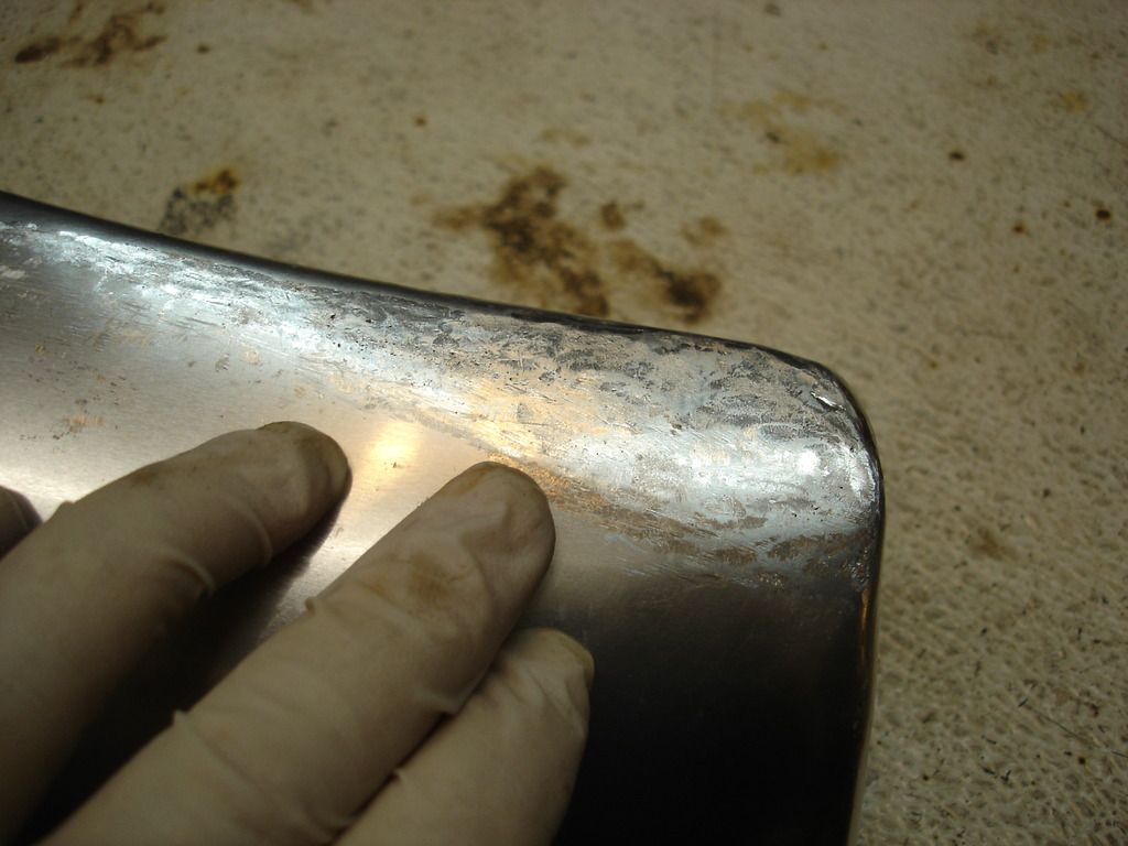

The wide selvage that gets pinched against the tub was too wide to shrink. On my wing the guard was not curved enough. That requires shrinking the edge selvage. You can see I attempted to shrink it by putting crimps along it. That was not enough...I eventually had to put some slits in this area too.

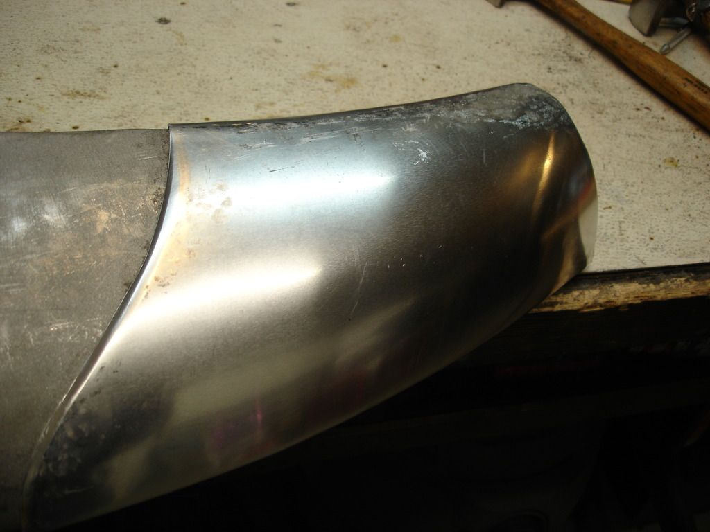

Here the guard is fit. Notice the areas I had to work a lot are no longer shiny. It's time to take care of that by polishing the guards.

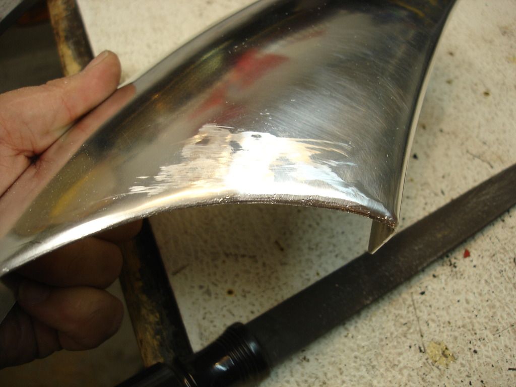

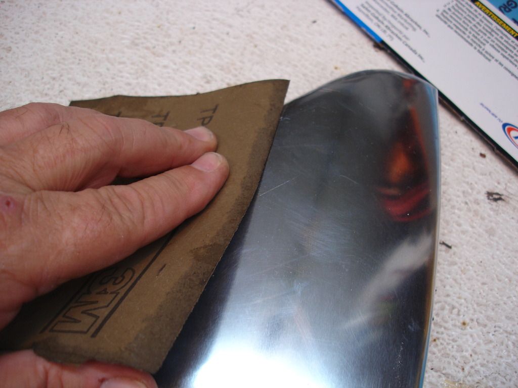

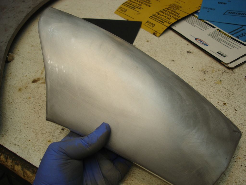

First, the rough areas get filed smooth.

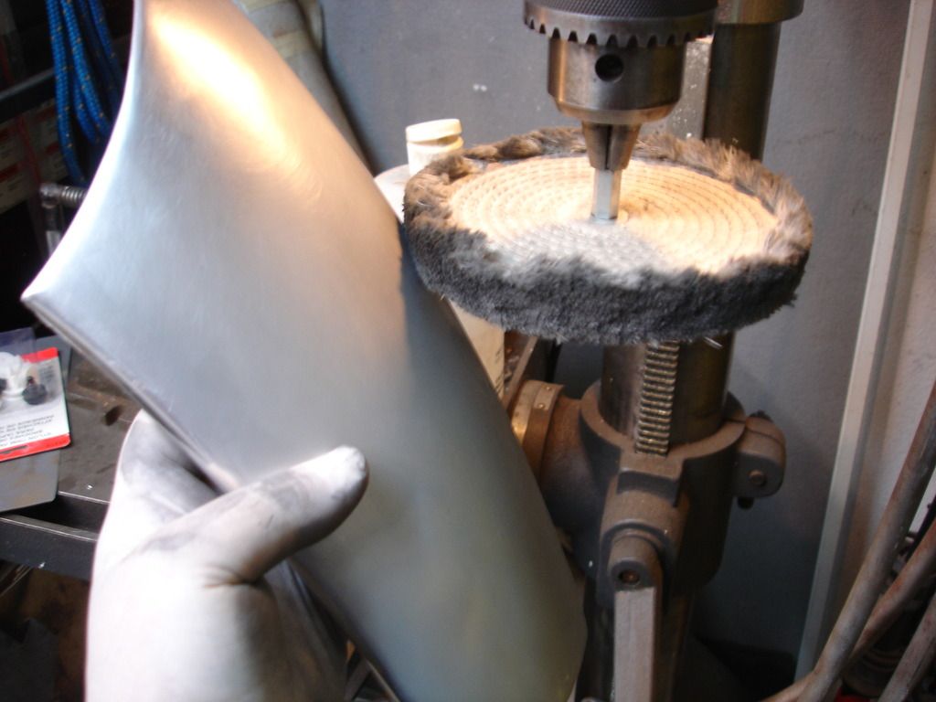

Now I sand the guard with progressively finer grit paper. I started with 220 to remove any dimples or gouges...and finished with 1000 grit. Each new grit is used until the marks from the previous, rougher grit, are gone.
You end up with this...a smooth, mat finish having absolutely no gouges or scratches. Now I turn to the buffing wheel.
I am a bit bummed about the finish. It seems the material they used for these guards does not shine up as well as it should. It looks decent...but with the hours of buffing I put into them, they should be like mirrors. I assume that's the cheap sheeting they are using for them....oh well.

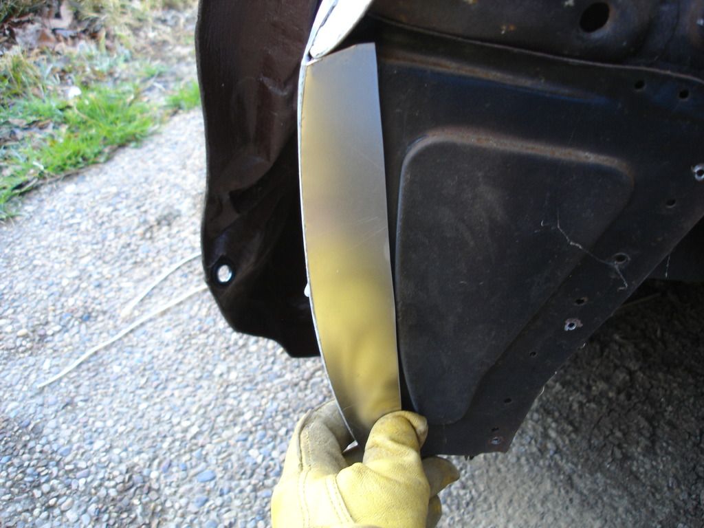

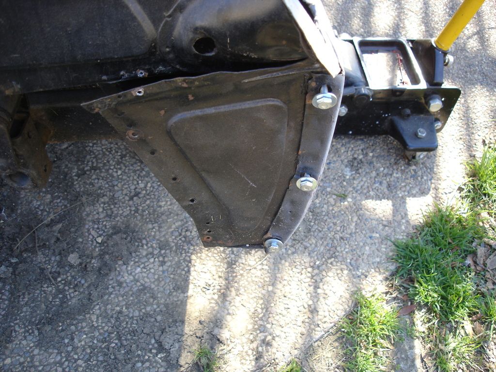

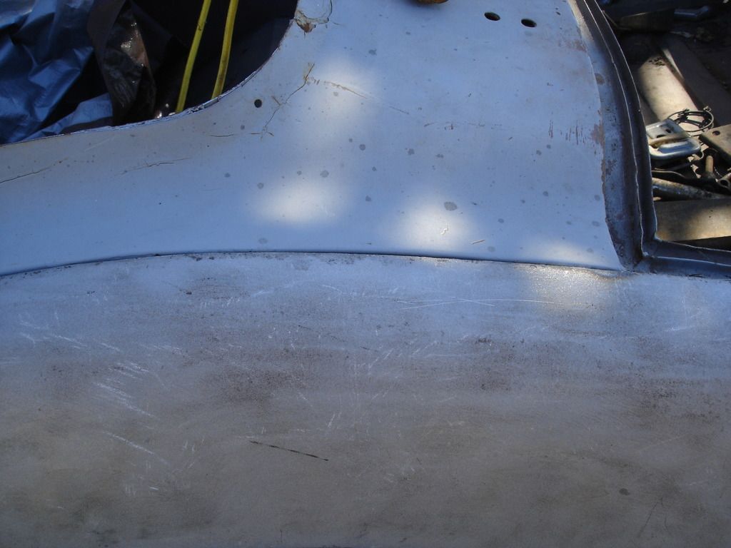

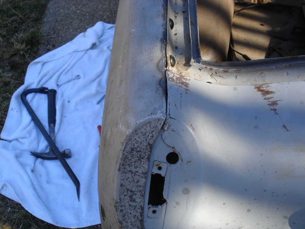

Now the show went outside, to trial fit the wings to the tub. In mounting wings, always start at the rear, by installing the 3 rear bolts and washers. Extra long bolts make the fitting easier.

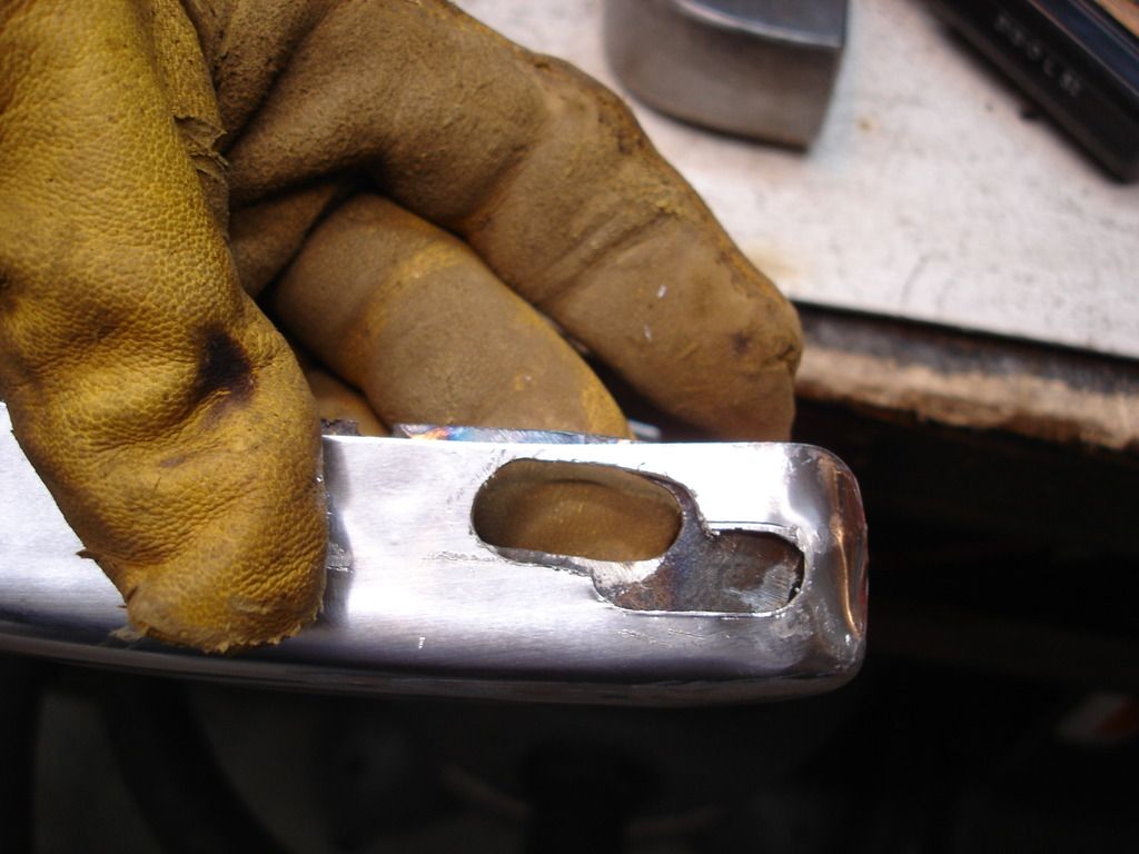

I then had to mark and cut the slots into the rear mounting flange that I replaced with a patch.
Hold the wing up to the tub and hook the slots to the 3 bolts at the rear. Slide it forward and the bolts will hold the backin place. Then, reach under and start any one of the forward bolts. At that stage you can let go of the wing and it will stay in place. Now you can take you time installing the remaining bolts. Once they are all started...start at the back and snug them down. Not tight! you are dealing with 20 gage metal, so snug is all you ever need for those bolts!
As you come to each next bolt forward, push the panel into alignment with the tub...and then snug it. Move forward to the very next one and do the same. If you try to start in the middle, you will frequently run into a misalignment situation that cannot be fixed without starting over.
This is the fit you are trying to get. It did not start out this good...I had to convince it with a body hammer!

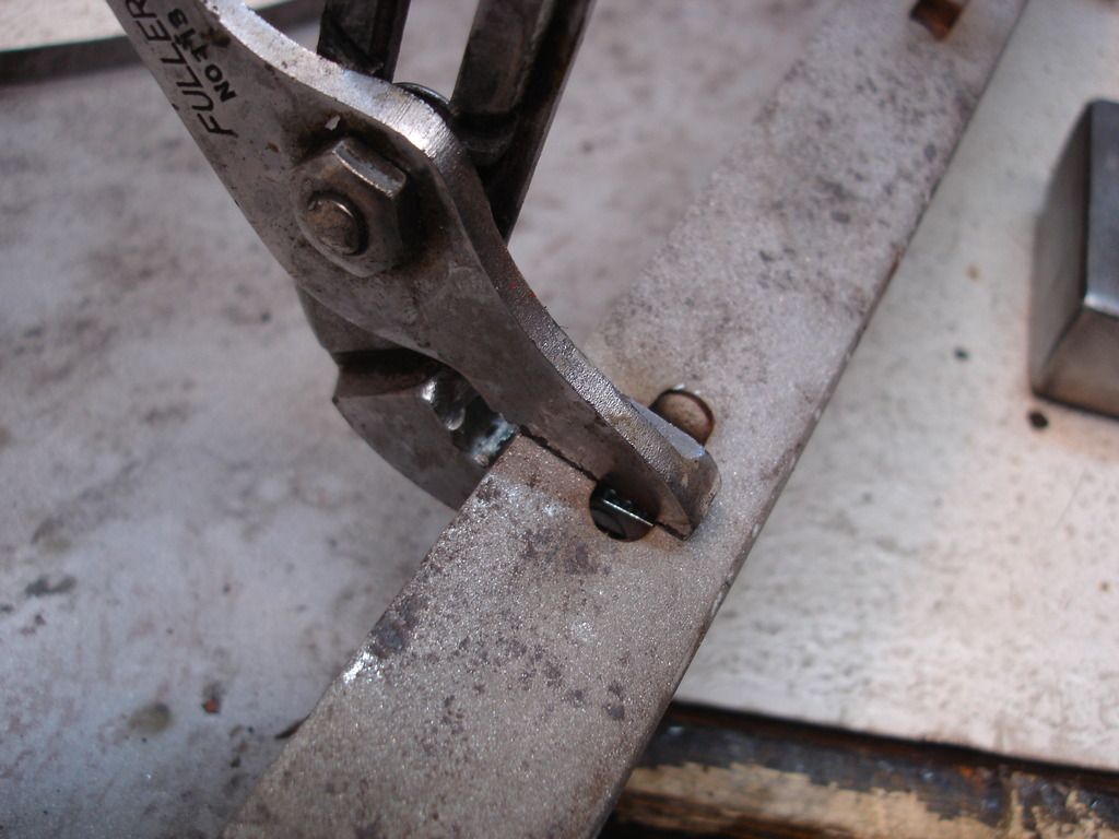

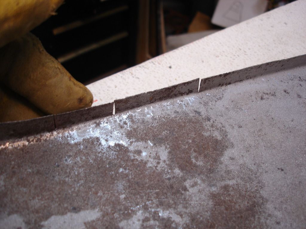

I found this interesting. Notice the outside of the bolt hole web has been slit with snips. The factory did this when the wing did not contour perfectly with the hand made tub. Do not be afraid to do this yourself for any problem area as you work forward tightening bolts. You do not have to take the wing off to snip these areas...or even loosen any previously titghtened bolts, for that matter.
To get the lower wing edge contour right, I actually had to snip the edge that is bent inward. I had to cut small "V"'s, and then they got welded back together after the fitting was done. This took the wings from a concave curve in this area to the slight convex curve that is correct.

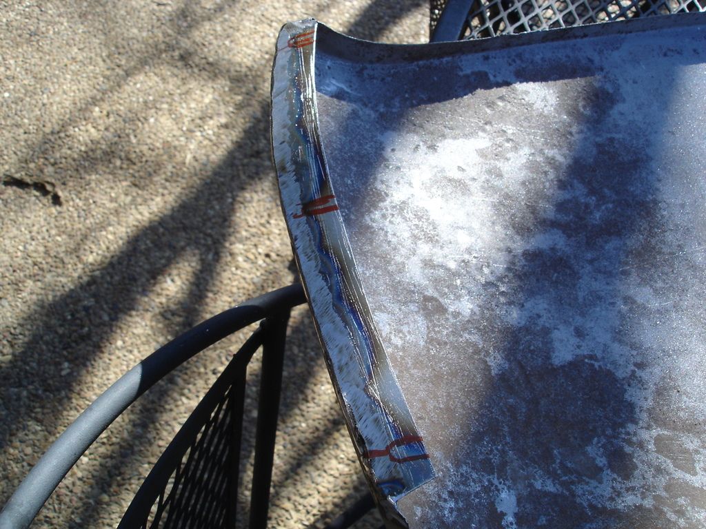

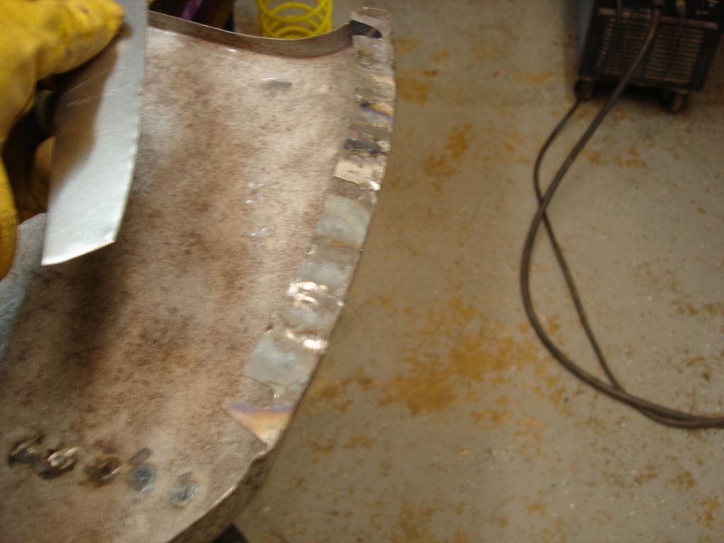

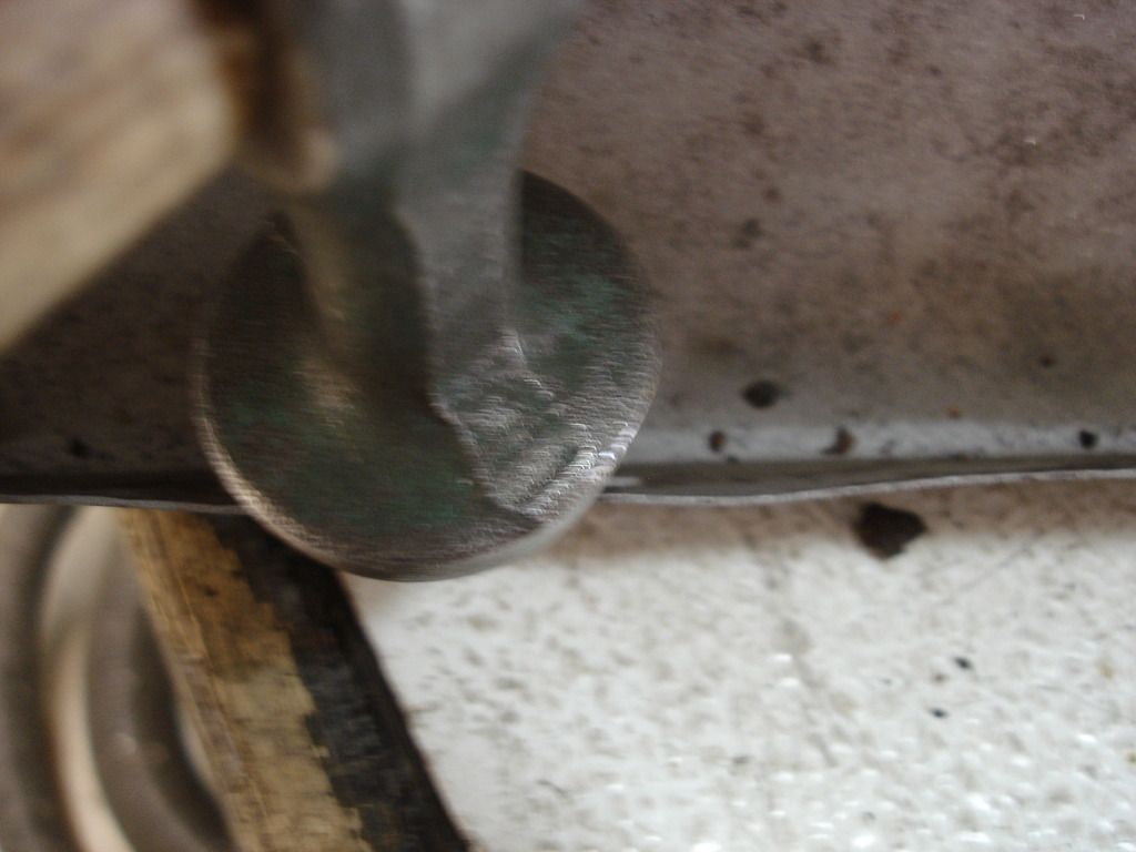

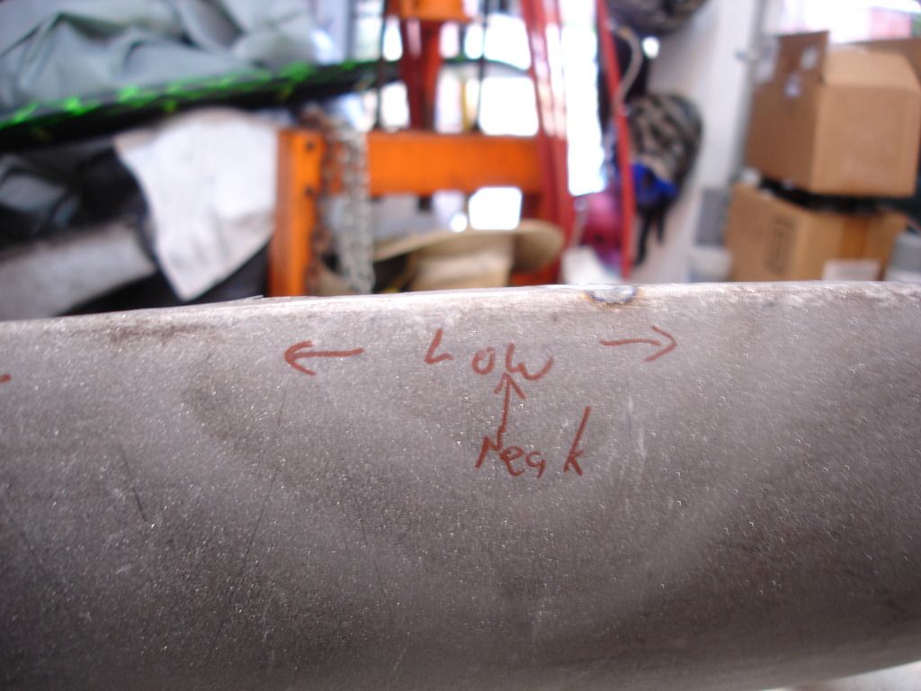

The right wing had one area that I absolutely could not get to match the tub. This is at the high point of the wing arch. I could not take care of this spot "in situ", so...
I marked it well while it was on the car. I then had to shrink the selvage by cutting slits to pull the area in and increase the curvature.
This is the same area, showing the spot where I slit and welded the edging.

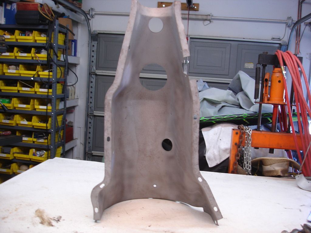

I found the tunnel cover. Well, it's sorta body. This is the original. It sucks. But, I bought a decent one from Marv 3 years ago. Finally I caught a break!
So far, every part I have worked on took a week or more. Sometimes MUCH more! The tunnel came out of the shed yesterday...
...and it went back today. Huyah! So nice to catch a break.
I did have to do some very minor repair and modifications, to bring the TR3 tunnel to TR2 standards. Here, I thought it was interesting that BOTH tunnels were cracked in the exact same location. I then plugged some extraneous holes that were in the newer tunnel.
