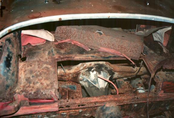

If you really like the car, oops, should of said "Love" the car, then it's worth all the time and money to restore it. I'll attach a few of my rust pictures to this post and we'll compare rusty cars. /ubbthreads/images/graemlins/blush.gif
