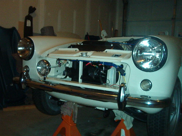

You need to do what I did - especially for you with you rubber bumper conversion.
