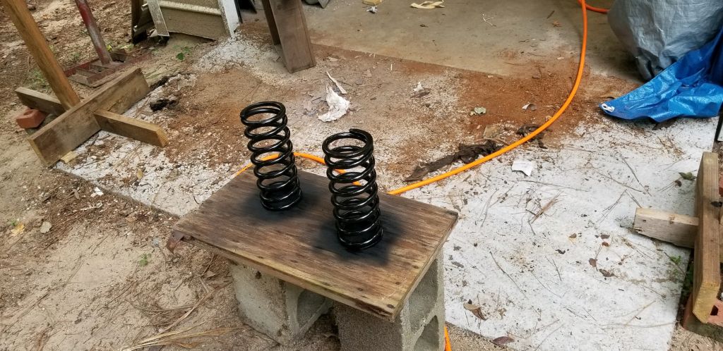

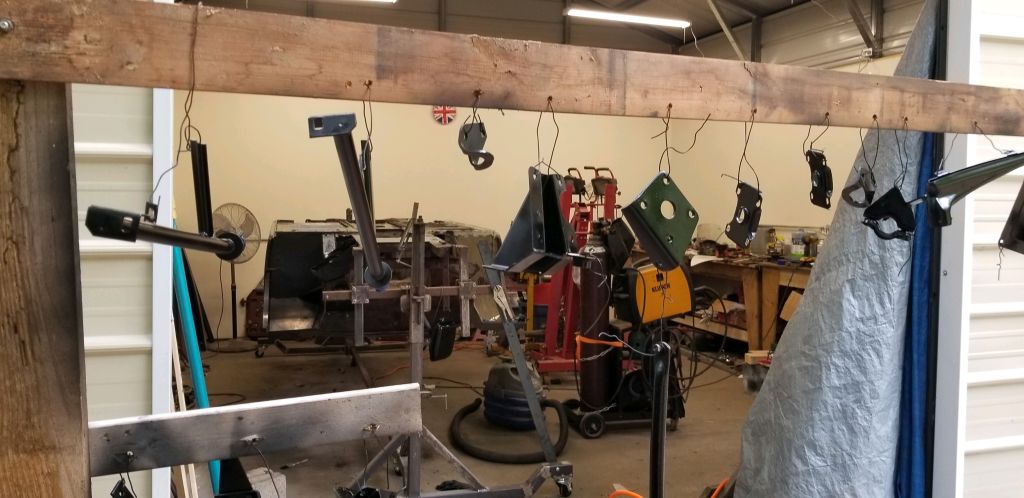

Got the floor pan painted inside and outside with 2 coats of POR15.
I have a lot of bits sand blasted, primed and painted black using Rust-Oleum Farm & implement paint to which I added some Majic Catalyst hardener. Seems to give a nice glossy finish and if it is tough enough for farm equipment it should do for for a pampered car.

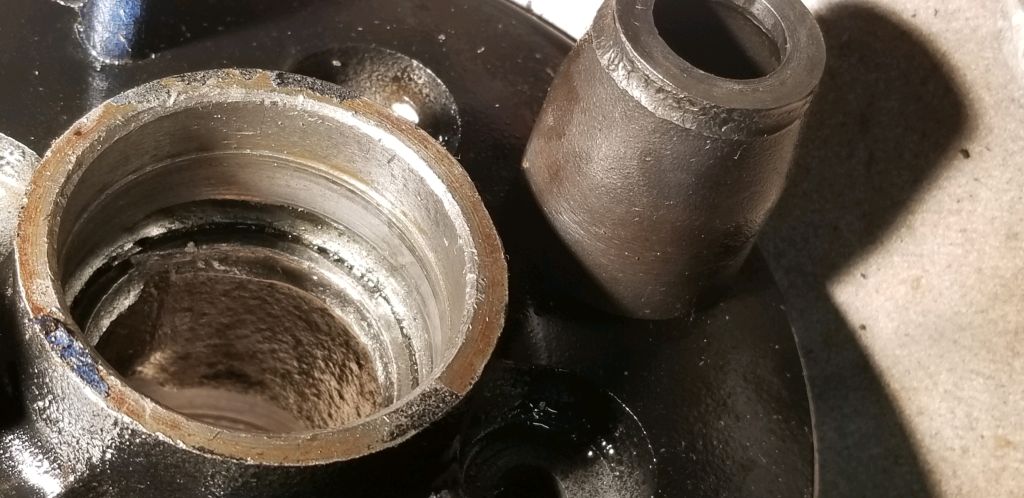

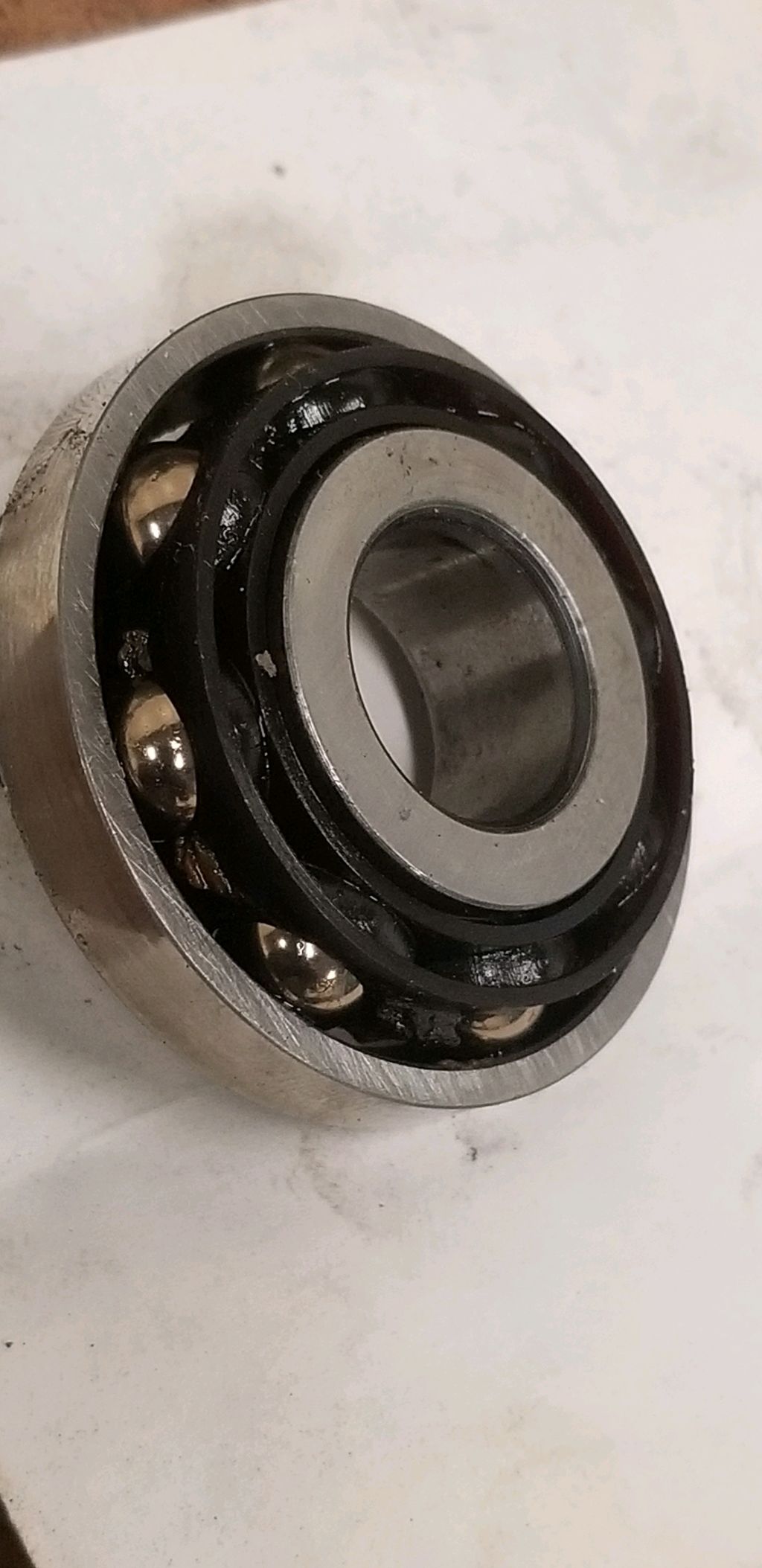

While I was working on the hubs replacing the Angular contact bearings with the Taper roller bearings I found a couple of odd things.
First was the outer bearing on one hub seemed to only have half an outer race. It was not broken and I can see the factory grind marks on the face of the bearing. Is that a normal MG bearing.
On the passenger side hub an outer ball must have been trapped between the spacer and hub at some time. The wheel turned before I took it apart and there were no missing balls.

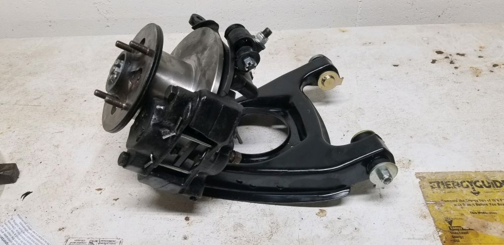

Back on to working on the Midget.
The front suspension is done and the shocks are back from World Wide Auto parts.
I am working on the rear axle now and the steering rack. Getting ready to paint and reassemble them so I can put them in the basement out of the way.

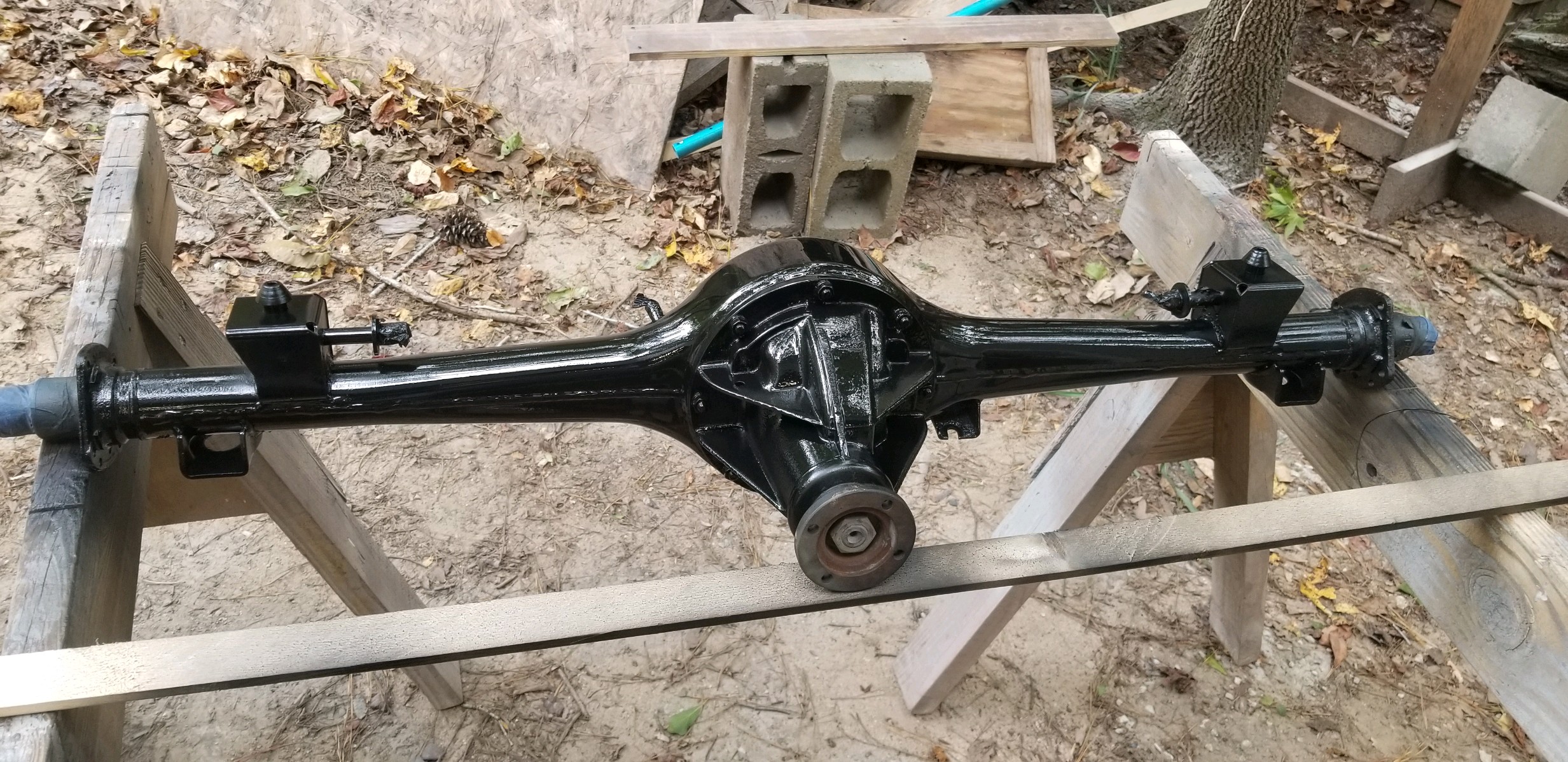

Got the axle painted ready for reassembly.
I noticed that the brake slave cylinder retaining "E" clip seems to be too large a diameter so it interferes with the axle housing. The opening in the "E" clip has to go towards the bleed nipple, They are Moss parts.

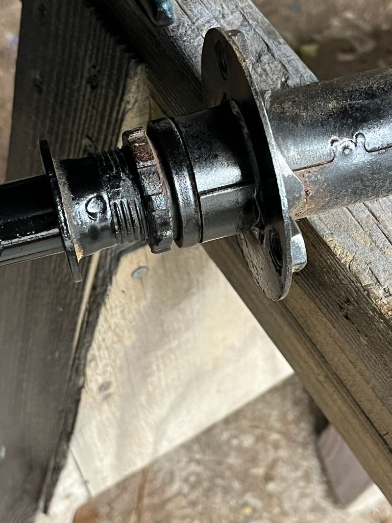

On the steering column there is a large SKF co type nut as the shaft exits the fixed part of the column. Is there any way to secure the nut and what is it intended to do?

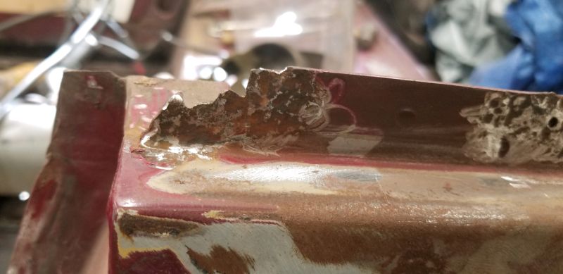

Anyone have a photo of the top corner of the "B" post. Mine are rusted away so I am not sure how much is missing.

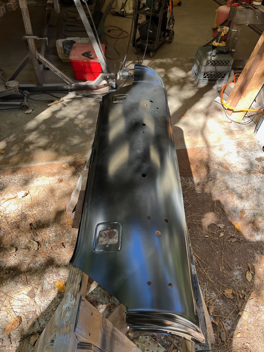

I can get back on the bodywork now as the rear apron has turned up from Moss UK. They are still on Back order at Moss US?

Anyone know if the rear light assemblies are handed or if they are both the same?
I am working on getting the rear apron fitted. Running into some issues with it. On the apparently undamaged passenger side the join between the wing and apron look good and the step where the rear light sits is fine. The Holes for the bumper mounts are out of position and the boot lid does not align up well. I am going to make some clamps so I can keep the seam below the lights closed up while I look at the other areas. The new part is BMH and looks very good. I have fitted the boot lid so I can use that as a guide for opening shape.
