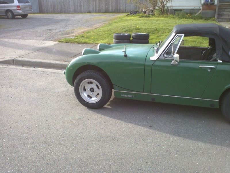

I got my new tires put on my aluminum mags.
They work great on the front.
Too wide in the back, on the outsides.
I am committed to getting these to work.
So, what do I need to know about flaring out my rear wheel arches?
I know it will also help if I put the blocks back in at the fronts of the leaf springs, pick up the back an inch or so.
Here's a picture of the front.

Rick, my LoTO midget had the fenders flared by putting the car on a hoist and prying away with a 2X6. I don't reccommend it. Looks to me by the fronts you have fitted that those wheels just have too much offset.IMHO.

You've tried rolling the car forward with a baseball bat (or similar piece of hardwood) between the tire and fender....yes?
This worked on my SWA rubber bumper racer along with a panhard rod and stock wheels. Until they stopped making 175/60-13 DOT race tires.
When I was forced to run 185/60-13s, I cut the fenders out to the RWA style. It's is a little ugly, but I actually have two RWA rear fenders I intend to fit on the car at some point.

Do it like the pros. roll it with a baseball bat. pick out the size of bat at your local sporting goods store, or yard sell. personally I would not try a 2X or anything that has an edge or is flat.
