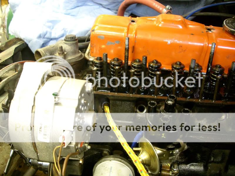

I went at it last night - note the valve pedestal removed for added insurance. I put some black pipe on the breaker bar and pulled down but no joy. I was really expecting something to go bang. I was pulling with an estimated 50 lbs and the breaker bar length was at least 4 1/2 ft so that gives, really approximately, 225 ft-lbs. Did not feel comfortable pulling harder - I had the fender protected with bunched up moving blankets but maybe the crank nut is not the weakest link, if you know what I mean, though never thought about bending con rods!
I think all is well - I put the pedestal back on and re-set the valves no problem. (Nice being able to turn the crank nut to rotate the engine!)
