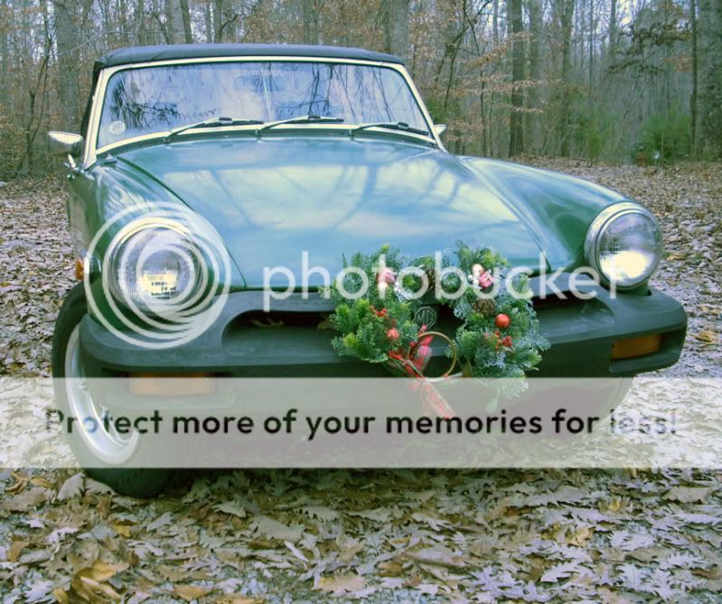

Just to complete this story:
I couldn't stood any longer (as the Cajun chef says) and went ahead and re-torqued the cylinder head nuts. Needless to say, this was a "pucker moment" as the Doc says, because, once you have heard a stud rip out of the block, you will never forget it. It went without incident, although some required more tightening than others.
The engine fired right up but it was agonizing looking at the white smoke coming out the tailpipe - we are getting cold weather now, here in NC. Eventually the smoke cleared and I went for a test (as Jack says, drive it like you stole it) and it ran fantastic.
It lives, I tell you, it lives!!
Cheers!
Excellent news! Many happy miles. :cheers:
Always nice when a plan comes together. Just in time for Christmas too, great.
