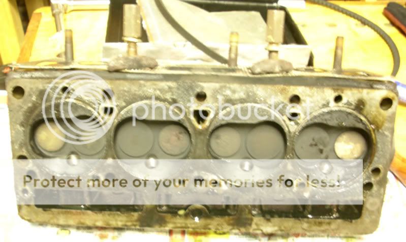

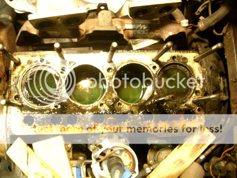

The head is off.
Looks like a tad amount of coolant was getting in there, what!
Bit of a mess and not much to see right now - tomorrow I'll clean up and post some more photos of anything interesting.
The really good news is that all the head studs feel solidly in place, ie not stripped.
Cheers!
messy but glad you pulled it!
I've cleaned up the head and block some but need to get to the store for some Gasket Remover to get it all off. Then I can lay a straight edge down and see if anything is warped.
It's usually best policy to take the head to a machinist for a light skim, regardless, right? Or should I bother?
The studs at the top are OK (not stretched) as I could thread a nut down, all the way, on all of them.

Cleaned up the head somewhat and done a quick check of the flatness. The ruler rocked downwards, at the back of the head, at the end opposite plug hole #1 (where I fed in the rope). And I could fit an 8 thou feeler blade in there. Kinda makes sense - bigjones pulls down on the breaker bar and actually bends cast iron, ar, ar!! You have been proved right, Kellysguy, I should have put smalljones on the breaker bar!
Anyways, it is at the machine shop, awaiting a pressure test for cracks and a skimming.

Not sure I want to bring this up but I suppose I should remove the studs for proper cleaning of the block? Visions of snapped studs. I know something is going to bite me in the backside before I am through with this job.
