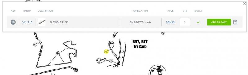

John
man, i swear that was not listed a few days ago. it showed n/a. but yes that is what i am looking for.
well except, if you look at the picture of the hose it shows a fitting on both ends. that would not be correct. the one end just uses a hose clamp on the carb float bowl. so i wonder if they just added this as something that would work. if it comes the way it shows, you would have to cut the line. And then i wonder if you could not just use the one for the MGA. it is only 18.49 vs 33.99.
either way, i am fine. got a hold of Healey Surgeons today and they had one to ship me. So i should have that in a couple of days and be fine. Now i need to decide if i want to put the fuel filter i was using back in or leave it out.

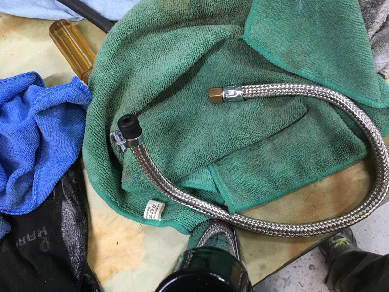

My line came today from Healey Surgeons and it looks like it is going to do the job. i am guessing they take one of the other lines and cut one end off of it. then add the robber end for the hose connection. this hose was like 20" long and only needs to be about 9. i cut it in half and move the rubber end.
the only change for me is that i had a fuel filter installed at this location. i have a solid line from the pump to this flex hose so a good place. these cars did not come with a fuel filter and i wonder what the thinking is on installing one. i have a brand new fuel tank, new pump and lines. when i took the filter off there was some small bits of sediment in there but not a lot.
thoughts on putting the filter back in? easy to cut the line again and insert the filter.
