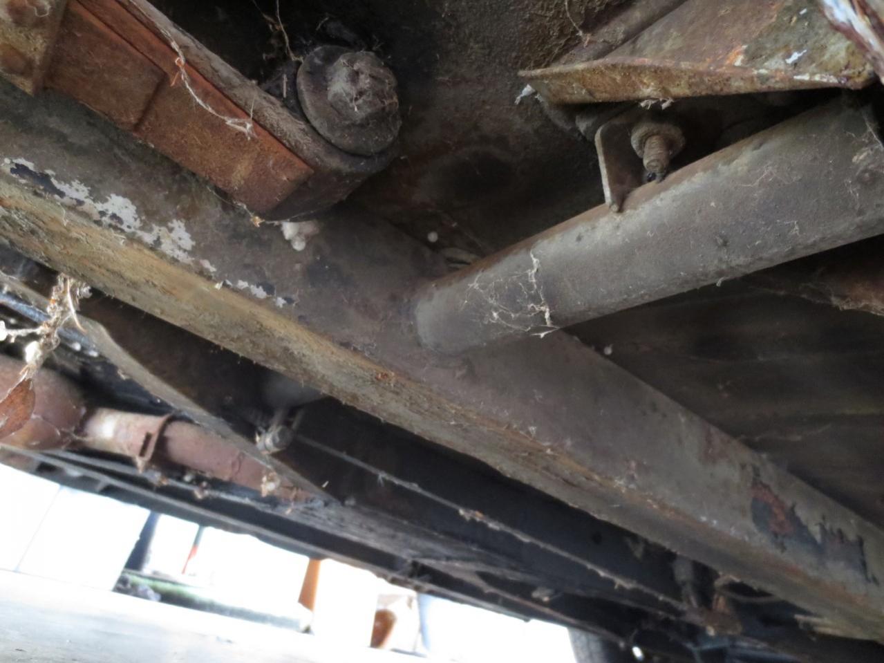

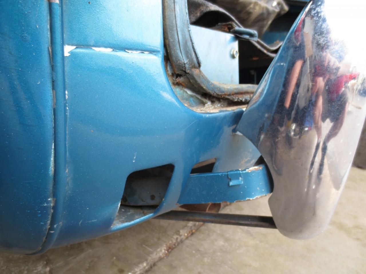

Here are a couple of pics of the frame area, driver's side floor and rear valance that was mentioned earlier. They look really good to me.

Sure looks like a good car beneath a dubious paint job, look forward to hearing about your plans for it. Not every car must or should be a show car -- solid drivers are a lot of fun and getting harder to find.

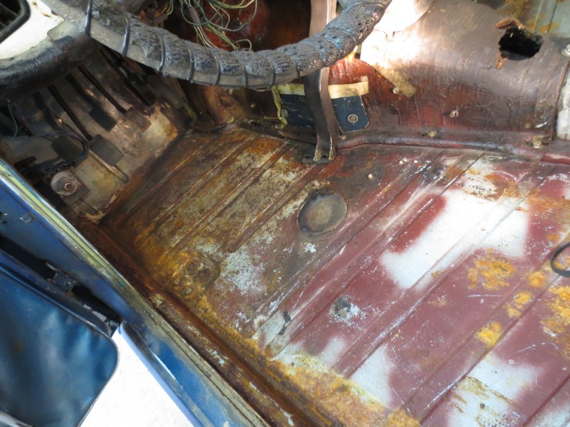

I spent this afternoon ripping out the disgusting interior. It was vile. Really vile. Like "the seller found a petrified cat on the passenger floor" vile (actually true). Found some minor pinholes on the passenger side, but the driver's side was awesome.
