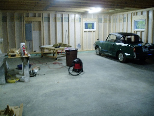

Yup, should have. I am trying to get the new garage finished and have car projects already going on inside. A lift was only fleetingly considered and the 2 foot foundation wall turned out to be two feet on the outside grade but only one foot inside. (1st mistake: should have made it 4ft.) That give a ceiling height of just under 9ft.
After 55 years or so of working on cars without a lift, I never thought I'd need one nor could afford one. However, at my age, a lift would be Nirvana. My advice: build it big enough for a lift, even if you don't plan on one.
I'm giving some thought to putting one outside, next to the building. Fair weather thing, I know, but I'm away during our New England winter.
The other option is to have one inside, crouching or sitting underneath. Beats the creeper? Also think I could stack, albeit with a bit of grease, two LBCs in the space for storage.
