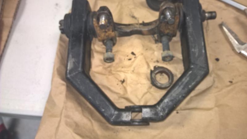

I was very carefully keeping the sub assemblies together to ensure I could put it back together, then in a moment of brain dead I took the upper control arm apart without noting which side overlapped which. This is the drivers side/left side. I believe it goes back together as pictured. Thanks all!

Right over left...so opposite the way in your pic.
If you look closely, you can even see that the bushing ends are off compared to each other...
