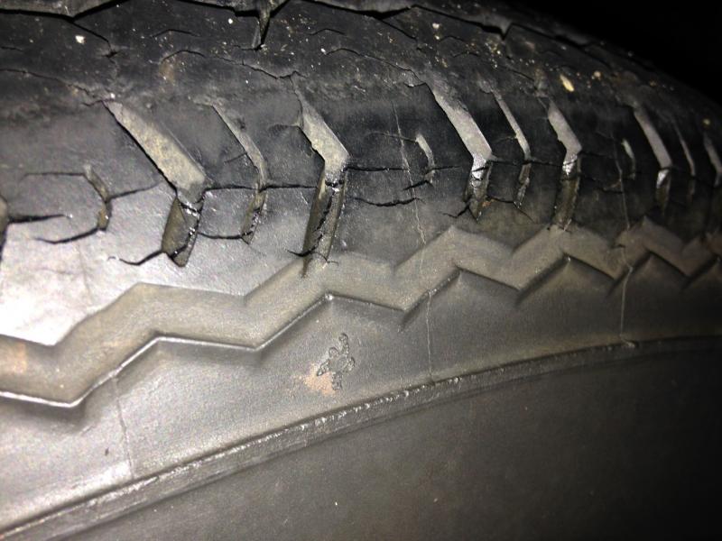

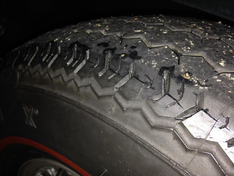

TR2/3/3A Tire condition, upper side wall splits...dangerous?
GTP1960
The tires are Michelin red stripes tube tires.
Other than the splits along the outer tread/sidewall Union, they are in great shape.
However I do not know how old they are.
The pics are of the front tires, which I'm running at 30psi (max 32)
I would appreciate wire wheel tire replacement recommendations, if deemed necessary.
advise appreciated.
thanks
Guy

Please tell us you're kidding, Guy! Those things are bombs just waiting to go off if you try to drive at highway speeds.
I wish I had a photo of what happened to the Stag when one of the old tires let go ("Those'll get me home, sure." ) The steel belts turned into a giant flap wheel and ruined not only the original paint, but took off part of the fender lip; just in the time it took me to realize what happened and pull over. But this shot might give you some idea:

Thx. They did alarm me. That's why I asked.
these tires are 185 x 15. tube tires redlines.
Any recommendation for replacement tires that are compatible with wire wheel splines would be appreciated.

Clearly those need to be replaced. It doesn't matter that the rim has a splined hub, as far as what tires you use. The cars originally had bias ply tires and the retrofit radial converts to 165R15 as Jeff stated, If you have the original 48 spoke rims. The red line tires were common on TR6's so you may have the wider wire wheels. I don't think I would put the 165's on the wider wheels, if that's what you have. I'll probably open myself to criticism from the experts, but I'm not a fan of putting wider wheels on the TR3, especially without the upgraded axle stubs. It changes the geometry...however minute it may be...making steering harder and putting more pressure on suspension parts than was originally designed. There, I said it, so experts blast away. 165's and even 185's are getting harder to find, but are still out there. The name brands are pricey, as mentioned, but there are still bargains to be had. I bought 165R15 Nankang for my TR3 and have been pleased with them, except for the black sidewall having a lot of "gingerbread". If you want the redline or the retro white sidewall look, you're going to be paying dearly for it. The other issue is tube vs. tubeless. Some tire dealers won't put tubes in tubeless tires, at least so I've heard, but I've never had a problem getting them installed.
CJD
Looks like age. My tires are over 10 years old, and they scare me when I get up to highway speeds these days...although I was dumb enough to get it over 90mph last week. Here in the DFW area, that was just matching the traffic flow, unfortunately.
A few years ago I had another really old tire blow on me at 70mph on a 1970 Olds 442. The tire stayed inflated, but the steel belt broke and made a huge, 70mph paddle. It ruined the fender and even broke the windshield glass. The funny part is that a newer BMW had been following me, and after it blew, he passed and pulled over about 100 yards in front of me on the shoulder. I had a spare, but the jack was broke. I thought, "how fortunate, he can loan me a jack!" As I started to walk towards him, he flipped me off, jumped in the car and sped off. Turns out that instead of being a good Samaritan, he was just checking his Beemer for flak damage from my blown wheel! I had to limp down the rural Alabama highway for an hour at walking speed before I got to the next exit.
I no longer take old tires out of town...
