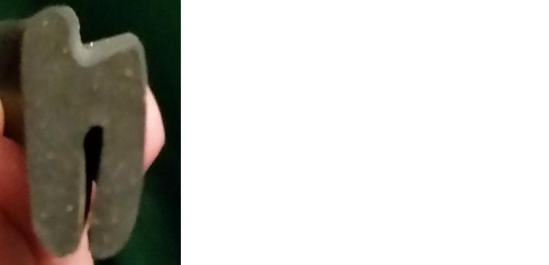

Here is a picture of the seal. If I understand correctly the higher lip should be inside.
Merlin63Tr4
Yes, the high side goes inboard.
