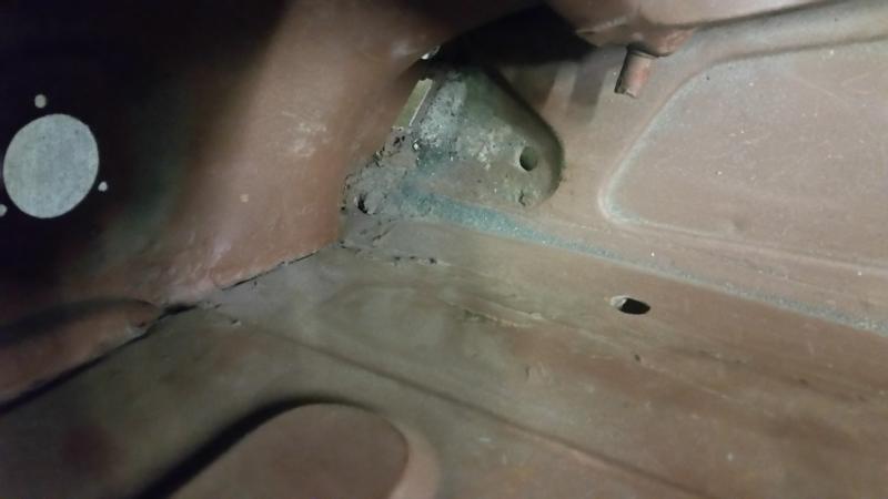

Not a very good photo, I'm afraid, but it's all I have handy. Maybe someone else has a better one. This is the drain tube where it comes out after going through the panel on the side, looking upwards inside the fender.

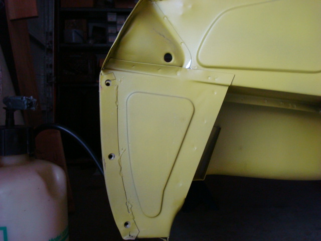

M_Pied_Lourd
Here is a pic of where the tube runs from inside the boot corners to the outside through the tail light nacelles.

DavidApp
Hello Mike
To be clear the tube goes through the the hole in the rear light bump out.

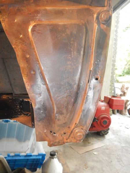

Tush I notice that your photo looks like the repair part I got but did not match my car. On my car the cage nuts are on the rear apron and the apron and side panel join with a flange.
David
M_Pied_Lourd
Hi David,
The photo I posted was not my car...it is one of the other guys resto photos (Keith maybe?). On my 1960, I bought that stiffener panel and it does come with the cage nuts on the back of the stiffener panel (same as the original panel I took off the car). I fitted my panel as per the photo I posted and it seemed to work well that way.

DavidApp
Hello Tush
Having revisited the passenger side rear quarter when I fitted the rear wing I started to think that I should have used the repair panel with the nuts attached. With my improved welding it would have been easier if I had done that but at the time I was not too keen to cut all that out. I will probable leave it as it is now.
That rear quarter had a bang at some time. I discovered just how bad it was when removed 2 1/2lb of bondo from the wing. I have got most of it beaten out and replaced the rear edge of the wing so I can get by with a skim of bondo.
It was almost 1/2" thick in one spot.
