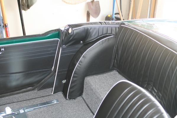

Hey! I am in the home stretch restoring my '64 TR4... I am not sure how to go about recovering the rear fenders in the interior. I am using the Moss interior kit. I have the Foam padding glued to the Fender OK, but the upholstery seems like it needs to be stretched quite a bit to get the puckers out... I worry about getting this done so it looks good once I apply the adhesive. Any tips out there?? Should I start at the top?? At the bottom? In the middle?? Thanks for any help in advance!:encouragement:

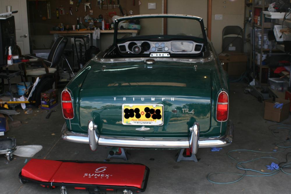

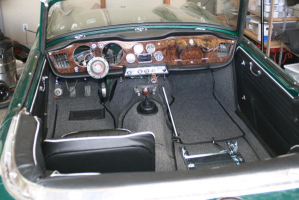

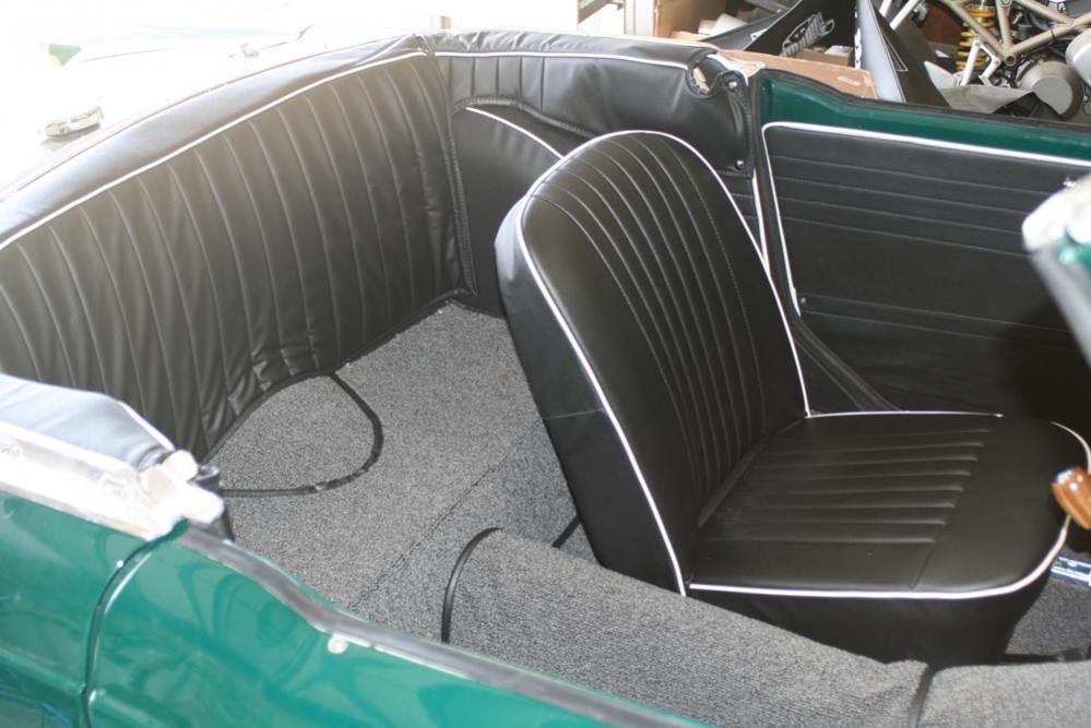

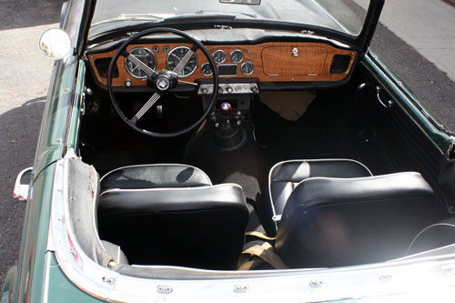

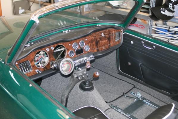

The interior is almost done! The wheel arches came out ok.... A few wrinkles, but not bad for my first attempt at this kind of work... Here are some pics... Except for paint and body, I did all the work myself..
dashcompletesmall.jpgdashrearcompletesmall.jpgfront2complete.jpginterior2small.jpginterior1.jpgleftcornercomplete.jpg
I have added more pics to my album as well if anybody is interested...

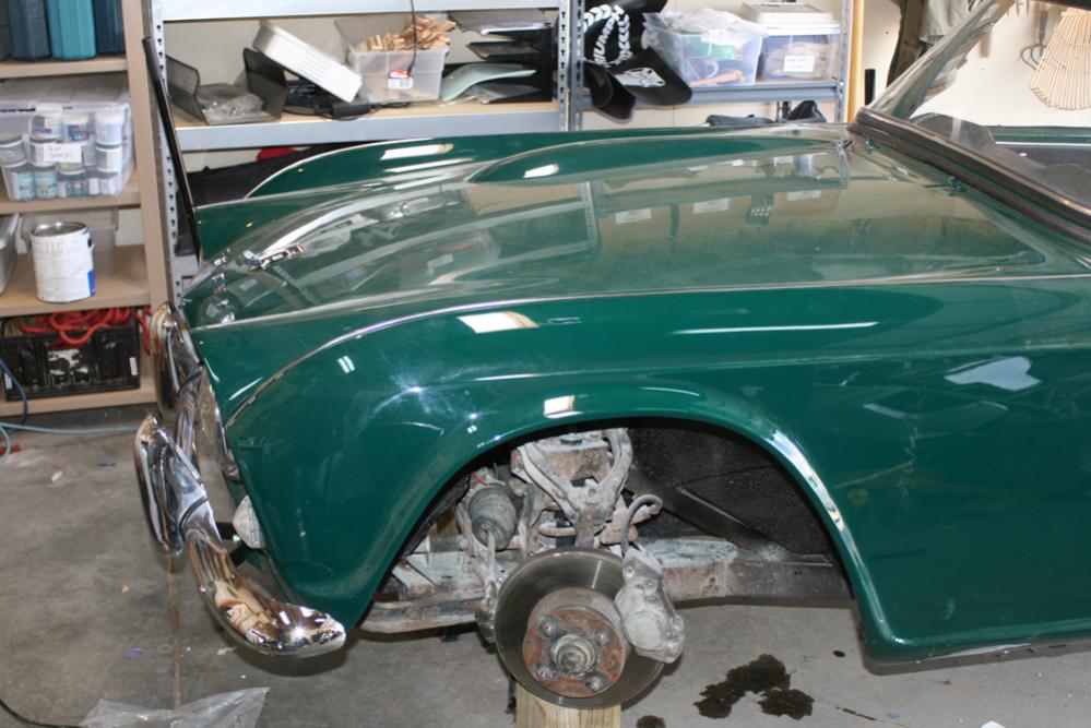

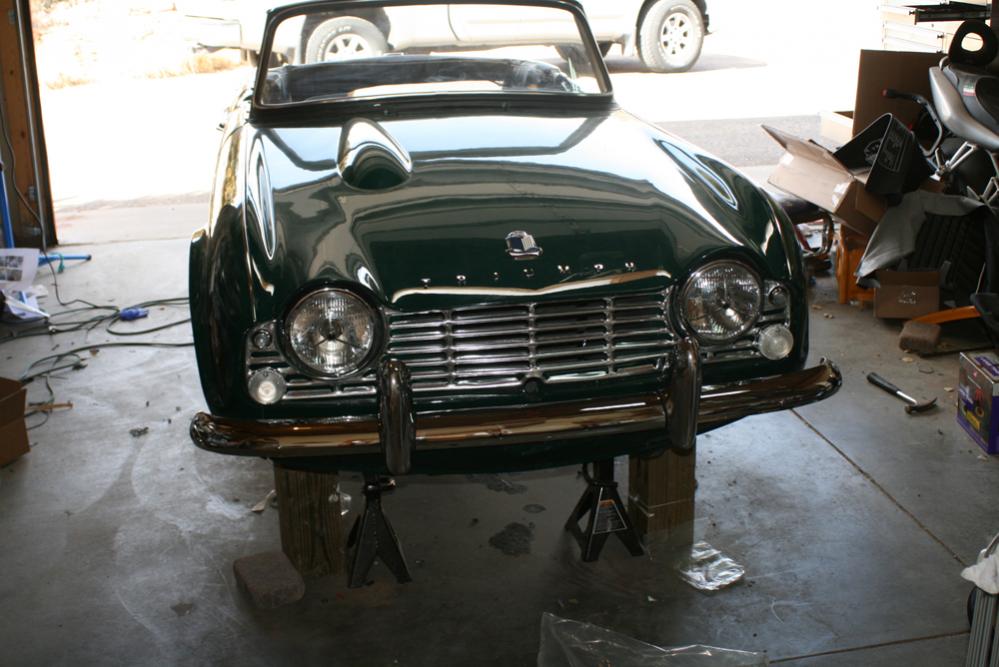

Here is a couple more pics..bootcomplete.jpgdash.jpgThis one is a before pic...
Geo Hahn
Very nice work indeed -- but here's a better (or is it worse?) before pic to show just how far it has come:
BTW -- That is an AC Ace getting washed in the background, we didn't let him in the picture.

MDCanaday
From much experience I would say that getting the seam straight and in the same spot side to side
is the starting point.The factory did NOT use foam at all ,just light cotton padding. I like to baste the seam
into position with a serious glue.Then spray on the fine adhesive of choice and stretch he upper section into position.
Dont be afraid of it and heat can be of help. Now roll the lower section on to the glue(allow it to tack off!!) and finish up the edges with the
serious stuff. Trim as needed when done.
