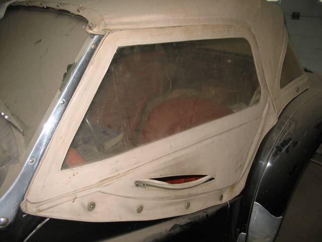

When Triumph introduced the hardtop option sometime during the TR2 or TR3 period (which had no external door handles) they had to add door handles to these cars before they left the factory. There was no way of getting in with the hardtop on the car. With the soft-top cars, handles were not needed outside because the owners could un-zip the zipper on the sidecurtain and open the door by reaching inside through the un-zipped opening. Hence the flat part under the door handle. When the TR3A was introduced with its door handles, the doors were produced with the raised bit under the door handle.
I believe that the door with the flat portion under the door handle is from a TR2 or a TR3 that originally had a hard-top.

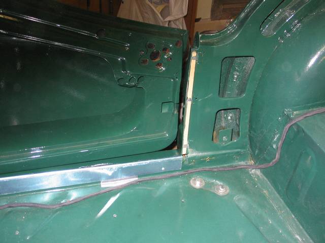

As for square corners or round corners, TRs before TS 60000 had doors where the 2 bottom corners were square. They also had wood inserts along the top of the doors under the vinyl covered interior trim. TRs after TS 60000 have a curved shape on the 2 bottom corners and no wood in the doors.

You can still open the handleless doors on early cars from the outside by opening the zipper in the side curtain no matter if the soft or hardtop is fitted. It's still the same sidecurtain!
