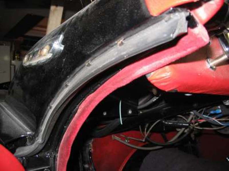

I just received my new door seals. After opening the package I realize what came on the car when I bought it was not at all what was original...imagine that!?!
I wondered if anyone would be so kind as to post a pic or two showing how the originals should go.
Thanks,
John
Don Elliott
Here are the ones above the door on my 1958 TR3A - towards the skuttle. Don't bother fitting the seal along the bottom length of the doors. These seals are too thick and you won't be able to close the door completely. I have stuck little rubber bottons on the door bottoms to keep them from rattling on rough roads.
CJD
CJD
Great...thanks Don!
So it sounds like the fuzzy seal gets held by the interior trim panel. One of the short seals (shown in your picture) is under the A-pillar overhang. The lower seal you are referring to must be the long one that came in the package.
That leaves one short seal that came in the package un-accounted for. It is the same cross-section shape as the lower door seal, but is short like the A-pillar seal. Could it be a different shape for some years on the A-pillar?
John
Don-
I'm glad you offered up that advice - I'm thinking of deleting those bottom seals. Way too many car I've seen have scratched up thresholds from the clips gouging the paint. If I use anything, it will be attached with an adhesive, not those clips.
Randy
Brinkerhoff
Instead of using the clips , use 3M weatherstrip adhesive and glue them tight to the face of the door , inside of the clip position. I couldn't get the door to shut either until I did this.

Just a follow-up for anybody interested.
Got the doors put on yesterday, and Don is 100% correct. The new lower seals are a waste of time. Just for my own edification I tried the doors with the lower seals, frontways...backways...and even shortened them. The doors absolutely will not shut with the lower seal installed. I even tried forcing them closed, to the point of almost bending the doors. No luck, at least with the seals I got...
