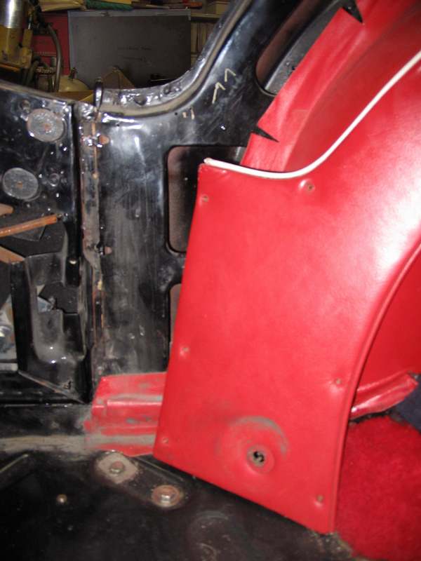

I used soft pine-wood in my 1958 TR3A 21 years ago. Works just fine. We did the same on TS 81552 L which we finished in 2006.
BTW the dog-leg interior trim is secured to this coconut, hemp, jute, nylon, pine-wood with #4 single slot wood screws about 5/8" long with a slightly convex surface to the head and is used with a small dished washer like all the other screws on any TR3A.
