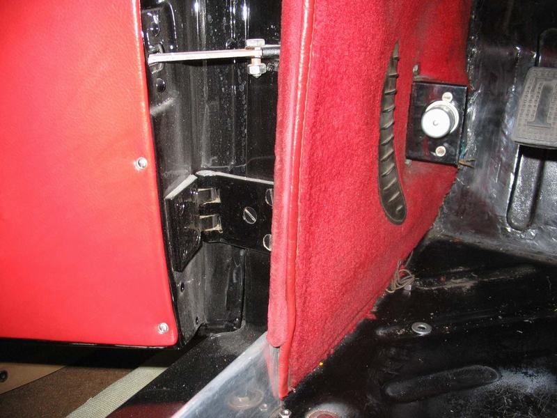

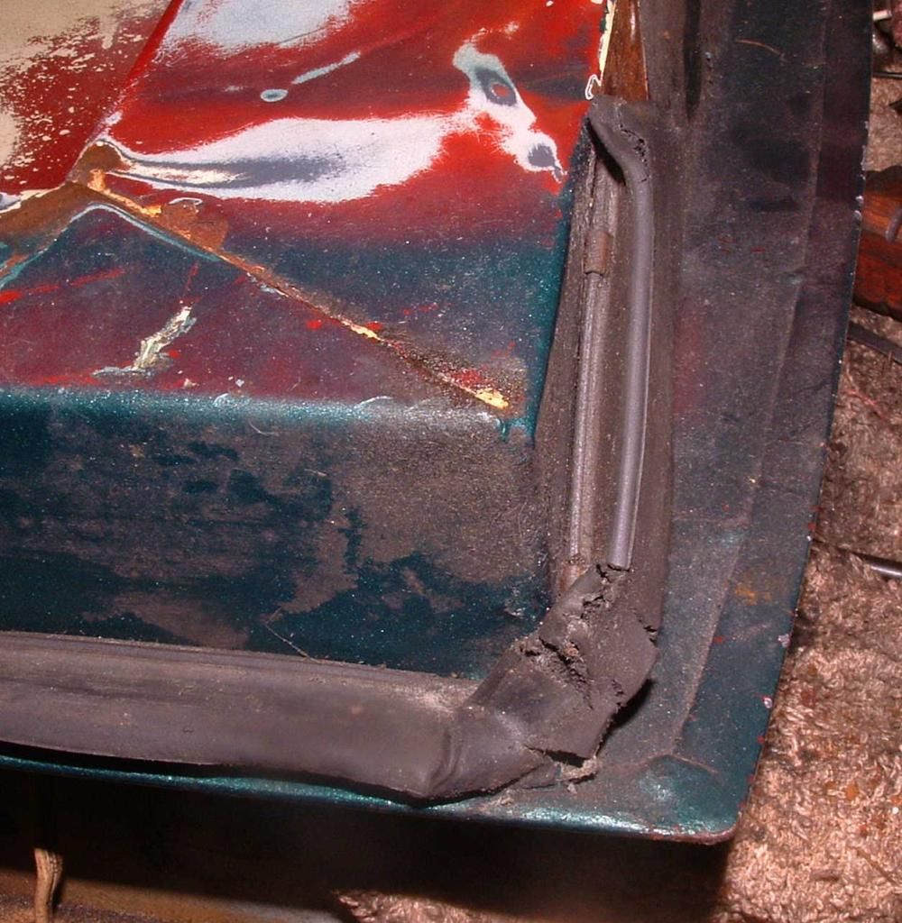

Hopefully, someone else has some better photos. 40 years of TR ownership, and I've never had them all installed properly at the same time! Here are a couple of shots that a friend (Don Elliott) sent to me of his early TR3A.
Interior20Door20Trim205s.jpg~original
In this second shot, you can see the two holes in the front of the door, where the bottom seal should be attached. As I recall, Don was one of those who found he couldn't get the door to fit properly with the bottom seal installed.
Trim%20around%20front%20door%20opening.jpg~original

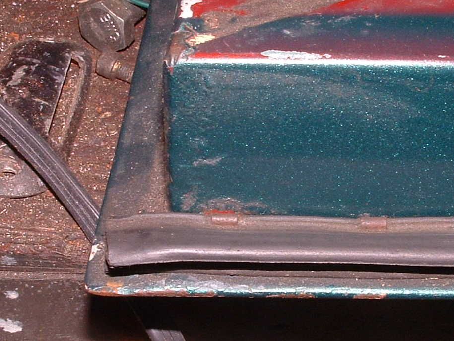

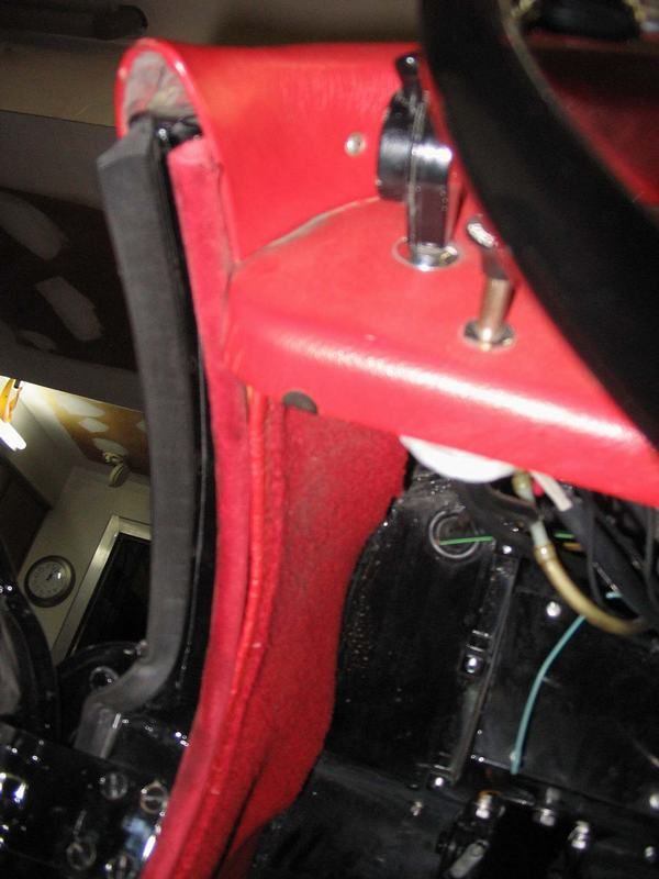

Here are a few more shots of my previous TR3A (after it got wrecked), showing how far that bottom seal has to crush in use
DSCF0035_reduced.jpg~original
DSCF0034_reduced.jpg~original

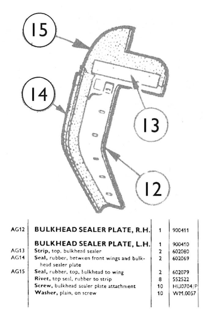

I don't have a photo of the actual bulkhead to wing seal, but here is the diagram from the parts catalogue
BULKHEAD%20TO%20WING%20SEAL.jpg~original

I refer to Randall's diagram above. In 1989, I made my own new ones (Item 12) out of stainless steel (16 ga. is thicker too) and painted them black. The top rubber bit (15), I cut .from thicker and stiffer rubber. I also cut it larger so that I have a curve in this piece where it sits tightly against the fender. I did not pop-rivet that top piece of rubber through the small plates shown. I hate the word "catalytic corrosion of dis-similar metals". So I drilled holes in stainless steel pieces like the original ones and screwed them all together with stainless steel screws, washers and nuts for easier removal. As for the side rubber strips, I reused my original ones from when I bought my TR3A in 1958. They still look like they did in 1990 when I finally finished my restoration. No water ever came in there in 24 years and 113,000 miles.
