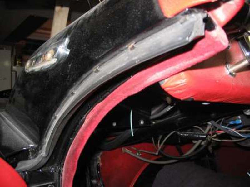

Trying to fit the door seals that go above the doors in the curve area. Do you fit the clips to the car and then the seals to them or the other way around?
Thanks
Greg
Don Elliott
I can't remember. It was so long ago. I would think that either way would work. If you put the clips in first, compress the open big end a bit, insert the clip and when they are all in you can compres the rubber just where the clip holds the seal. Make sure the clips are in the right way round. You can put them in 180 degrees half way round which may be wrong because each side of the clip is different.

I put them on the strip at approximately the correct place. Then started at the hinge area putting one clip at a time and use a pair of needle nose to position and push in the clip.
Moseso
I think clips on the rubber, then insert, would be WAY easier than trying to stuff the rubber into the clips after they're in.
mrv8q
I agree, from experience: clip onto seal, clip with seal into hole. Not a bad job, but just wait till you do the seals under the doors, ugh!
