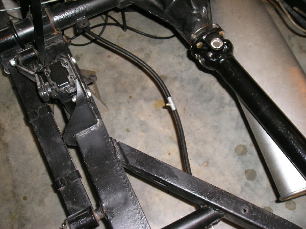

Looks like my hand brake line will have a bit of a bend to it. Problem? Or, is that just the way it is.

That's the way mine is. When you put the body on, there's a small tab with a hole in it where a spring attaches and then attaches to the brake cable to keep it out of the way of things.
You can see the spring here...part #36.

That's the way it should be! It needs some slack to accomodate the movement of the rear axle.
There should be a spring that pulls the cable to the side, so it doesn't hang down to snag on road obstacles. P/N 60274.

Here's a shot of the spring in situ

Thanks fellows. Kinda thought it needed to be there, but I had forgotten about the spring. Thanks for the pictures, clears things up!

During the final assembly in 1990, I noticed that my handbrake cable had quite a "bend" in it. So I took off the outer sheath and shortened it. Then I found that the cable was still the long length and I had to modify its length too. I don't remember how exactly . Then I put on the spring and adjusted the whole arrangement so that the chromed hand-brake lever arm clicks about 5 clicks and then it's fully on. I've had to re-tighten it twice in the past 18 summers during 100,000 miles.
