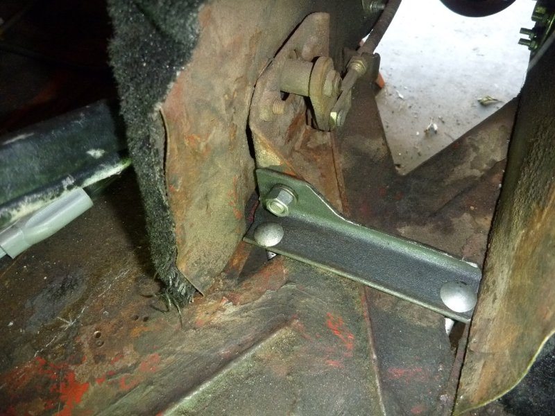

Also check inside the prop shaft tunnel to make sure the handbrake mount isn't broken. I made this brace to fix that problem. This would seem to address the accessibility issue.

"Also check inside the prop shaft tunnel to make sure the handbrake mount isn't broken."
It appears this is a common problem. Mine had been broken for years, and I just around to re-welding it.
