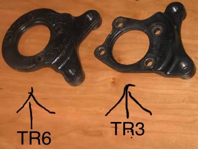

Yes a and b will fit and are interchangeable and have the slightly larger disc (rotor) and the the pads are held in with spring plates top and bottom.
The later calipers TR4a through the tr6 the pads are held in with through pins ( but of different size dia.)
Some P16 imperial or P16m metric for the pipe input.
The disc is slightly smaller too.
These later calipers need a different hub mount ring. But they do fit the hubs.
So not a massive change.

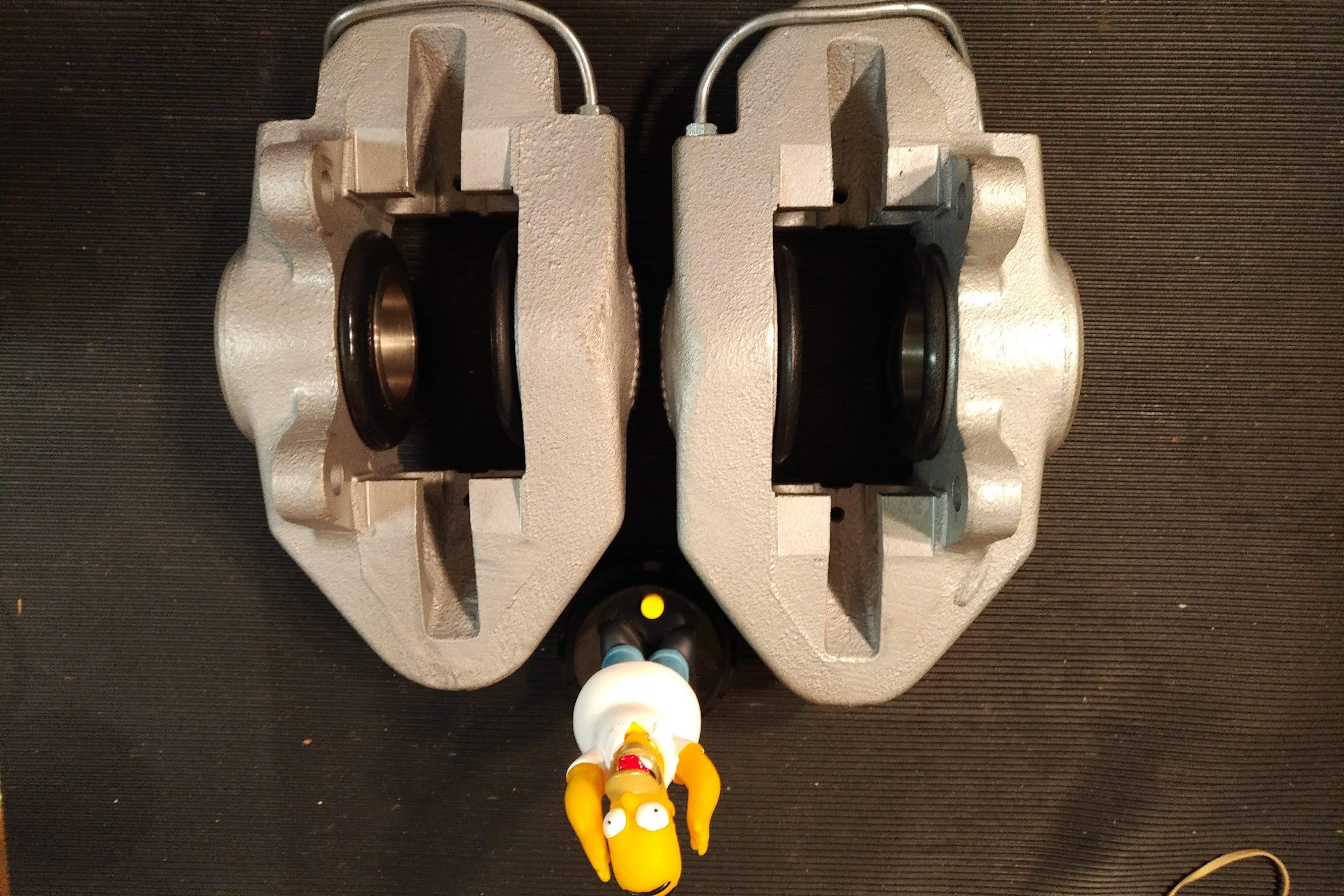

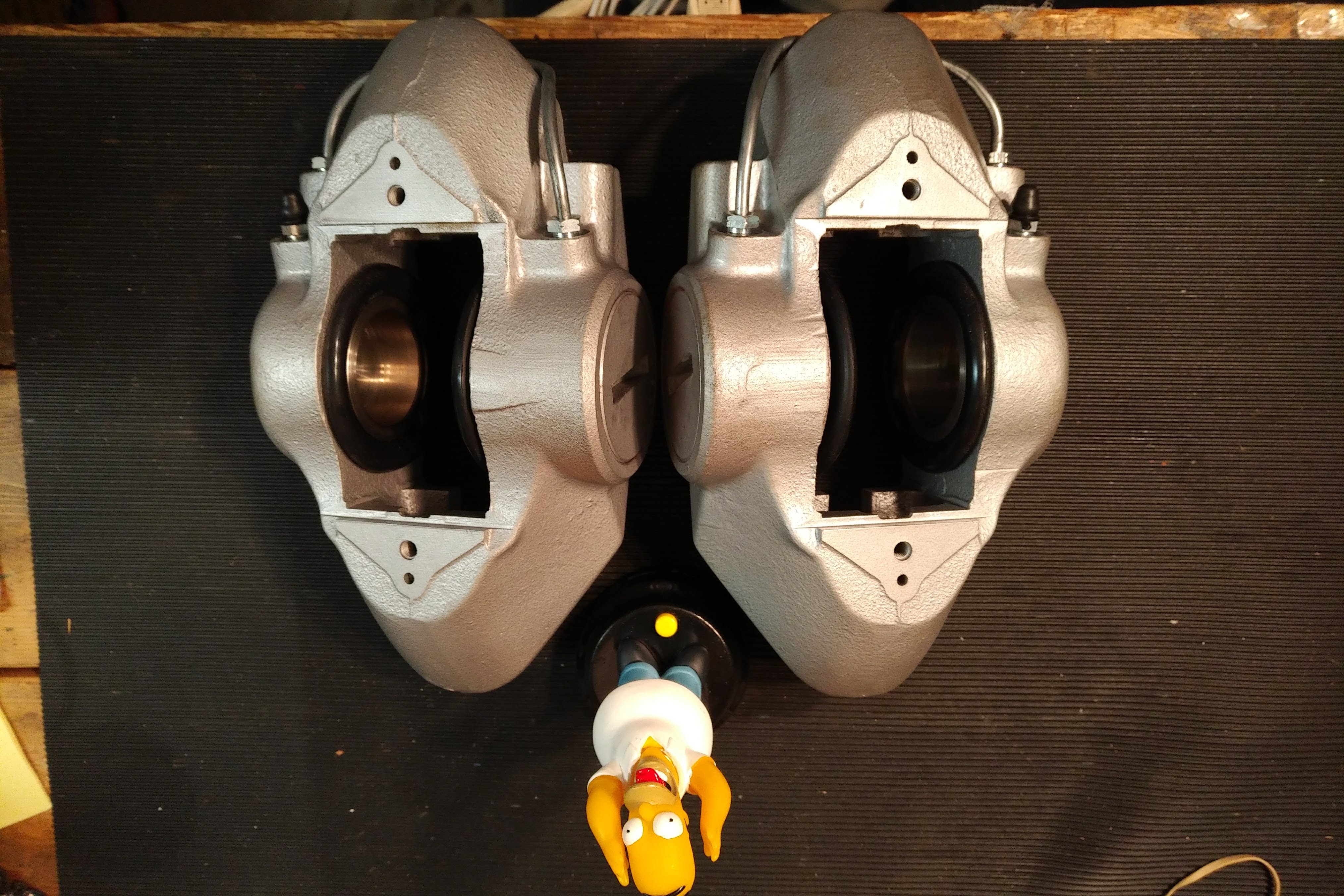

Tom, I have #58370. These are my rebuilt calipers. Don’t know if they are ’A’ or ‘B’ type.

Yup, Those are the "A Type". Appears as though there are some inconsistencies in the numbers. Not unheard of with Standard Triumph. Could be me too. I don't remember where I got that data so the credibility might be suspect.
Tom
