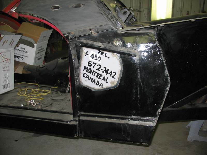

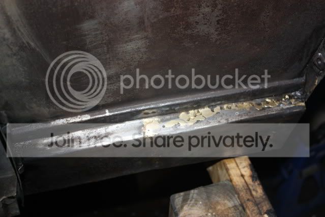

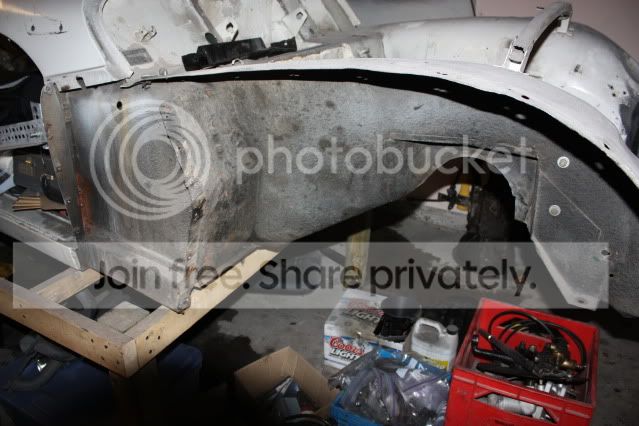

Pretty Cold out in the garage these days so I thought I would take a break from the chassis and work on the body a little bit. How do you ward of the cold do you ask....with a nice hot heat gun of course!
Here are a few pics of tonights adventure.
At least there is metal :smile:
PS. Don't know what's up with that little cutout....

Unfortunatley, it is on both sides ....
Good guess though..

My TR2 has a big ol' speaker hole in that panal on the right hand side. Intrestingly enough in the "How To Restore Triumph TR2, TR3 & TR3A" book, the author points out a hole like that in one of the pictures (Page 44), and mentions how it will need to be repaired. A hole EXACTLY like the one in mine, and Exactly like I've seen in other early TR2s.. It was factory! Deleted fairly early on I suspect. My theory is it went away about the same time they started putting the vent in the cowel. I've only ever seen that hole in cars without the cowel vent.

Right and left hand drive may have dictated ant. placement opposite the steering wheel.

My radio ant was thru that hole but never looked on the driver side...also had a factory cutout for speaker on passenger side.

Ah, now the fun stuff Tush!
Looks pretty good there actually compared to many I've seen. And by that, I of course, mean mine. LOL.
Is that patch solid enough to be left alone? Going with the Eastwood products again in there?

Not sure what I am going to do yet...I will wait until I see the bigger picture.
Having said that, I really like how the truck bed liner worked in the wheel wells and inner fenders of my 6. I may just use the rust encapsulator followed by paint and then a quick scuff before applying the Duplicolor bed liner.
Will let you know.
Regardless, I am getting to the point where I am excited and a little nervous when I walk by the MIG everyday.....Might finally get that unpacked in the next couple of weeks and will start practicing on the old tub.

TS39781LO also had it. But it's normally covered by the carpet panel, so not normally visible unless there is a speaker in it.
The hole is huge by modern standards (remember, those old 50's speakers were much larger), so I was unable to source a full-range driver to fit the hole. I solved the problem by making a ring of masonite that would mount to the hole (which even has notches for clip nuts) and mounting the speaker to the masonite.

The really strange part is that none of the US-bound cars had factory-installed radios, they were all dealer installed, and apparently mostly used a central mounted speaker. I've never seen an original speaker mounted in the hole in the kick panel.
prb51
True, I've never seen one either but have that same oval cutout in the passenger footwell that has always been described as a speaker cutout. The driver side is full sheet metal.

According to my BMIHT Certificate my car came from the factory with a Radio installed.....Unfortunately, it is long gone. I asked the PO (2nd owner) who owned the car prior to me since 1967 and he doesn't remember it either....

My 1958 TR3A (TS 27489 LO) came with a hole for the speaker over on the RHS of the footwell. The front fender came with a convex metal plug painted body colour on the top of the RHS front fender for mounting an antenna. In 1962 or so, I put a radio, antenna and speaker in my TR and after a week or two, when I couldn't hear it because it was way over on the far RHS, I decided to remove it. It was worth nothing but the extra weight etc. was increasing my rally times.
The same original metal plug is back in the hole in the fender where I had the antenna installed.
When I did my restoration from 1987 to 1990, I cut a piece of sheetmetal and blanked off the speaker hole to cut down on draughts that used to come through there. Not original, but no concours judge ever saw it. Notice the rain trough above where the hole was. I added my phone number if my TR ever gets stolen, the new owner will hopefully give it back to me.
