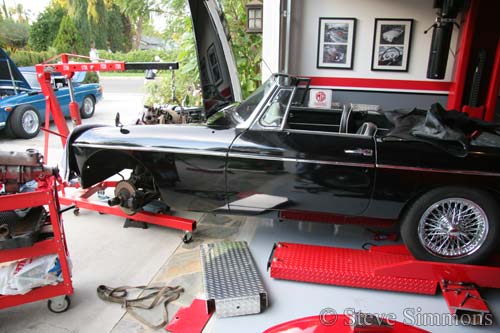

Steve_S
No special tricks I can think of off hand, but my preferred method is to raise the rear of the car to make the engine / gearbox combo easier to tilt out.
19_again
Steve, I'm disappointed that your garage gear isn't color coded. It appeard that you're using your red car jacks and cranes on the black car. Ordinarily that's a 3 point deduction, but it's Friday and Ive had enough pinot to be mellow, but don't let it happen again.

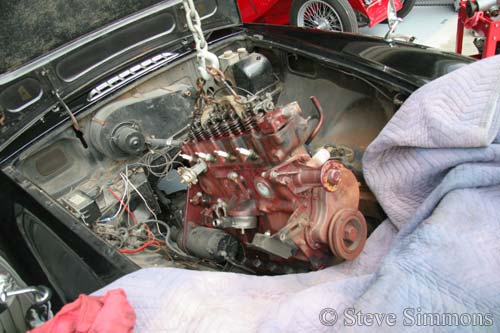

Here is where I am at:
Platinum
Did'ja do inside th' bellhousing, too? /bcforum/images/%%GRAEMLIN_URL%%/devilgrin.gif

Bronze
Nah just a quick wipe.
