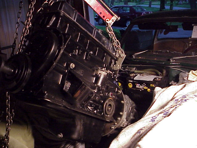

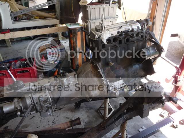

Hey Tom,
Not sure if you were asking about the 6 or 3 so I thought I would post both.
On the 6, I used the stock attachment point at the rear of the engine where the ground strap is. If you look at the second pic, you can see the pick up point I used for the front. I always thought that this was a stock piece but after attending a TRials, I was told it wasn't. You could always use the head stud instead.
On the 3, I had two pick up points that I assume(d) were stock. You can see them in the pics below.
Cheers,
M. Pied Lourd

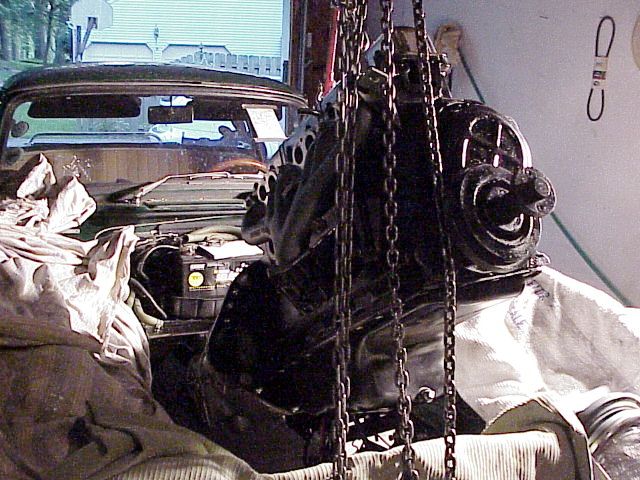

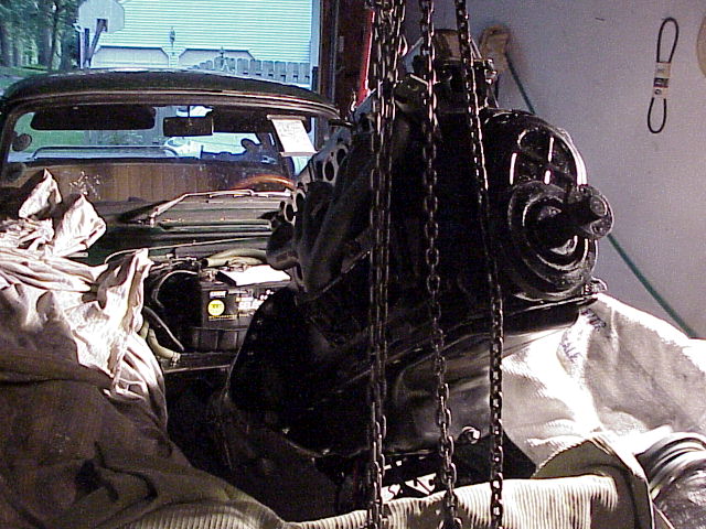

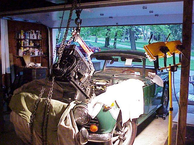

Did this 10 years ago. You will notice that we were able to pull the engine and transmission together. With the correct equipment, this is not a bad job. The load leveler gizmo (not sure what these are called) is a must for pulling the engine with the trans because of the extreme angle required. I did this job before I owned an engine hoist. I had to jerry-rig a chain fall and temporary A-frame. With the trans it's a heavy load, beyond the 2x8 rafters in my garage!

TR3driver
Great Pumpkin - R.I.P
Surely does make the job easier. Yet I have gotten by with just a hook on the hoist and a chain that would slip through the hook; plus a couple of big tapered drifts (punches) to lever the chain through the hook and lock it in place.
The hoist was a simple cable puller (aka "come along"), linked to a braced rafter in the garage. Well, actually I used the rafter without bracing several times, until it broke. After that, I decided the bracing was required :laugh:
Necessity is a mother, and all that.
