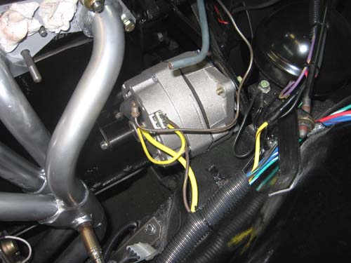

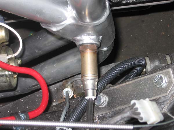

Art Did you install the RH needles in the Su's and what O2 sensor did you use? Whereabouts on the header did you install the O2 sensor? Thx Karl
Yes, I put RH needles in the the SUs. My O2 sensor is an AEM wideband. See the pics for header location. The O2 sensor in the pics is a narrow band I had in there just to see how it would work out.
