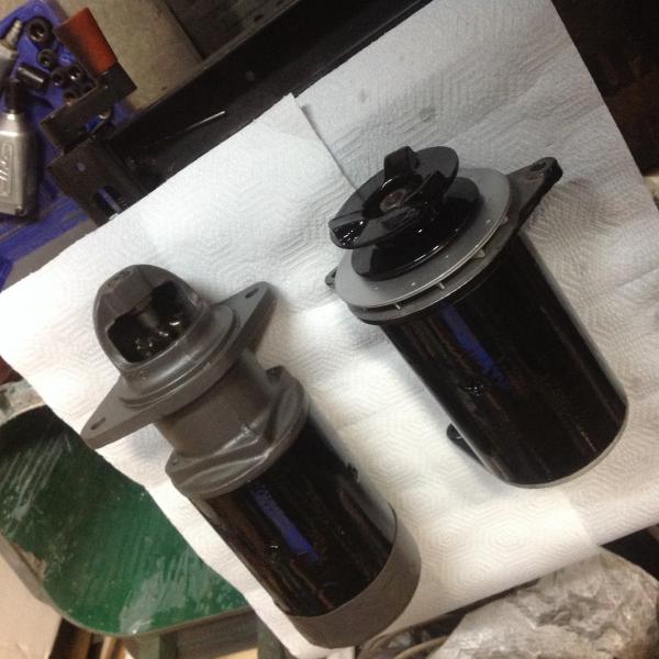

I went ahead and painted the body black and use an Eastwood spray grey on the nose piece and the band.
Cheers
Tush
M_Pied_Lourd
M_Pied_Lourd
Just a quick picture of the painted starter and generator. Not concourse but 100 per cent better than what I started with.
Cheers
