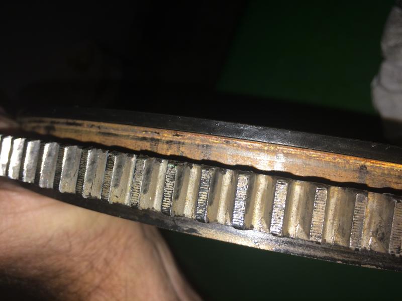

I was speaking from experience when I suggested the flywheel might have moved. The same symptoms plagued my car.... starter gear would not engage all the time but it would just spin.
Here's a pic of my flywheel with the ring gear as it was when I removed it. The ring gear should be against the shoulder at the top of the pic. The ring gear moved almost 2 inches away from the shoulder making it impossible for the starter to engage unless the flywheel was 180 degrees opposite.
A $30 ring gear but a PITA to install it. All is good now!
